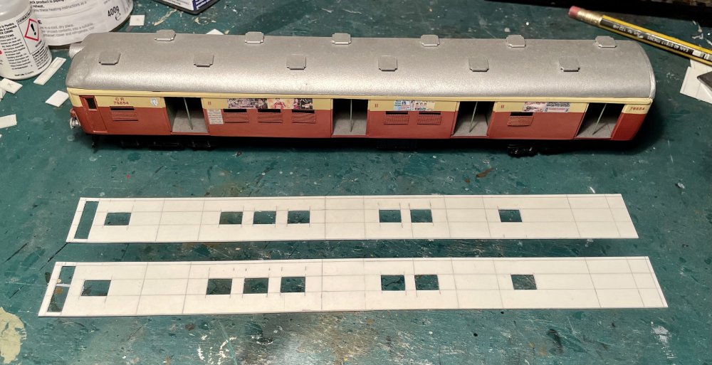

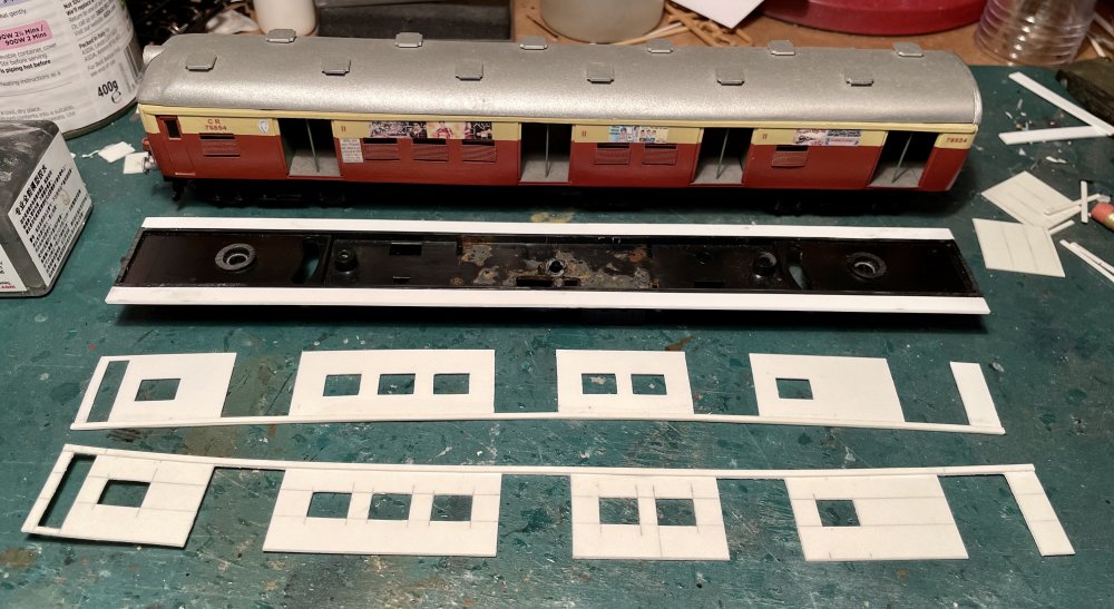

Darius43 Posted June 3, 2023 Author Posted June 3, 2023 Started work on a composite coach this evening. Sides marked out on a sheet of plasticard. Windows cut out. Doors cut out. Representations of the sliding doors and window shutters glued to the inside face of the carriage sides. These are always open. Coach ends made using a plasticard master template. Vestibule walls made from 1mm thick plasticard. These have the curved profile of the carriage sides on one edge and will be glued in place once the carriage sides have been fixed to the chassis. Carriage sides fixed in place. Cheers Darius 6

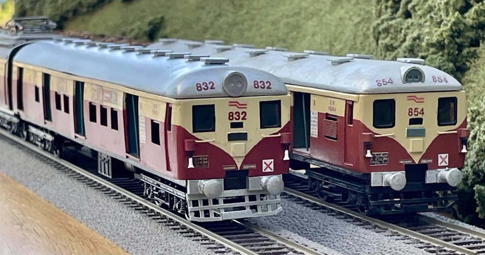

Darius43 Posted June 7, 2023 Author Posted June 7, 2023 Five cars completed… …one more to go. Cheers Darius 6 1
