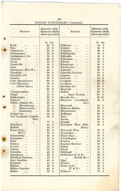

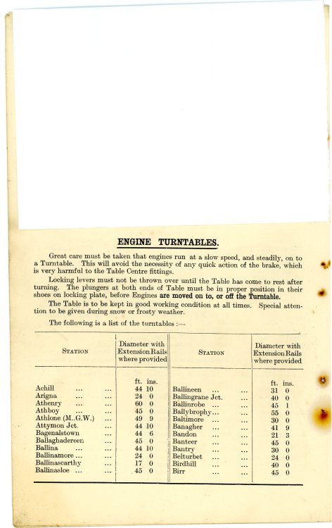

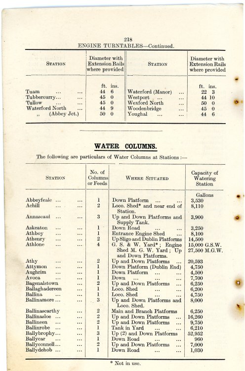

seagoebox Posted November 24, 2022 Share Posted November 24, 2022 From the GSR Green Appendix dated 1st March 1935 4 1 3 Quote Link to comment Share on other sites More sharing options...
jhb171achill Posted November 24, 2022 Share Posted November 24, 2022 I need a 45' one for my layout. Could any of our 3D print wizards do an Irish standard 45ft one? These massive 70ft things they have in GB, with little cabs on them and so forth, or ground level ones - for an Irish layout look as utterly ridiculous as a TGV in Amtrak livery, hauled by "Dick", on a model of the Sligo Leitrim in 1898. The "bought" turntables are both too big and too expensive. 4 Quote Link to comment Share on other sites More sharing options...
Blaine Posted November 25, 2022 Share Posted November 25, 2022 14 hours ago, jhb171achill said: I need a 45' one for my layout. Could any of our 3D print wizards do an Irish standard 45ft one? These massive 70ft things they have in GB, with little cabs on them and so forth, or ground level ones - for an Irish layout look as utterly ridiculous as a TGV in Amtrak livery, hauled by "Dick", on a model of the Sligo Leitrim in 1898. The "bought" turntables are both too big and too expensive. Look for a Heljan one, they were shorter. As used on the MRSI Loughrea layout, suitably regauged to 21mm. 121's and J15's sit nicely on them 4 Quote Link to comment Share on other sites More sharing options...
