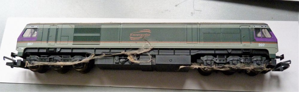

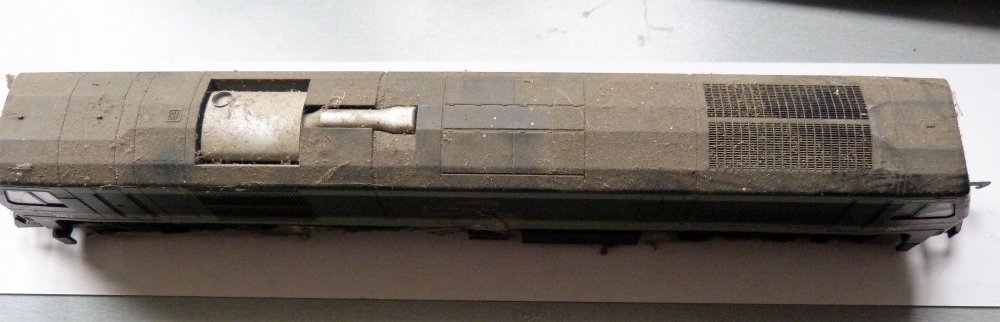

WRENNEIRE Posted April 2, 2018 Posted April 2, 2018 (edited) You can mess all you like with your weathering powders and air brushes but when it come to it its hard to beat the real thing Edited April 2, 2018 by WRENNEIRE 2 1 Quote
JasonB Posted April 2, 2018 Posted April 2, 2018 2 hours ago, WRENNEIRE said: You can mess all you like with your weathering powders and air brushes but when it come to it its hard to beat the real thing Christ Dave, where did you dig that out of.Its in worse condition than the one's rotting away in Inchicore 1 1 Quote

jhb171achill Posted May 11, 2018 Posted May 11, 2018 On 4/2/2018 at 3:30 PM, jason brady said: Christ Dave, where did you dig that out of.Its in worse condition than the one's rotting away in Inchicore The cobwebs are the wrong livery............. 1 1 Quote
JasonB Posted May 11, 2018 Posted May 11, 2018 4 hours ago, jhb171achill said: The cobwebs are the wrong livery............. Now that you mention it JB, they do look slightly the wrong shade Lovely work Noel. Very precise lining as always. 1 1 Quote
jhb171achill Posted May 11, 2018 Posted May 11, 2018 2 minutes ago, jason brady said: Now that you mention it JB, they do look slightly the wrong shade The spiders are the wrong way round too. 3 Quote
