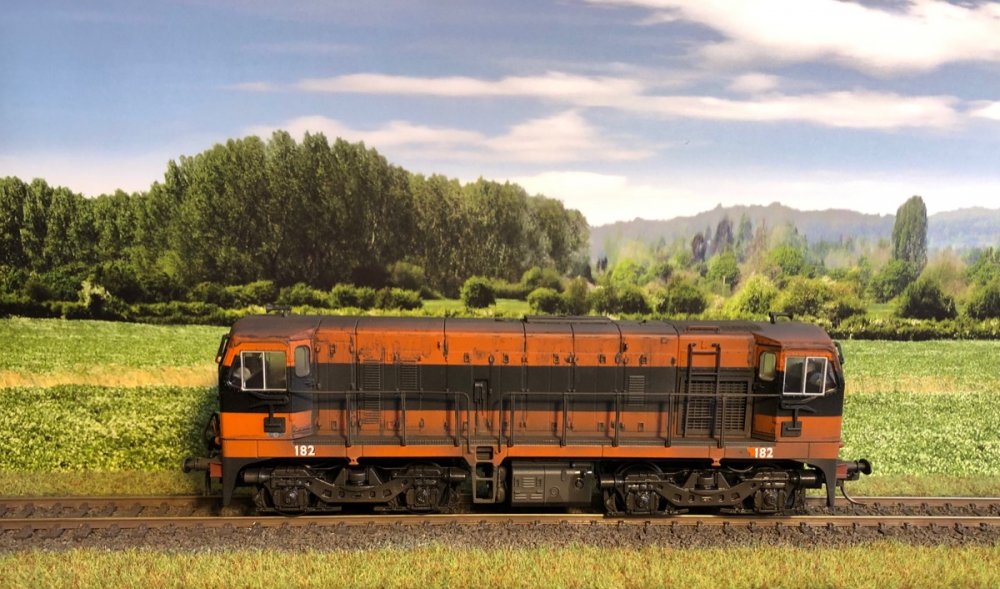

Noel Posted March 21, 2019 Author Posted March 21, 2019 Pals at WMRC gently hinted that a change of back scene might look better when photographing models off the workbench or out of the paintshop so here are one or two updates. Thank you WMRC pals for the present of a roll of back scene. 6 Quote

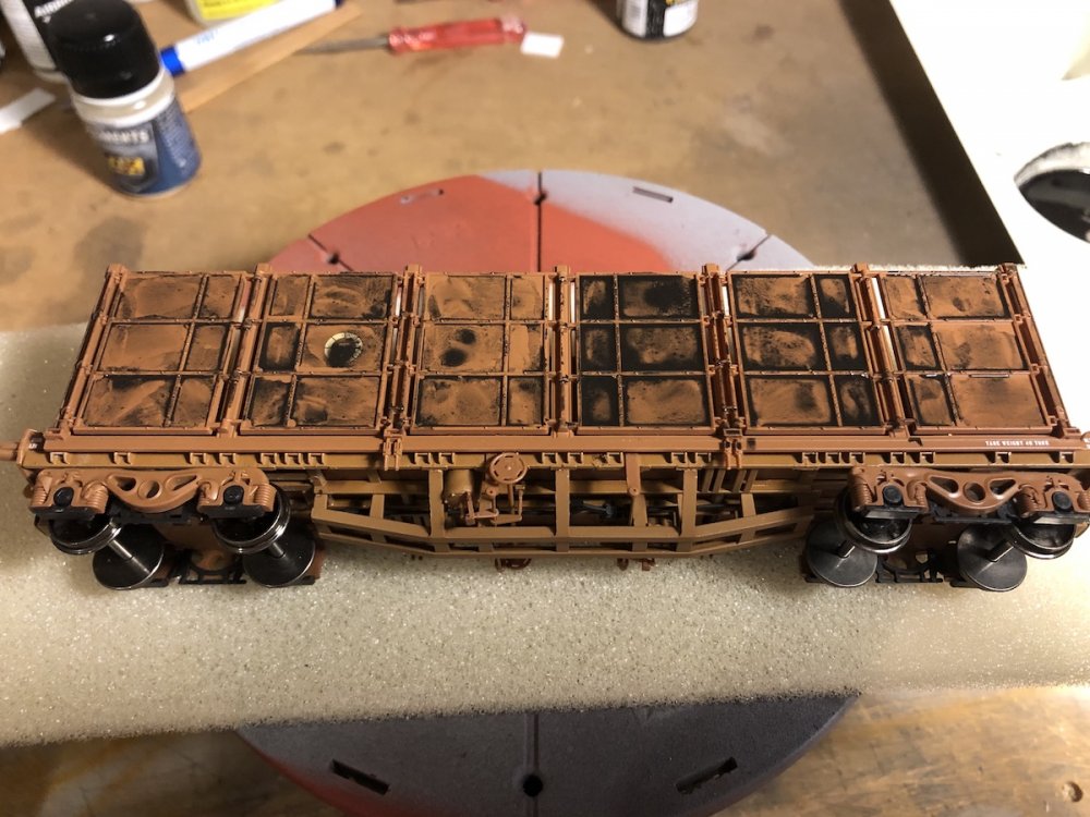

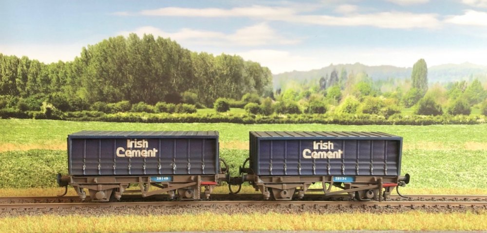

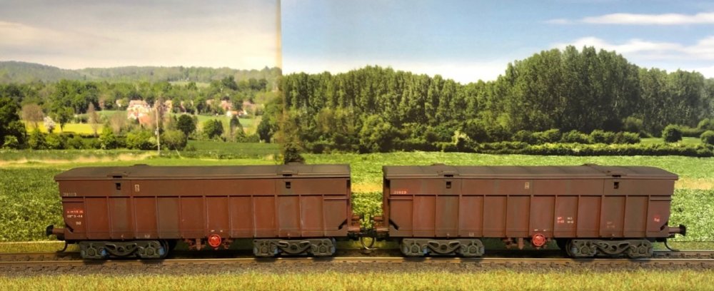

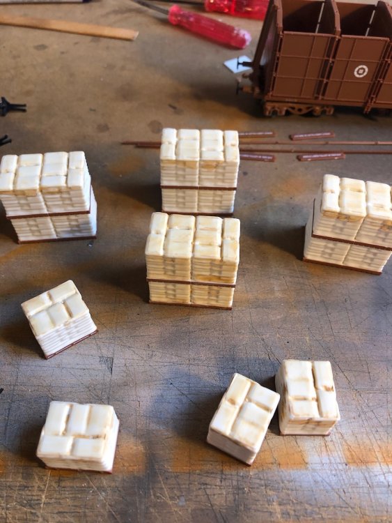

Noel Posted February 12, 2020 Author Posted February 12, 2020 Had a quick go at weathering one of my new IRM Fertiliser wagons this evening. Mainly weathering powders washed on in solution and then rubbed off again using damp cotton buds. The loads also got a bit of a wash to dull the bright white bags. These wagons seem the best yet from team IRM. The fab four have pulled it out of the bag again. Thank you guys. Now what's next? No rest for the successful. The loads got a bit of dulling down as well. Two weathering powder solutions (50% water/50% decal fix), first is a grungy black/brown to stain recesses. The second a cream white to simulate rain streaking and cement dust from the odd burst bag. Its a bit like making an omelet you have to make a mess before you can recover it and tidy up (ie break an egg). The sole bar got a judicious amount of grey/white to simulate the odd bag on the bottom of a pallet load punctured by fork lift truck drivers rushing to finish their shift of an evening in the yard. 5 Quote
Noel Posted February 13, 2020 Author Posted February 13, 2020 (edited) Just a tip. Decalfix is essential to help the weathering powder solution spread easily over plastic surfaces and avoid surface tension causing it to clump into droplets or small pools. With Decal fix 50% + water 50% the powder solution seems to spread evenly and adhere to the plastic better. Also allows reactivation later so it can be changed and reworked using damp cotton buds. First you make a mess, then clean it up. Trying to learn how to speed this process up. I generally leave it about 45mins to semi-dry before reactivating and working it with damp cotton buds to remove most of it. End result after its dried Used a blackish/dark brown gunk powder colour first in solution to define edges and recesses, later a second solution of cream white to simulate water stains and cement dust from odd burst bag. The load got a bath as well to dull down the white and give the bag shapes visual definition. Lovely loads on these wagons, well done team IRM. They even have pallets to if you choose to remove them from a wagon and place in a yard beside these wagons, looks great. Edited February 13, 2020 by Noel 4 Quote

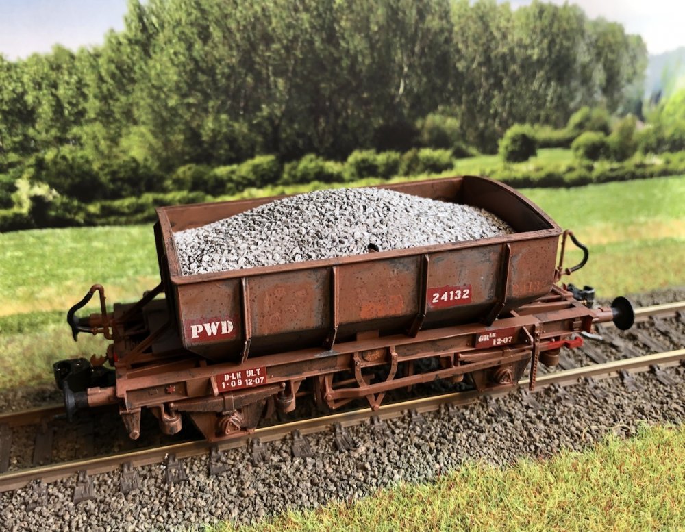

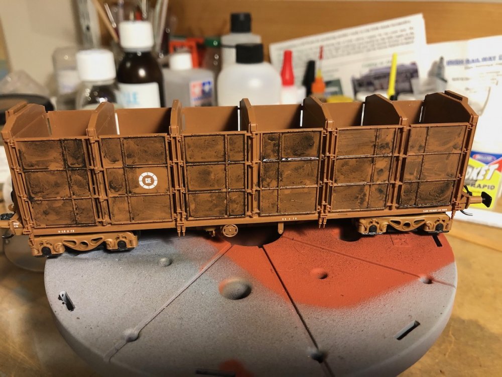

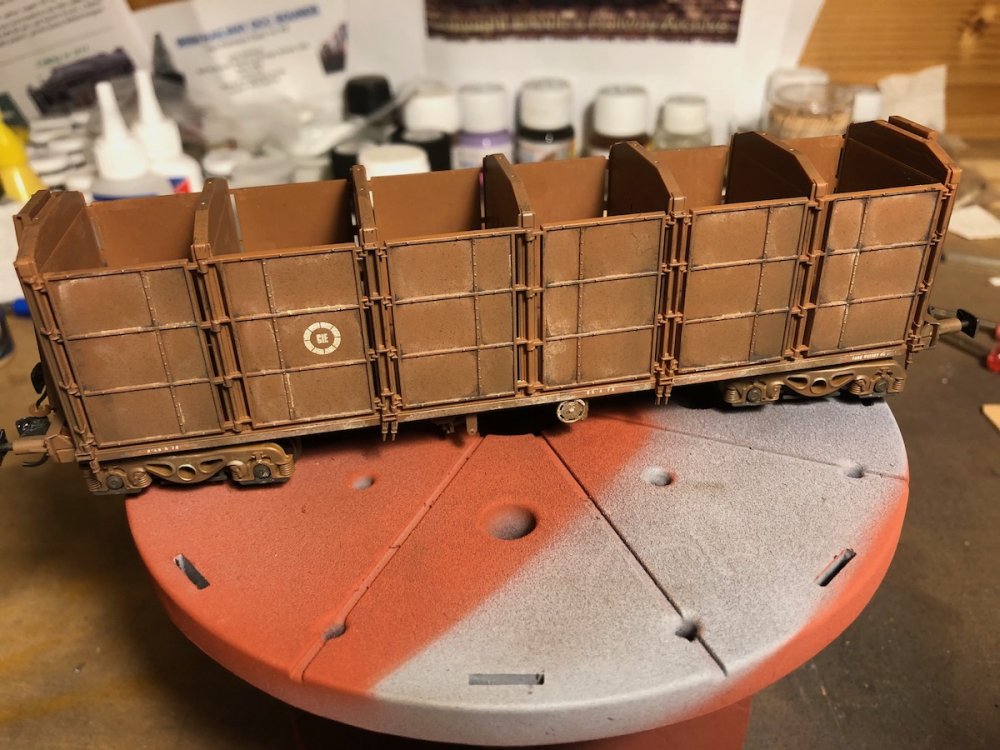

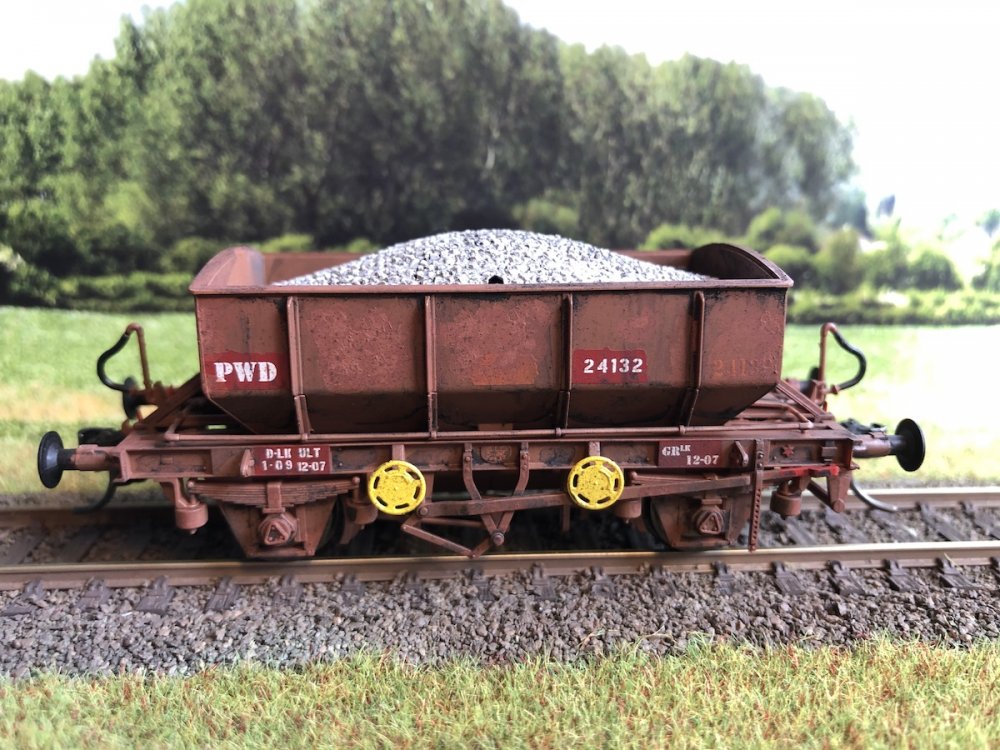

Noel Posted April 9, 2020 Author Posted April 9, 2020 I finally got around to weathering one of the IRM Ballast wagons. Don't know why it took so long as these were the first IRM wagons I got back 2 or 3 years ago when they first hit the market? Perhaps it was because the natural colour of the ballast wagon model doesn't scream 'I need to be weathered'. Even more impressed with these original wagons. Real beauts. One done, 11 more to do. Have to handle with care there are so many super detailed parts on these. It took a while. No airbrush was harmed doing these. The load also got a little wash. 6 1 Quote

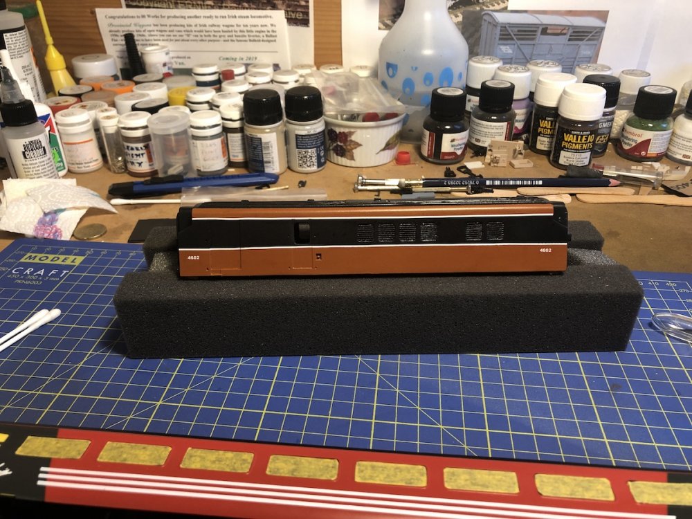

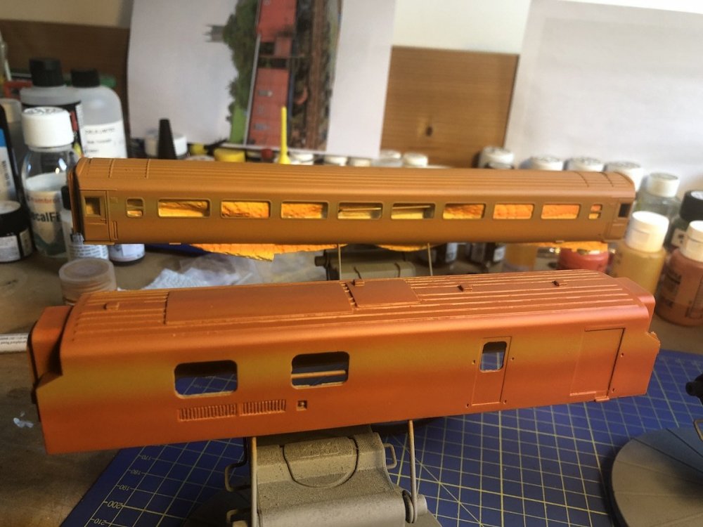

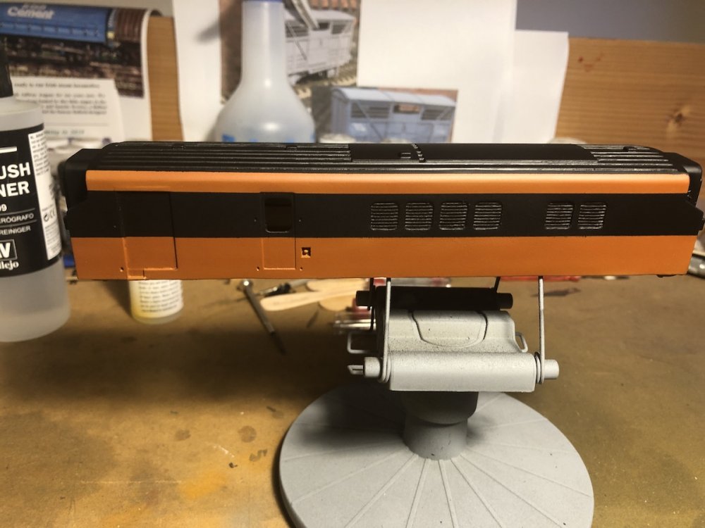

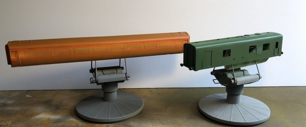

Noel Posted May 22, 2020 Author Posted May 22, 2020 (edited) There be painting going on. A bit of an orange parade. Parallel projects can mean overlap efficiencies. Provincial Wagons CIE 20ft container, Later generation Dutch GSV suitable for running with Mk2 coaches and a BR Mk3 respray to supertrain. For fun half thinking of doing one side of the mk3 in supertrain livery and the other side in IR intercity tippex. Vallejo mix of Yellow and Red 35:1 ratio. The mk3 is a little deeper, added a tweak more red. Edited May 22, 2020 by Noel 5 Quote

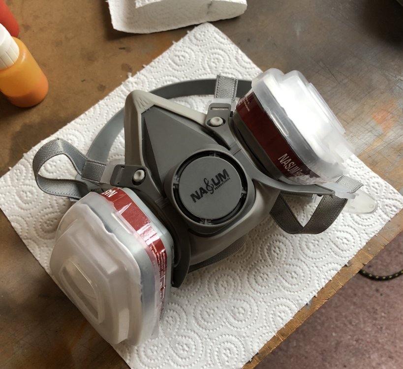

Noel Posted May 22, 2020 Author Posted May 22, 2020 Invested in a more effective breathing mask. It doesn't get in the way of the head gear optivisor I also wear. I only airbrush acrylics, but you can't be too careful with ones lungs. 1 Quote

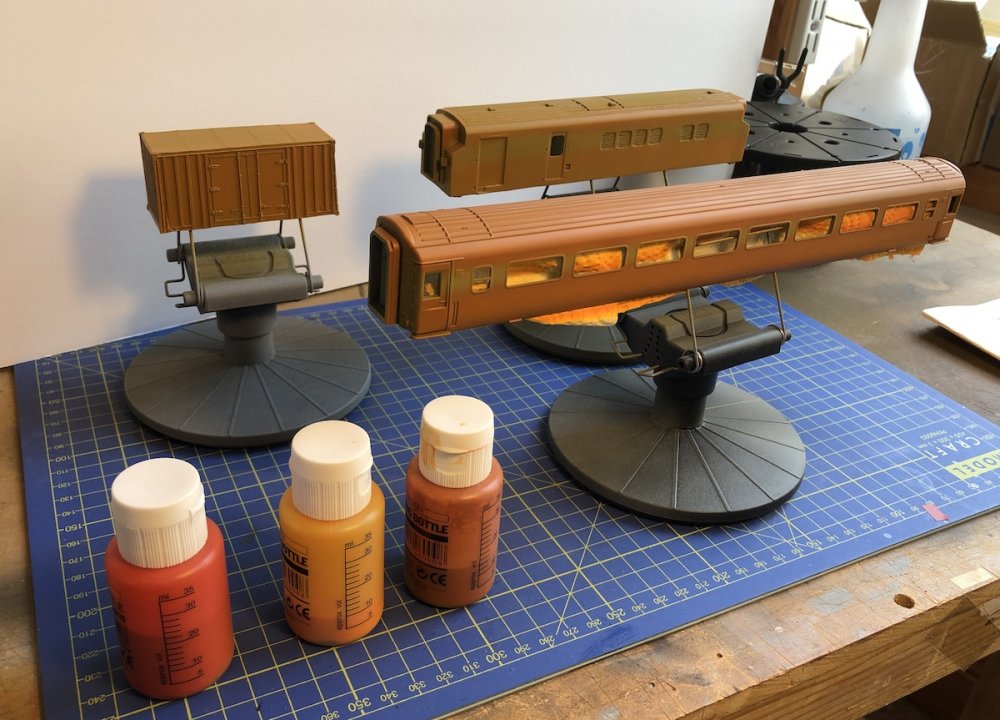

Noel Posted May 22, 2020 Author Posted May 22, 2020 Two more thin coats of paint today. The GSV is a different shade (more red) as it will be tippex IR livery running with Bachmann/MM mk2 non aircon coaches (ie with the opening windows). Mk3 will be super train. The fun will begin in 24/48hrs time when the masking begins. A reasonable number of coats of the paint are needed to cover the dark grey primer otherwise it darkens the shade of orange/tan too much as a background colour. Perhaps a white primer might be better for orange livery coaches and save on paint. The one thing about this hobby is you never stop learning, especially the stuff you don't know that you didn't know. Its great fun 3 Quote

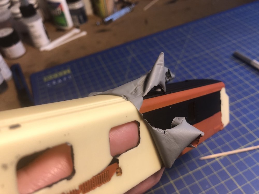

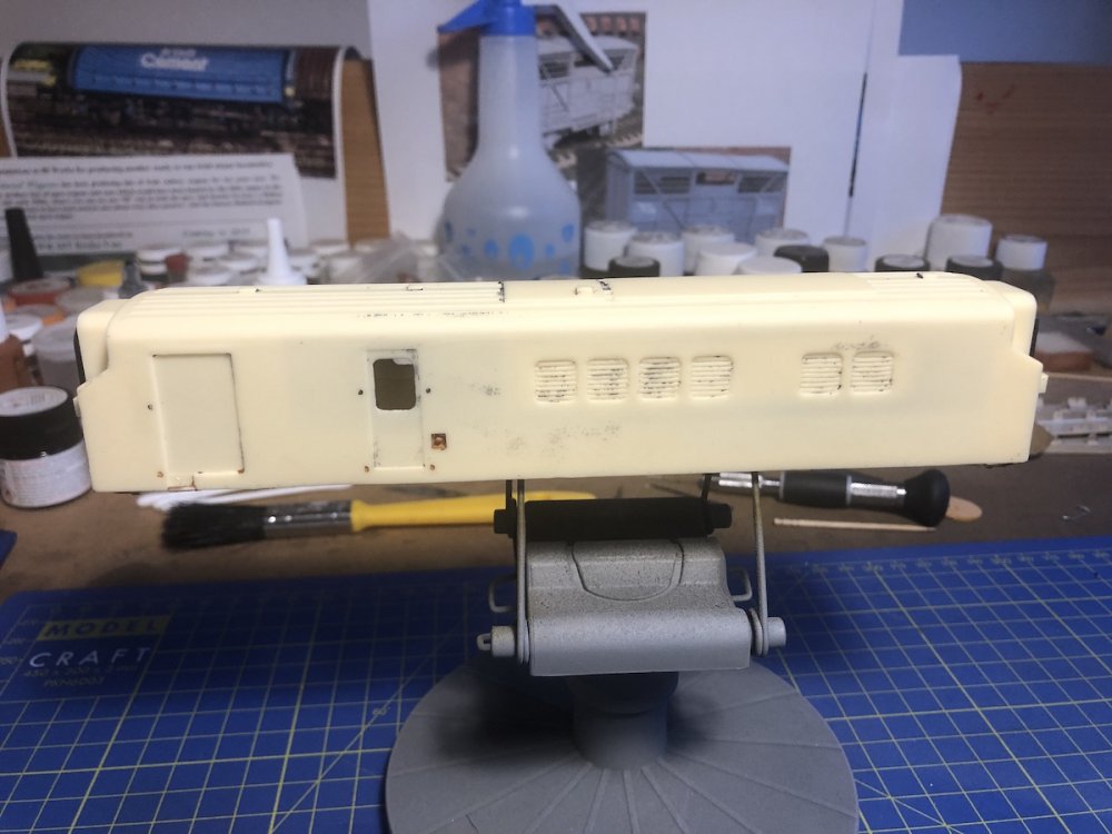

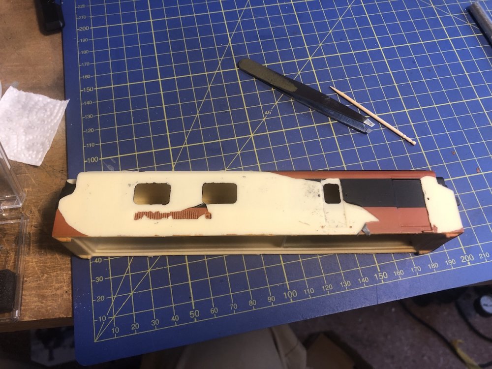

Noel Posted July 21, 2020 Author Posted July 21, 2020 If at first you don't succeed try try again, and learn from any boo-boos. Whoops - I failed to adequately clean the resin body before priming with the result below when removing masking tape. Managed to peel most of the paint off by hand. Removed the first paint job, It actually peeled off by hand and finger nail scratching, brake fluid was not required. Then resin body thoruughly washed down using IPA to remove any trance of release agent on the body, then warm soapy water, then primed again using HyCote. Volla - Masking tape removed without incident. The primer had bonded with the resin body properly. Ready now for white lining and final decoration. 3 Quote

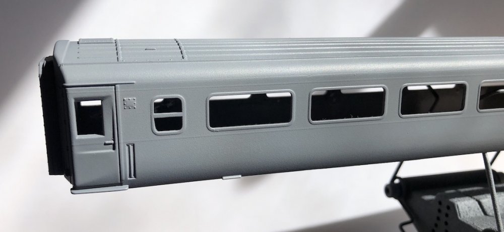

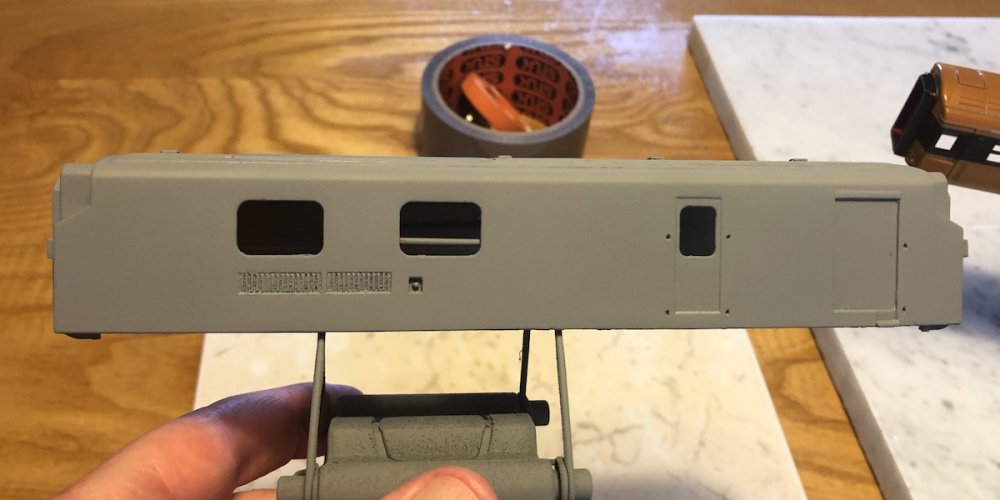

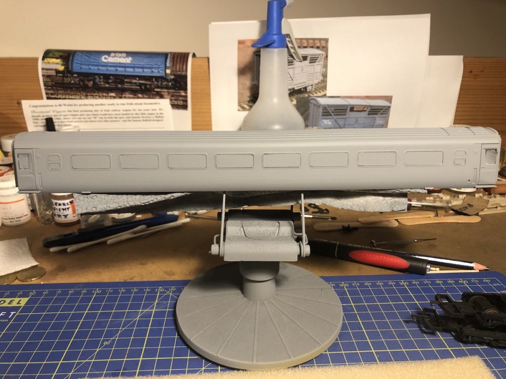

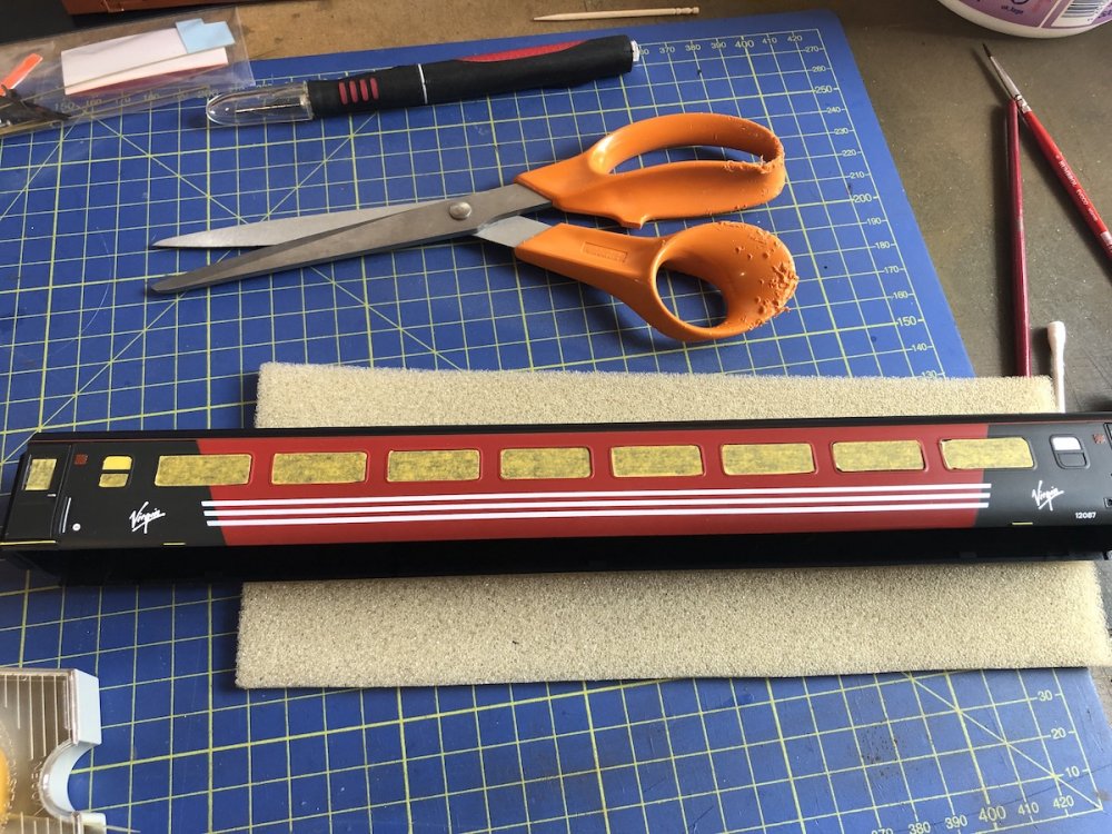

Noel Posted July 31, 2020 Author Posted July 31, 2020 Another mk3 donor bites the dust. Could not get the window glazing out this time so had to resort to tedious masking. Avoided the hideous maskol route, dreadful stuff. Primed with Hycote plastic grey primer ready for reverse masking It kind of gets addictive after a while 1 Quote

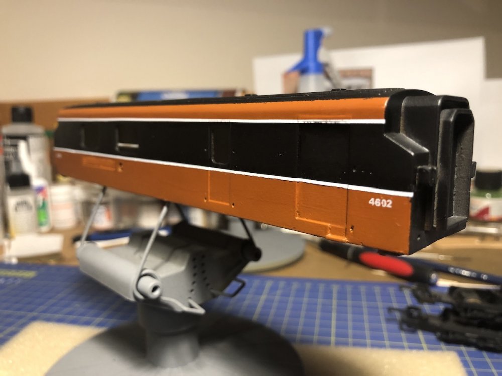

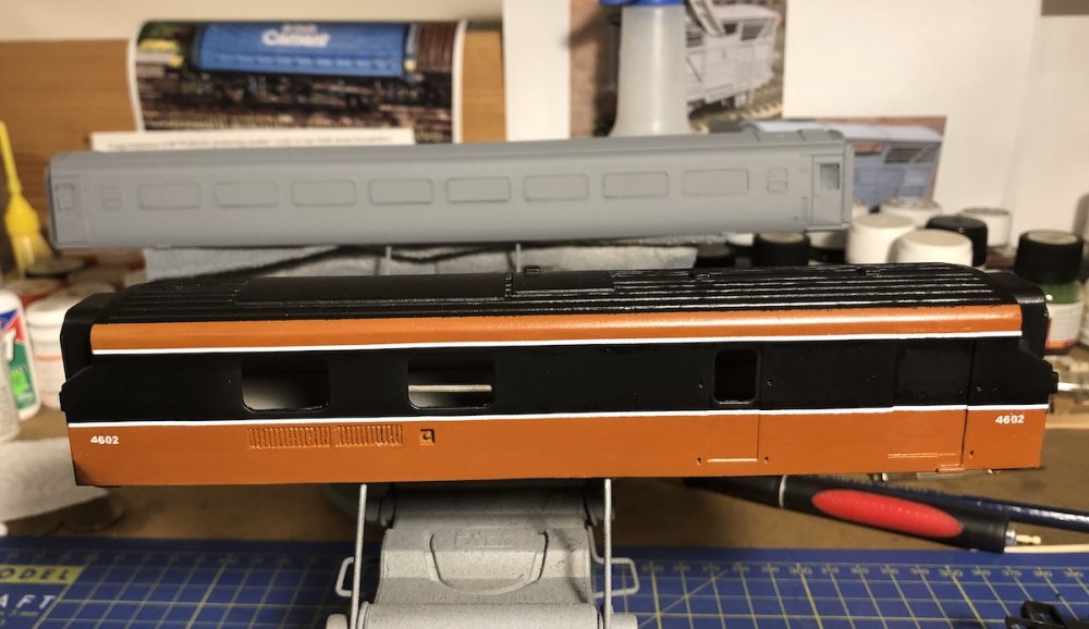

Noel Posted July 31, 2020 Author Posted July 31, 2020 Redemption for the rebuilt Dutch GSV kit from IFM, after the great peeling primer disaster of two weeks ago. Had a second go at this, first time using waterslide transfers instead of reverse masking and airbrush for white stripes. The first attempt two weeks ago didn't end well (below). Lesson learned clean resin bodies properly using unspent nuclear fuel if necessary to ensure no resin release agent residue, and never give up. There's always a recovery route. When this is finished have two IFM Park Royal kits to start. Not so long ago I was RTR man, now finding doodling with kits addictive and therapeutic. 5 Quote
skinner75 Posted July 31, 2020 Posted July 31, 2020 Cracking job Noel! Certainly a cautionary tale for anyone having a go at painting a resin body for the first time. The transfers for the white 'tippex' lines sure do work great for giving a nice crisp line alright 1 Quote
Noel Posted July 31, 2020 Author Posted July 31, 2020 3 minutes ago, skinner75 said: Cracking job Noel! Certainly a cautionary tale for anyone having a go at painting a resin body for the first time. The transfers for the white 'tippex' lines sure do work great for giving a nice crisp line alright Cheers Skinner. I think in future I may still lean towards reverse masking. I cannot abide wavy lines nor wavy stripes. Enjoyed this kit, just grab rails, glazing and some decoration to do. Quote
