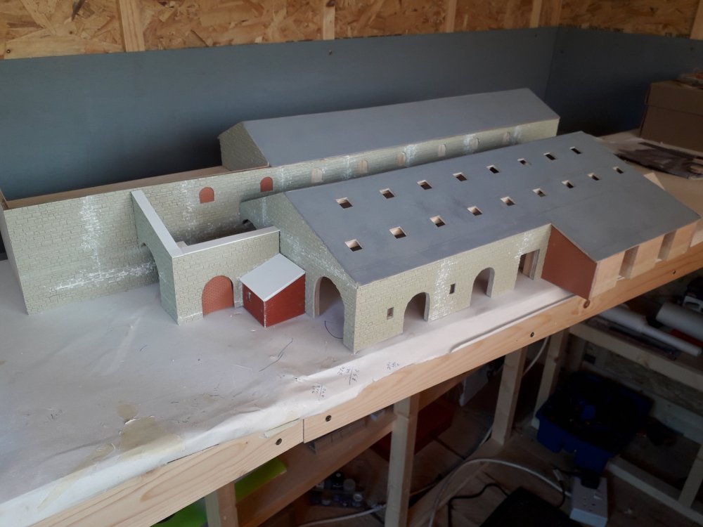

GNRi1959 Posted April 7, 2019 Author Posted April 7, 2019 (edited) Some brick openings and quoins added this morning..... Edited April 7, 2019 by GNRi1959 4 1

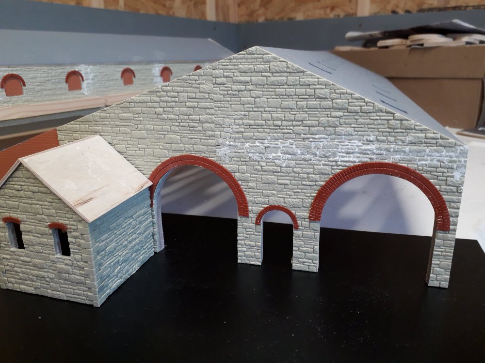

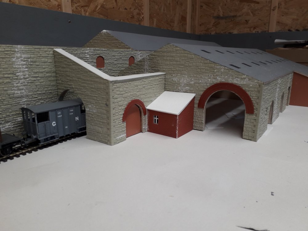

GNRi1959 Posted April 7, 2019 Author Posted April 7, 2019 Something worth noting if you are planning on using Wills Red Brick headers over arches. Although Omagh had three brick headers over all arch openings, Wills brick headers appear to be over-sized and look out of place. Acting quickly before my adhesive totally set, I removed these headers and reduced them to two brick headers, as can be seen below. Â 11 1

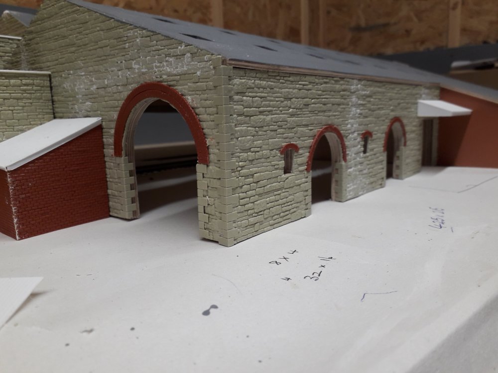

GNRi1959 Posted April 12, 2019 Author Posted April 12, 2019 Little by little, the front arches and goods office entrance 4

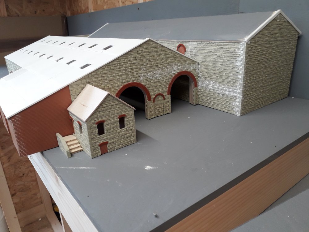

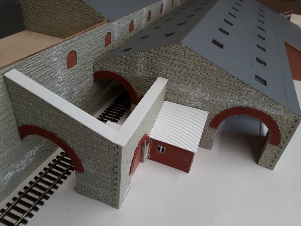

GNRi1959 Posted April 14, 2019 Author Posted April 14, 2019 Some progress to front of building..... 6

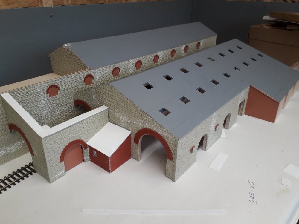

GNRi1959 Posted April 17, 2019 Author Posted April 17, 2019 Here's the goods store office. Primed the fascia boards and ready to fit door and window frames 5

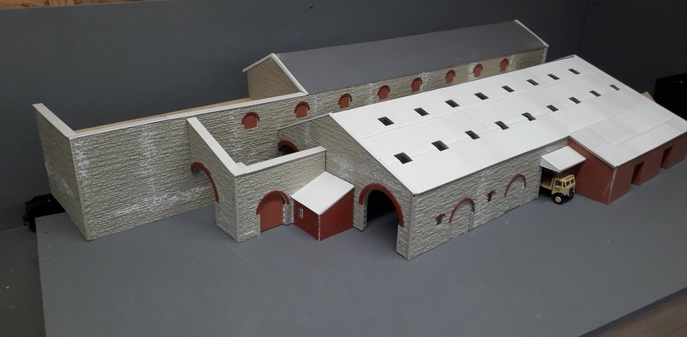

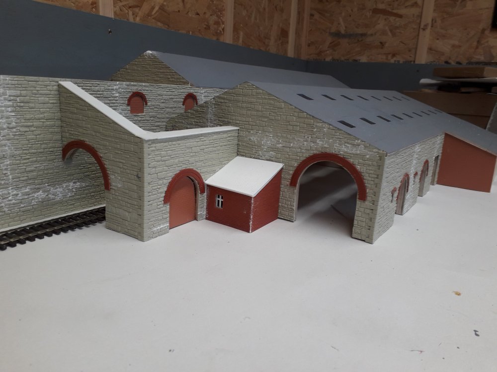

GNRi1959 Posted April 18, 2019 Author Posted April 18, 2019 Took a step back today and primed the entire build with Halfords grey primer. The enamels were not taking to the plasticard very well. 1

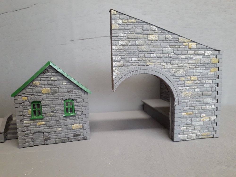

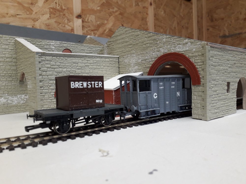

GNRi1959 Posted April 24, 2019 Author Posted April 24, 2019 First efforts to paint exterior stone..... 6
