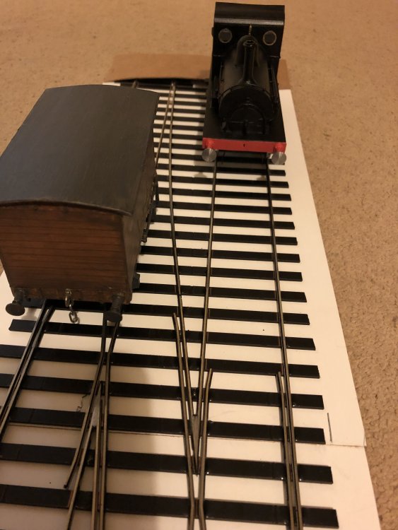

Galteemore Posted March 19, 2019 Posted March 19, 2019 (edited) Just starting my layout thread! Baseboards are inbound and my hand built pointwork has arrived. So time to post something I thought.... Like all right minded people I have long loved the SLNCR and its environs. My mother went to school on it, my grandfather sent his freshly caught fish to Dublin on it, and my cousins to this day farm beside the trackbed. So my layout is a might have been SLNC/MGWR joint branch from Sligo to Rosses Point. The line was built just as Atock’s rebuilt 2-2-2 tanks were falling into redundancy and one found a home - where it still is. The terminus ante quem for the layout is of course 30 Sep 1957....and the history of various Irish lines has been blended together to produce the end result. So expect bits and pieces from Timoleague, Tramore et al. CIE provide the stock but the odd SLNC train may appear..., Some philosophy and poetry before the first photos though ...some lines from Louis MacNeice..... Why do we like being Irish? Partly because It gives us a hold on the sentimental English As members of a world that never was, Baptised with fairy water; And partly because Ireland is small enough To be still thought of with a family feeling, And because the waves are rough That split her from a more commercial culture; And because one feels that here at least one can Do local work which is not at the world's mercy And that on this tiny stage with luck a man Might see the end of one particular action. This extract sums up two things about the layout. First of all it’s nostalgic. This is Dev and Costello’s Ireland with all the bad bits taken out. The sun is shining and steam reigns supreme. Baptised with fairy water indeed. Secondly, the layout will be tiny - 6’ by 2’. Hence the reference to a ‘tiny stage’ that ‘might see the end of one particular action’. In other words I might finish it! Trial run tonight of the new crossover which will be at the heart of the station -built to 36.75mm gauge. You may also glimpse an MGWR carriage chassis.. Early days yet but putting a marker down so I will be posting from time to time! Edited March 19, 2019 by Galteemore 5 Quote

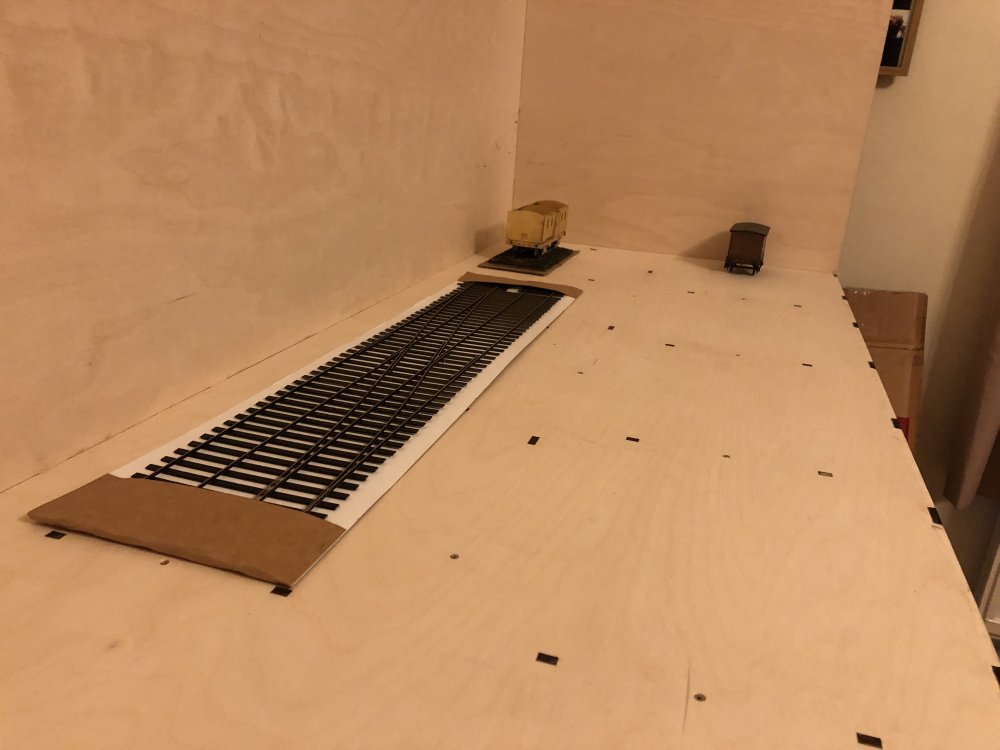

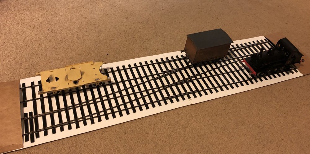

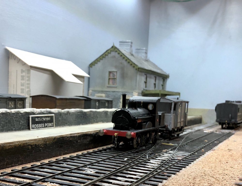

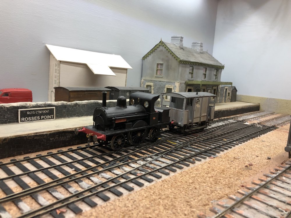

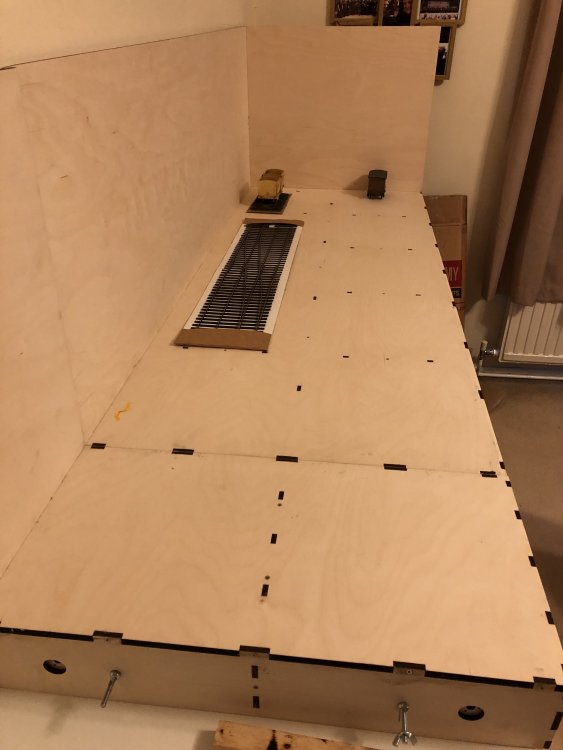

Galteemore Posted March 25, 2019 Author Posted March 25, 2019 (edited) Took the plunge last night and built the baseboards. The camera is sited where the traverser or similar will be. Only track I have right now is the crossover - which is placed roughly where it will eventually go. The coach is standing on the loco release headshunt whilst the van is resting at the prospective goods store. There will hopefully be a stock stabling siding in between - for all the excursion traffic which never appeared... In 7mm terms this is not a big layout. But look at http://yourmodelrailway.net/view_topic.php?id=9636&forum_id=21&highlight=luxted to see what’s possible in such a space. Won’t be much progress for a while I suspect due to a variety of other things going on but I want to get this moving now.. Edited March 25, 2019 by Galteemore 2 Quote
David Holman Posted March 25, 2019 Posted March 25, 2019 36.75mm gauge! What's not to like? These modern, laser cut baseboards have a lot going for them too. By the by, a question posed by Richard Chown back in MRJ several years ago was ' how many locos were called Galtee More?' I can think of two - the WLW 2-4-0 and an S class 4-4-0. Am guessing folk here will know of others... Quote

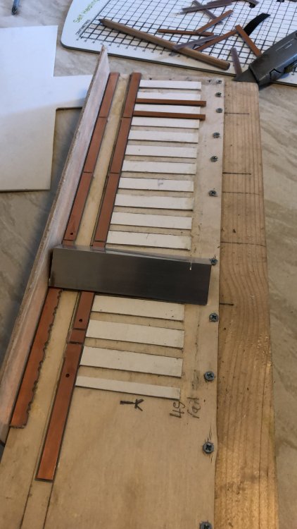

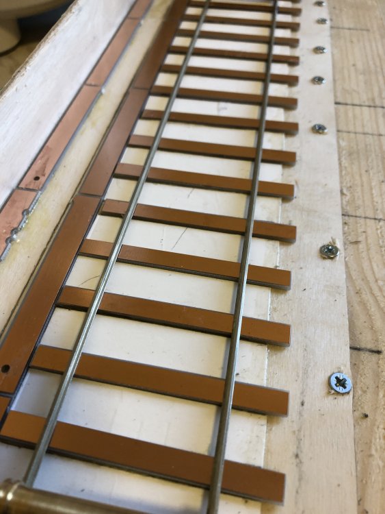

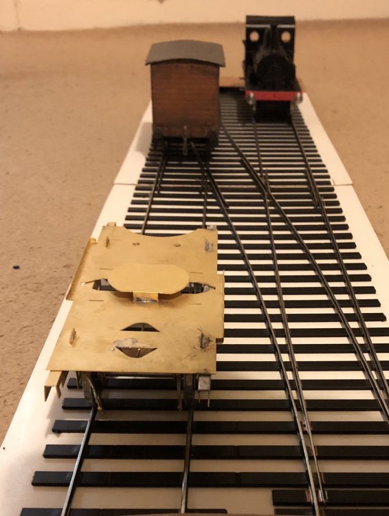

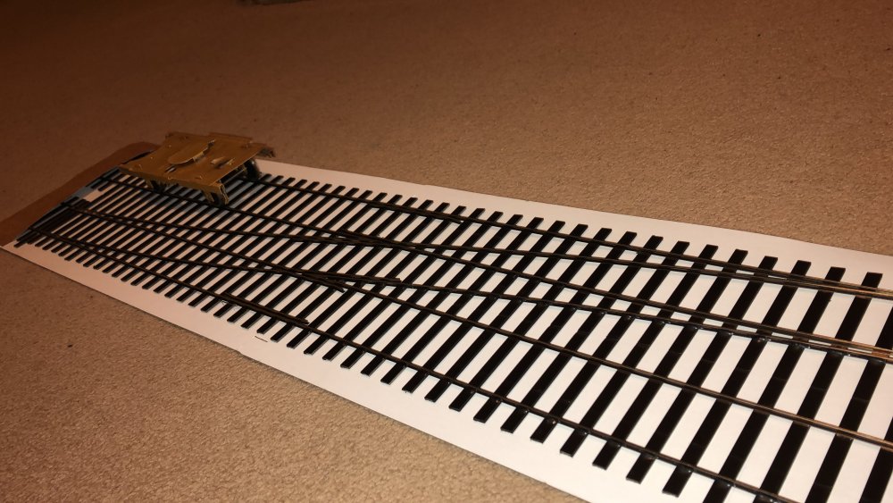

Galteemore Posted May 26, 2019 Author Posted May 26, 2019 Thought I’d better do an update. Baseboards finally painted. And I’ve built a tracklaying jig - almost ready for work. Not exactly Bretland’s system but hey?! First mock-up looks ok I think.... 5 2 Quote

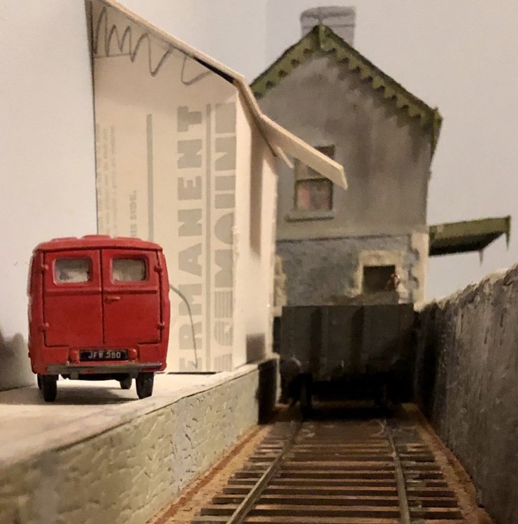

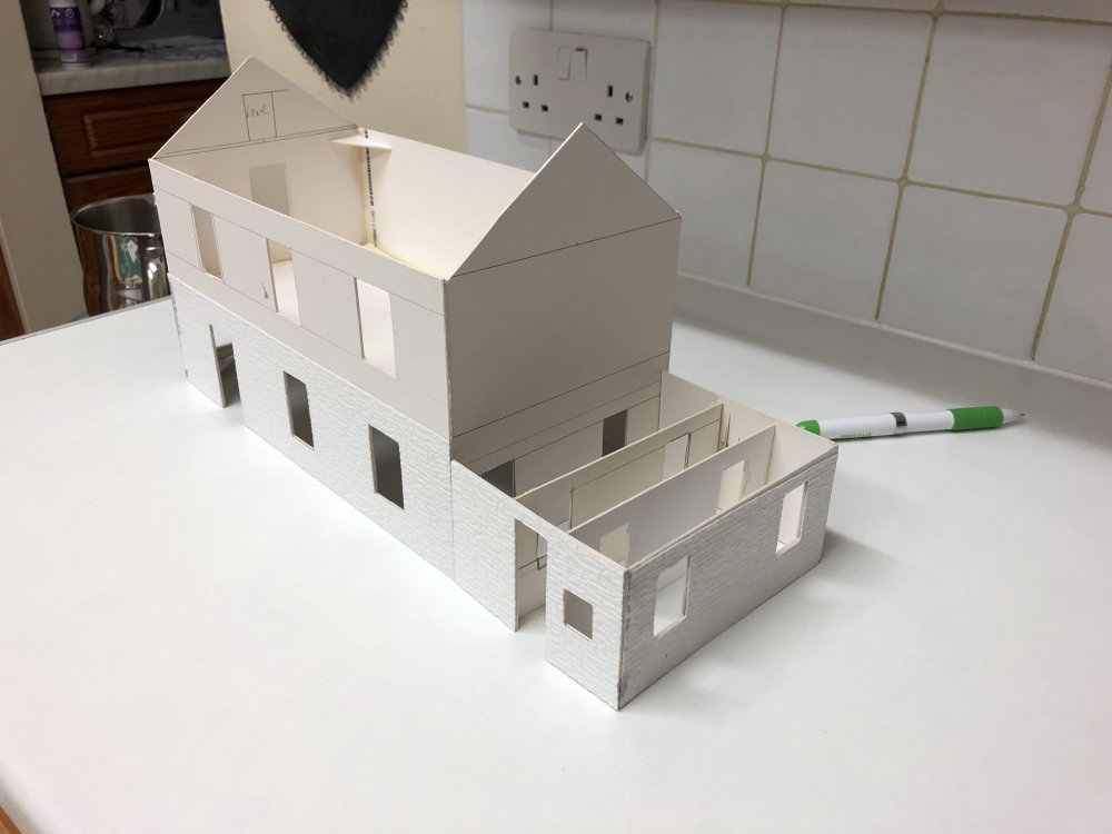

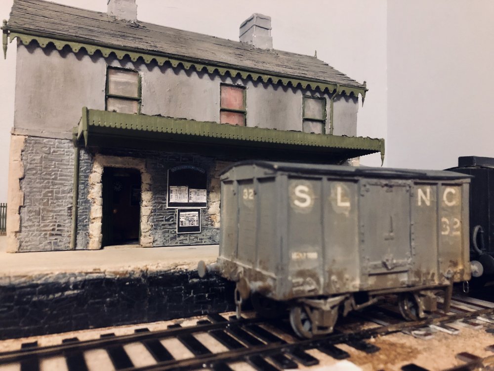

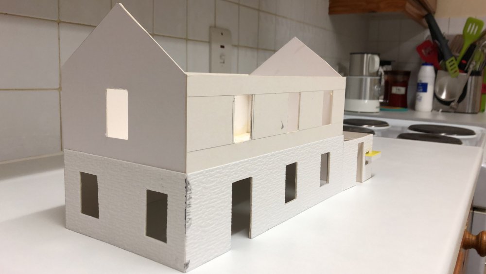

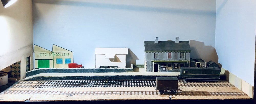

Galteemore Posted July 11, 2019 Author Posted July 11, 2019 (edited) Some basic steps in station building...usual modus operandi - Alphagraphix kit as the inspiration. This time using single storey Florencecourt card kit as a source for two storey Dromahair .... you’ll notice the back wall is completely featureless. That’s because it will be invisible on the layout - a John Ahern idea I think..no point modelling it if you can’t see it Edited July 11, 2019 by Galteemore 13 Quote
Angus Posted July 12, 2019 Posted July 12, 2019 I have the same structure to build in 2mm scale so I'm looking forward to watching progress. Was the Florencecourt station building a similar footprint? Quote
Galteemore Posted July 12, 2019 Author Posted July 12, 2019 (edited) Thanks Angus - you’ll hopefully learn from my mistakes! From what I can see, Florencecourt and Dromahair were initially identical buildings in layout. Dromahair had a second floor added at some point. The courtyard area at the end seems to have gone through various iterations and was mostly demolished by 1957. The likeness between the buildings is not overly obvious at first as Florencecourt was largely rendered whilst Dromahair kept the bare stone at ground floor level. The canopies are also slightly different. For my purposes, Dromahair is a more useful prototype hence this effort.Not to mention that Dromahair was my family railhead ! Edited July 12, 2019 by Galteemore 1 Quote
leslie10646 Posted July 12, 2019 Posted July 12, 2019 Back to the A3, for a moment. You are dead right, Mr Holman, an A3 with Witte deflectors is really the job! Now, to the other David's comment on not bothering with what no-one will see (Mr Ahearn's famous layout is at Pendon, less than ten miles from where I am). I always thought that you could save a lot of effort with wagons for the same reason - you only ever see one side on most layouts. It does mean that if you're building a wagon from a kit and one side's better than the other - turn it round (or by numbering the other side differently - two wagons for the price of one!!!!) 3 Quote

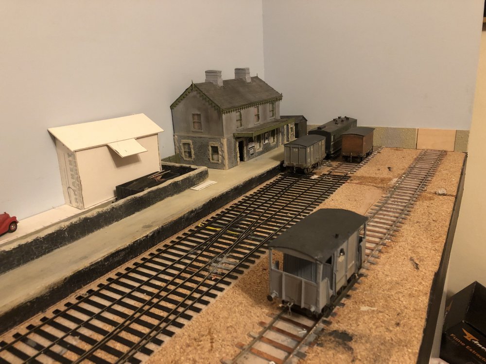

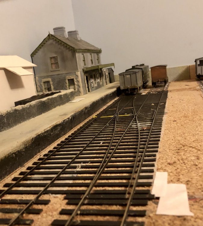

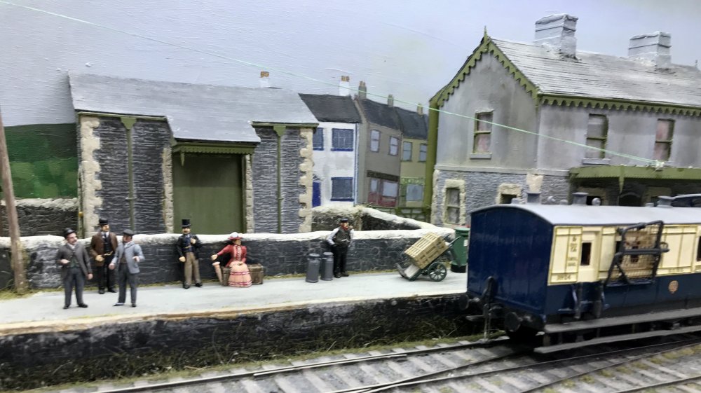

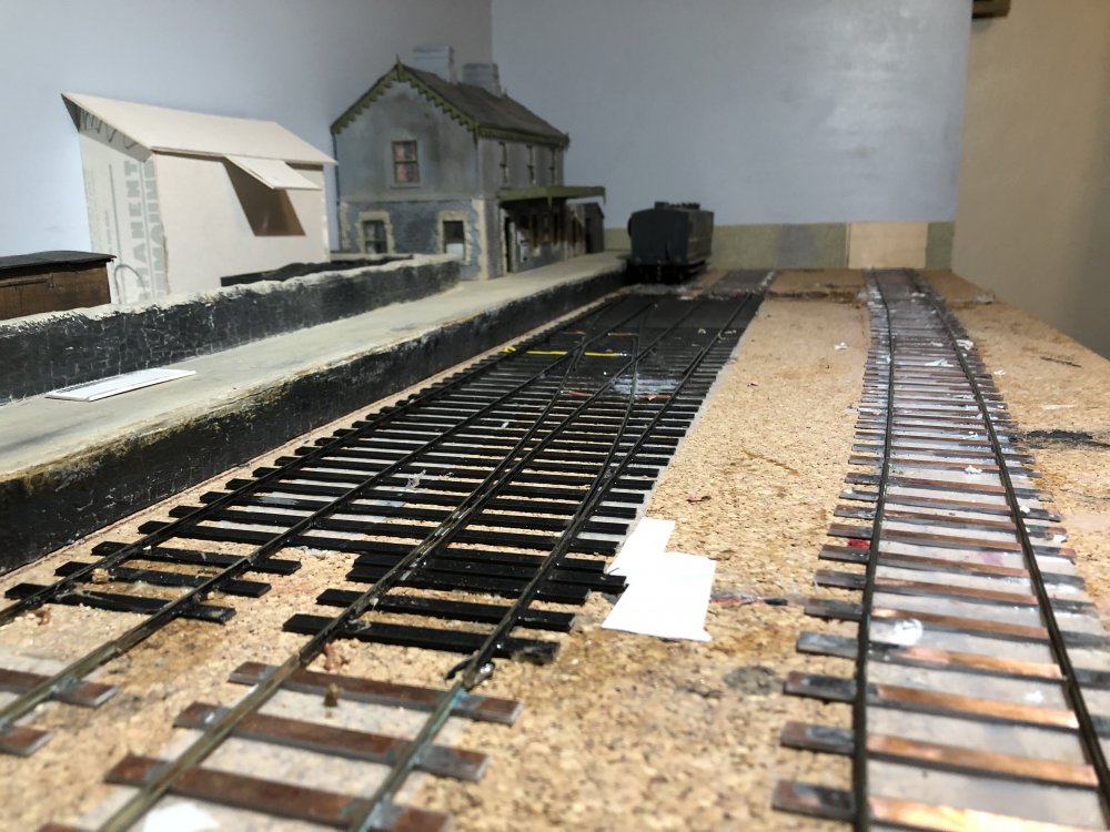

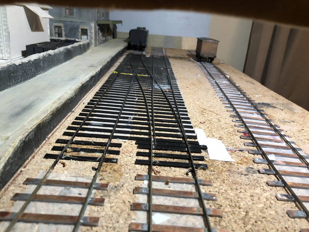

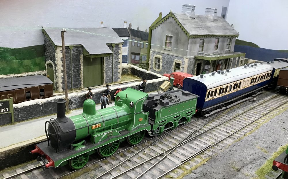

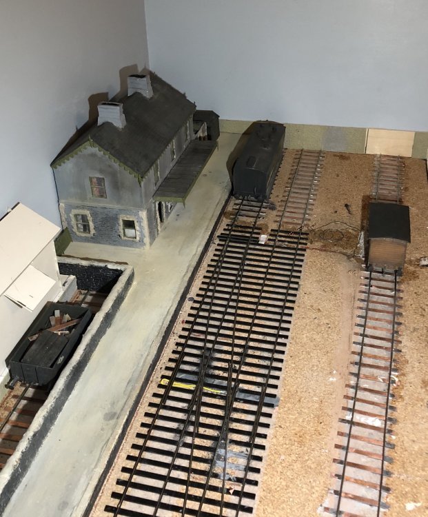

Galteemore Posted November 16, 2019 Author Posted November 16, 2019 (edited) Frantic day of progress at Rosses Point. Track laid after much deliberation. Needs wired up next. Basic design inspired by this http://yourmodelrailway.net/view_topic.php?id=9636&forum_id=21&highlight=luxted - but with an Irish twist. From back of layout to front, goods bay, main running lines, and harbour branch...note gap in wall where gate will go. The branch beyond the gate down to the harbour is conveniently derelict by 1957 ! I was originally going to make all the track parallel to the baseboard edge but having read wiser counsels, the quay branch has a slight but pleasing undulation. Edited November 17, 2019 by Galteemore 9 2 Quote
David Holman Posted November 17, 2019 Posted November 17, 2019 Has all the makings of a fine cameo, not least because the photos make it look much bigger than it really is. It also has real atmosphere, because the track and buildings say Ireland, even without the stock. Nice one! 1 Quote

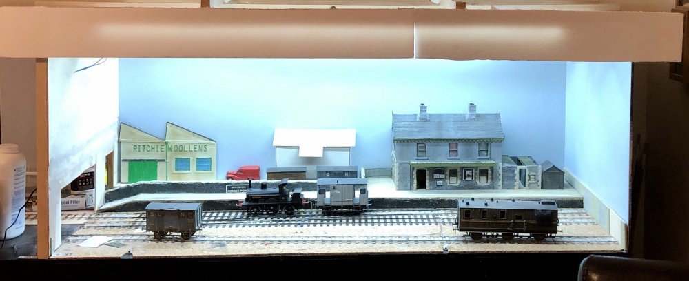

Galteemore Posted November 17, 2019 Author Posted November 17, 2019 (edited) Thanks everyone! Much help has come from this forum. Tonight I made a basic ladder frame to sit on top of the baseboard as an LED canopy with a temporary foam core pelmet. Reminds me of a fish tank but it’s lovely having a constant light on the stage ... Edited November 18, 2019 by Galteemore 8 Quote
Angus Posted November 18, 2019 Posted November 18, 2019 Hi Galteemore That lighting really gives a lift to the scene. Did you mix LEDs or just use one type? Quote
Galteemore Posted November 18, 2019 Author Posted November 18, 2019 (edited) Thanks Angus. It’s one roll of Amazon-sourced cool white LEDs, cut into three strips with wire jumper leads connecting them. They have a built in dimmer switch. These are they.... Edited November 18, 2019 by Galteemore 1 Quote

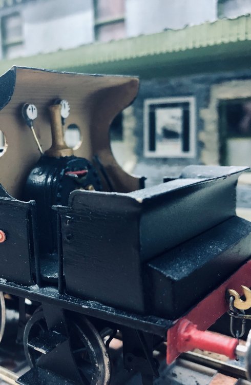

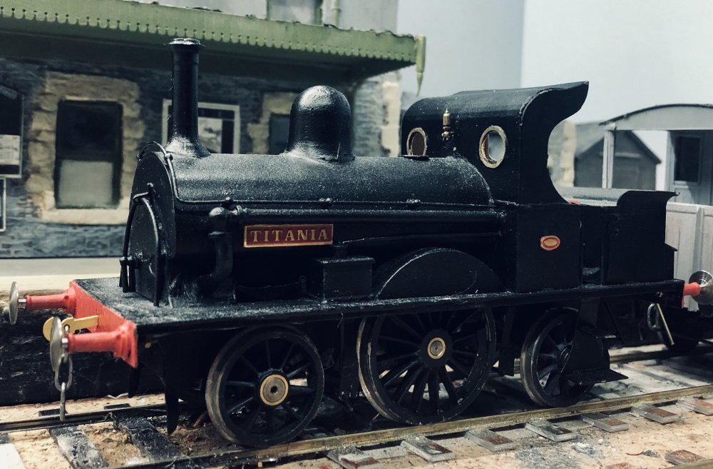

David Holman Posted November 24, 2019 Posted November 24, 2019 The little film is great fun and the loco runs well too. Did I detect a bit of gear whine? If so, is the 'box well oiled? That, along with more running in, usually cures it. Quote
Galteemore Posted November 24, 2019 Author Posted November 24, 2019 Thanks David. A Boyd cine movie I saw years ago, of a Donegal 2-6-4T shunting at Stranorlar set to that music, has always lingered in my mind so it was fun to imitate! The loco is the first one I have ever built so it’s a bit of a learning curve. Getting the single wheel chassis to balance was especially ‘educational ‘. I did wonder if it was a little noisy. I shall apply a little lube and let her spin for a while. 1 Quote
