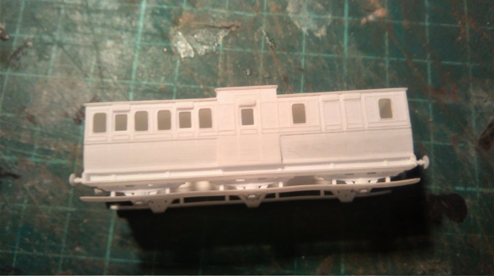

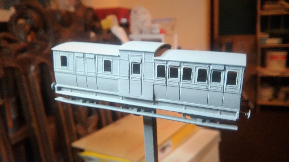

As I was placing an order with Shapeways I also took the plunge and bought the MGWR brake 3rd carraige that has been the subject of some discussion in another topic on this site.
Buying it lessened the pain of Shapeways postage costs.
As it arrived:-
In this form the plastic is quite soft and there is still some of the support wax present. Following advice of others (I had done this before) I scrubbed the surface with a toothbrush and washing up liquid before dunking the body in a bath of white spirit for an hour. Left overnight the body turns white. It is now quite hard and easier to sand. You can also see the surface clearly to work on.
The body appears dimensionally correct and captures the lines of the carriage well the buffers seem a bit over scale (a scale 18" across the face) but easily replaced with some turned ones from N-Brass.
As I feared though the surface striation is quite bad.
1885950432_MGWRbrakethirdsides.thumb.jpg.a5c4c14edcecc1e186a0534ca7052108.jpg260370378_MGWRbrakethirdroof.thumb.jpg.ed439fb0d7085bb5d0e96c4f06da34b7.jpg
Without care I'll be losing a lot of the side detail. The doors will need re-scribing at the very least. Please bare in mind this is 2mm scale, in larger scale the striation will appear less worse.

Hate to say it the striation is just as bad in 4mm i've got one sitting on the workbench at the moment a good argument for etched brass i'm afraidespecially as its sharing the workbench with a rake of Worsley DNGR 6 wheelers.Andy.
Although I dislike making negative comments, I have to concur.
This particular manufacturer has many items listed that I would be most interested in. However, a couple of years ago I ordered some narrow gauge War Department Class D bogie wagons for an Ashover Light Railway layout project. The models when they arrived were terribly striated and the surface details were very poorly defined.
Unfortunately, this supplier's models seem to only be available in one single type of material, which I've been informed isn't ideal for fine detail, and so I've made a conscious decision to not order from him again.
Kind regards,
Mark

After about three hours of careful sanding last night, mostly using a toothpick which was surprisingly effective, I was left with this
Whilst not perfect it is a lot better than when it arrived.
After re-scribing the doors and  a blast of primer:
All in all I'm fairly happy. I might have a last go at smoothing out if the mood takes me. Please bare in mind the carriage is 2mm scale so reproduced here at lest a couple of times bigger than actual.

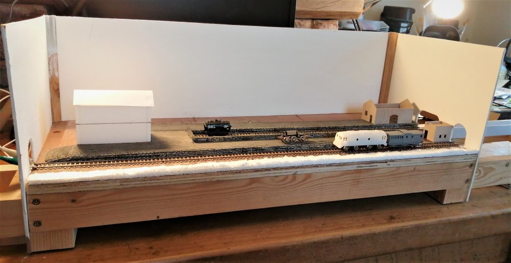

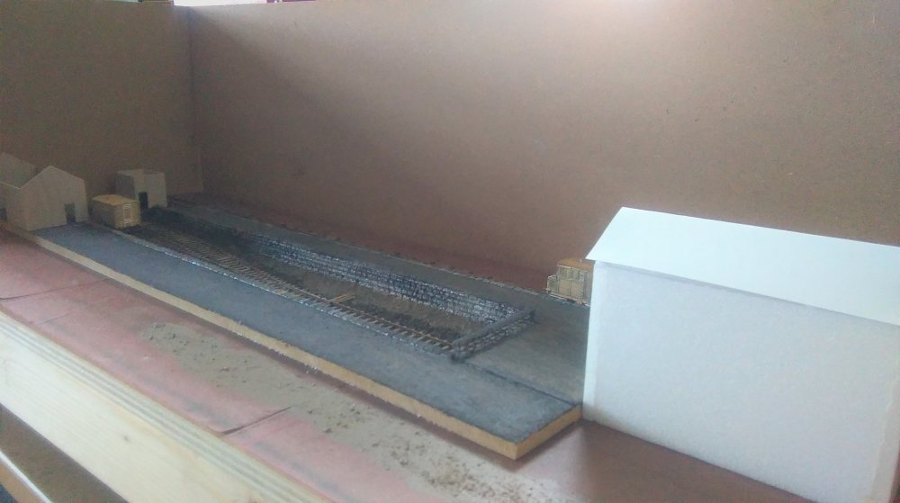

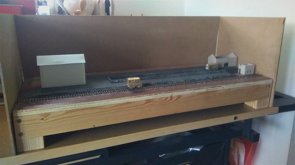

I had a play around with the backscene for the layout today.
The original intention was the layout would be viewed from the rear of the station with the station building, goods shed and signal box all acting as view blockers for the fiddle yard exits.
This works (apologies for the poor photos the sun was coming in the window behind)
This has the disadvantage of not being able to see the wheels of any stock as the platforms prevent this.
Up to now I have been presenting the layout in the more traditional front view.
Obviously here there is no view blocker  for the fiddle yard exits from the mainline, there is also a bank in front of the station that might look a bit odd in this view.
Still not convinced which is better though, any opinions out there?

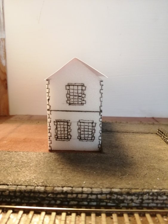

The mock up of the station building is scaled from various photos, it looks way too tall but I've double checked the measurements, if the is an error it is only a mm or so.
I'll need to draw on the windows and dividing line between the stone lower and rendered upper floor to see if breaking up the surface change the appearance.
Looking good Angus. Traditional it may be but the front view offers a bit more scope for detailing - as you know, the area under the canopy at Dromahair is rather rich in poster boards, barrows and scales. Unlike Manorhamilton and Glenfarne, the ‘street frontage’ at Dromahair is most uninspiring as it was basically the back of a rather plain house - no elaborate door, canopy or such - photo taken last summer. The level crossing etc at the Ballygawley end might offer some scope for trompe l’oeil distractions. At the Lisgorman end, a telegraph pole and some verdancy might serve...
Edited by Galteemore
As Galteemore says better scope for details, maybe use half cut trees as  view blocks to the sides, also you could have the trees come out over the front of the baseboard and even wrap around over the edge of the side back-scene board?
Looking good
Eoin
Hopefully the station house looks bigger because it is so stark, so a bit of work with felt pens or crayons should soften it. If not, as Eoin and David suggest, trees should help balance the scene. Ideally similar height objects at either end will balance the view. Current thinking favours curved corners to the backscene, though again, trees or buildings can hide these. Presumably, there will be a fascia to help hide the holes in the sky?
 Great to get an insight into the overall project too.

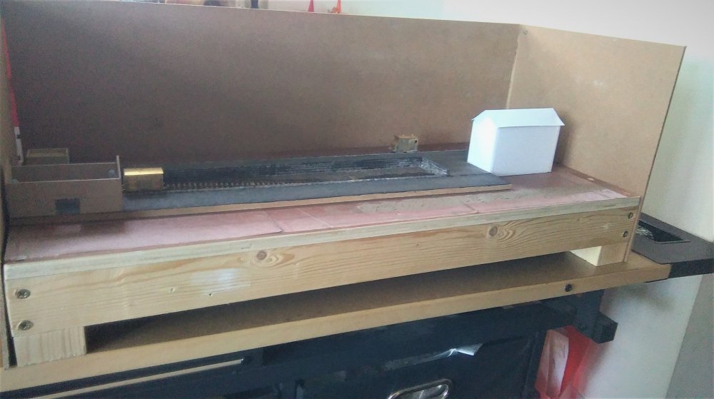

The backscene is in position but needs the corners filling in, ultimately integral lighting will be added, I'm still working this out.
The platform facing was also catching on passing stock as there was insufficient clearance, the facing was carefully cut off, thinned down by sanding back then re-glued back on.
All is good.

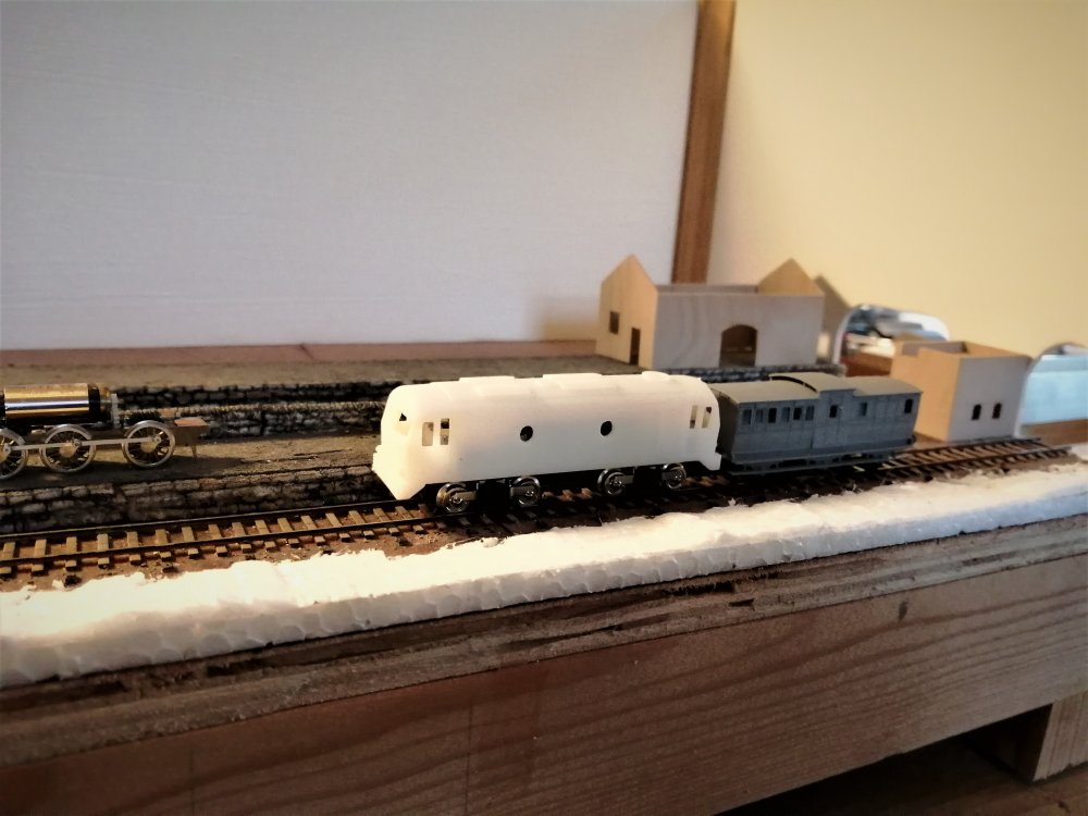

The C class is a 3D print that was amongst the items gifted to me. I've bought a Tomix chassis that is very nearly scale. (Bogies are correct but the centres are slightly too close together). For the moment I've simply pushed the wheels out to match the gauge, obviously this won't run through pointwork but it was fun to connect up some power and have the loco run along the front of the module.
Testing clearances.....obviously!
Who would have thought the first loco through Dromahair would be a diesel?
The body print is quite nice, although it will need a bit of work to add some detail but should be fun. Although out period I've always had a soft spot for the little diesels.

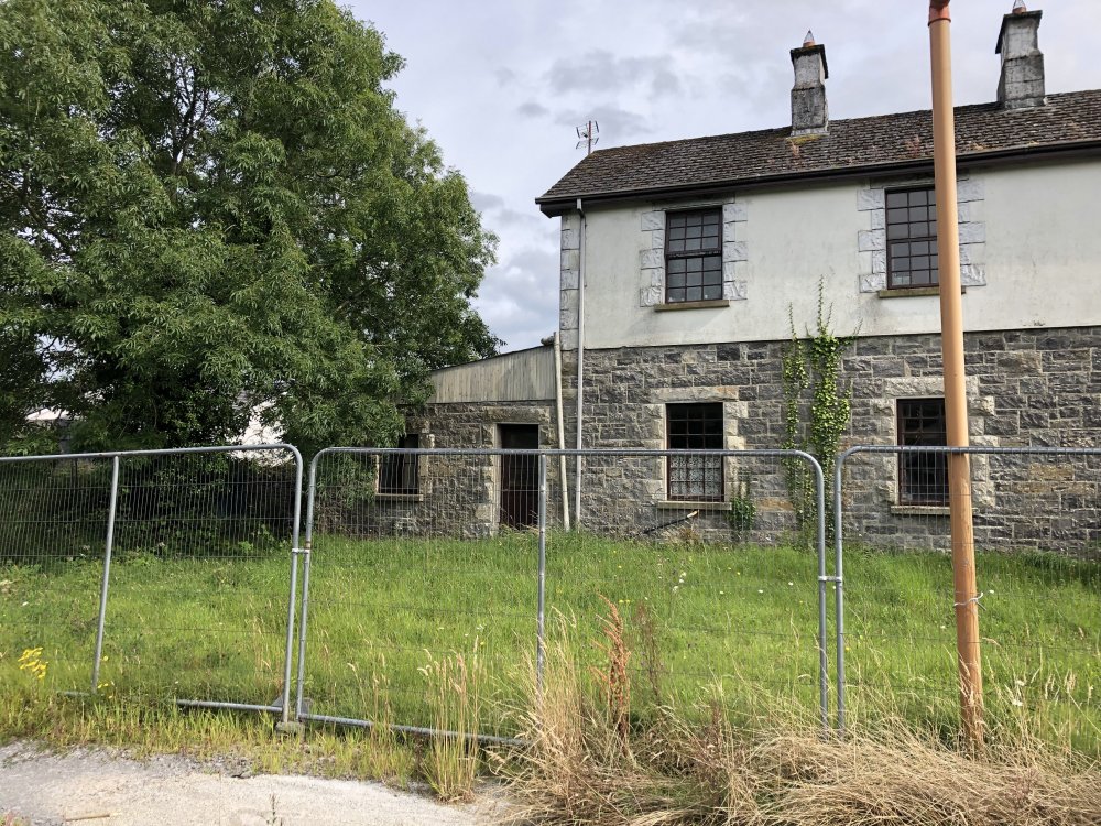

I had previously posted some concerns regarding the station building dimensions so I set to work with some pens. once the windows are sketched on it is amazing how it all seems to come back into proportion.
Edited by Angus

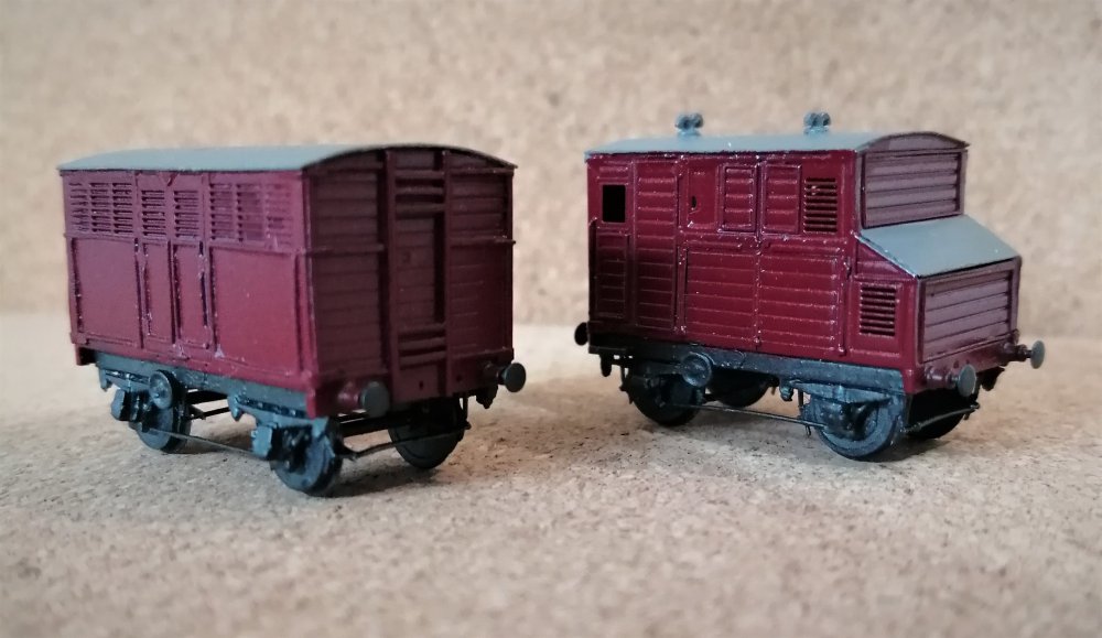

A bit of progress is being made on finishing some stock already built.
These MGWR vans attracted a bit of attention when first built.
Inspired by David Holman's recent MGWR mail train build I've decide to finish them in pre-GSR colours. This probably means I'll have to backdate the layout to early GSR days at the least. It would give me the opportunity to run a mix of liveries although the thought of lining out a loco in 2mm does bring on a cold sweat!
I've just realised I've painted the solebars underframe colour as a steel underframe rather than body colour for a wooden underframe. I'll correct that.
A couple of questions to the audience, is the body colour correct? I believe it should be slightly darker than LMS maroon for late period MGWR which I've tried to capture?
In the UK the wooden centres of the Mansell wheels were sometimes varnished or even painted (on the LNWR newly constructed coaches had varnished centres that were then painted the body lake colour at the first re-paint). Does anyone know what the MGWR practise was? Accepting, of course, being low to the ground the wheel centres would be covered in crud in ordinary operation!

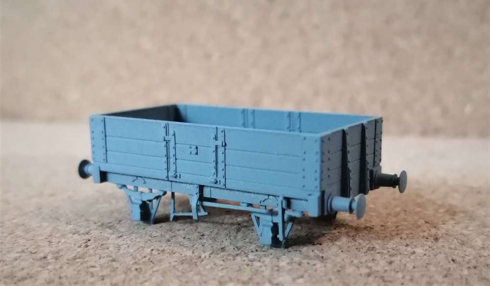

I made reference to being gifted some models from a fellow 2mm scale association member. This included what is described as a CB&SC open wagon.
The body is scratch built from styrene and is rather exquisite (please bear in mind this is 2mm scale so the body is only 30mm long)
I can't find any details of the wagon (the CB&SCR doesn't appear in my library as it's a bit far south). The wagon scales at 15' in the body with a 9' wheelbase. Also I can't find any CB&SC wagon livery details either, I could always cop out and paint it GSR grey, in which case the undercoat will suffice! I'd be appreciative if anyone can fill in in any of the gaps?

That is incredible workmanship all round. These are exquisite. What thickness are the sides of the open, Angus?
Just been looking back at the 5p pictures to remind myself how tiny these wagons are. Little jewels!
 The two Dublin and Meath brake vans I got from Richard Chown have their wheel centres in varnished wood,meanwhile, am sure it won't be long before our livery guru can advise.
 Going back to the horse box, when you think how small it is, the smallest error will throw the shape of it completely, which only goes to show what a fine model it is.
 Keep 'em coming Angus!
Hi Galteemore, the wagon has 20thou sides, so 0.5mm or scale 3" thick.
For 2mm gauge, these vehicles - all of them - are quite simply the very best modelling in that scale that I have EVER seen. That pic would do credit to 0 gauge!
The undercoat colour you have would indeed suffice, though it's lighter than the grey used. If you weather it badly - which would be absolutely prototypical - it'll match perfectly!
As to the horse boxes - the chassis is fine. Horse boxes and carriage trucks were very usually painted by most Irish railway companies in passenger livery, hence MGWR ones were brown initially. After 1918 they were maroon, and from what I understand, it would fade quite quickly to match exactly what you have. So, the above is correct either for 1918-25 MGWR livery, OR GSR livery.
Chassis would be black, as these were in passenger livery. The general rule for most irish companies is - goods livery has chassis same colour as body and ironwork; passenger livery has black chassis.
So that horse box is fine as it is. SOME horse boxes could be wagon grey in CIE days, but most seemed to have passenger livery. (Laterally this meant exceptionally badly worn, bleached and faded remains of CIE green - and some grey).
While it was conventional to paint horse boxes in passenger livery, this was usually without any lining! So you're safe on that front! Just lettering and number; in the case of both the MGWR and GSR, a gold-yellow colour, shaded. I think I've seen a pic somewhere of one of these with a GSR crest added, but it would not have been typical; maybe a one-off, so you're safe there too!
Because its passenger livery, black chassis / wheels / solebars is correct. If you wanted to have it in wagon livery, obviously the whole thing would be grey.
