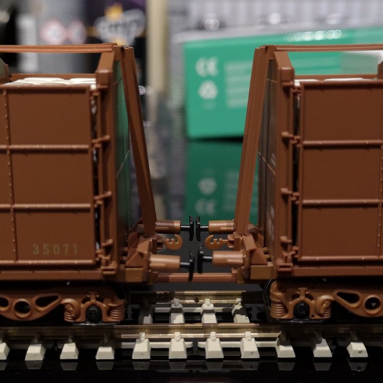

BosKonay Posted February 20, 2020 Posted February 20, 2020 5 hours ago, gm171 kk said: I'm wondering if they'll work with the swivel type couplings that MM and IRM used for Bogie rolling stock. We provide coupling bars with our kinematic stock. These work the same way. Quote

Noel Posted February 20, 2020 Posted February 20, 2020 2 hours ago, BosKonay said: We provide coupling bars with our kinematic stock. These work the same way. Kadee no 18s works a treat with your Taras, Container Flats and the Fertiliser Wagons. Much closer than the tension lock. The kinematic stock really benefits layouts with tighter curves. Quote

WRENNEIRE Posted February 21, 2020 Posted February 21, 2020 Not a fan of the coupling bars provided with the Taras, I think the fine detail on the wagons would suffer if rakes were to be handled while coupled together These Hunt yokes look like a great answer Quote

gm171 kk Posted February 21, 2020 Posted February 21, 2020 (edited) The bar coupling that comes with the Ferts. Nice and close but the kinematic couplings allow too much movement Edited February 21, 2020 by gm171 kk Quote
