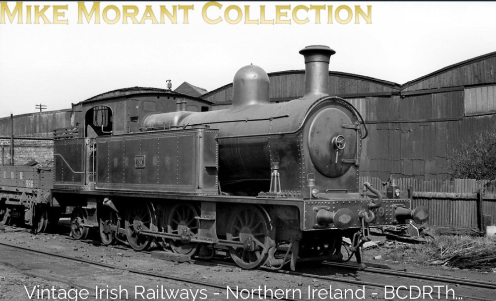

Galteemore Posted November 23, 2021 Posted November 23, 2021 Looks brilliant. Although SLNC and BCDR cabs aren’t always that far apart check out no 29 here which has a very SLNC air, right down to the 0-6-4T arrangement and the jack beside the smokebox! 1
J-Mo Arts Posted November 23, 2021 Author Posted November 23, 2021 (edited) 4 hours ago, Galteemore said: Looks brilliant. Although SLNC and BCDR cabs aren’t always that far apart check out no 29 here which has a very SLNC air, right down to the 0-6-4T arrangement and the jack beside the smokebox! I wonder if it was inspired by success of the SLNCR locos... Edited November 23, 2021 by J-Mo Arts 1
Galteemore Posted November 23, 2021 Posted November 23, 2021 (edited) Nice thought! Des Coakham’s view was that it was one of the most interesting engines on the line. He felt that the inspiration came from the GNRI RT tanks which visited Queens Quay. The external styling though is very SLNC-like ! In a nice little circle of history, of course, 2 SLNC 0-6-4Ts worked on the Belfast dock lines just after 29 was withdrawn- a real pity they were never seen together. Edited November 23, 2021 by Galteemore 1 1
J-Mo Arts Posted November 23, 2021 Author Posted November 23, 2021 30 minutes ago, Galteemore said: Nice thought! Des Coakham’s view was that it was one of the most interesting engines on the line. He felt that the inspiration came from the GNRI RT tanks which visited Queens Quay. The external styling though is very SLNC-like ! In a nice little circle of history, of course, 2 SLNC 0-6-4Ts worked on the Belfast dock lines just after 29 was withdrawn- a real pity they were never seen together. Those are nice engines too. I really like some of the GNRI tank engines, perhaps once I've cleared my mile-long narrow gauge and BCDR to-do list one will form on my workbench. Was there ever a 'handing over' of passenger or goods trains between the BCDR and the GNRi? For example a train to Bangor from Armagh or vice versa. That would make a nice tie between any GNRi and BCDR stock I make.
Galteemore Posted November 23, 2021 Posted November 23, 2021 There was an end on junction between the two systems at Castlewellan, and trains from both could be seen in each other’s company between there and Newcastle. 1

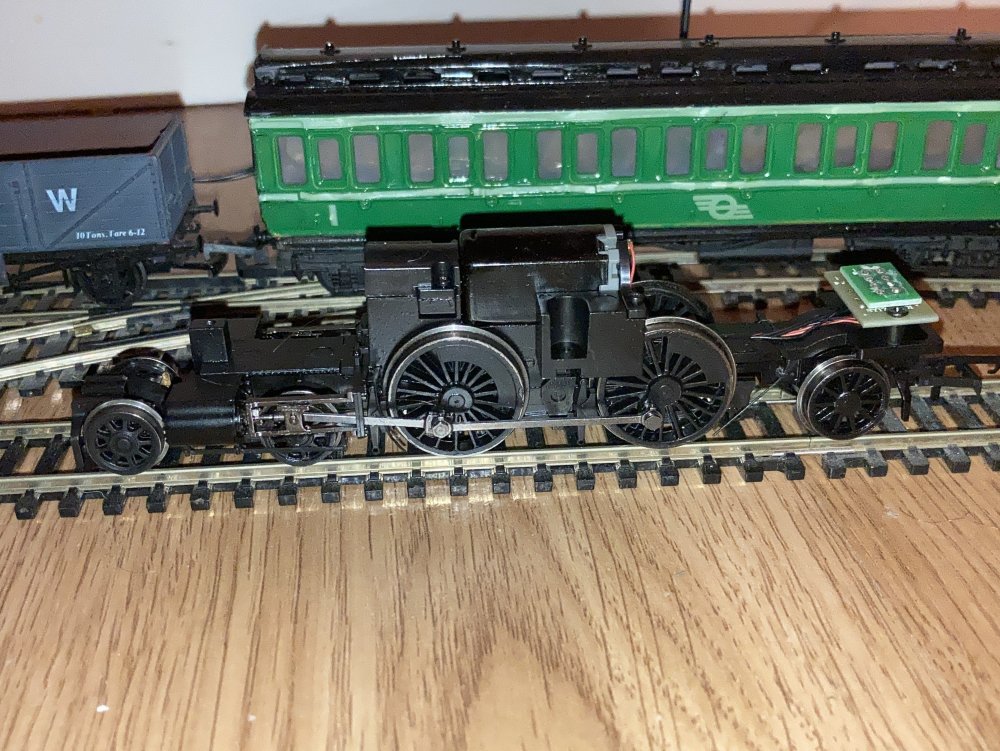

J-Mo Arts Posted November 24, 2021 Author Posted November 24, 2021 The chassis has arrived and is de-cylindered. I think this may have had an affect on the quartering. The wheels seem to slip out of sync slightly after a bit of running. I'm not entirely sure however if this came from take off the cylinders as I'm unsure how that would have that effect, but oh well. The trailing wheels are a tad small for a BCDR tank but I'm happy to overlook this. The radial body is now in bits and awaiting modifications to both the superstructure and to fit the chassis. Thanks for reading! 3
Westcorkrailway Posted November 24, 2021 Posted November 24, 2021 3 minutes ago, J-Mo Arts said: The chassis has arrived and is de-cylindered. I think this may have had an affect on the quartering. The wheels seem to slip out of sync slightly after a bit of running. I'm not entirely sure however if this came from take off the cylinders as I'm unsure how that would have that effect, but oh well. The trailing wheels are a tad small for a BCDR tank but I'm happy to overlook this. The radial body is now in bits and awaiting modifications to both the superstructure and to fit the chassis. Thanks for reading! I’m going to say by the looks of my wheels we have two different chassis. Are you going to carry over some elements of the origional and Adams radial shell in the BCDR tank print? 1
J-Mo Arts Posted November 24, 2021 Author Posted November 24, 2021 (edited) 44 minutes ago, Westcorkrailway said: I’m going to say by the looks of my wheels we have two different chassis. Are you going to carry over some elements of the origional and Adams radial shell in the BCDR tank print? You have the Hornby version. I have an Oxford, which has an inferior chassis design however at £48 I thought it was a fair price. The Radial body will be recycled into the freelance 4-4-0 posted above I also have Hornby's no.3125 but I like it too much to cut up and I model Southern too anyway! Edited November 24, 2021 by J-Mo Arts 3
Galteemore Posted November 24, 2021 Posted November 24, 2021 So that Schools Class isn’t slated to become a VS then ? 1
J-Mo Arts Posted November 24, 2021 Author Posted November 24, 2021 10 minutes ago, Galteemore said: So that Schools Class isn’t slated to become a VS then ? That is a limited edition one, so I'm probably going to sell it for a less valuable one to make into a VS but that's absolutely on the projects list. 1
Westcorkrailway Posted November 24, 2021 Posted November 24, 2021 Maybe you got lucky with the radials, some get away but most are shocking bad I had the idea of school vs class too, but considering we already have the Woolich in Ireland, I strayed off! 1 1
J-Mo Arts Posted November 24, 2021 Author Posted November 24, 2021 39 minutes ago, Westcorkrailway said: Maybe you got lucky with the radials, some get away but most are shocking bad I had the idea of school vs class too, but considering we already have the Woolich in Ireland, I strayed off! I'm hoping mine is okay. It seems to be relatively okay so far, and as my layout is flat I don't have to worry about the hill problems. A few times it hasn't started moving straight away, but after a second or so I hear a spark or something go 'click' and it moves. I have a similar problem with my 009 L&B Manning Wardle and I'm not sure if it's fixable but I can live with it.
Westcorkrailway Posted November 24, 2021 Posted November 24, 2021 8 minutes ago, J-Mo Arts said: I'm hoping mine is okay. It seems to be relatively okay so far, and as my layout is flat I don't have to worry about the hill problems. A few times it hasn't started moving straight away, but after a second or so I hear a spark or something go 'click' and it moves. I have a similar problem with my 009 L&B Manning Wardle and I'm not sure if it's fixable but I can live with it. It still might be worth the simple spring fox on the rear and front bogey, you might loose traction even on flats over that! 1
Westcorkrailway Posted December 4, 2021 Posted December 4, 2021 (edited) (that was all meant for another tread, apologies) as I’m here I may as well post the Hornby Adams radial chassis for comparison as it’s now off the body for painting Edited December 4, 2021 by Westcorkrailway Wrong thread 2
J-Mo Arts Posted December 4, 2021 Author Posted December 4, 2021 That rear wheel looks much more like it for the BCDR tanks 1

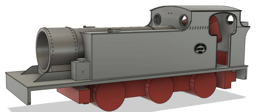

J-Mo Arts Posted December 10, 2021 Author Posted December 10, 2021 A bit of bored 3d modelling of a L&LSR/L&BER 4-6-0 gives me this, with the TT chassis dropped in roughly in red: As the motor is protruding from the front of the cab I think I'll extend the bunker back and move the chassis backwards, which will also give the space (I hope) for a shorter wheelbase bogie in front of the TT bufferbeam. If not, I could make a 2-6-0. Thanks for reading! 2
Mayner Posted December 11, 2021 Posted December 11, 2021 5 hours ago, J-Mo Arts said: A bit of bored 3d modelling of a L&LSR/L&BER 4-6-0 gives me this, with the TT chassis dropped in roughly in red: As the motor is protruding from the front of the cab I think I'll extend the bunker back and move the chassis backwards, which will also give the space (I hope) for a shorter wheelbase bogie in front of the TT bufferbeam. If not, I could make a 2-6-0. Thanks for reading! It looks like LLSR No 17/No 4 Innishowen would make a nice straightforward conversion project for the TT Jinty chassis 2
David Holman Posted December 11, 2021 Posted December 11, 2021 8 hours ago, J-Mo Arts said: A bit of bored 3d modelling of a L&LSR/L&BER 4-6-0 gives me this, with the TT chassis dropped in roughly in red: As the motor is protruding from the front of the cab I think I'll extend the bunker back and move the chassis backwards, which will also give the space (I hope) for a shorter wheelbase bogie in front of the TT bufferbeam. If not, I could make a 2-6-0. Thanks for reading! Assuming this is a semi freelance job, why not consider a 4-6-2T? That should give space in the cab.
airfixfan Posted December 11, 2021 Posted December 11, 2021 Have not seen that photo of LLSR No 4 later No 17 before. Have a few photos of that loco in my new Lough Swilly book.
J-Mo Arts Posted December 11, 2021 Author Posted December 11, 2021 4 hours ago, Mayner said: It looks like LLSR No 17/No 4 Innishowen would make a nice straightforward conversion project for the TT Jinty chassis Thanks for the suggestion, I did consider it but I find the dome rather offensive. Did it have a different one at some point? It may have the same problem of the motor being too tall and sticking out of the front of the cab, I'll have to try it out if I can find drawings. 1 hour ago, David Holman said: Assuming this is a semi freelance job, why not consider a 4-6-2T? That should give space in the cab. Thanks for this suggestion too, and that would make up quite a smart loco. I'll see what I can do! 41 minutes ago, airfixfan said: Have not seen that photo of LLSR No 4 later No 17 before. Have a few photos of that loco in my new Lough Swilly book. I think it's here : https://transportsofdelight.smugmug.com/RAILWAYS/IRISH-RAILWAYS/LONDONDERRY-LOUGH-SWILLY-RAILWAY/i-Z9sr578/A
Westcorkrailway Posted December 11, 2021 Posted December 11, 2021 12 hours ago, J-Mo Arts said: A bit of bored 3d modelling of a L&LSR/L&BER 4-6-0 gives me this, with the TT chassis dropped in roughly in red: As the motor is protruding from the front of the cab I think I'll extend the bunker back and move the chassis backwards, which will also give the space (I hope) for a shorter wheelbase bogie in front of the TT bufferbeam. If not, I could make a 2-6-0. Thanks for reading! Those motors in awkward positions killed the 3d print bandon tank. A new chassis has to be made which I have made no progress on since 1
David Holman Posted December 11, 2021 Posted December 11, 2021 Relying on rtr chassis certainly limits what you can do, which is a shame given the amount of skill and practice required to produce a 3D printed loco body. It might sound scary, but with excellent motor gear boxes available from the likes of High Level, Branchlines and Roxey, scratchbuilding a chassis means it is always possible to hide the motor. Worth considering having a go at making frames from plasticard, but with brass bearings, especially as ready milled coupling rod sets will be available for many varieties of wheel base. There again, a bit of freelancing can not only still be good fun, but also helps develop the skills for more advanced work later. 4
J-Mo Arts Posted December 11, 2021 Author Posted December 11, 2021 5 hours ago, David Holman said: Relying on rtr chassis certainly limits what you can do, which is a shame given the amount of skill and practice required to produce a 3D printed loco body. It might sound scary, but with excellent motor gear boxes available from the likes of High Level, Branchlines and Roxey, scratchbuilding a chassis means it is always possible to hide the motor. Worth considering having a go at making frames from plasticard, but with brass bearings, especially as ready milled coupling rod sets will be available for many varieties of wheel base. There again, a bit of freelancing can not only still be good fun, but also helps develop the skills for more advanced work later. Over the Christmas break I hope to make a custom chassis for a Donegal class 1 2-4-0, which seems like an easy enough one to start with and something I'd like to have anyway. The engine to fit the Triang TT chassis I am more than happy to freelance, it will be a nice first engine I reckon and won't be the best 00n3 model ever, although I'm not trying to make it that. Looking forward to working on it more soon! 2

J-Mo Arts Posted December 13, 2021 Author Posted December 13, 2021 This is how the project is ending up looking; it's taking form nicely: Going for a 2-6-0 wheel arrangement, as I've been able to regauge a 00 wheelset I had lying around. They're fairly big wheels and I may do outside axleboxes for interest, like the Isle of Man Beyer Peacocks. I'll leave the bufferbeams bare until I choose a coupling style, Branchlines' chopper couplings do appeal for that look of realism. Thanks for reading! 4
Mayner Posted December 14, 2021 Posted December 14, 2021 7 hours ago, J-Mo Arts said: This is how the project is ending up looking; it's taking form nicely: Going for a 2-6-0 wheel arrangement, as I've been able to regauge a 00 wheelset I had lying around. They're fairly big wheels and I may do outside axleboxes for interest, like the Isle of Man Beyer Peacocks. I'll leave the bufferbeams bare until I choose a coupling style, Branchlines' chopper couplings do appeal for that look of realism. Thanks for reading! She looks close to one of the LLSR Barclay 4-6-0Ts I wonder would the Tri-ang Castle or Princess Chassis be a better option that the jinty? Second hand TT prices seem a lot more realistic than OO https://www.ebay.co.uk/itm/353802880994?hash=item52604b87e2:g:jDgAAOSwOYFhsMVU. If you are feeling adventerous you could try re-wheeling with Markits wheels with extended TT axles and outside cranks, everything is self jigging Markits supply a special axlenut screwdriver. and you end up with a reasonably authentic outside framed Swilly Loco. My favourites are the two dainty Kerr Stewart Tanks Aberfoyle and Richmond No 4 with a decent looking dome though the chimney is a bit of a monstrocity 3

J-Mo Arts Posted December 14, 2021 Author Posted December 14, 2021 (edited) 5 hours ago, Mayner said: She looks close to one of the LLSR Barclay 4-6-0Ts I wonder would the Tri-ang Castle or Princess Chassis be a better option that the jinty? Second hand TT prices seem a lot more realistic than OO https://www.ebay.co.uk/itm/353802880994?hash=item52604b87e2:g:jDgAAOSwOYFhsMVU. If you are feeling adventerous you could try re-wheeling with Markits wheels with extended TT axles and outside cranks, everything is self jigging Markits supply a special axlenut screwdriver. and you end up with a reasonably authentic outside framed Swilly Loco. My favourites are the two dainty Kerr Stewart Tanks Aberfoyle and Richmond No 4 with a decent looking dome though the chimney is a bit of a monstrocity Thanks for this. She's based on the 4-6-0 drawings. I did have a look at a bigger TT chassis, but I think that they'd come with their own compromises, and so I think the next step in my 3ft modelling will be to make my own chassis. I'm planning to do a Donegal class 1 2-4-0. Perhaps in the future I'll do a half-cab no.4, as Dr Alan Gee has, as it's quite a pretty engine. So are Aberfoyle and Richmond, you're quite right! So many ideas... Thanks Edited December 14, 2021 by J-Mo Arts 3

J-Mo Arts Posted December 14, 2021 Author Posted December 14, 2021 Did a bit of work on her this morning. As the boiler is pitched higher, and I'm trying to keep it with the same loading gauge as the 4-6-0s, the chimney and dome look a bit small. I'm sure it'll look fine when painted and moving around on the layout. 2
