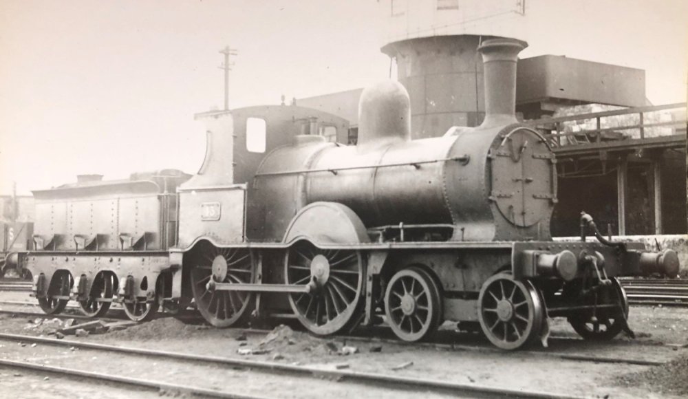

J-Mo Arts Posted February 3, 2022 Author Posted February 3, 2022 (edited) Current state of play with the Radial bash into GNRI tender loco: Just plonked on the chassis to realise that the rods hit the bottom of the body, so she'll need to be raised a mm or two and have some false frames made at the front. I haven't got round to drawing up the BCDR tank to print for the radial's chassis yet but it's in the queue! Edited February 3, 2022 by J-Mo Arts 3 Quote
Galteemore Posted February 3, 2022 Posted February 3, 2022 Very nice - although there’s a fair GSWR resemblance going on here too! 3 Quote
David Holman Posted February 3, 2022 Posted February 3, 2022 (edited) Interesting! My thoughts too... Edited February 3, 2022 by David Holman 1 Quote
J-Mo Arts Posted February 3, 2022 Author Posted February 3, 2022 3 hours ago, Galteemore said: Very nice - although there’s a fair GSWR resemblance going on here too! Yeah there is isn't there. I like those smokebox doors! Also looks a little like No.54 I was tempted to do a GSWR loco but I would like to keep my Irish SG modelling currently to GNR(I) and BCDR so that I don't have to make as many coach rakes to go with them.Saying that I've got a CBSC loco in the works and plans for the DNGR saddle tanks, so I may end up making a generic rake of coaches of the right period. If anyone wishes to complain they can post me some correct carriages! Perhaps this particular loco was bought 2nd hand from the GSWR... It's a freelance anyway so I can pretty much give it any semi-plausible history. 1 Quote

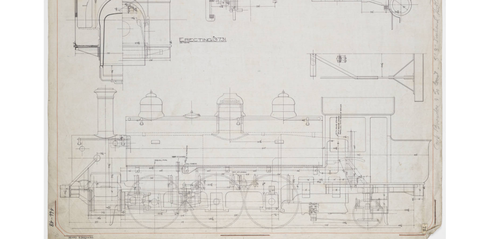

Killian Keane Posted February 4, 2022 Posted February 4, 2022 I take it you have these drawings, J Mo? [Cork, Bandon and South Coast, Locomotive 19-20, Erecting Card Drawing No. 3731] - Railroads - Photographs, Manuscripts, and Imprints - SMU Digital Collections 3 Quote

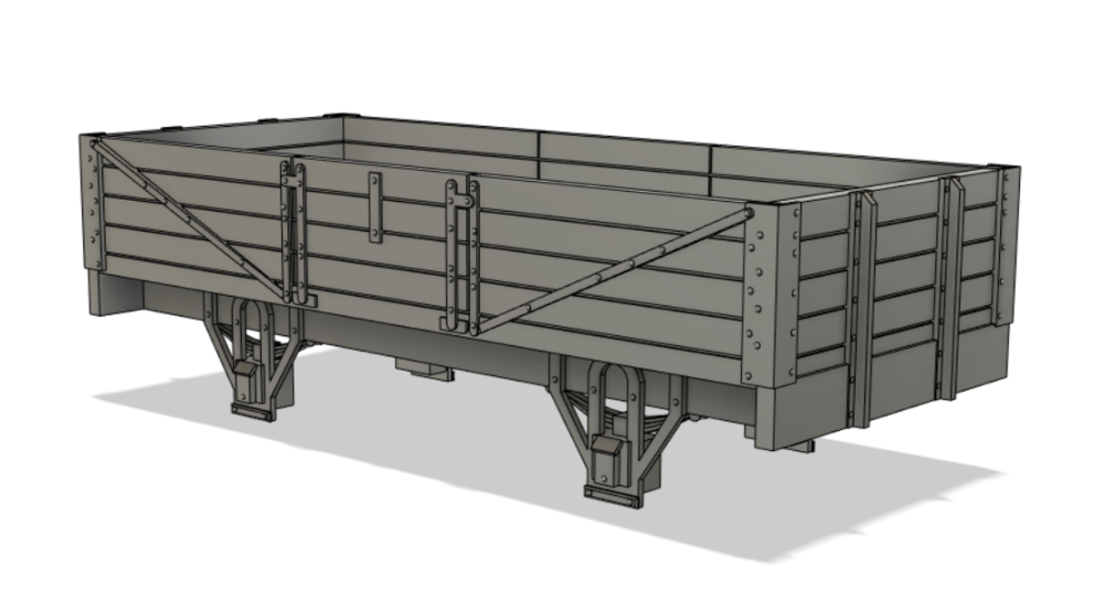

J-Mo Arts Posted February 12, 2022 Author Posted February 12, 2022 On a bit of an impulse I have been drawing up a Donegal 7 ton wagon this evening: I've hit a bit of a snag- I used these drawings from HMRS: And the brake lever is of a different design to the one here (apparently correct for numbers 101-120 and 121-154) and on the wagon in Cultra: http://gardenrailwayrealism.pbworks.com/f/1237901124/cdropen2.jpg This gives conflicting designs and I'm not entirely sure which to go with- obviously the one in Cultra is going to be the most accurate but was this truly representative of the majority of the Donegal 5-plank wagons' brake gear? This is a small gripe but I'd love to sell a few of these wagons and so would like them to be as accurate as possible. @airfixfan please excuse the tag, you are the most knowledgeable person on the DR that I know of- if you could shed any light on this it would be very greatly appreciated! 1 Quote
airfixfan Posted February 13, 2022 Posted February 13, 2022 (edited) Thanks let me look through my records and have some photos of different types of CDR eagons from the 1930s onwards in my own collection. By chance as part of my work on a new CDR book I am going through various photo collections at present. Will also be volunteering at the Donegal Railway Heritage Centre for a few days next week going through our photo archive. As a Committee member have also access to other sources there such as our rolling stock diagram book Send me a PM? Edited February 13, 2022 by airfixfan 1 Quote
Andy Cundick Posted February 13, 2022 Posted February 13, 2022 Basically 3 different types the 1893 Oldbbury stock has 8 shoe clasp brakes plus a single brake lever operating on one shoe only,then with the 1900 stock onwards 4 shoe brakes with 2 brake levers operating from the same end Cultras open 13 has this type, when you get to the Strabane and Letterkenny Hurst Nelson stock you have 8 shoe clasp brakes with the 2 brake levers at the same end.There are a few variations due to rebuilding etc,but that is the basics.If you havn't got it Roger Crumbleholmes "County Donegal Companion"is very useful.Andy. 1 1 Quote
J-Mo Arts Posted February 13, 2022 Author Posted February 13, 2022 29 minutes ago, Andy Cundick said: Basically 3 different types the 1893 Oldbbury stock has 8 shoe clasp brakes plus a single brake lever operating on one shoe only,then with the 1900 stock onwards 4 shoe brakes with 2 brake levers operating from the same end Cultras open 13 has this type, when you get to the Strabane and Letterkenny Hurst Nelson stock you have 8 shoe clasp brakes with the 2 brake levers at the same end.There are a few variations due to rebuilding etc,but that is the basics.If you havn't got it Roger Crumbleholmes "County Donegal Companion"is very useful.Andy. Thanks a lot Andy! I assume then that these drawings I've used are of the 1893 stock as they have a single brake lever. Thanks again! Quote
Andy Cundick Posted February 13, 2022 Posted February 13, 2022 The answer to that is no,the drawing is a Bruce Heaven drawing which has to treated with caution. 141 was rebuilt at Dundalk c1949/50 and so is a bit of a one off.The single brake levers pivot on the bottom of the frames If its any help i can sort you out some drawings of Donegal stock if its of any use.Andy. Quote
J-Mo Arts Posted February 13, 2022 Author Posted February 13, 2022 4 hours ago, Andy Cundick said: The answer to that is no,the drawing is a Bruce Heaven drawing which has to treated with caution. 141 was rebuilt at Dundalk c1949/50 and so is a bit of a one off.The single brake levers pivot on the bottom of the frames If its any help i can sort you out some drawings of Donegal stock if its of any use.Andy. That would be very useful, thanks! Quote
