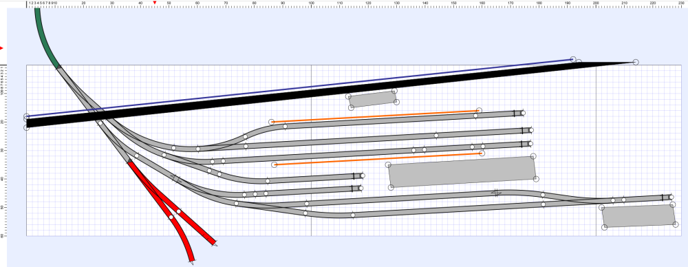

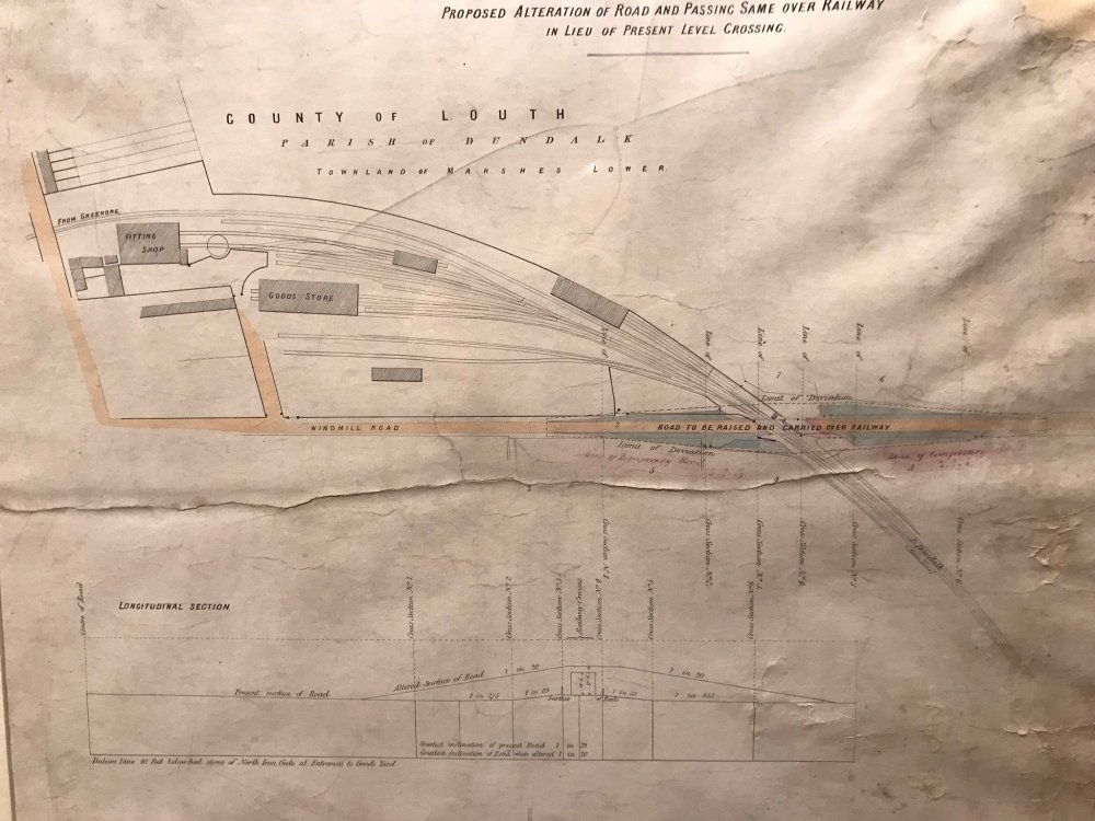

Dempsey Posted May 30, 2022 Posted May 30, 2022 After coming across this plan some time ago on this forum and after much thought I thought I'd try my hand at an exhibition layout of the yard. While the image below is an original plan I will be aiming to model the yard in the last year or months before it finally closed. Your thoughts, feedback or information in regards to the yard are as always greatly appreciated. Chris 13 Quote
Niles Posted May 30, 2022 Posted May 30, 2022 Always thought this would make an intriguing compact little layout, plenty of potential for single 121s running bonnet first etc. 2 Quote
Dempsey Posted May 30, 2022 Author Posted May 30, 2022 4 minutes ago, Niles said: Always thought this would make an intriguing compact little layout, plenty of potential for single 121s running bonnet first etc. I've found a video on YouTube of movements in the yard around when I plan to set it. 121s bonnet first among them 3 Quote
Rob Posted May 30, 2022 Posted May 30, 2022 It certainly looks like it would have great potential to model- l like the sound of it being based on the time before it closed! Look forward to seeing it develop for sure 2 Quote
popeye Posted May 30, 2022 Posted May 30, 2022 Should make a nice project. It's hard to tell from the plan what all of the buildings are. 1 Quote

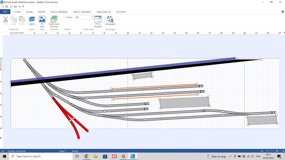

Dempsey Posted May 30, 2022 Author Posted May 30, 2022 Below is a rough initial track plan based on the above plan and with stills taken from videos on YouTube of workings in the yard itself before its closure. The blue line simulates a scenic break between the layout and the storage area. In front of that in black is a road bridge over the line and the following road. The section in red will be isolated and unpowered scenic track which would have lead toward Greenore and some long since removed trackage at this point. Also the end that overhangs off the baseboard will be cut flush and not as shown here. The two orange lines represent the rails for the gantry crane. Yet undecided whether or not this will be motorized in some way or just stationary. This is just a rough track plan which is subject to revising and is by no means the finished plan. As always your thoughts are greatly appreciated. Many thanks. Chris. 7 Quote
jhb171achill Posted May 30, 2022 Posted May 30, 2022 9 minutes ago, Dempsey said: Below is a rough initial track plan based on the above plan and with stills taken from videos on YouTube of workings in the yard itself before its closure. The blue line simulates a scenic break between the layout and the storage area. In front of that in black is a road bridge over the line and the following road. The section in red will be isolated and unpowered scenic track which would have lead toward Greenore and some long since removed trackage at this point. Also the end that overhangs off the baseboard will be cut flush and not as shown here. The two orange lines represent the rails for the gantry crane. Yet undecided whether or not this will be motorized in some way or just stationary. This is just a rough track plan which is subject to revising and is by no means the finished plan. As always your thoughts are greatly appreciated. Many thanks. Chris. Looks good - a good representation, as the real thing to scale on a layout would be enormous. 1 Quote
Dempsey Posted May 31, 2022 Author Posted May 31, 2022 The overall dimensions is 6 foot by 2 foot for the display part. With two storage tracks to the rear. 3 Quote

Dempsey Posted June 11, 2022 Author Posted June 11, 2022 After watching through the above video I posted and closing looking at various pictures of the yard online I have adjusted and revised the track plan. Furthermore I will be taking the dive into DCC for this layout including sound installed A class, class 121 and 141s. As always I look forward to hearing your feedback. 9 Quote

Rob Posted June 12, 2022 Posted June 12, 2022 On 11/6/2022 at 2:09 PM, Dempsey said: After watching through the above video I posted and closing looking at various pictures of the yard online I have adjusted and revised the track plan. Furthermore I will be taking the dive into DCC for this layout including sound installed A class, class 121 and 141s. As always I look forward to hearing your feedback. Looks good- plenty of possibilities there and a good era to model l think!! 3 Quote

Dempsey Posted July 6, 2022 Author Posted July 6, 2022 With some time off work the baseboard for barracks street layout has been completed. 12 Quote
Dempsey Posted July 7, 2022 Author Posted July 7, 2022 Track plan printed out to use as a template 2 Quote
ttc0169 Posted July 7, 2022 Posted July 7, 2022 (edited) 29 minutes ago, Dempsey said: Track plan printed out to use as a template I would suggest using PECO points as they are far more reliable than the Hornby rubbish. Edited July 7, 2022 by ttc0169 1 1 Quote
Dempsey Posted July 7, 2022 Author Posted July 7, 2022 7 minutes ago, ttc0169 said: I would suggest using PECO points as they are far more reliable than the Hornby rubbish. I had originally set out with a view to using peco but my limited selection of their points on Any Rail didn't allow for the track plan within the available board space. 1 Quote
ttc0169 Posted July 7, 2022 Posted July 7, 2022 2 minutes ago, Dempsey said: I had originally set out with a view to using peco but my limited selection of their points on Any Rail didn't allow for the track plan within the available board space. Ok, you may encounter derailments with the 001 class locomotives as I have found when traversing Hornby points. 1 Quote
Dempsey Posted July 7, 2022 Author Posted July 7, 2022 10 minutes ago, ttc0169 said: Ok, you may encounter derailments with the 001 class locomotives as I have found when traversing Hornby points. Unfortunately it was a compromise I had to make with the space. Thank you though for your suggestion. 1 Quote
irishmail Posted July 7, 2022 Posted July 7, 2022 8 minutes ago, Dempsey said: Unfortunately it was a compromise I had to make with the space. Thank you though for your suggestion. If you are using set-track then the Peco track geometry is the same as Hornby. As previously mentioned, Peco much better quality track than Hornby. 1 1 Quote
Sean Posted July 7, 2022 Posted July 7, 2022 The larger express type points are far more reliable than hornbys little points, they also plumb into set track geometry without issues. you cant do this with any of the larger peco points from what i have found however for smaller points peco ones are very reliable and hornby ones are the devil. I think the peco curved point may be the same as the hornby one but im not 100% sure, peco have a template you can print on their site. railmodeller express will allow you to plan the layout in peco. 2 Quote
