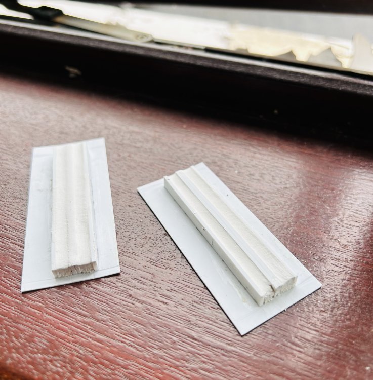

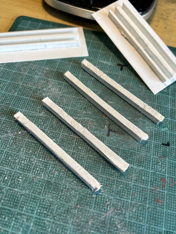

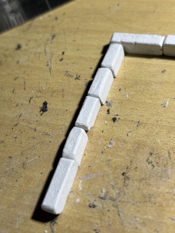

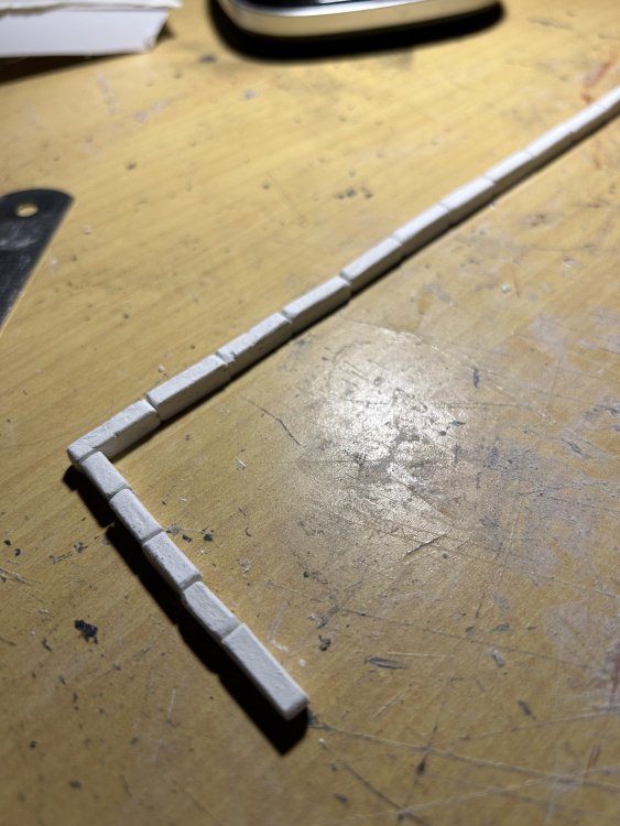

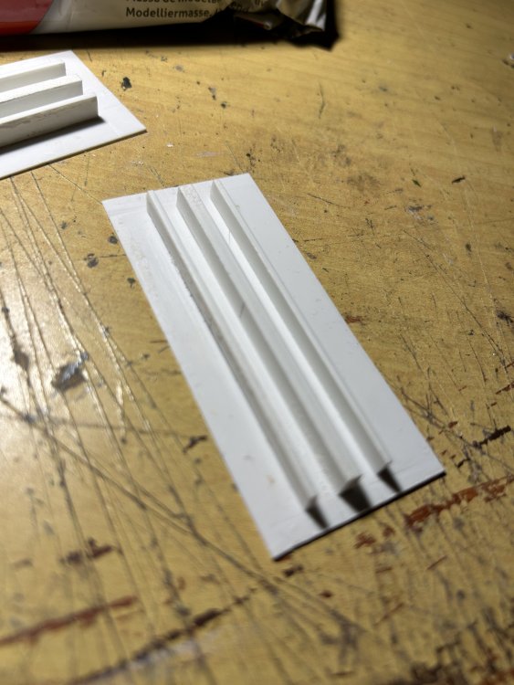

Patrick Davey Posted September 18, 2023 Author Posted September 18, 2023 Also more of the coping strategy as well….. I will need some coping stones for the top of my sand loading bank so I’ve used a plasticard jig to form DAS clay into long square strips which will then be cut into the coping stones. 7 1 Quote
Tullygrainey Posted September 18, 2023 Posted September 18, 2023 2 hours ago, Patrick Davey said: Looking good Patrick. Nice photo - two sides of the one quoin. (I'll get my coat) 4 Quote
Patrick Davey Posted September 18, 2023 Author Posted September 18, 2023 I think DAS produces a very realistic stone effect when it's fully dried, lots of nice random chips etc. 1 Quote
jhb171achill Posted September 18, 2023 Posted September 18, 2023 6 minutes ago, Patrick Davey said: I think DAS produces a very realistic stone effect when it's fully dried, lots of nice random chips etc. Also a good base for low-lying scenery, if it's moulded into shape and covered in grass. 1 Quote
Patrick Davey Posted September 18, 2023 Author Posted September 18, 2023 11 minutes ago, jhb171achill said: Also a good base for low-lying scenery, if it's moulded into shape and covered in grass. Tis versatile shtuff! 1 1 Quote

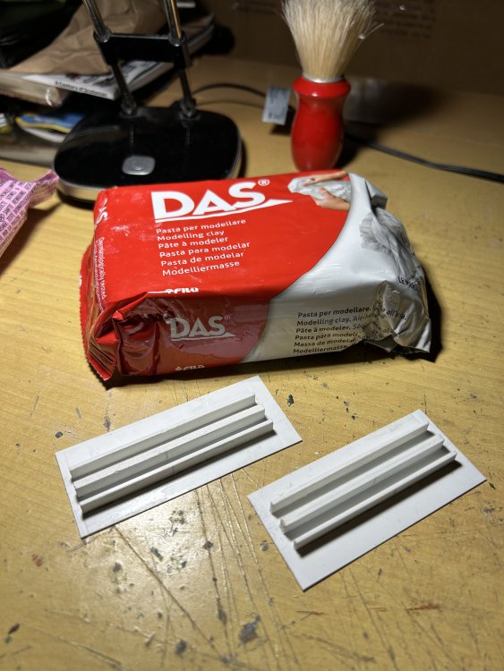

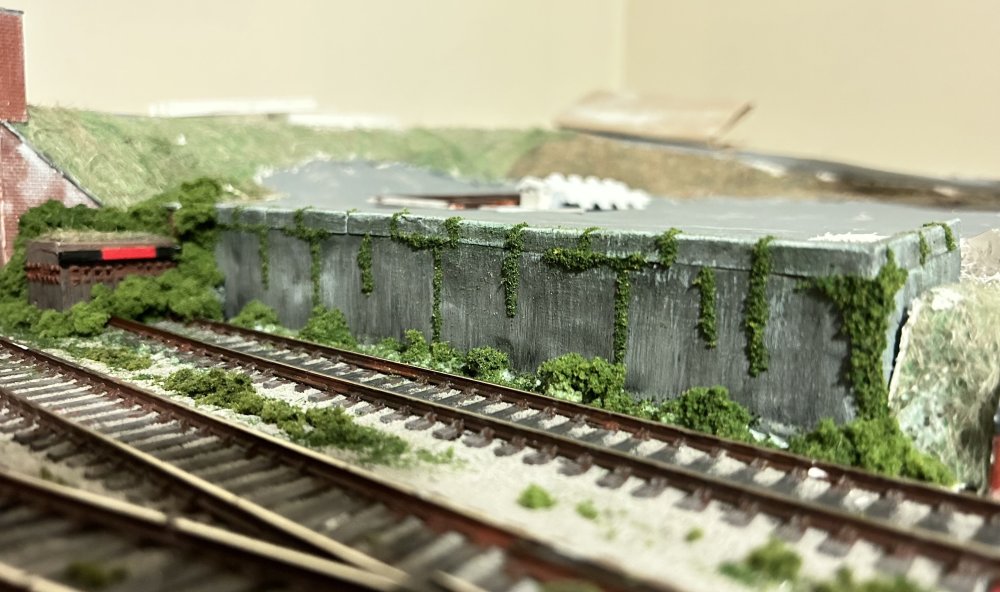

Patrick Davey Posted September 20, 2023 Author Posted September 20, 2023 The sand loading bank at Clogherhead is taking shape - the sub-structure is plasticard and the vertical faces have been covered with DAS and will hopefully be finished to represent concrete, it is currently drying outside. The coping stones, also made from DAS, have also been finished. Once the loading bank dries completely I'll add the coping stones and paint the whole structure. 2 1 Quote
Tullygrainey Posted September 20, 2023 Posted September 20, 2023 (edited) DAS ist gut! Edited September 20, 2023 by Tullygrainey 1 7 Quote

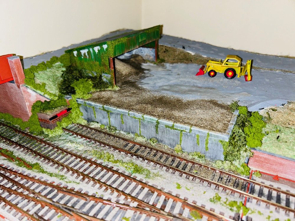

Patrick Davey Posted September 21, 2023 Author Posted September 21, 2023 (edited) The sand loading bank has been completed and getting bedded in with foliage. I was going for a weathered concrete look, but I think I may have gone too dark….? Edited September 21, 2023 by Patrick Davey 15 Quote
David Holman Posted September 22, 2023 Posted September 22, 2023 Good stuff. Colour is always difficult to gauge, but that seems right - besides which the colour of concrete can change considerably depending on light, recent rain, weathering and so on. Have yet to find a tin of concrete coloured paint that looks anything like the real stuff, but when you think about it, the composition (especially if lots of gravel included) is far from uniform anyway. 1 3 Quote
Flying Snail Posted September 22, 2023 Posted September 22, 2023 Agree with the other comments - your concrete looks spot on. 1 Quote

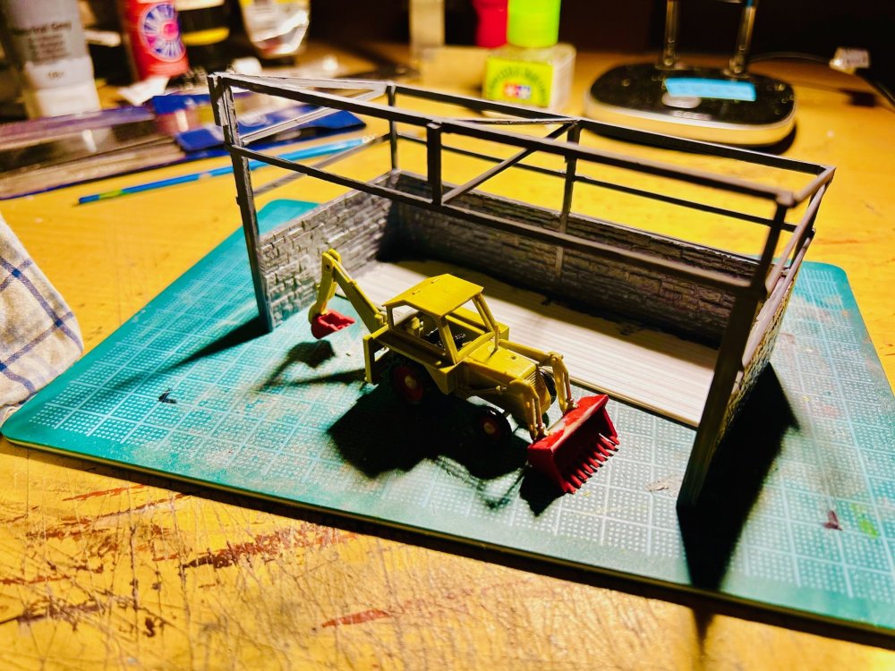

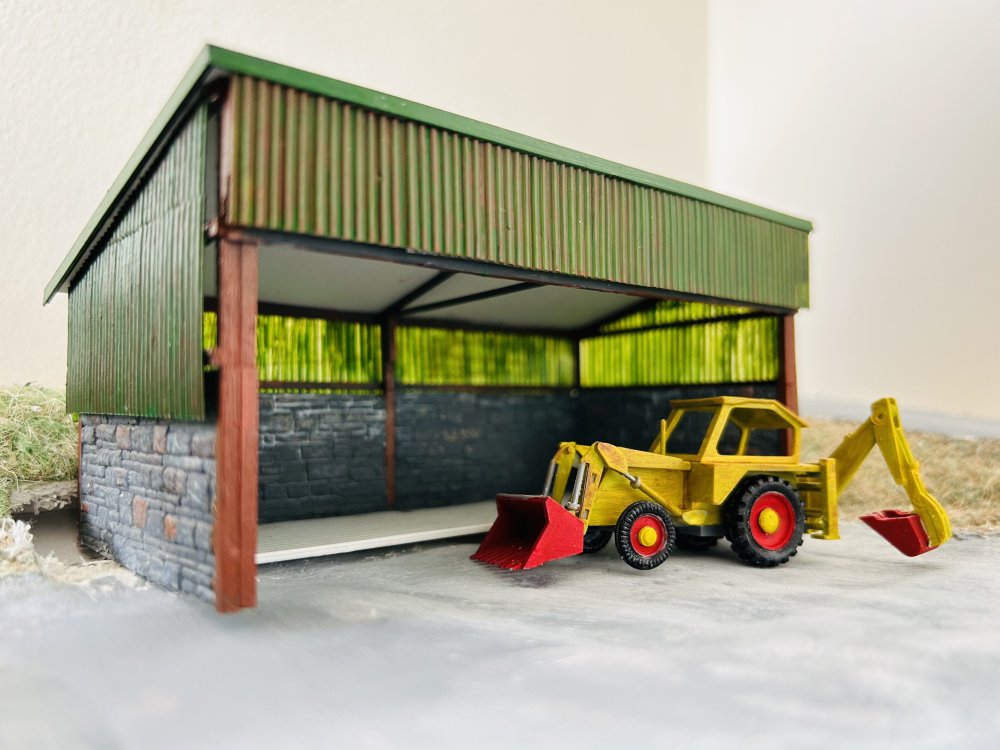

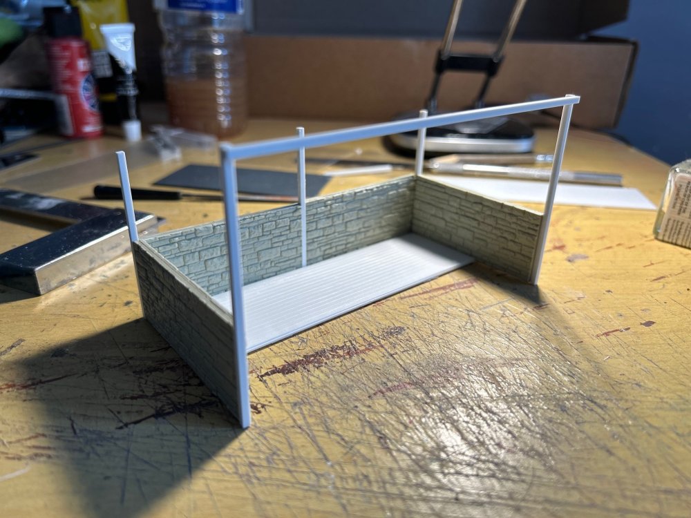

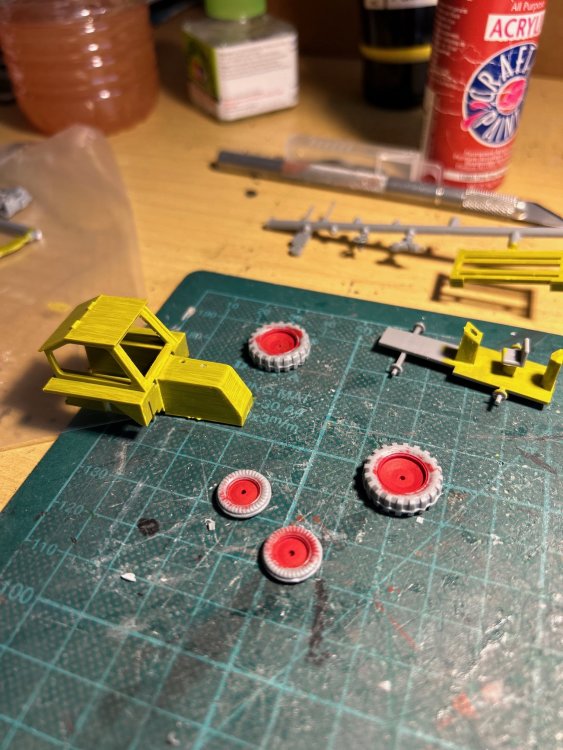

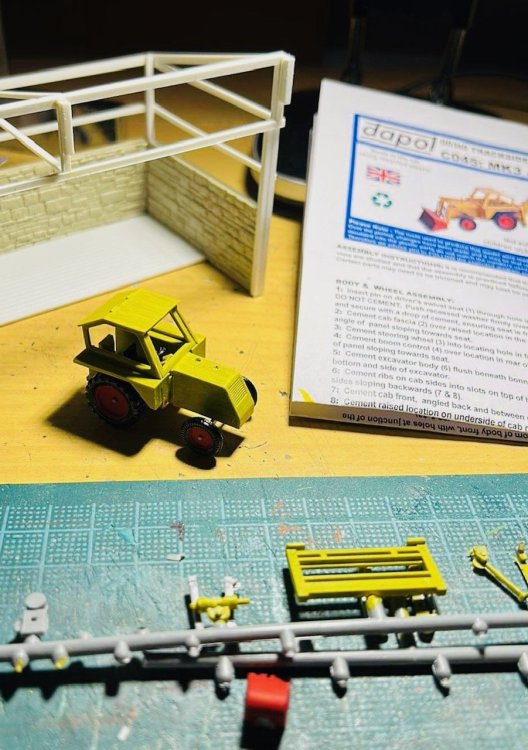

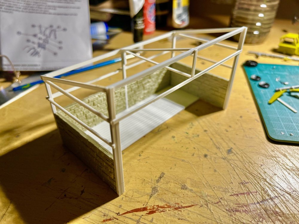

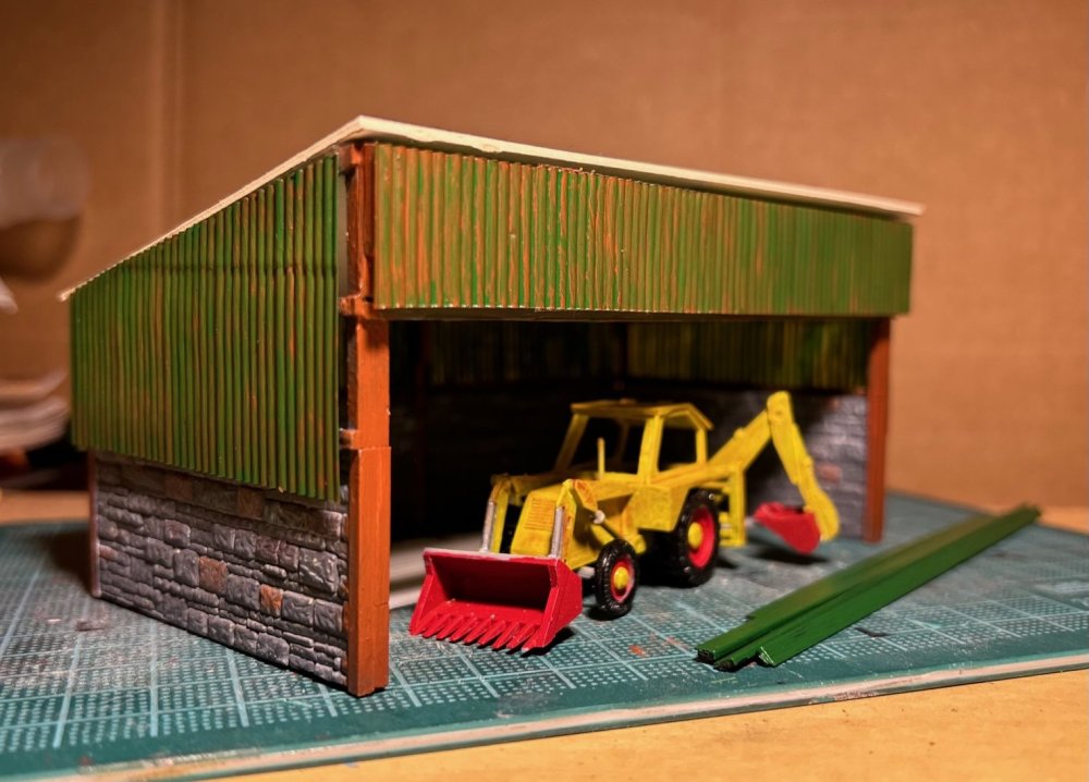

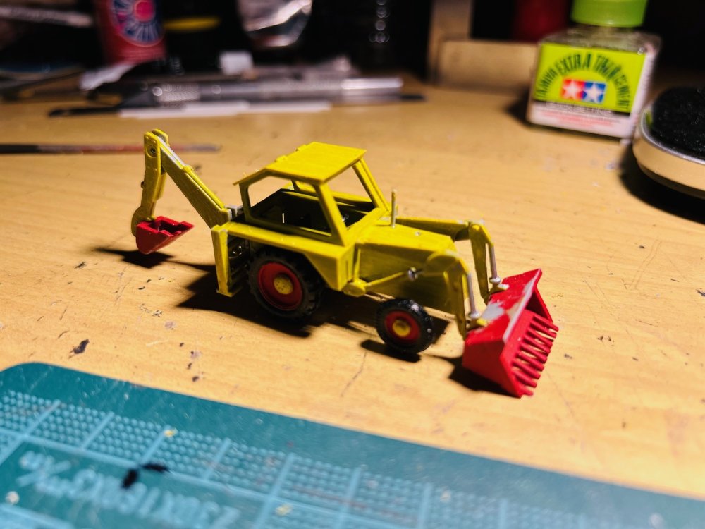

Patrick Davey Posted September 24, 2023 Author Posted September 24, 2023 (edited) So now that the sand loading bank has been installed, I have moved on to the sand store, which will be a very basic structure with a stone base and corrugated iron upper parts and roof. I also needed something to transfer the sand into the wagons and the old Dapol JCB kit fits the bill....I think.....am hoping this machine would have been around during the early 1970s.....? There will also be a small red brick sand 'office'. More tomorrow.....yawn......... Edited September 24, 2023 by Patrick Davey 13 Quote
Galteemore Posted September 24, 2023 Posted September 24, 2023 Excellent. Looks like a 3C possibly ~ which was produced late 60s on. 3 Quote
Mayner Posted September 24, 2023 Posted September 24, 2023 The early version of the JCB3c similar to the Airfix/Dapol model had largely disappeared by the early 70s replaced by the more angular 3c2 model. When I started work in 76 our contractor replaced his 3c with a 3C2 possibly engine or hydraulic pump worn out An older machine might survive longer on light work like loading sand into railway wagons, I would fill-in or remove the teeth from the bucket, seldom used on a JCB (backhoe loader) and remove the backactor and replace with a rectangular block of concrete as a counterweight if only used for loading sand. 4 1 1 Quote
Patrick Davey Posted September 24, 2023 Author Posted September 24, 2023 Thanks for the info above John @Mayner - noted! Had hoped to get this building finished this weekend but a leak from a tube of impact glue went unnoticed until I saw the table and my hands covered in it, tube had to be binned so I wasn't able to fix the framing around the roof and get the roof in place. Maybe tomorrow. Happy with the result though, of both JCB and sand store! 10 Quote

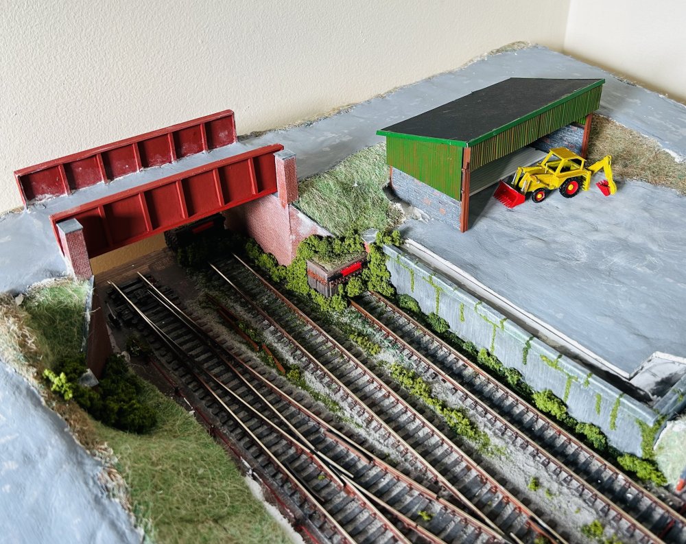

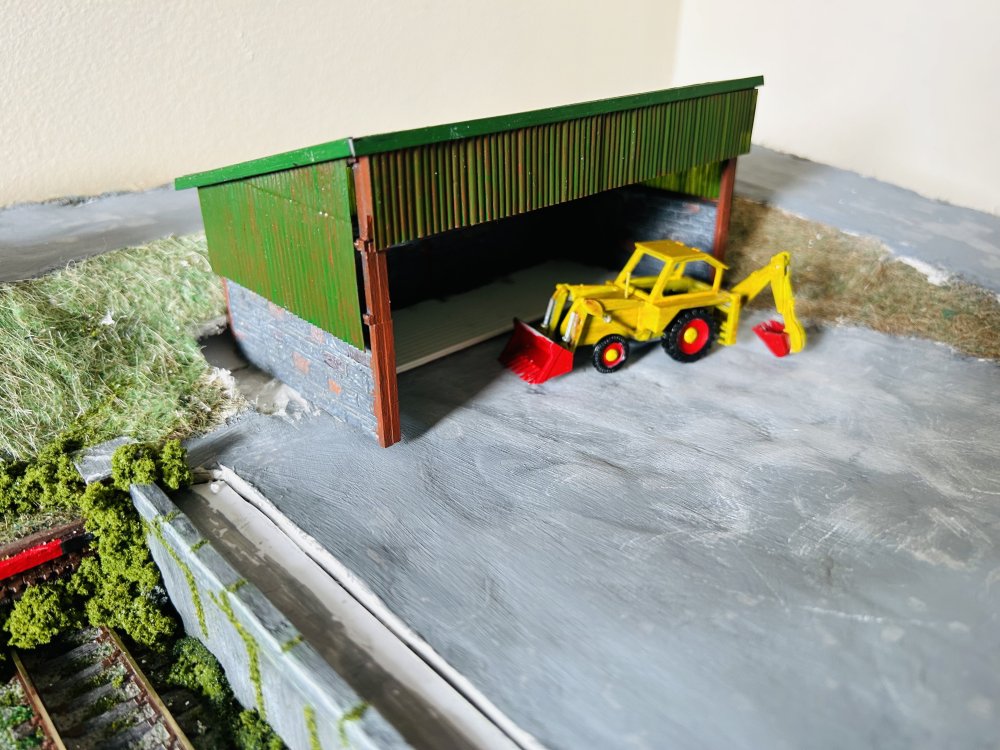

Patrick Davey Posted September 25, 2023 Author Posted September 25, 2023 Roof and fascia affixed and looking fairly good now. 15 Quote
Flying Snail Posted September 25, 2023 Posted September 25, 2023 Love the shed. This is going to be a very distinctive layout 1 1 Quote
Galteemore Posted September 25, 2023 Posted September 25, 2023 Excellent. Will look great with a 70s era CIE freight coming under that bridge. Just needs a battered old car with a red rear numberplate sitting around somewhere ! 1 2 1 Quote
Patrick Davey Posted September 27, 2023 Author Posted September 27, 2023 (edited) The sand store has been further weathered (including evidence of swallow activity?) and bedded into the layout. I have taken the risk of using real Clogherhead sand again so I am half expecting carnage in the morning like last time it was used, but this time it's less confined so maybe not! UPDATE: No sand-related carnage! Edited September 28, 2023 by Patrick Davey 10 Quote

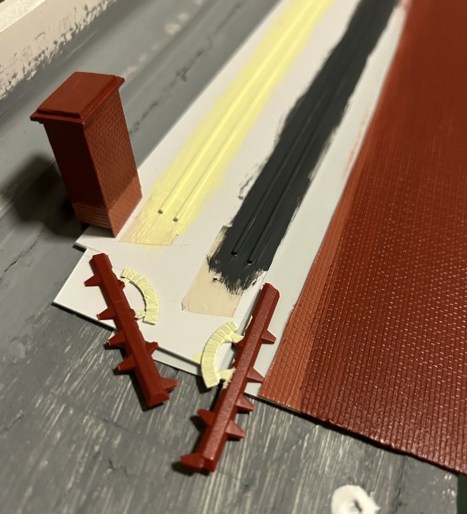

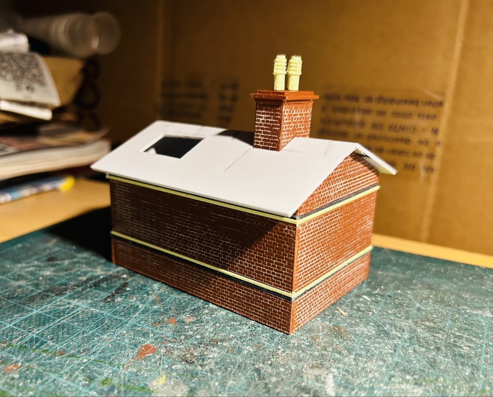

Patrick Davey Posted September 28, 2023 Author Posted September 28, 2023 A small build in preparation….. 6 Quote

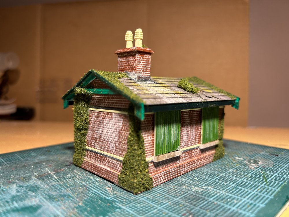

Patrick Davey Posted September 30, 2023 Author Posted September 30, 2023 This will become the derelict 'sand office' at Clogherhead station. It's also a practice run for a new technique for creating GNR polychrome brick station buildings although I'm cheating slightly with this one! 14 Quote

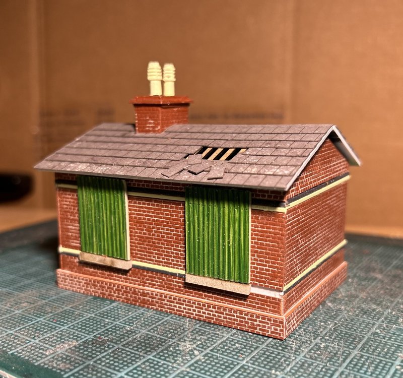

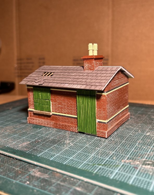

Patrick Davey Posted October 1, 2023 Author Posted October 1, 2023 Once again the escapism provided by a project makes one lose track of time….. it’s now past 2:00am but the sand office is now almost complete. Just barge boards, gutters & downpipes left, then weathering & ‘ivy’ to be applied. 19 Quote

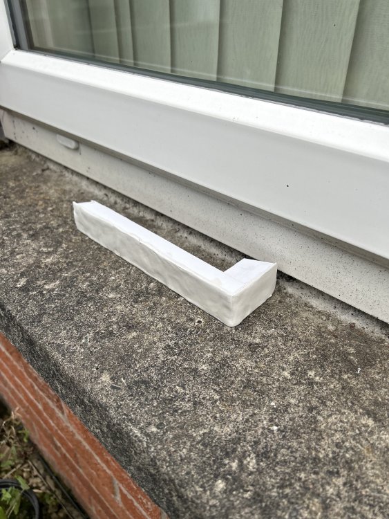

DJ Dangerous Posted October 1, 2023 Posted October 1, 2023 Just catching up on this thread, now. Outstanding work, @Patrick Davey! In particular the two post near the top of this page with the coping stones and the quoins, just wow. That said, the most impressive aspectof this thread is that it hasn't decended into farcical pun-itive jokes, yet. 1 1 Quote

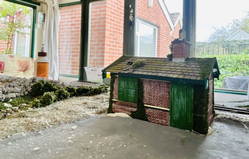

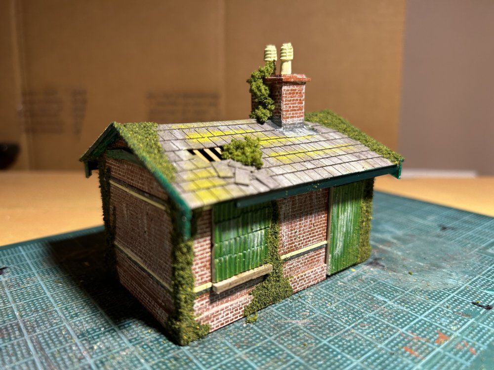

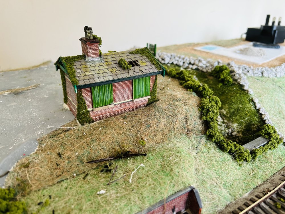

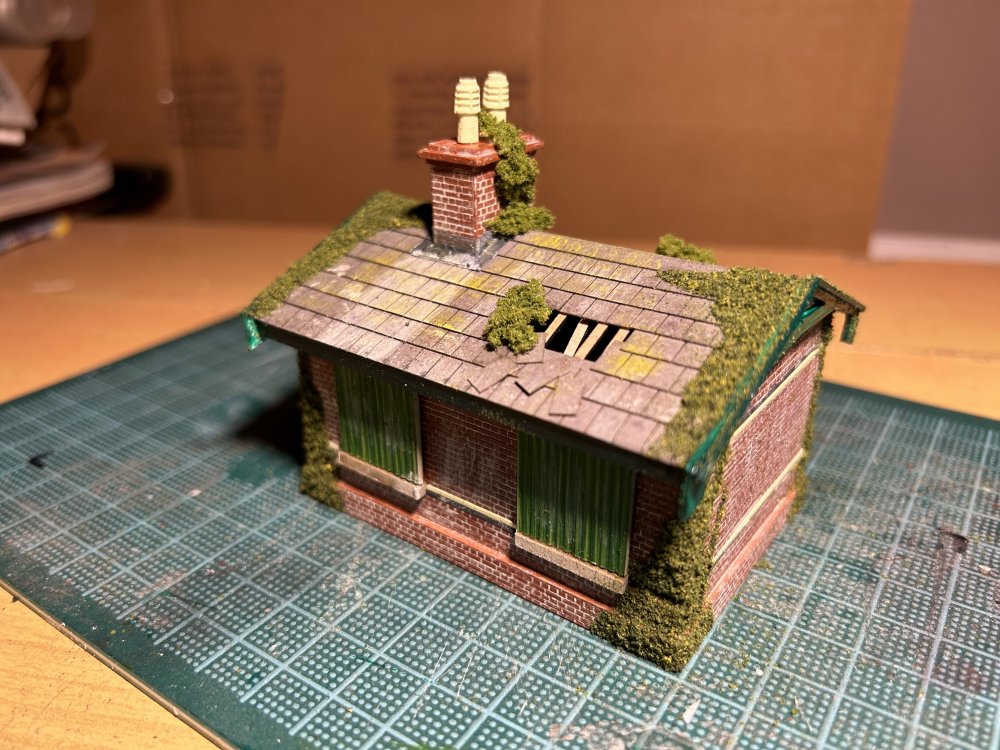

Patrick Davey Posted October 2, 2023 Author Posted October 2, 2023 Thanks folks for all the nice comments I think this small build is almost finished! Weathering can become something of an addiction, it’s definitely very effective - I think I just need to dull down the chimney pots a bit, then we’re done. 16 Quote

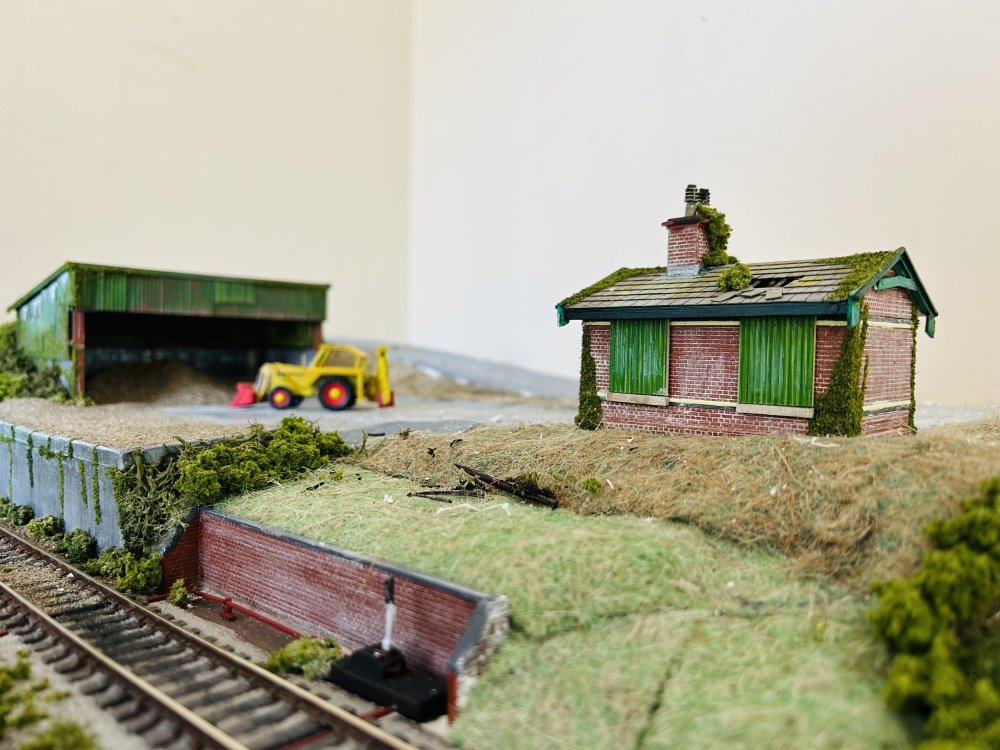

Patrick Davey Posted October 3, 2023 Author Posted October 3, 2023 Thank you everyone for the nice comments above! This has definitely turned out better than expected which is always nice The office has now been planted in position, so once the glue dries, I will add some more foliage to bed it in. Useful techniques practised here for the construction of the station building, which is next on the agenda! 14 Quote
Broithe Posted October 3, 2023 Posted October 3, 2023 Marvellous stuff! But, the building behind it in the last picture is still 'too clean' and a bit over-scale, I think. 1 5 Quote

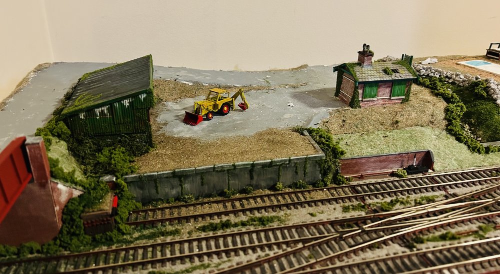

Patrick Davey Posted October 3, 2023 Author Posted October 3, 2023 (edited) An aerial view of the sand facility at Clogherhead, photographed sometime around 1974. On the right is the long disused office, and on the left is the rapidly deteriorating sand store with an elderly JCB in attendance. The concrete of the loading bank is cracked and the weeds are slowly making the structure crumble. But the sand traffic lingers on for now. Edited October 3, 2023 by Patrick Davey 15 Quote
Gabhal Luimnigh Posted October 3, 2023 Posted October 3, 2023 It's a lovely piece of work Patrick, very realistic, well done you. 2 1 Quote
