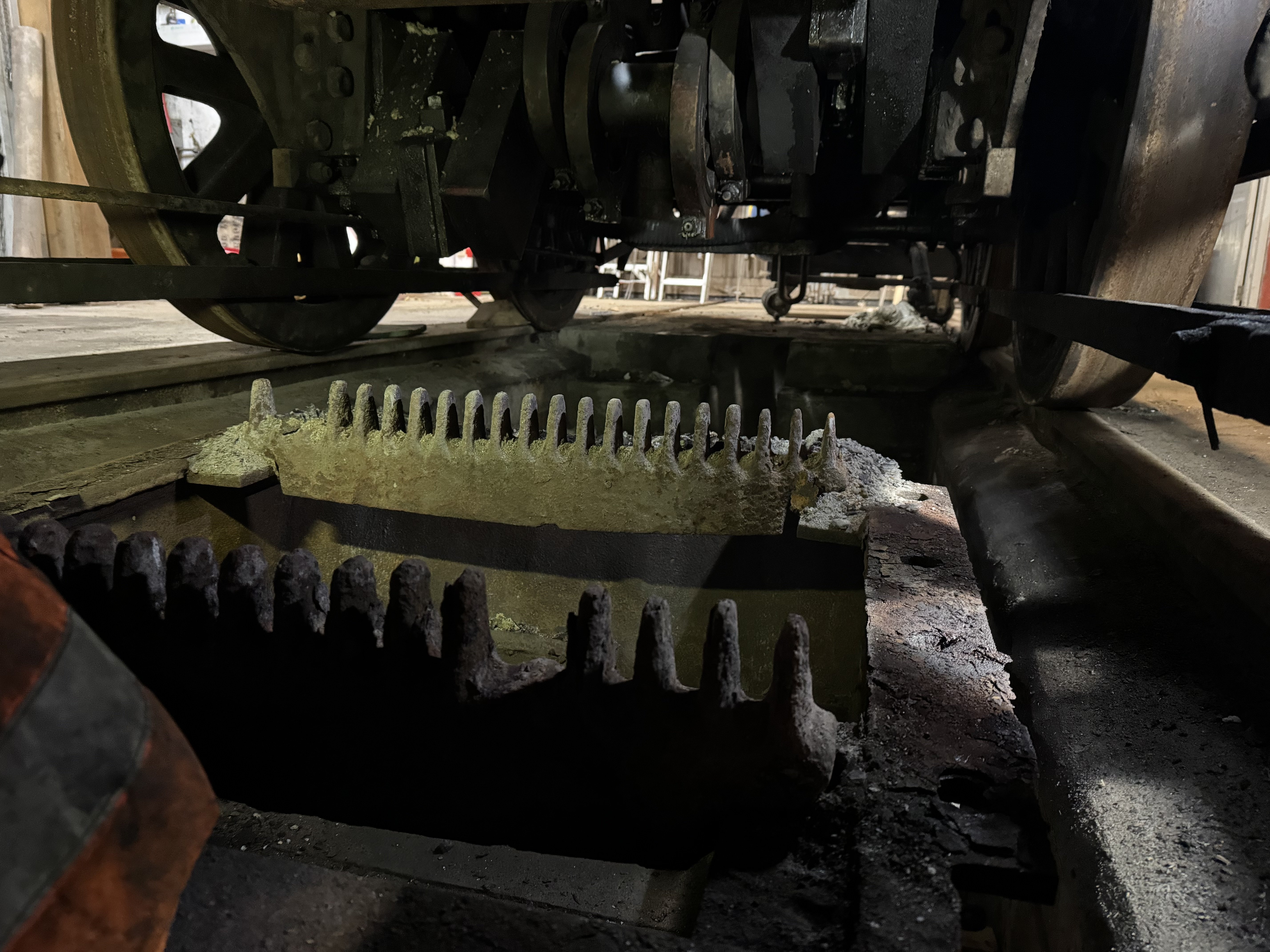

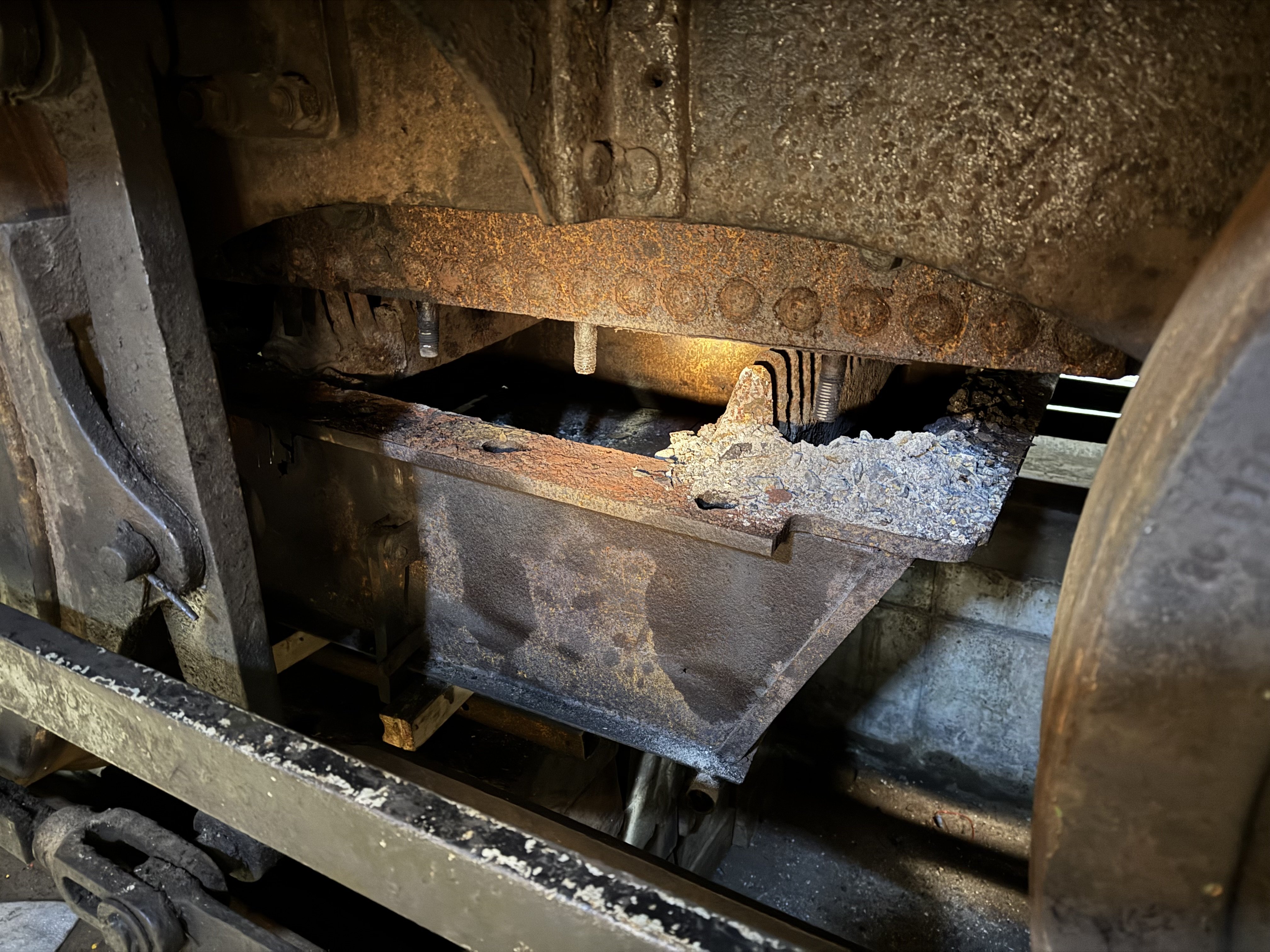

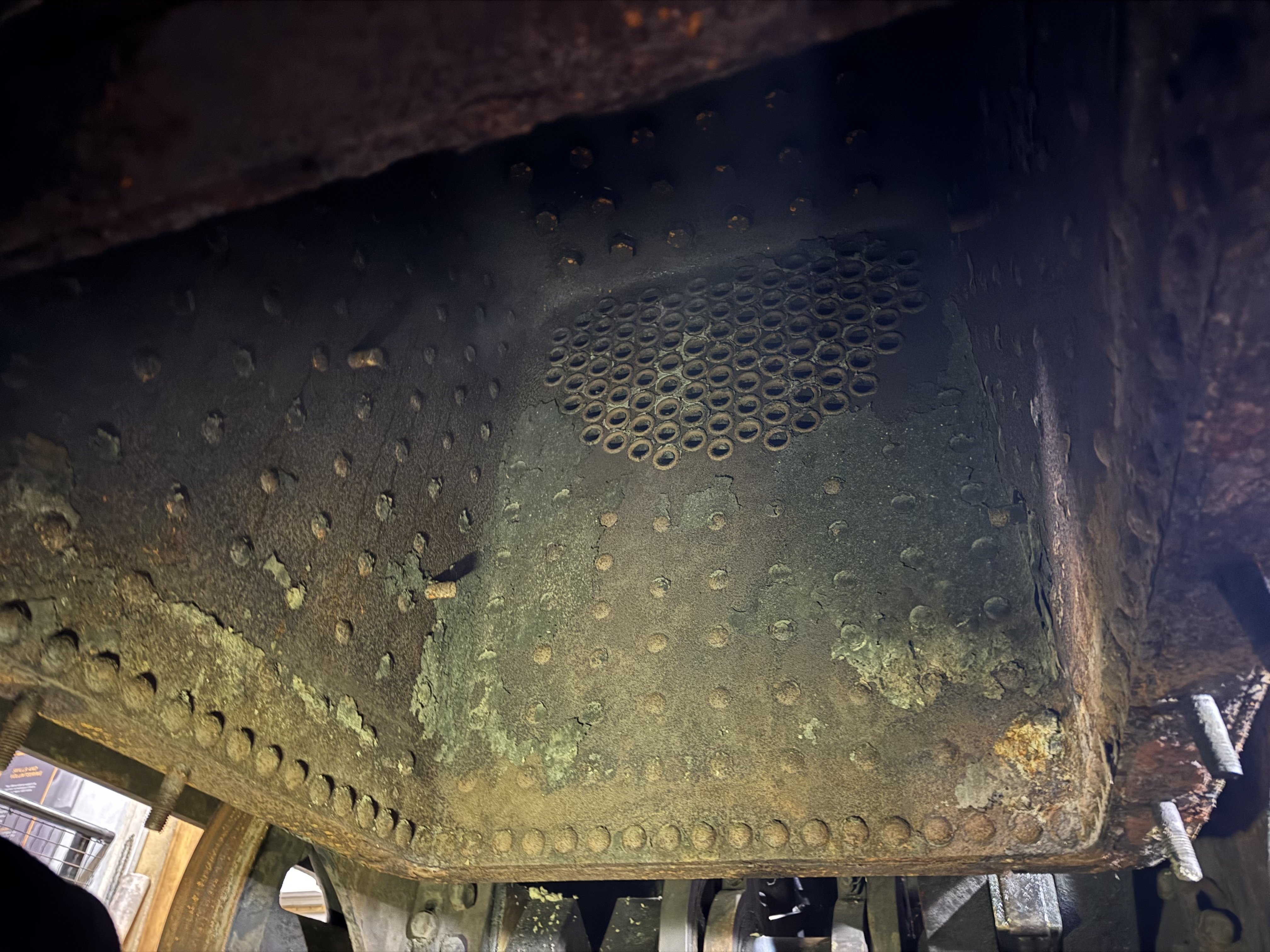

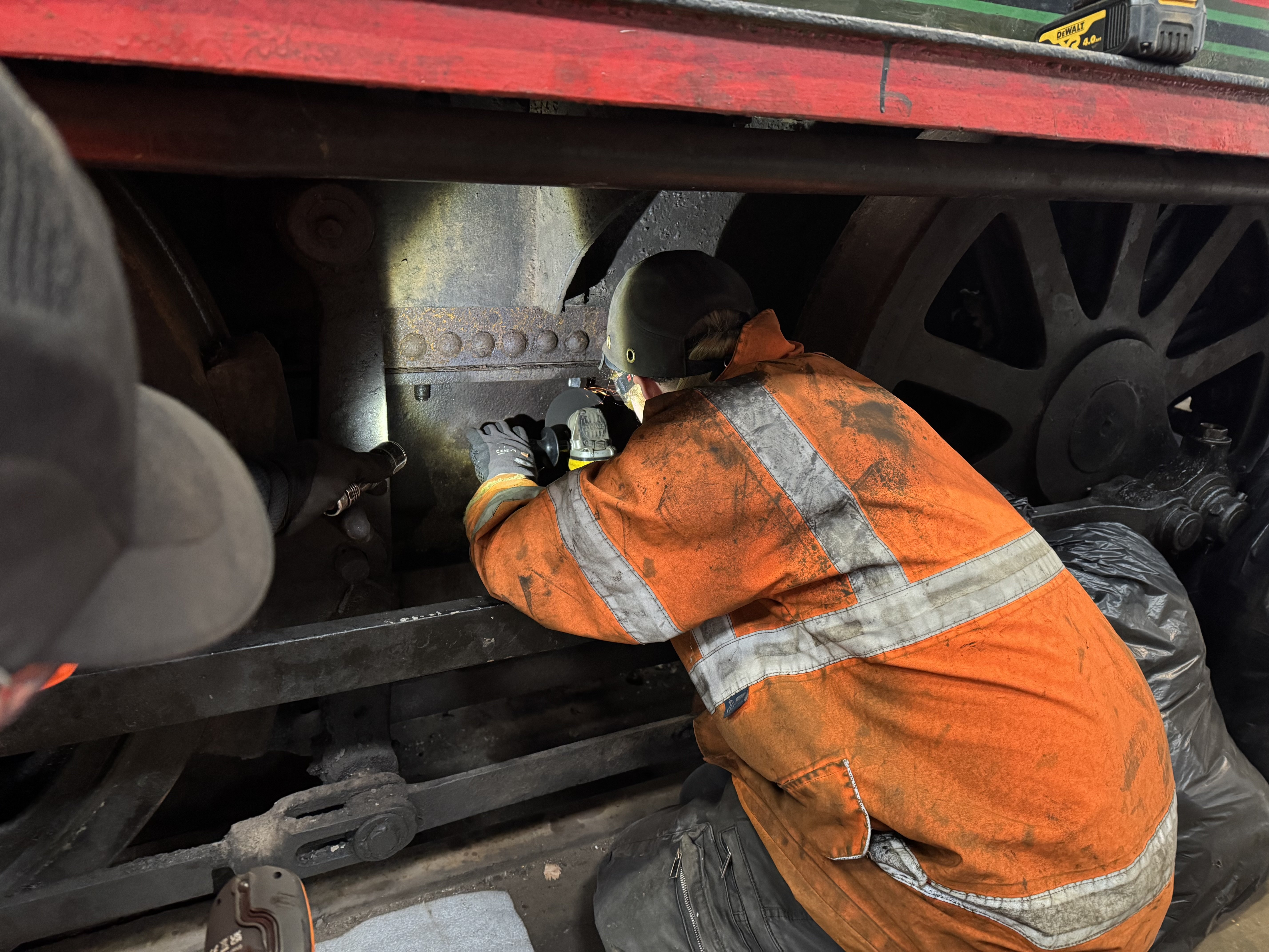

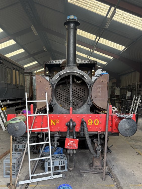

Westcorkrailway Posted February 12 Posted February 12 Munster perspective of 90 this weekend (some 12 inches to a foot scale modelling) Not long after arriving on the 0500 Ex-Cork car, we examined our options to get the bolts off, didn’t take long to realise that these nuts were too far beyond whacking them off, so modern methods as seen below were used To acheive the above photo, it quite literally took a day to do, trying to cut off the bolts without damaging anything else, most bolts needing to be cut on 3/4 times before being loose enough to knock off after another hour of hacking, the ashpan had been finally lowered into the pit here we get a unique look into 90s firebox 11

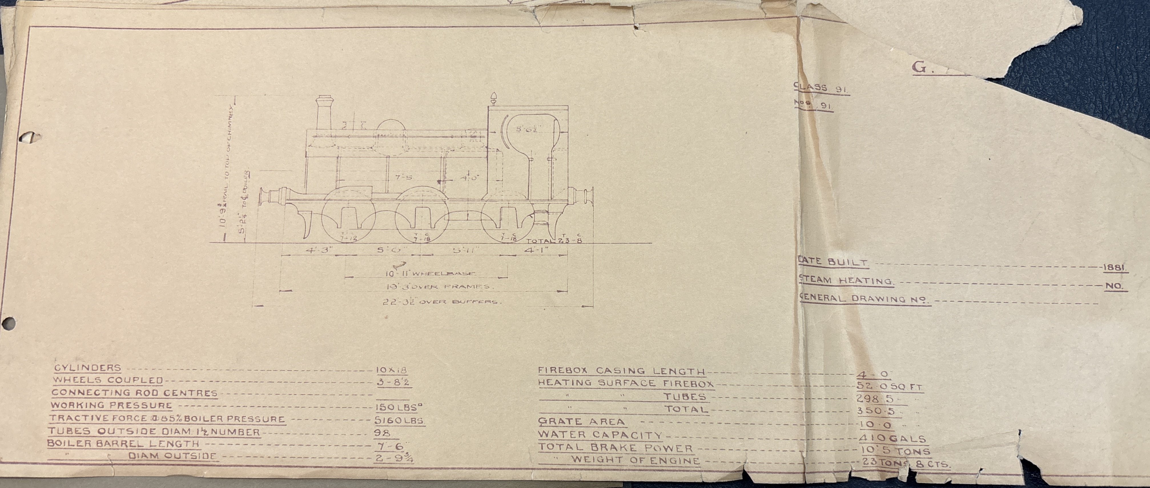

TheAccountOfMine Posted May 12 Posted May 12 (edited) Not many are aware that no.91 - a sister of 90 - was rebuilt into a slightly awkward looking saddle tank. Originally authorised in 1878 as C2, along with a second engine, C3, the GS&WR’s acquisition of the Castleisland Railway in 1879 lead the “C” numbering sequence (likely an abbreviation for “Castleisland”) to be dropped. The pair would be out-shopped in April / June 1881, carrying the numbers 91 and 92 respectively. 91 carried a coach-portion similar to 90’s, whereas 92’s had seats lining the sides. Unlike 92, which retained the coach-portion until withdrawal in 1945, 91 was rebuilt in 1924 with a saddle tank - a strange choice given that 90 had been rebuilt as a side tank, not to mention nos.99 and 100, which had been built as side tanks in the 1890/91. I’m not aware of any official reason as to why a saddle arrangement was chosen. Whatever the case, the engine lasted until 1930 before withdrawal, leaving the saddle tank saga as an odd footnote in the history of the 90 class. Edited May 12 by TheAccountOfMine 8
Mol_PMB Posted May 13 Posted May 13 Here’s a photo of the diagram of 91 in the IRRS archives. This is just a phone snap, it’s not flat or square so not suitable for scaling dimensions. Looking at the photo you can see how the saddle tank gave better maintenance access to the clacks and reverser linkage than a side tank would have done. Also better access to the inside motion from above. The awkward saddle dimensions may have been chosen to minimise alteration to the pipework and boiler fittings? However, I think the side tanks would give better weight distribution. 4
Rob R Posted May 13 Posted May 13 It does seem to have an "I bodge it and run" quality to it. Was the saddle tank just lying around the works , off a long scrapped loco?
Mol_PMB Posted May 13 Posted May 13 (edited) 13 minutes ago, Rob R said: It does seem to have an "I bodge it and run" quality to it. Was the saddle tank just lying around the works , off a long scrapped loco? Saddle tanks have to fit over the boiler, dome, safety valves, and in this case chimney. It's rare to find a secondhand one that would fit a different loco. Edited May 13 by Mol_PMB 2
Rob R Posted May 13 Posted May 13 I appreciate that they usually have to be made to fit but that one doesn't seem to fit very well... 1
Westcorkrailway Posted May 13 Posted May 13 Looking at how it fits over 92s boiler perfectly, and that it’s designed so that all the necessary linkages are exposed lends me to beleive it was actually custom made for the J30 1 1

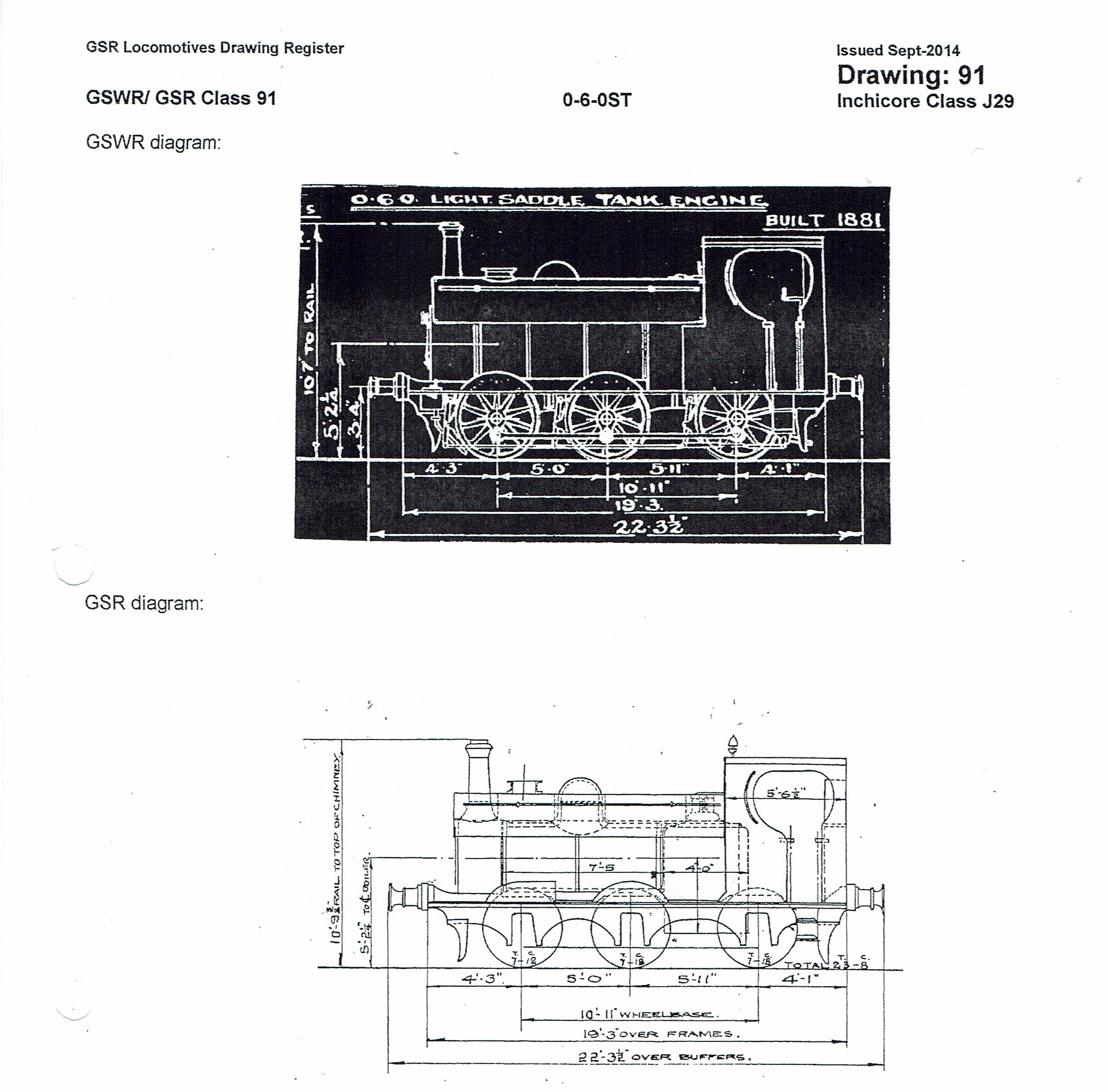

Westcorkrailway Posted May 14 Posted May 14 19 hours ago, Mol_PMB said: Here’s a photo of the diagram of 91 in the IRRS archives. This is just a phone snap, it’s not flat or square so not suitable for scaling dimensions. Looking at the photo you can see how the saddle tank gave better maintenance access to the clacks and reverser linkage than a side tank would have done. Also better access to the inside motion from above. The awkward saddle dimensions may have been chosen to minimise alteration to the pipework and boiler fittings? However, I think the side tanks would give better weight distribution. Interestingly, the drawing seems to show the wrong type of splashers (like those on 100) 2
Mayner Posted May 14 Posted May 14 3 hours ago, Westcorkrailway said: Interestingly, the drawing seems to show the wrong type of splashers (like those on 100) Interestingly the GSWR diagram shows No91 with the correct style of splashers. Cambridge Dictionary definition of diagram: a simple plan that represents a machine, system, or idea, etc., often drawn to explain how it works: Never scale from a drawing golden rule during a working life in construction and engineering Extract from GSR Locomotive Drawing Register issued IRN Sep-2014 Drawing 91 Inchacore Class J29 Ironically the Drawing more correctly GSWR & GSR diagrams Drawing 90 Inchacore Class J30 notes that there were several detail differences between 90/99/100 and notes that the only drawings available depict No90 while the actual diagrams appear to depict 99-100 with their curved topped tanks and extended splashers. 90-92 appear to have been built as 0-6-4T combined loco and carriages, 99-100 0-6-0 as tank locos for the Fermoy-Mitchellstown. 90 & 91 rebuilt as 0-6-0 following removal of carriage protion. It looks like the water may have been originally carried in a well? tank under the rear of the loco/carriage portion. Interestingly not a lot of difference in water capacity between 0-6-4T 370gal, 0-6-0T 430 gal and 0-6-0ST 410 gal versions, possibly 91 & 99 beccame a source of spares yo keep 92 (1945) 90, 100 (1959) going. 4 1

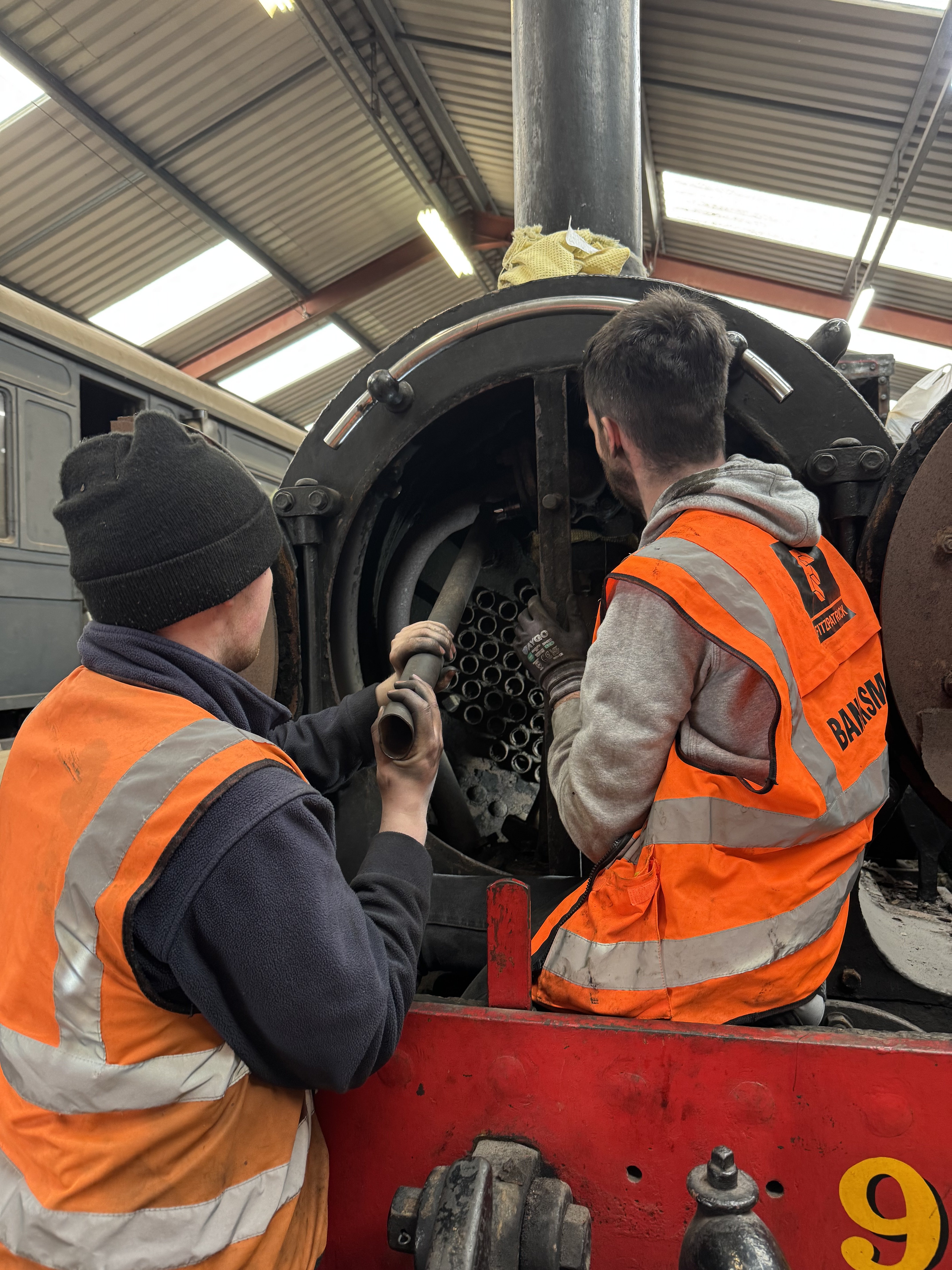

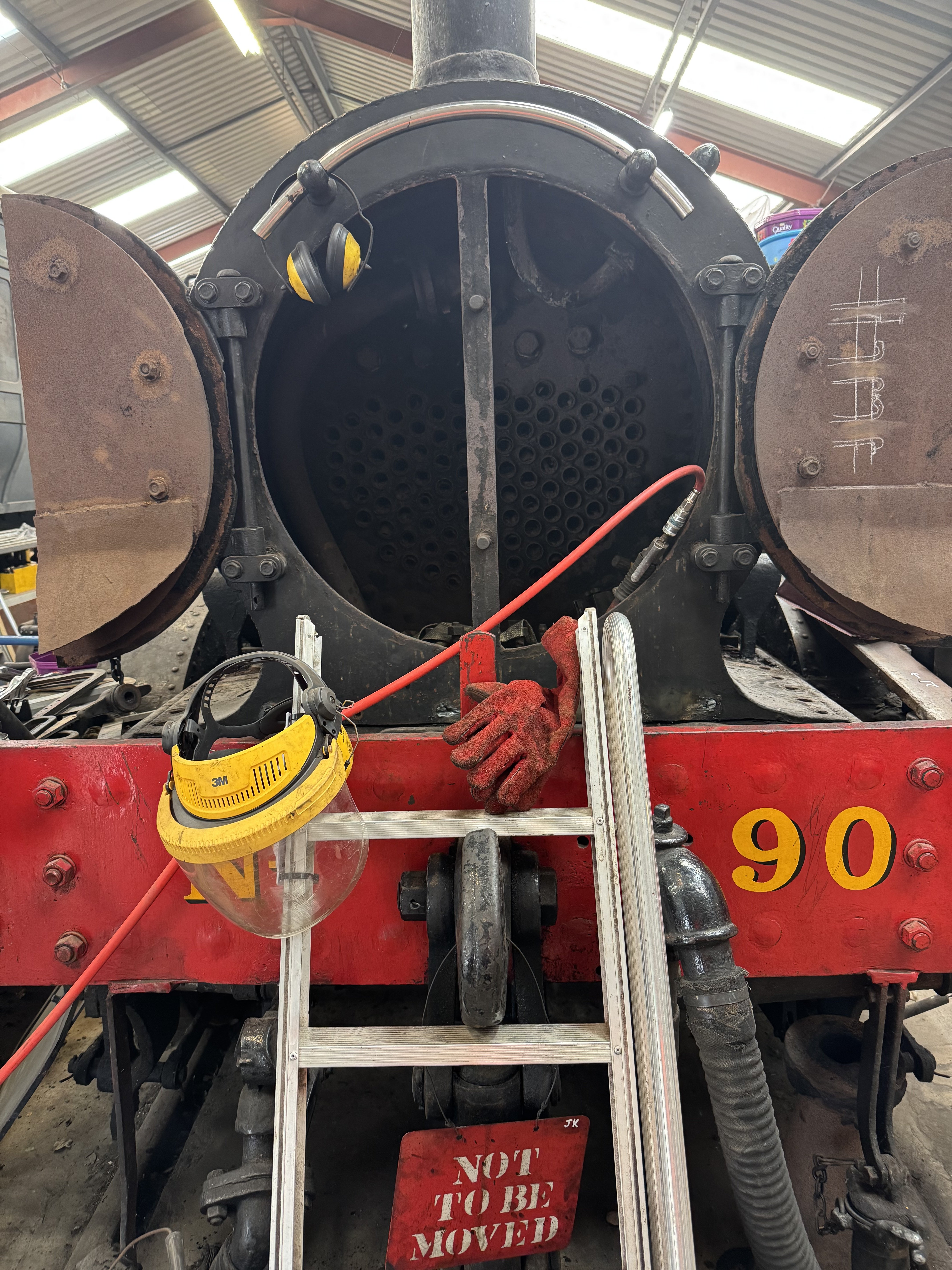

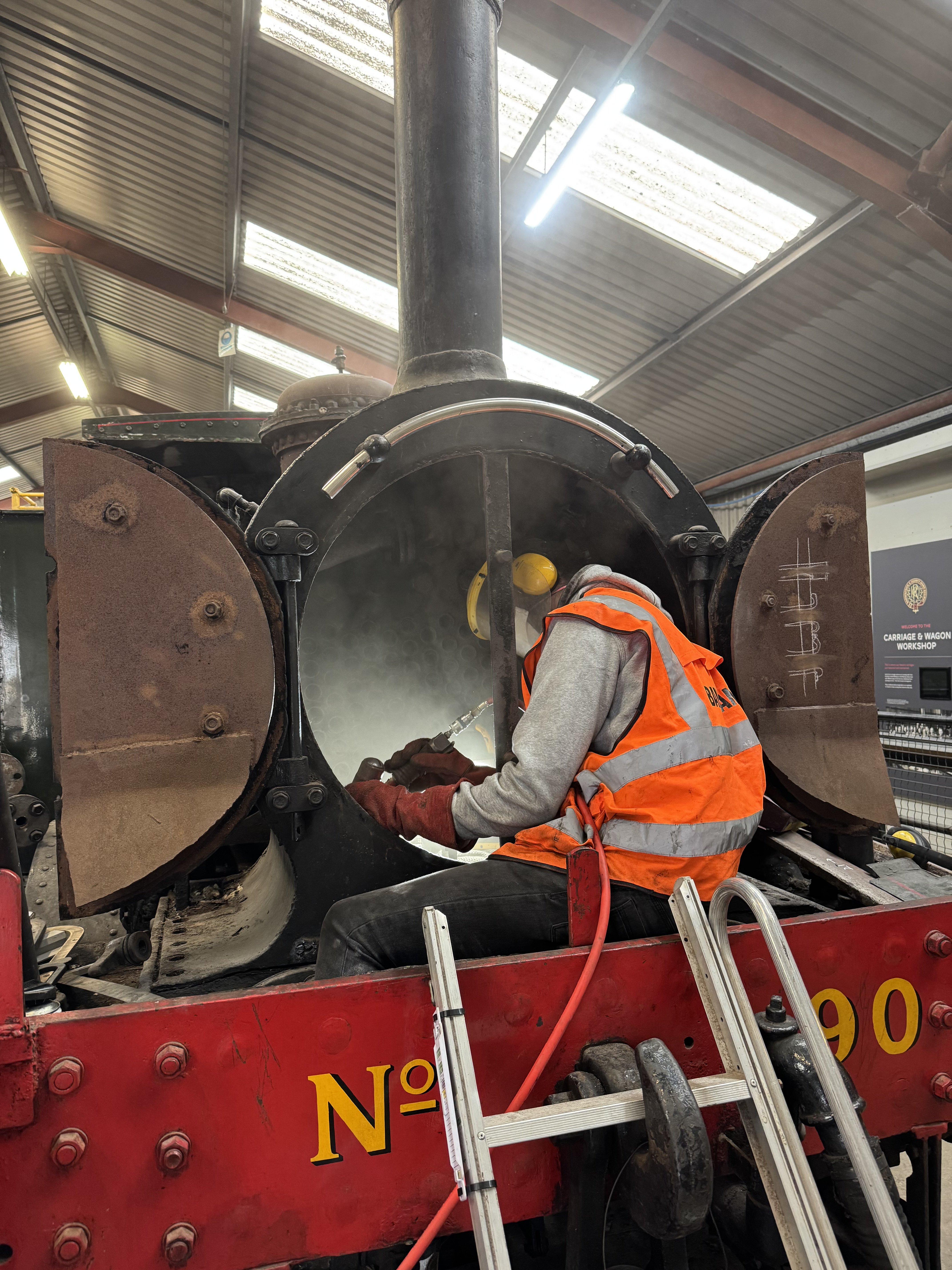

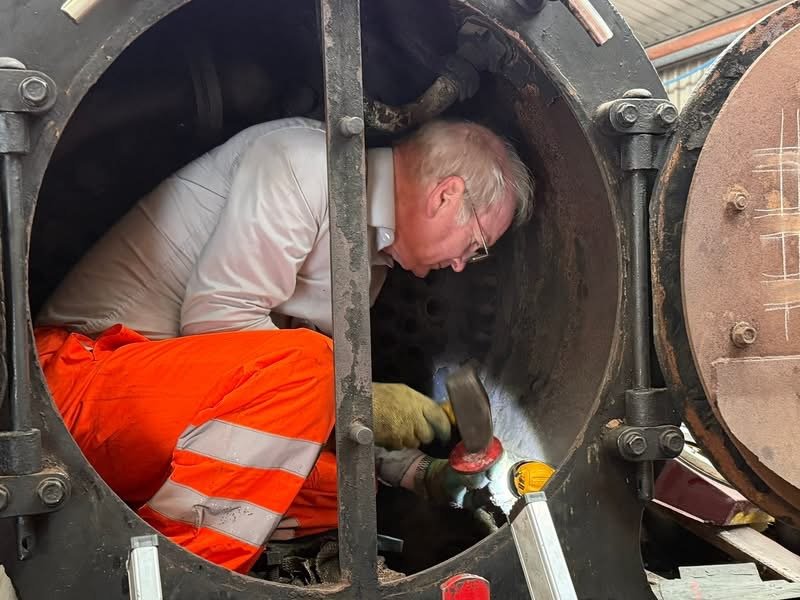

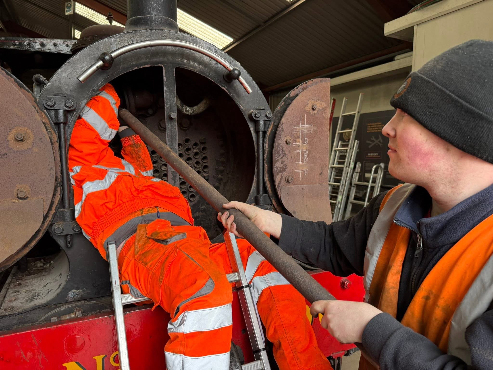

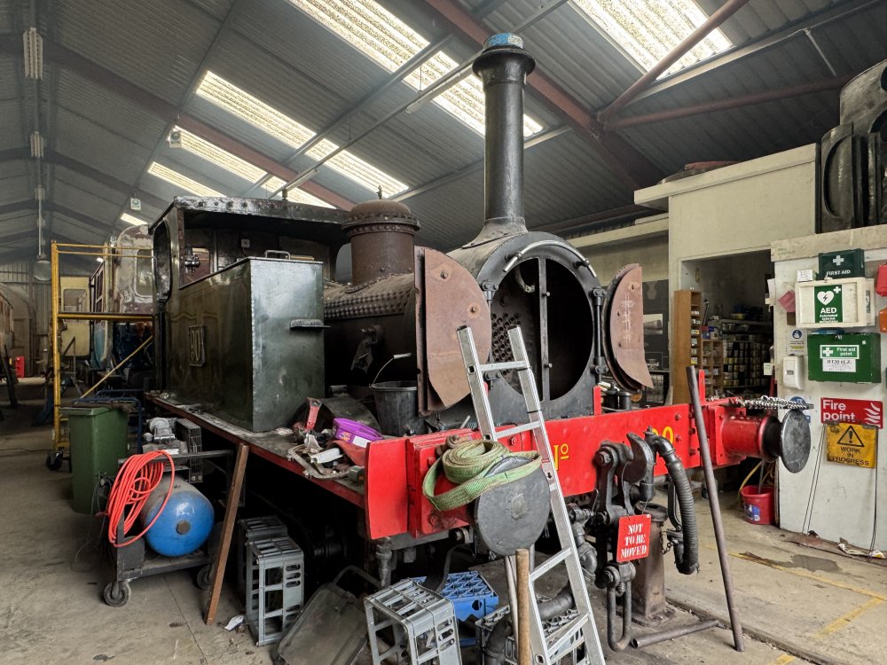

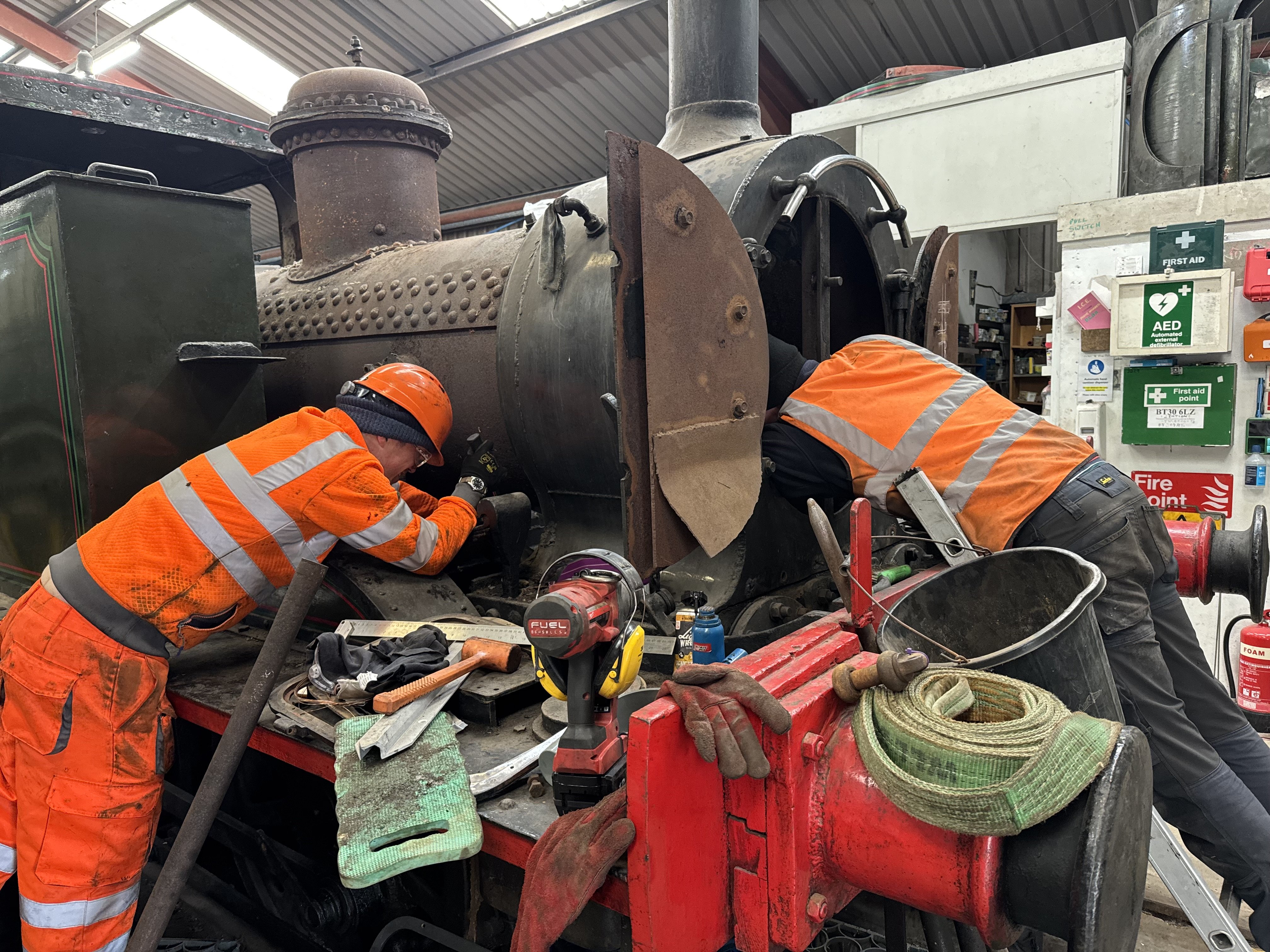

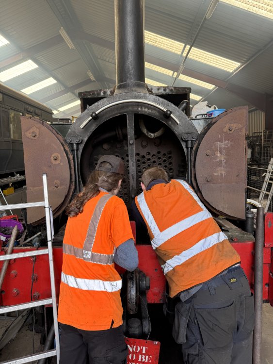

GSWR 90 Posted May 26 Author Posted May 26 The dismemberment continues – the blastpipe and blower have been removed from inside the smokebox 8

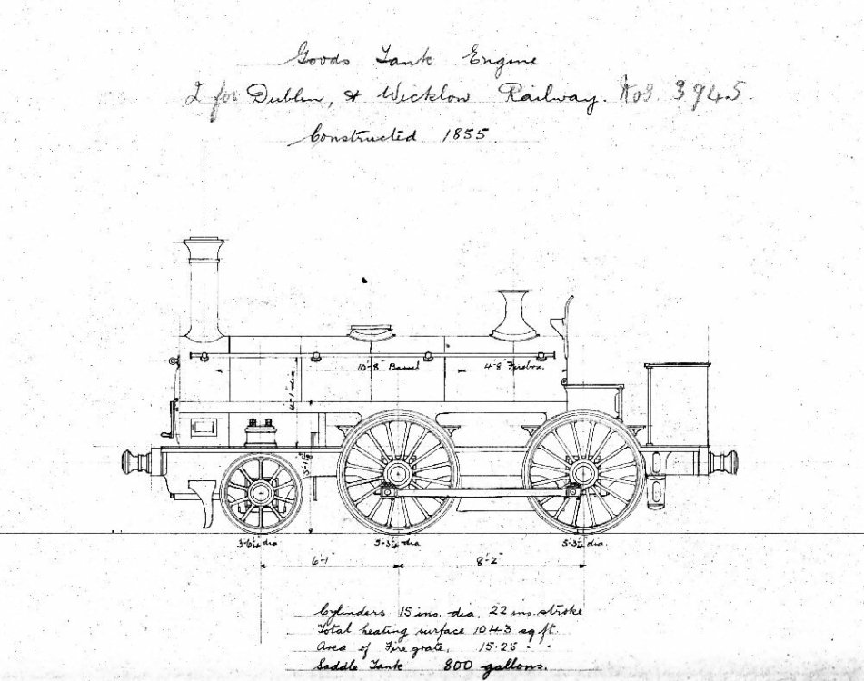

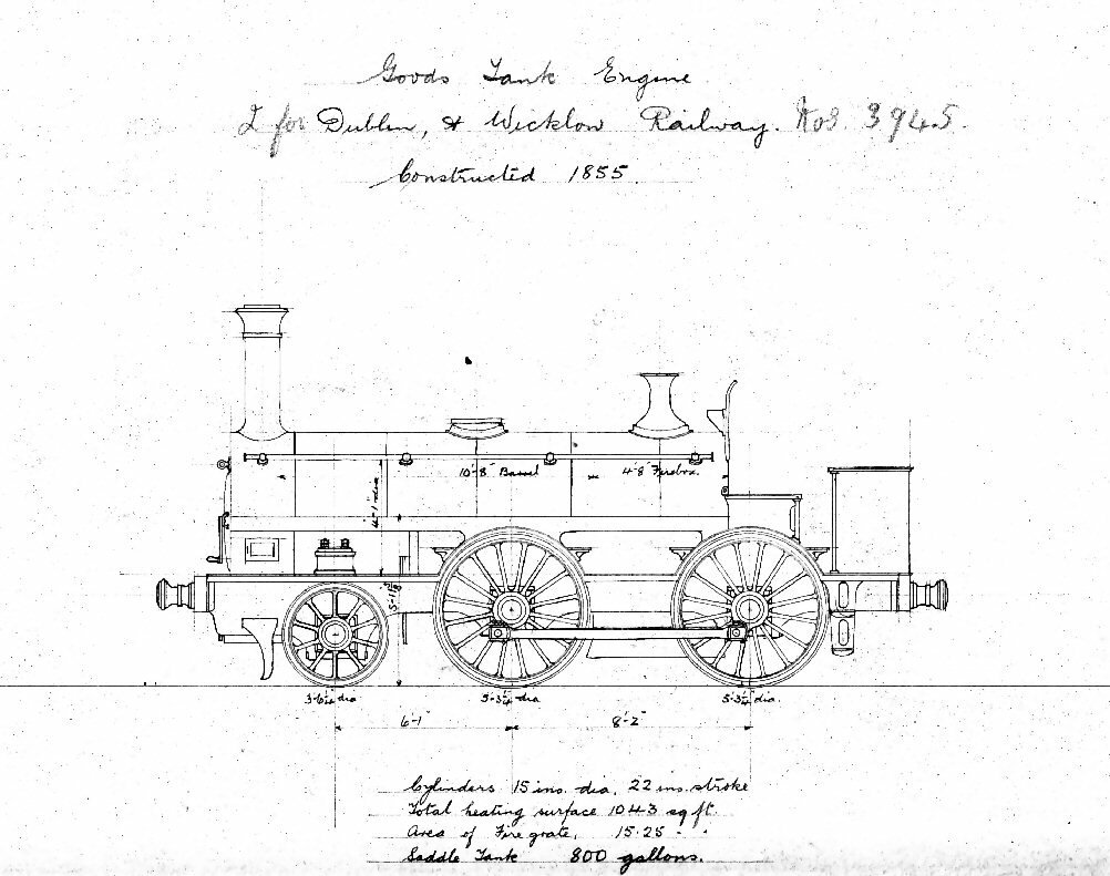

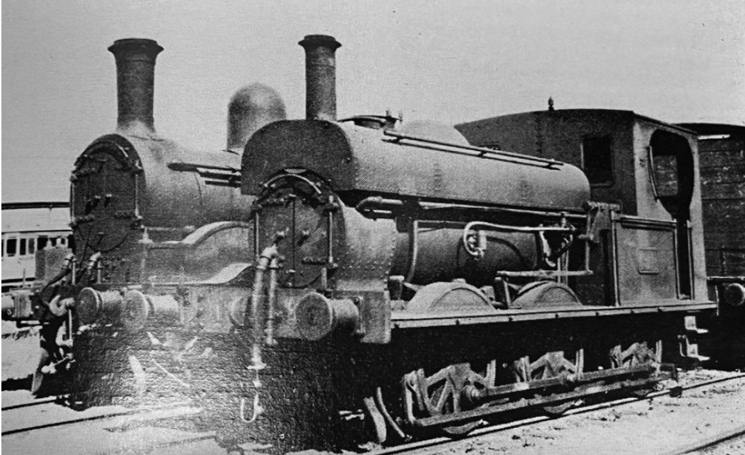

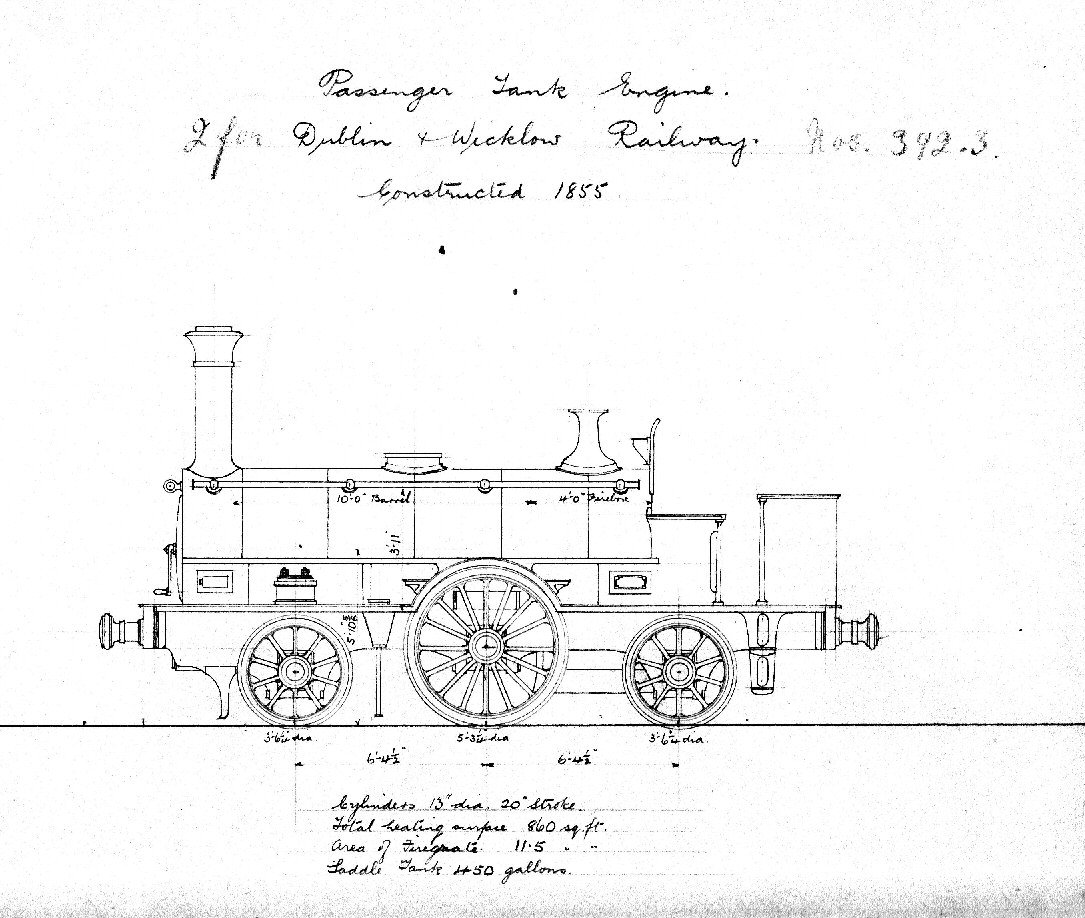

Killian Keane Posted May 26 Posted May 26 On 13/5/2026 at 2:41 PM, Mol_PMB said: It would be interesting to make a list of those that worked in Ireland. There were several in Cork and Kerry over the years, including the Bandon Yanks, the Allman's locos, and the former Shamrock and Erin. Guinness, LP&HC and Courtaulds were other users of the type. The Vulcan Foundry supplied four to the Dublin and Wicklow in 1855, two of the 2-2-2 type and two 2-4-0s 6
