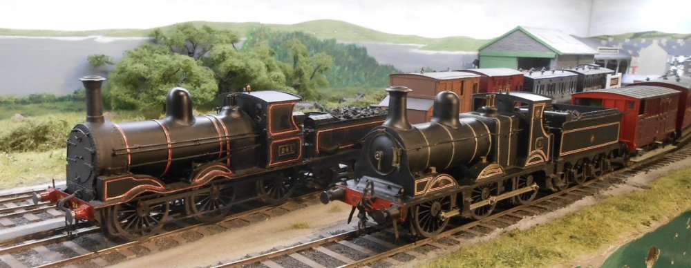

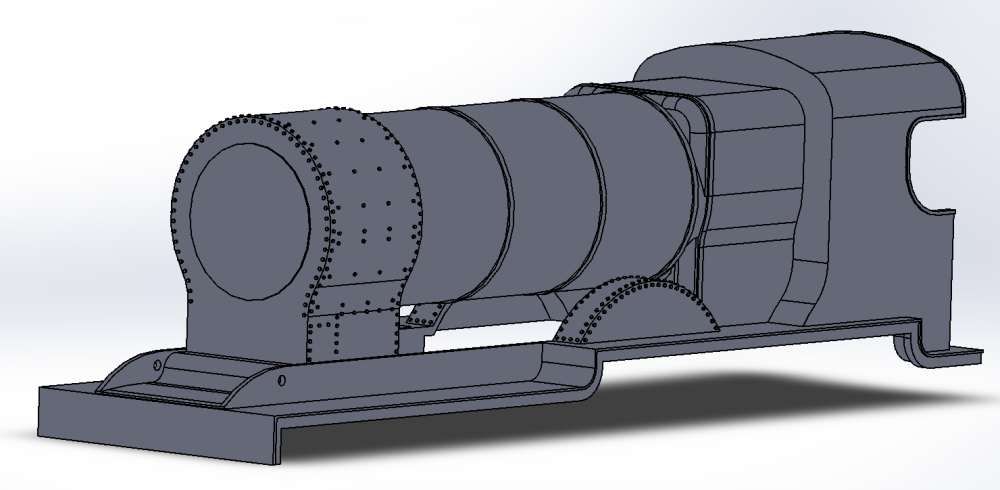

Killian Keane Posted April 15 Share Posted April 15 (edited) Here is a project Ive been working on with @GSR 800 for some time, its getting to the stage where the work in progress images are starting to be worth showing, an 800 for 00 gauge to fit the hornby Royal Scot chassis, consequent to the use of that chassis, the front has had to be shortened by 2mm between the bufferbeam and the front of the smokebox, other than that its the intention to have it accurate as near as possible rivet-for-rivet When posed next to a loco 46 years its elder (and much more my usual type of modelling, again a work in progress), you get an appreciation for the immense size of the prototype Edited April 17 by Killian Keane 13 6 Quote Link to comment Share on other sites More sharing options...

Mayner Posted April 16 Share Posted April 16 The loco posed next to the 800 caught my eye, looks suspiciously like an ex-Waterford Limerick and Western 0-6-0. Nice contrast to the J15 "Standard Goods" a number of these locos survived in service into the late 1940s working goods trains between Limerick-Waterford and Tuam, with another based at Mullingar on the Midland. Presumably intended to fit on an Oxford? Dean Goods chassis. 2 Quote Link to comment Share on other sites More sharing options...
Killian Keane Posted April 16 Author Share Posted April 16 1 hour ago, Mayner said: The loco posed next to the 800 caught my eye, looks suspiciously like an ex-Waterford Limerick and Western 0-6-0. Nice contrast to the J15 "Standard Goods" a number of these locos survived in service into the late 1940s working goods trains between Limerick-Waterford and Tuam, with another based at Mullingar on the Midland. Presumably intended to fit on an Oxford? Dean Goods chassis. Precisely correct on both the prototype and the intended chassis, my local line being the former WLW I had to have a loco from that line, very scarce information on them unfortunately so designing has been like pulling teeth, but its coming along 2 Quote Link to comment Share on other sites More sharing options...
BosKonay Posted April 17 Share Posted April 17 On 16/4/2024 at 12:27 AM, Killian Keane said: Here is a project Ive been working on with @GSR 800 for some time, its getting to the stage where the work in progress images are starting to be worth showing, an 800 for 00 gauge to fit the hornby Royal Scot chassis, consequent to the use of that chassis, the front has had to be shortened by 2mm between the bufferbeam and the front of the smokebox, other than that its the intention to have it accurate as near as possible rivet-for-rivet When posed next to a loco 46 years its elder (and much more my usual type of modelling, again a work in progress), you get an appreciation for the immense size of the prototype Most impressive so far. If i might ask what demanded the 2mm compromise? Quote Link to comment Share on other sites More sharing options...
Flying Snail Posted April 17 Share Posted April 17 31 minutes ago, BosKonay said: Most impressive so far. If i might ask what demanded the 2mm compromise? Comparing design notes??????? Very impressive work by the way Killian and GSR - Nice to see the WLW in the mix as well as the Queens! 1 Quote Link to comment Share on other sites More sharing options...
Killian Keane Posted April 17 Author Share Posted April 17 6 hours ago, BosKonay said: Most impressive so far. If i might ask what demanded the 2mm compromise? Thank you, the 2mm is down to the royal scot being shorter than the 800 mainly in the front bogie, if I'd have made it the full length I was concerned about the overhang of the front buffers etc on curves 2 Quote Link to comment Share on other sites More sharing options...
Killian Keane Posted April 17 Author Share Posted April 17 The WLWR loco in closeup, with its tender for anyone interested 4 4 Quote Link to comment Share on other sites More sharing options...

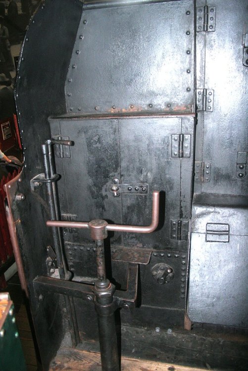

Killian Keane Posted Friday at 16:53 Author Share Posted Friday at 16:53 Ive had some trouble establishing whether the WLW goods locos had screw or lever reverse, does anyone know? Quote Link to comment Share on other sites More sharing options...
Andy Cundick Posted Friday at 17:28 Share Posted Friday at 17:28 As a rule goods locos have lever reverse as its much easier on the crew than screw (rather poetic that ) Andy Quote Link to comment Share on other sites More sharing options...
Mike 84C Posted Friday at 21:19 Share Posted Friday at 21:19 Andy , for shunting engines I'd agree, WR Panniers etc; but look at the position of the reach rod from the cab to the motion behind the splasher. At that angle I think screw reverse is very probable because the pin joints to make the mechanism work would mean a reversing lever handle and catch taller than a man. I think something like a spoked wheel as on an L&Y A class 0-6-0. Mike 1 Quote Link to comment Share on other sites More sharing options...
Rob R Posted Friday at 21:35 Share Posted Friday at 21:35 Locos of the GS&WR mentions that they were used on the fast fish specials from Fenit for which screw reverse would be more useful. The resources section has a copy of the "Engineer" drawing of Robinson's 240 which shows the Screw Reverse nicely. Rob Quote Link to comment Share on other sites More sharing options...
Mayner Posted Friday at 22:39 Share Posted Friday at 22:39 (edited) Cannot check for cab photo as IRRS Flickr site is closed for editing at the moment. Richards Chown's model on WLWR No 2 (later 222) in its original conditions is fitted with a screw reverser. There is a photo of the cab interior on 5 Nov 2020 posting on David's thread. Its likely that Richard's model is based on a Kitson builders drawing obtained from Leeds or NRM York Edited Saturday at 05:22 by Mayner 1 Quote Link to comment Share on other sites More sharing options...
