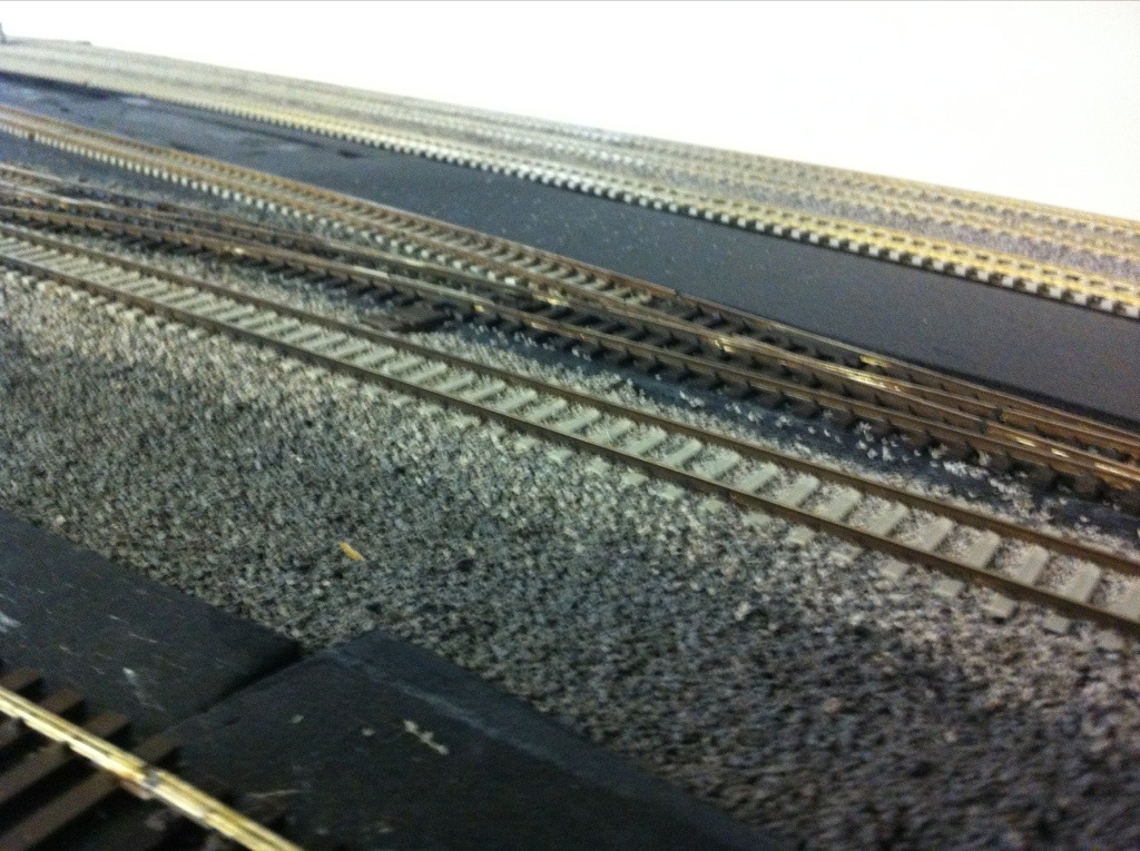

BosKonay Posted October 25, 2012 Posted October 25, 2012 Small update - did some ballasting, and painted the railsides of the perway sidings with the Woodlands Scenics 'steel rail' pen (still wet mind you)

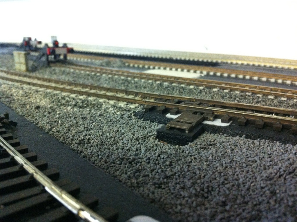

BosKonay Posted October 25, 2012 Posted October 25, 2012 Will see how it looks when dry, also painted and installed some knightwing point level base thingies
RedRich Posted October 25, 2012 Posted October 25, 2012 Will see how it looks when dry, also painted and installed some knightwing point level base thingies It looks good Stephen and it's really coming to life. Rich,
BosKonay Posted October 25, 2012 Posted October 25, 2012 One thing I would say is that it was very fast and very easy to use. Shake the pen, take off the lid, run it down the rail sides (the application is designed to slot easily in) and you're done. Very clean, no fuss and good coverage (comes with a spare tip too). I think with a good wash over of dilute track dirt and then an attack of the airbrush it should look ok.
Kirley Posted October 25, 2012 Posted October 25, 2012 Excellent finish with the ballast Stephen. I'm sure you'll remember to clean the top of the rails as soon as you use the paint pen, I missed some parts and had to scrape the top of the rails to get good contact again.
BosKonay Posted October 25, 2012 Posted October 25, 2012 I have a lump of 2x2 in a jar of white spirits It's the perfect size to run over the rail tops works great
BosKonay Posted November 1, 2012 Posted November 1, 2012 Another coat and the woodlands ‘steel rail’ color is looking well. Might even need another coat. I reckon three coats, with letting the rails dry fully in between, and you've a good rail base for then spraying over some grime and oil stains...
Broithe Posted November 1, 2012 Posted November 1, 2012 Another coat and the woodlands ‘steel rail’ color is looking well. How is the nib lasting? What's it like for getting in near frogs, etc?
BosKonay Posted November 1, 2012 Posted November 1, 2012 The nib was 'destroyed' by the second coat of the sidings and points in the photos - about 10 feet of track and three points. Luckily, they ship the pen with a spare, so I should be able to use it until it's empty. The nib is a little large for the frogs, etc, but you can get decent coverage, and I plan to cover up any gaps with grime from the airbrush. In it's favour it's clean, simple, you get very good coverage with a few coats, and no overspill, and it's very very quick to use. overall, I'd recommend them.

irishthump Posted November 1, 2012 Posted November 1, 2012 How is the nib lasting? What's it like for getting in near frogs, etc? I found them very easy to use myself, but the nibs don't last very long. I find the chairs on the sleepers tend to chew them up! They should really include more than 1 extra nib. I would also recommend getting an airbrush to weather the track rather than using aerosols, unless you have very good ventilation you are going to sufer from the fumes a spray can gives off. (Speaking from experience here!)
ttc0169 Posted November 1, 2012 Posted November 1, 2012 Layout is coming along nicely Bos,your track looks very realistic. That weathering pen is great,although I've also found the nib didn't last long either..
irishthump Posted November 1, 2012 Posted November 1, 2012 fumes..... sounds like fun Believe me, no fun at all in a confined attic space! Can I ask, in that first picture are you scratchbuilding the point levers and ground frames?
BosKonay Posted November 2, 2012 Posted November 2, 2012 The levers and frames are a knight wing white metal kit. Very simple to fit. I've the levers in another box waiting for a luck of white paint.
BosKonay Posted November 2, 2012 Posted November 2, 2012 These are they http://modelshopbelfast.com/index.php/railways/oo-gauge/knightwing-b14-ground-frame-point-lever-bases-levers.html

josefstadt Posted November 7, 2012 Posted November 7, 2012 Absolutely fantastic! Stupid question time:confused:: what are the white things that look like the backs of tickets in the photos of the turnouts?
josefstadt Posted November 7, 2012 Posted November 7, 2012 Dummy point motors? No, the things under the track.
BosKonay Posted November 7, 2012 Posted November 7, 2012 They are small card 'inserts' that come with the Cobalt Motors. After you drill the hole for the motor armature to poke through, you are left with a big, 6mm hole - not good for ballasting! You slip the card insert under the point, and you get a neat little slot for the motor arm, and can then ballast safely without dropping ballast into the motor or under the board. They'll need a good whack of an airbrush too - you'd think they could have printed them with ballast (or even printed them grey )
