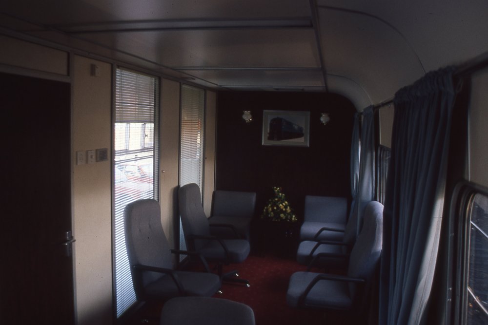

0 flange lubricator Posted June 9, 2016 Posted June 9, 2016 Managed to dig out a couple of pictures of the interior of the catering car 4401 mk2b from Aug 1991 1
0 jhb171achill Posted June 9, 2016 Posted June 9, 2016 That's excellent stuff. An oft-neglected type of vehicle....

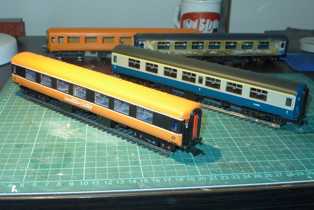

0 flange lubricator Posted January 28, 2018 Posted January 28, 2018 (edited) On 14/12/2014 at 2:43 PM, Frank_the_ piper said: Would be great to get photos of the prototype and your model! This has to be the longest time to reply in the history of this site ! my apologies I have moved house in the meantime and am only getting back to sorting modelling matters now attached is a picture of Irish Rail Mk2a 4113 which was converted from a bachmann Mk2a FK , I filled in the centre door and fitted an open seating arrangement which is how Irish Rail converted the original. Interestingly enough the Bachmann Mk2a FK BR number is E13468, Irish Rail 4113 original BR number was E13469 the next in sequence . Edited January 28, 2018 by flange lubricator 3 1 1 1
0 Noel Posted January 28, 2018 Posted January 28, 2018 That's an excellent conversion and an absolutely superb respray. Top class. 1
0 PaulC Posted January 28, 2018 Posted January 28, 2018 Stunning work there Mr Lubricator. Looks like there are a few more conversions pending on the workbench. Paul 1
0 flange lubricator Posted January 28, 2018 Posted January 28, 2018 2 hours ago, PaulC said: Stunning work there Mr Lubricator. Looks like there are a few more conversions pending on the workbench. Paul Cheers Paul yes working on another Mk2a FK 4114, I am also converting a hornby Mk2e to a Mk2c FO with brass overlays from http://www.erminemodels.co.uk/ 1
0 flange lubricator Posted January 28, 2018 Posted January 28, 2018 2 hours ago, Noel said: That's an excellent conversion and an absolutely superb respray. Top class. Thanks Noel I white primer to cover the BR colours then a few coats of RAL2011. 1

0 murphaph Posted May 17, 2021 Posted May 17, 2021 Looking more closely at 4401 and 4402 I'm not sure these aren't actually mk2c's. The exterior shots show a roof hatch which I believe the b's didn't have. This was to gain access to planned but never installed AC equipment. Likewise the internal shots show the lowered, flattened ceiling in the passenger compartment (interestingly stripped back in the buffet area). This lower false ceiling contained AC ducting (again never used in practice). The toilet windows are of the vent type like the b's but AFAIK some early mk2c's had these toilet windows rather than the later sealed AC type. I guess to the modeller trying to recreate these vehicles it makes little difference but the roof hatch should be included. The Lima mk2b correctly doesn't have this. 1
0 flange lubricator Posted May 17, 2021 Posted May 17, 2021 Your correct they are difficult to model as they are unique, both 4401 and 4402 are ex Br Mk2b FKs these coaches were completely gutted and rebuilt buy IE using new and replacement parts so Thaler had bits of everything on them 4402 had roof hatches fitted similar to the later Mk2 c/d , it also had a replacement door off a mk2d with vent at the top of the door very unusual.
0 murphaph Posted May 17, 2021 Posted May 17, 2021 Do you know what the hatch in the roof was actually cut out for? The original use in the mk2c was for AC plant that was in the end never installed in BR mk2c's. Was only 4402 cut into like this to add the hatch? The hatch is at the opposite end to the buffet itself, so I guess it's not directly related to that. IR really went out of their way to make them look like 2c's with the external roof and internal ceiling modifications lol. The only thing left about this coach that suggests 2b is the toilet window. For comparison the first three pics on this site appear to be a mk2c FK: https://citytransport.info/Compartment.htm For modelling purposes I guess it's easyish to add the "2c" hatch detail to the roof. The other mods "just" involve blanking windows mostly I guess. I am thinking of having a go at some of these "lightly modified" mk2's to practice my modelling skills before tackling something like a mk1 GSV conversion. 1
0 flange lubricator Posted May 17, 2021 Posted May 17, 2021 (edited) I think the roof hatch was possibly used for access to the water storage tank for the toilets? I dont think they went out of their way to make them like MK2c's the majority of the conversions were ex MK2c FO five of them so it was a matter of using similar interior's materials wise . If your doing a 4402/4401 buffet a good place to start is a LIMA MK2b FK while not perfect comparied to the Bachmann Mk2's this can be picked around the place pretty cheaply and with a little effort can be made into an acceptable converson . Edited June 8, 2021 by flange lubricator
