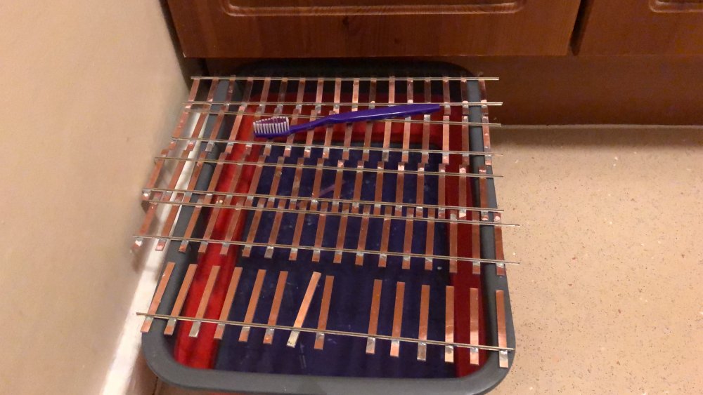

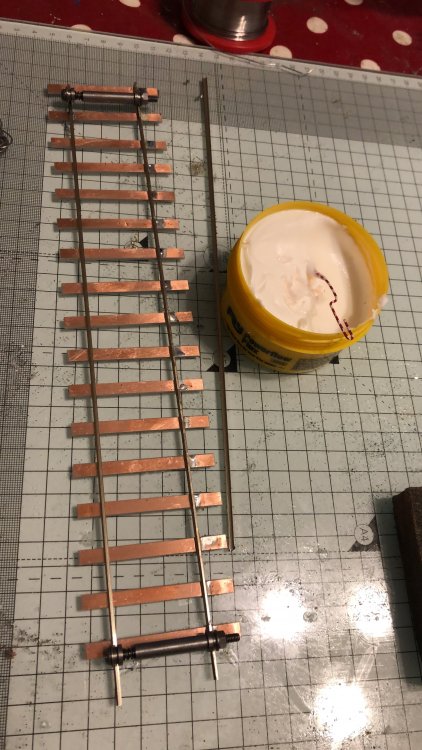

Colin R Posted December 12, 2017 Share Posted December 12, 2017 (edited) Hi guys I have been considering this myself as I really fancy a 21mm gauge layout, nothing fancy you understand, just something very simple to start with. One bit of advice I can give since I have build some 009 track work and that is don't rush the first point or section of track. The second bit of advice is to build some cardboard jigs for the track and point work, cardboard from the wheatie bangs or other breakfast cereals is good enough for this. For best results use a bit of 9mm or deeper plywood as a base for the give me a few days to sort all this out and I will try try and do an article on how to build track over Christmas. Edited December 12, 2017 by Colin R 1 Quote Link to comment Share on other sites More sharing options...

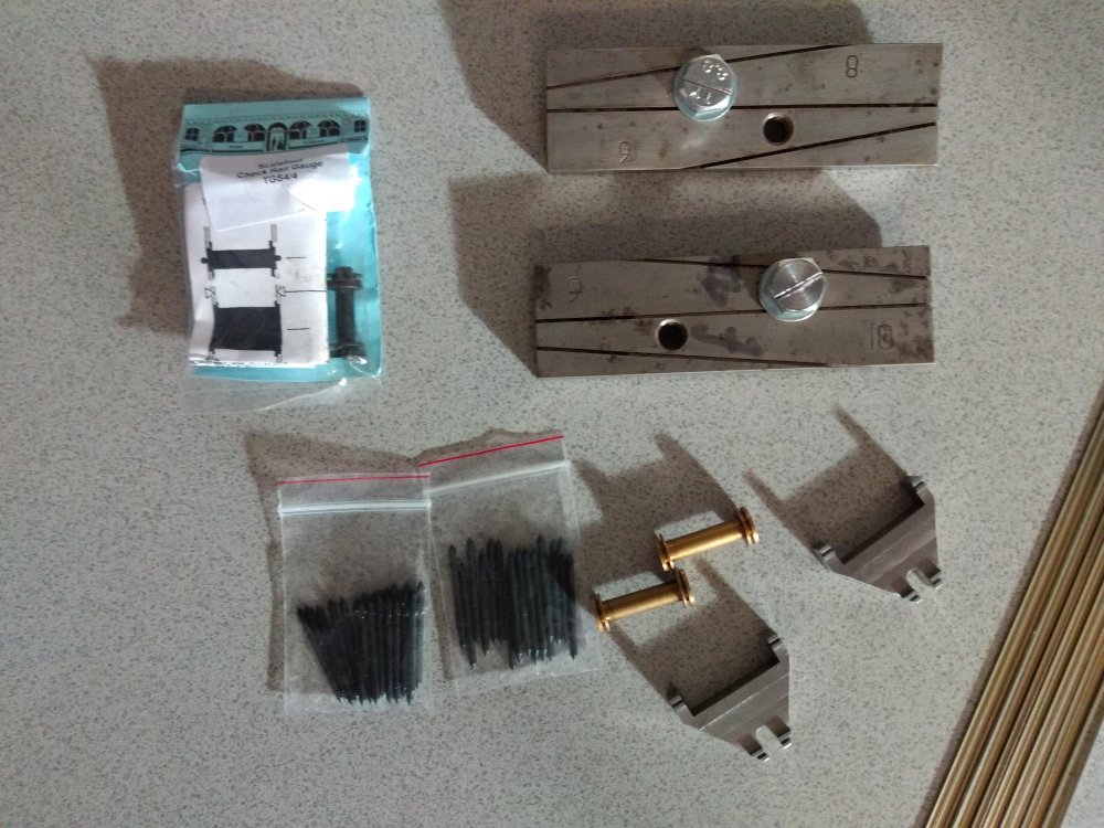

Mayner Posted December 12, 2017 Share Posted December 12, 2017 Building a small layout in 21mm gauge certainly won't melt the wallet, especially if you go for handlaid track. Its more a question of investment in time in acquiring and developing new skills with potentially a greater sense of achievement in building a unique model rather than going out and buying a mass produced rtr model regardless of the quality. The biggest decision would be in whether to work to S4 or the coarser OO/EM standard. The S4 Society have an established set of standards for laying trackwork including pointwork and setting up wheelsets for 21mm gauge where a modeller is largely left to their own devices if they work to the coarser OO/EM standard where different modellers use differing back to back and check gauge standards. SSM loco and coach kits including the GSWR 6 wheelers can be assembled to 21mm gauge, 28mm coach and wagon axles suitable for 21mm gauge can be sourced from the S4 society or Northyard in New Zealand, alternatively a standard OO gauge axle can be extended out to 28mm by cutting and sleeving with 2mm inside dia brass tube from Eileens Emphorium. Converting the majority of rtr coaches and wagons is a greater challenge as the chassis/bogies will need to be replace, but not to significant a factor on a small layout with a small amount of rolling stock. Steam locos are more of a challenge than diesels, but apart from a handful of types most Irish steam locos have to be scratchbuilt or built from kits anyway. The simplest approach would be to build a test track using soldered construction with copper clad sleepers available from SMP/Marcway in Sheffield, re-gauge a Murphy Models diesel and some IRM ballast or cement wagons to get a fell for the gauge and the work involved. Ardfert or Spa would make a nice simple test track/diorama to test the concept. SSM produce a very nice GSWR/GSR/CIE whitemetal open & a 30t van which would go nicely with a black and tan B141 or 181 on a North Kerry beet train John 8 hours ago, jhb171achill said: It most certainly is. I think that for those with either the skills to hand-build everything to that gauge, or with the wallet to pay for it, 21mm is the way to go. I'm at "costing" stage now. My own skills are most certainly not those of Mayner, David Holman, Eoin or others of this planet, thus some stuff I would have to have made. It's as simple as this. If I can afford it once all the bean-counting is done, I'm going for 21mm. If practicality dictates, through a melted credit card, that I can't afford it, 00 it is. 1 Quote Link to comment Share on other sites More sharing options...

Andy Cundick Posted December 12, 2017 Share Posted December 12, 2017 A few points (Pardon the pun) about doing 21mm gauge,like most things its a lot to take on board at first,however it really isn't that difficult.For a start my first attempt at track building was a 21mm point,The way i did was to buy an SMP point kit ,they come with a full set of instructions plans copperclad sleeper strip,rail,and even a crossing gauge.then what i did was blew the point plan up to 21mm gauge and built a point,and heres the scary thing it actually worked!up to that moment trackwork had been a black art worshipped from afar,incidentally the second one was a complete disaster as i was overconfident.I would sugggest as first go copperclad construction has a lot going for it as its easy to adjust track after construction with a touch of the soldering iron.My way of building the track is to mark the centres of the tracks directly onto the baseboards then lay the sleepers using double backed sellotape(the type used for laying carpet tiles).a 3ft steel rule on its side helps with marking out as bending creates its own transistion curve.Obviously a couple of roller gauges are needed,now the Scalefour Society do them,but they are easy enough to make yourself with some tube cut/filed to length and some washers with a bolt through the lot.There is a set of dimensions in Alan O'Rourkes "Modelling Irish Railways".I would suggest sticking to the EM standars then at least you can see the flanges.Back to Back gauges are usfull but a Vernier caliper does the job just as well,incidently i jst checked my back to back gauge which came from Terry McDermont back in the day and that comes out at 19.6mm. A lot has been said about the cost but especially if you build your own track it shouldn't cost any more than doing it in 00,especially if get into kit building.Andy. 1 Quote Link to comment Share on other sites More sharing options...

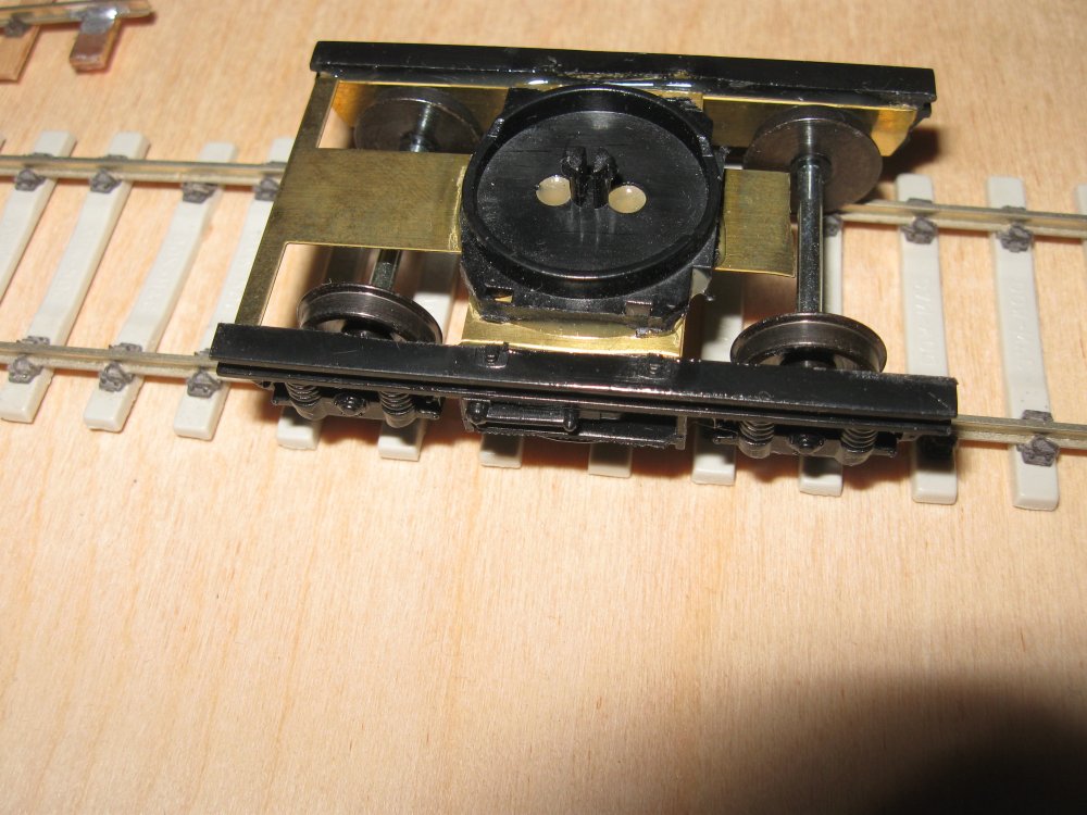

Andy Cundick Posted December 12, 2017 Share Posted December 12, 2017 Coach bogies are dead easy MJT do a range of basic compensated coach bogies in various wheelbases the two sides and centre bolster are connected together by wire so all i do is make the wire longer then solder up the whole lot,they work a treat and you can fix whatever cosmetic frames you want.As for wagon chassis i don't know whether SSM still do their 21mm RCH w irons but those plus the wheel spacing jig from Brassmasters makes the job easy,Andy. 2 Quote Link to comment Share on other sites More sharing options...
