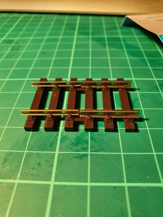

As a suggestion it might be worth buying a single length of Peco standard gauge concrete sleeper track with the right size rail, strip the rail carefully from the sleeper base and then once the PCB sleeper have been isolated from each side super glue the Peco sleepers on to the base.
I suggest you cut them just outside of the pandrol clip and glue the two ends on the outside of the track, the concrete section in the middle you will have to play around with until it looks right.
If that is too much faffing about for you, you might like to try just painting the PCB with a dirty concrete paint mix, at 2ft you will not notice just how accurate you have made them, if you plan to fill the space between with ballast.
This is only a suggest for you to think about.

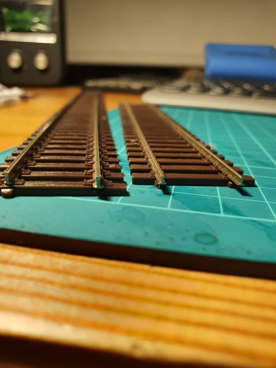

 There are a few things to consider with track beyond getting the gauge right. As Galteemore shows, ballasting and weathering make a huge difference, but choose you rail carefully too. Am fairly sure Rosses Point uses Code 100 flat bottomed rail, same as Belmullet, whereas the norm in 7mms scale is Code 124. Years ago, did an 0 gauge light railway with Code 100 track and got asked several times at shows if it was broad gauge, so just goes to show the effect of finer rail.
 Indeed, Peco 75 makes a big difference compared to 100. - though the improved sleeper spacing help too. Overall, for standard gauge, never mind broad gauge, Peco 100 is probably the least good option, followed by their 75, then the likes of EM and P4. For those who are too committed to 00, or just happy with the compromise, reducing the viewing angle helps a lot, as does careful ballasting and painting the rails and track the right colours. Things anyone should be able to do and probably a key step in turning a train set into a model railway.
 It remains however down to the individual and as long as you enjoy it, that is all that matters. No prizes for guessing where my own preferences lie of course!

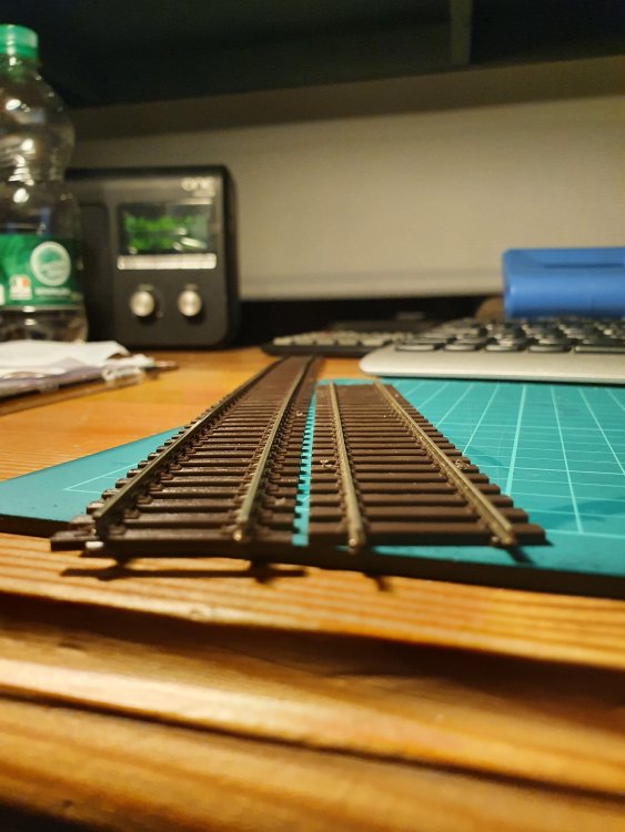

Hi Murph

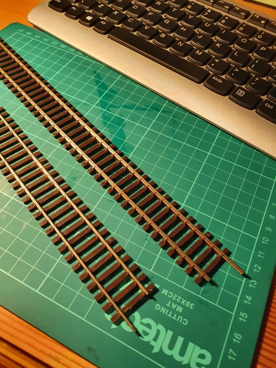

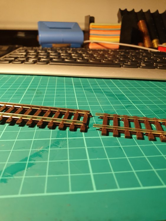

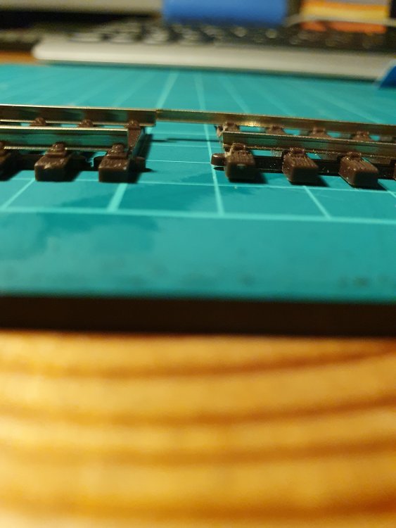

Heres a few photos of peco code 100 and code 75 side by side and piece of transition track ( from 75  to 100) to join them. As much as i'd love to go down 21mm route and make my own track ala David H, GM , JM et al....im just not at that level of modelling proficiency yet and i'd like to get something built in the near future....so im building a layout using code 100 in the fiddle yard and non scenic areas and code 75 in the scenic areas.....all modelling is about compromise to some degree - all comes down to the resources, skills and time you have or have not to spend....
Code 75 when well ballasted can look well and less like narrow gauge than code 100 usually does. Ironically some of the IRM stock with scale width wider bogies highlights how off 16.5mm track can look.

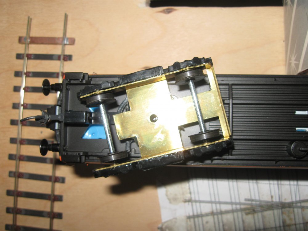

I have re-gauged coaches to 21mm gauge simply by widening the existing plastic bogies in addition to more complex methods.
Cheap and cheerful Hornby coach bogie widened with strip of plasticard, these were used to re-gauge a pair of Hornby Stanier coaches as a stop gap measure until I built more accurate stock.
The plasticard bolster provides a similar degree of resilience to a compensated or torsion bar bogie system.
Wheels re-gauged by cutting and sleeving axle with 2mm bore brass tube.
21mm bogie with MJT cast whitemetal bogie sideframes and MJT "Torsion Bar" bogie on Ultrascale wheels.
1mm plasticard packers were used to pack the bogie sideframes out to 26mm
These were used under a number of Worsley Works coaches including a Park Royal and a Laminate
21mm gauge rigid bogie frames for B4 bogies intended for use with MJT B4 whitemetal bogie sideframes.

I too did some etches many years back, originally for use with Lima sideframes. I converted a Murphys Cravens, but tried to keep the close couple mechanism, which meant I used smaller wheels to keep the ride height correct whilst resung the bolster. I would not use the same method again.
The bogie is on a bit of 21mm gauge track. The concrete sleepers are C&L with Peco code 75 FB track and pandrol fittings.

So my first few bits have started arriving...
Filing jigs, track gauges, 10m of bullhead rail and 28mm pinpoint axles from the S4 society (stung for vat by the customs unfortunately but not unexpectedly).
I managed to get a hold of Marcway (at home as the shop is closed) on the phone just now and placed an order for 1000 34mm copper clad sleepers and a few sheets of strip for the points.
Step by step on the way to 21mm.
  • Like 5
Have fun , building track  is generally therapeutic!  and like riding a bike once lessons over it is not forgotten, but then experiences kick in and progress can be quick. - But like bike riding falling off/ over the handle bars a risk - burnt fingers and not cleaning off flux properly  spring to mind.
