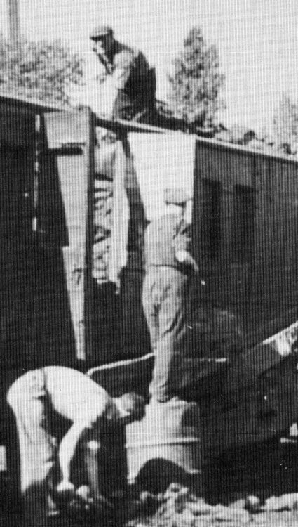

A copy of Trains, Coal & Turf landed on the door mat today and the method of un-loading is shown in Plate 1. The coach shown  has a set of double doors no doubt part of a Guards compartment still 'openable'
This is part of the photo. The photo credit is "courtesy of Gerry Beesley"
