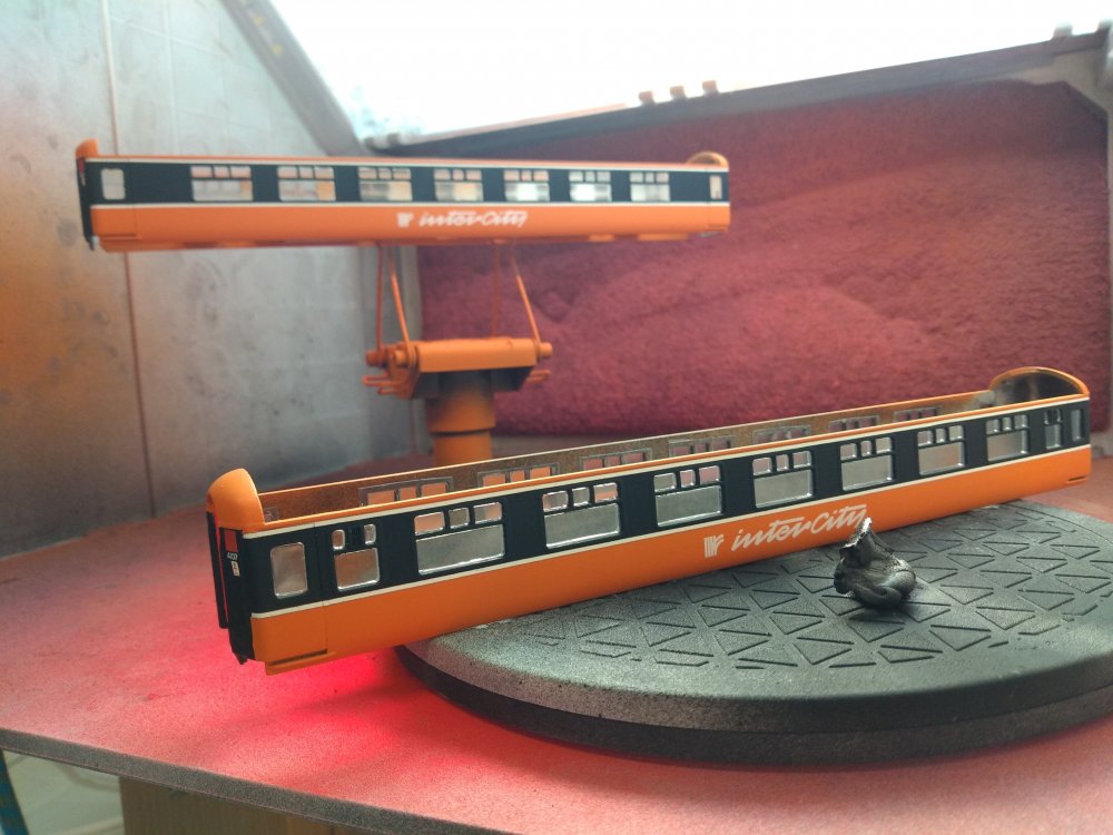

A first for me but seemingly a well worn path...preparing Lima mk2b coaches for respraying.
I'm removing the raised and obviously not prototypical paint moulding from these and filing out the windows to receive south eastern finecast flush glazing.
They were stripped in brake fluid which seems to do no harm to the plastic on this type of model.
I am trying rattle cans first and depending on the results I may or may not try an example with my as yet unused air brush!

Thx a lot chaps. The second one came out just as well. I can see that my 1mm masking tape was about half a mil short at the ends. I didn't notice it when masking up.
The next challenge (after they are fully cured) will be applying decals which I've never done before.

FL: I would like to get the roof vents right. Have you any suggestion for a source of scale vents though, or something else I might be able to make work? These two will be "simple resprays" to test the waters so I may just spray the roofs on these and then "up my game" on later ones. I can always throw them back in the brake fluid some day and redo them to a higher standard.
popeye, I used a RAL 2011 rattle can from Belton. I did replace the nozzles on all the rattle cans with low pressure types to reduce the amount of paint coming out. I don't know if this helped but it seemed prudent as these caps cost very little.

Thanks again guys. Very encouraging words also. I'm on the right track and it reassures me that spending more time on the prep won't be wasted by a catastrophic paint job. I was expecting all manner of bleed but only had it in one or two spots at the coach ends where a touch up will be under the weathering later anyway.

Thanks chaps.

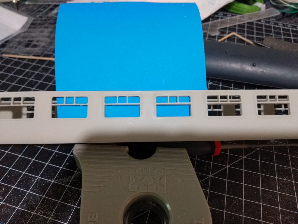

The white stripes are reverse masked with 1mm Tamiya masking tape. You can just spray the whole thing with white primer and mask this I suppose. I had no white primer to hand so primed in grey then sprayed white and reverse masked over this.
1mm in 4mm scale is exactly 3" which is what those stripes were in reality I believe.

Thx again gents. I should point out that I took extra time to fully burnish the edges of all the tapes with a cocktail stick, getting into any grooves and whatnot especially around the doors.
In a later iteration I intend filing off the handrails and door handles and fitting with brass replacements. I figure adding a bit of 3d detail this way will enhance a cheap model for very little money.

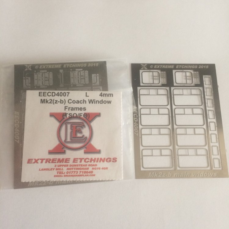

I think you should be very pleased with these.  I tried south eastern flush glaze on one but gave up as they had got old and brittle plus would not sit in the holes well - it looked a mess as you do not get a flat window- all the reflections were wrong.  I asked  along time ago about getting a Shawplan lazer glaze replacement - work in progress but nothing yet, so I have several coaches at the same stage as yours.

I do like the Mk2c conversion idea  makes for a neat job but IIRC the sides beteen airfix 2D and lima differ - I tried this mod on an early 80 class effort!.

I believe Shawplan did start production of the mk2c extreme etches but no lazerglaze. I am trying to balance the economic aspects as well.... lazerglaze or even the extreme etches are going to be worth more than the coach itself, so I said I'd use the flushglaze, accepting the extra filing effort into the bargain.

Indeed it takes a good evening to file out one coach so not a 5 minute job by any means.
I'm trying to source a small flat file with no profile on either of the thin sides. The Americans call these pillar files. I'm not sure what the proper description is of them on this side of the pond.
At present my small flat file passes nicely into the left and right top openings but it has profile all around so I have to be very careful not to accidentally file into the vertical bars.
If I had "safety files" I'd be a lot quicker.
The above photo also shows my first attempt at removing the upper paint moulding which is not at all prototypical. The trick I've found to cleanly remove most of these paint mouldings is to get the tip of the scalpel at the right angle and then pull the coach to me rather than pushing the scalpel away. I can keep my scalpel hand much steadier this way and there's little to no sanding required.

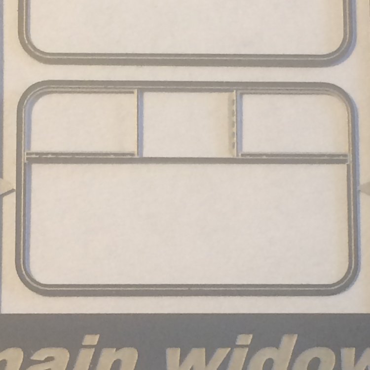

I would definitely try them if but I've read on RMweb that they are difficult to get from Shawplan. I asked previously in the questions section about them in fact but I think the question got lost in there. I was curious how one glazes them as there is no lazerglaze to suit the etches. Do you cut out acetate sheet and then glue it to the inside of the frame and then glue the lot to the coach side or how do they work in practice? The detail on them is cracking. Correct me if I'm wrong but they only go up to the 2b model. The mk2c coaches had those square AC toilet windows from the 2d's. The etch doesn't include those toilet windows, right?
