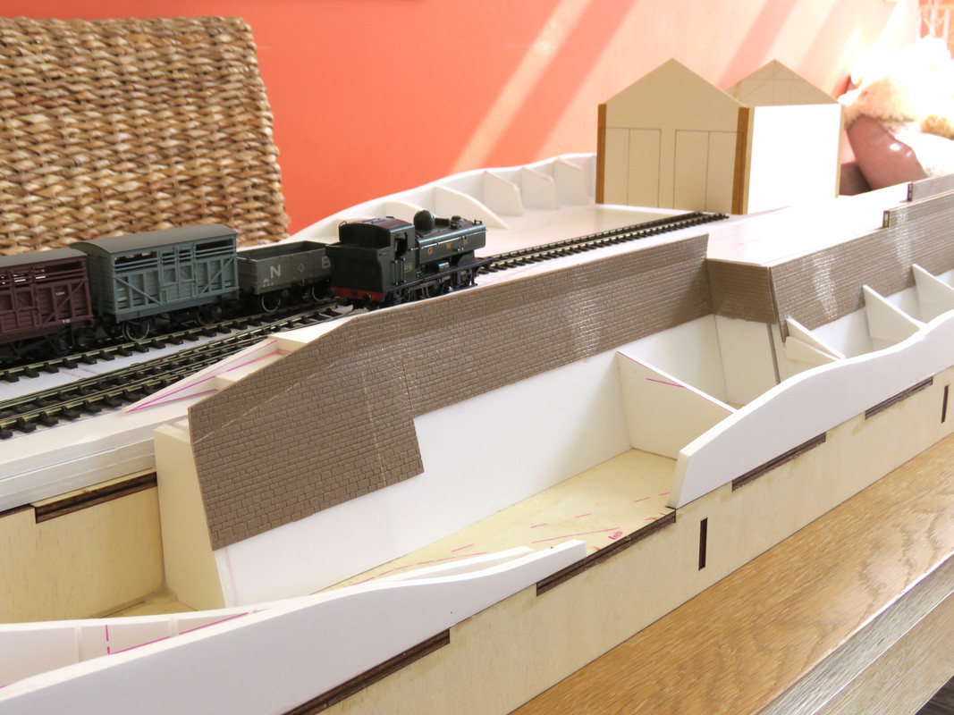

2996 Victor Posted August 17, 2022 Posted August 17, 2022 16 hours ago, Kevin Sweeney said: On the northern end the ground will rise 10 mm to the NW corner and drop 14 mm at the NE corner. The trackbed will remain flat. I'm not sure yet how I'm going to create this non flat landscape, but I'm experimenting with plywood templates, to give me the basic shape I've been using 3mm and 5mm thick foamboard on my 4mm/EM micro: This was a while ago and things have moved on a bit, but you can see the foamboard profiles. Easy to cut with a craft knife or scalpel, glued with Javis VeloSet quick setting PVA. Its light and strong and its easy to carve if you need to modify it once its in place. I've got mine from a seller on eBay - this is the link to the 3mm foamboard https://www.ebay.co.uk/itm/272000832907 Looking forward to see your progress! All the best, Mark 3
Kevin Sweeney Posted August 17, 2022 Author Posted August 17, 2022 9 hours ago, 2996 Victor said: I've been using 3mm and 5mm thick foamboard on my 4mm/EM micro: Looking forward to see your progress! All the best, Mark Thanks for the tip, it sounds easier to work than plywood. 1

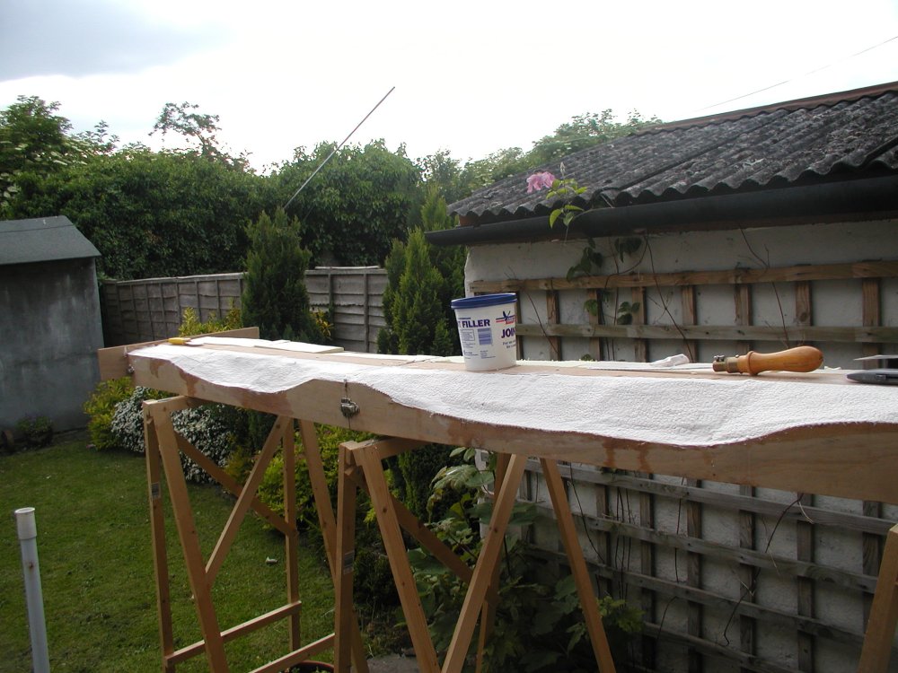

2996 Victor Posted August 18, 2022 Posted August 18, 2022 (edited) 21 hours ago, Kevin Sweeney said: Thanks for the tip, it sounds easier to work than plywood. It is! Much! I'd definitely recommend it. I've been covering the foam board formers with a lattice weave of wall paper lining paper, and then four layers of newspaper strip papier mache. It makes a pretty strong shell. Cheers, Mark Edited August 18, 2022 by 2996 Victor 2

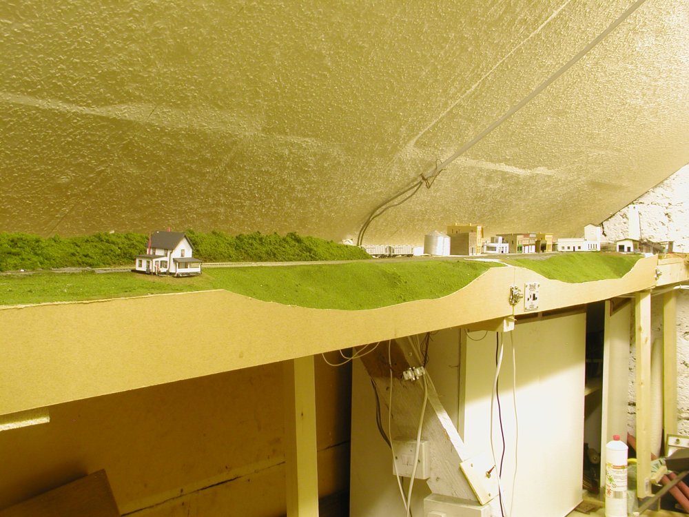

Mayner Posted August 18, 2022 Posted August 18, 2022 I generally use ply or stripwood framing for open top baseboard construction of where the railway is on an embankment. These days I cut the ply strips on a bench saw and use a jig saw for profile cutting and fascias My current dock layout uses similar baseboard construction 8

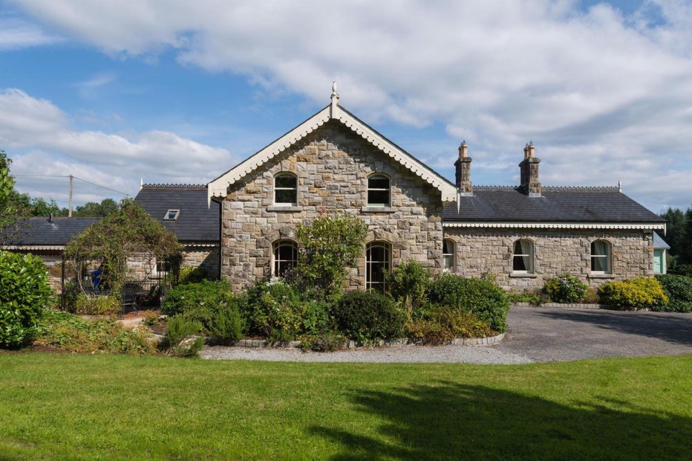

popeye Posted November 21, 2022 Posted November 21, 2022 I can't think of anything worse than putting all that modern crap on an old building, it just looks wrong. It would be better to leave it to crumble away. 1 1
jhb171achill Posted November 21, 2022 Posted November 21, 2022 8 minutes ago, popeye said: I can't think of anything worse than putting all that modern crap on an old building, it just looks wrong. It would be better to leave it to crumble away. The bit on the left is in keeping, if it had a stone finish. The Dermot Bannon thing in the foreground is light years beyond hideous. 1
Galteemore Posted November 21, 2022 Posted November 21, 2022 Glenfarne is the way to go. Can’t even see the join! 7 2
Kevin Sweeney Posted November 22, 2022 Author Posted November 22, 2022 Agree 100%. The extension is an ugly post-modernist monstrosity, which completely destroys the beautiful, classically designed lines of the Station House. Cavan County Council applied the exact same "heritage" planning principals to Farnham House, the greatest, most important and most intact of Cavan's big houses. until it became the Raddison hotel in this century. Raddison built a huge post-modern extension onto the back of Farnham House. Just like Crossdoney but on a much bigger scale. There is no meaningful protection for historically important buildings like these in the Republic of Ireland. A more rigorous regime applies north of the border. 4
minister_for_hardship Posted November 22, 2022 Posted November 22, 2022 10 hours ago, jhb171achill said: The bit on the left is in keeping, if it had a stone finish. The Dermot Bannon thing in the foreground is light years beyond hideous. A flat roof in a country famously known for its rain. That's archithicks for you. 2
