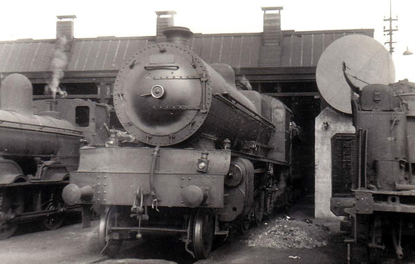

Scots Mac Posted December 17, 2013 Author Posted December 17, 2013 Hi Guys, heres one I'm working on at the moment with prototype picture and step by step progress pics. Having taken a great interest in the steam locos of the CIE I've been scouring thru online galleries and books and looking for engines similar to UK types readily available from proprietory manufacturers. I discovered engine 402.She was the only engine of the B2 type re-built with a flush running plate,all the rest of the class had split level running plates/walkways . I happened to notice that the old Hornby King Arthur class "Sir Dinidan" had a very similar style cab and had a similar longish front end. So I'd reckoned I'd buy a Sir Dinidan off ebay and have a go. I stripped all the detail off apart from the chimney then decided that it too wasn't right for the Irish engine so it got buffed off too. I kept comparing pictures then realised that the Sir Dinidan smokebox sat back from the front curve of the running plate whereas 402's smokebox hung over the lip so I razor sawed off the front end of the smokebox and and glued in two balsa wood extenders into the boiler barrel.Fortunately the inside of the hornby barrel moulding isn't round but rectangular so it was easy enough to extend the firebox with straight edged balsa. I never measured anything, 99% of the time I work by the eye. I only care that the models I do "look" about right when finished and capture the essence of the prototype, so if you're a rivit counter....look away now ha ha !!. Anyway I glued the smokebox front back on its new esimated position then filled in the space with body filler. I use "Chemical Metal" body filler by the Plastic Padding co. Great stuff. Sets very fast and is great for buffing and rubbing down and is very strong. So that was the boiler extended.Next on the agenda was a belpaire firebox which I made out of plastic card and buffed down to look approximately right. Strictly speaking it should tuck in tighter at the bottom but I decided it was near enough to satisfy me so that was that. I resurfaced the running plates with fine paper thin plasticard and wrapped the smoke box area with it too so that it stands out from the rest of the boiler barrel a bit as this is a chareceristic I noticed in the B2. I re-covered the cab roof with slightly thicker plastic to get the relationship between the belpaire firebox and the cab roof looking about right and buffed a bit off the back of the over-all roof lenth.Anyway guys the pictures attached will save many words. As it stands the loco requires a new chimney and steam dome and generally detailed up and painted. I'm not sure what tender it will get as yet. The original Sir Dinidan tender doesn't look like the B2's tender,but I'll see what Hornby or some of the other makes have out there and see if theres something close. Oh ...the wheel splashers ,I forgot about them. I made them out of plasticard layered then buffed to shape and glued on. They are cosmetic only as the hornby driving wheels don't actually come up that high but ...who cares ...like I say it is all about capturing the feel of the 402. I "think" its starting to get there. I'll keep you posted as things progress. Cheers DAVY
UP6936 Posted December 17, 2013 Posted December 17, 2013 Wow, you're fairly turning out locos at some pace! It looks great. I always thought that the 800s where the only 4-6-0s in Ireland. I think the rebuild you have done on the firebox is particularly good

Scots Mac Posted December 17, 2013 Author Posted December 17, 2013 Hi Guys, I've got tons of stuff on the boil,been working away at various engines for weeks now , I'll get round to posting everything in time. "UP6936" have a look here, ,there were the 400s and 500 4-6-0s. I;ve already started chopping a replica railways LNER B12 which will I hope turn out a decent representation of 502 ,which co-incidentally was classed B12 on the irish railways. Anyway guys ...enjoy... Davy
