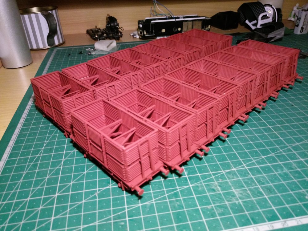

Noel Posted May 14, 2017 Posted May 14, 2017 I picked up 10 double beet wagons from Leslie at Bangor. I really enjoyed putting them together and hope to do more in the future. They are sprayed with Halfords red primer, I am unsure whether I should spray them brown now or just apply lots of weathering. Hi Robbie, Nice job they look great. Are the chassis less fiddly to work on then the single beats? Noel Prototypical colours seemed to vary greatly anyway from various shades of grey, bauxite, brown, etc
jhb171achill Posted May 14, 2017 Posted May 14, 2017 With a liberal coating of South Wexford mud from the beet, they weathered to a greyish brown colour, to such an extent that the original brown (and yes, that's way too red) was completely obscured. So much so, that operating them in a pristine state would be akin to a "wrong livery", same as an all silver A or C class loco, or tin van! So the solution is to very heavily weather them, and all will look good.
RobertRoche Posted May 15, 2017 Author Posted May 15, 2017 As said already its nothing a light coating of brown can't sort out.Nice work by the way they look very well. I gave four of them a coat of flat brown yesterday - picture to follow. So the solution is to very heavily weather them, and all will look good. Weathering to definitely follow. Toning down of the brown, perhaps dry brush with some greys and add dirt and grime. Hi Robbie, Nice job they look great. Are the chassis less fiddly to work on then the single beats? I didn't make any of the single beets, this is the first railway kit that I have done. I found the chassis to be grand, I only had to trim the back off a few brake shoes where it was catching a wheel. I did however manage to put the brake gear on the wrong side of the wagon, despite the instructions clearly stating which way they should go. Thanks for the pictures and video!
Kirley Posted May 15, 2017 Posted May 15, 2017 Looks the part Robbie, I would do a light mist of grey to underline the original colour, a slivery grey, that has rusted to finish them off.

popeye Posted May 15, 2017 Posted May 15, 2017 That looks much better but it does need a bit of variation in colours.
jhb171achill Posted May 15, 2017 Posted May 15, 2017 A shade lighter, perhaps? - to blend in with the local mud washed off the beet!

RobertRoche Posted May 16, 2017 Author Posted May 16, 2017 Oh wow, spot on with the colour, very nice. Thanks Nelson. A shade lighter, perhaps? - to blend in with the local mud washed off the beet! Would you be able to suggest a colour? I used Tamiya acrylic XF10 flat brown on these. Have a rattle through this thread - http://irishrailwaymodeller.com/showthread.php/1203-Beet-wagons-what-colour-were-they RedRich of this parish has provided some tasty in traffic shots, which would echo JHB's sentiments above. Richie. Great reference there, I will definitely try to replicate some of the weathering in those shots. Your efforts are giving me an enthusiasm to look at a couple of kits again though. Paul Good - this beet kit was really simple and good fun. I have many projects on the go, most of which have been sitting untouched for a while, hoping to get back to them shortly.
jhb171achill Posted May 16, 2017 Posted May 16, 2017 I don't know of an exact colour, I'm afraid - possibly blending different things as the overall effect wouldn't be quite uniform.

RobertRoche Posted May 17, 2017 Author Posted May 17, 2017 Very nice build, well done, like the colour as well.can I ask did you use tamiya acrylic spray or brush paint the wagons. maybe you will post more photos if you weather the wagons . cheers John. Hi John, I sprayed the wagons with an airbrush. I diluted the paint slightly with IPA and it went on very well.
JasonB Posted May 17, 2017 Posted May 17, 2017 That coat of brown has made a huge difference Robbie.Nice base now for the weathering to be applied to.

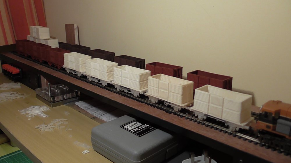

RobertRoche Posted October 30, 2017 Author Posted October 30, 2017 Ten more beet wagons on the bench tonight - from Leslie at Blackrock this weekend. 2
JasonB Posted October 30, 2017 Posted October 30, 2017 5 minutes ago, robbie58 said: Ten more beet wagons on the bench tonight - from Leslie at Blackrock this weekend. Very nice Robbie, that'll be proper rake when finished.Is that 20 you have now? 2
Glenderg Posted October 30, 2017 Posted October 30, 2017 Very nice! I meant to sodding well buy one, pure distracted... 😆 1
RedRich Posted October 31, 2017 Posted October 31, 2017 25 laden wagons in a rake. Mind you the inside looks so nice that they deserve to be run empty. If one was stuck for space Campile would be a lovely little station to model. Rich,
John-r Posted October 31, 2017 Posted October 31, 2017 Very nice Jason,. They really are a pleasure to build I find. The colour on yours looks smashing. any idea on how you'll approach the weathering.
John-r Posted October 31, 2017 Posted October 31, 2017 Sorry . I meant very nice robert. to busy looking at the photo of the double beets.
RobertRoche Posted October 31, 2017 Author Posted October 31, 2017 I've run out of glue sorry for the poor quality picture. 23 hours ago, jason brady said: Very nice Robbie, that'll be proper rake when finished.Is that 20 you have now? Yes 20 of them. I will get a video of them in one train when done. 2 hours ago, RedRich said: 25 laden wagons in a rake. Mind you the inside looks so nice that they deserve to be run empty. If one was stuck for space Campile would be a lovely little station to model. Rich, Plans in my head for Wellingtonbridge....I'd need another 100 wagons for that though! 1 hour ago, John-r said: The colour on yours looks smashing. any idea on how you'll approach the weathering. Not sure yet. I'll put the decals on and try some weathering powders and airbrushing. 2

RobertRoche Posted November 4, 2017 Author Posted November 4, 2017 I got 11 wagons primed today. There are 16 to paint brown next and then all 20 for decals. 3

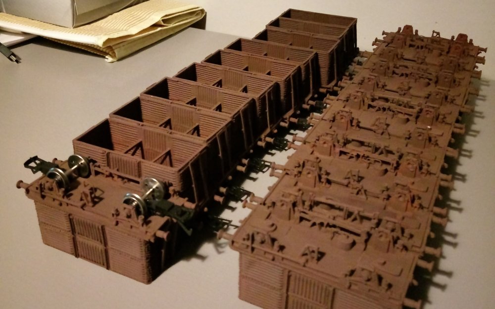

RobertRoche Posted February 12, 2018 Author Posted February 12, 2018 (edited) I got a new compressor recently which allowed me to finish most of the painting on the beet wagons. I forgot to drill the holes for the couplers on ten of them so I can't finish them all for the moment. Some decals and weathering to follow, and eventually a few shots of them running. Edited February 12, 2018 by robbie58 3 1 2
seanrail Posted February 12, 2018 Posted February 12, 2018 Lovely sugar beet wagons, Robbie58. Good luck with completing them. 2
JasonB Posted February 12, 2018 Posted February 12, 2018 Lovely work Robbie, really like the colour it looks spot on.Its a nice base to apply some weathering to if that's what you choose to do, if not they'll still look great as they are. 1
