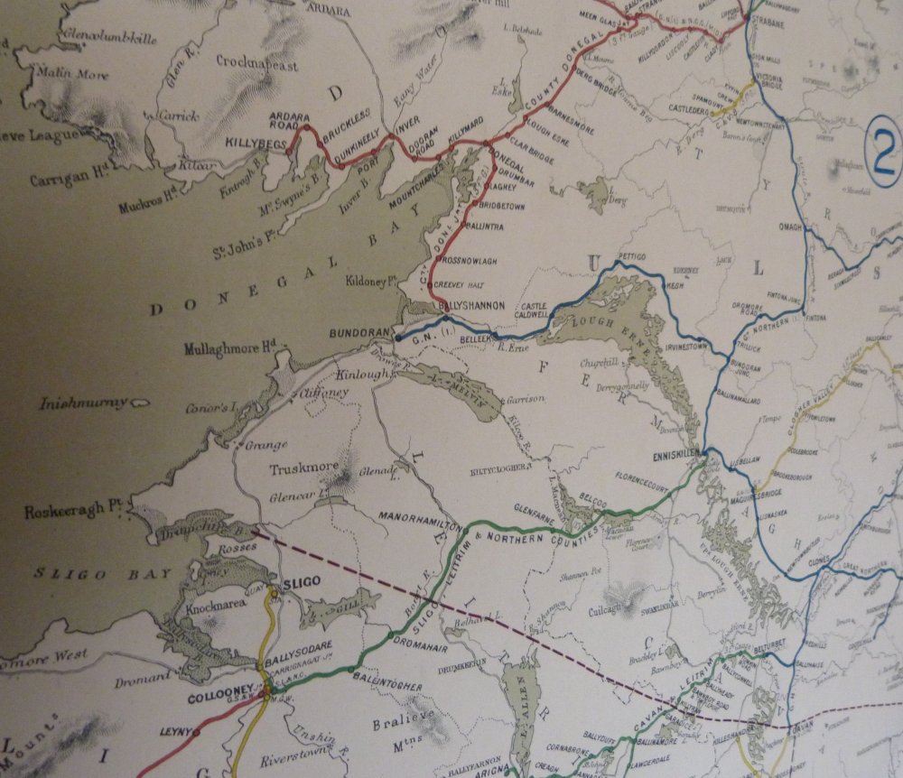

Earlier on there was reference to David Malone’s Cliffoney, a presumed MGWR line from Sligo to Bundoran, an alternative to a GNR(I) line from Bundoran to Sligo. Apart from some pieces in Rail Model Digest and Irish Railway Modelling, I can find no other references to it anywhere else. Can anyone help?
