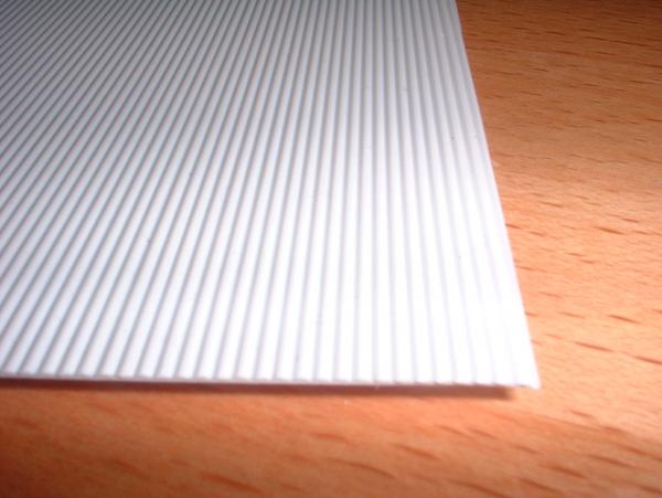

43 minutes ago, jhb171achill said:
Anyone seen this stuff - is it coarse and toylike or realistic enough? Checked Marks Models website, and they don't seem to stock it. Need to order from Brexitland, presumably........
It's 15 thou thick in 4mm scale, apparently - looks like it might be flat underneath?
  • 0
Many thanks, Broithe.
If it was flat underneath, it might aid construction. That said, I wouldn't want it to be obvious how thick it was.
Was browsing Valentia line stations this evening. Some were corrugated iron and some wooden plank. I think I'll go for corrugated as first choice, but if I don't like the look of my efforts, or indeed the construction materials themselves, the wooden plank version will appear instead.

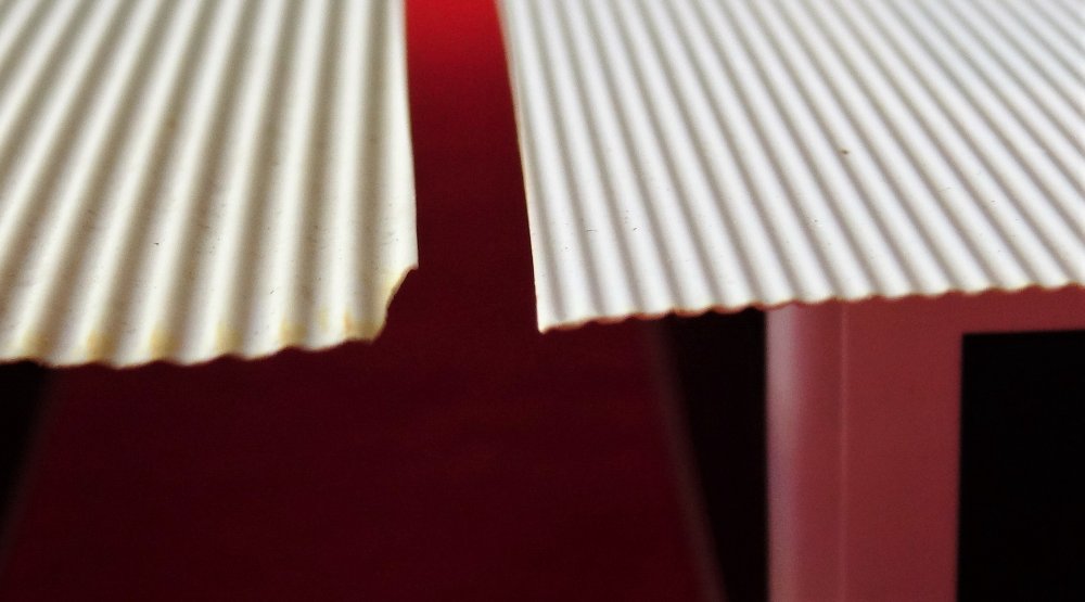

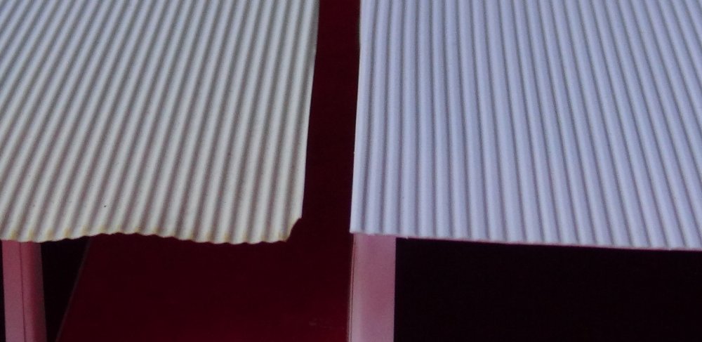

2 hours ago, Irishswissernie said:
That doesn't look like the my corrugated sheet, I have great piles of Slaters plasticard unfortunately without numbers! The one on the left is the 4mm corrugated, that on the right is probably actually planking and corresponds with the one that Broithe has uploaded.
The corrugated  sheeting isn't flat on the back and I always used it with plasticard support i.e. built the building shell in the same material so that it could be glued together with mekpak to stop the corrugated sheet warping when painted
Ernie
That looks much better, especially if there are going to be overlaps necessary.
  • 0
3 hours ago, jhb171achill said:
Ernie - is that light 4mm stuff Slaters too? I wonder what reference number it is? That's exactly what I'm looking for.
I've done some more digging! well actually I took the dogs and a tape measure up to the Haltwhistle allotments to measure some prototype corrugated iron as I was a bit concerned that the earlier photo actually showed the Slaters 7mm scale plasticard rather than the 4mm. Information gleaned from the allotment visit is that corrugations are 3" wide or 4 to the foot (Plus if you are planting potato's in horse manure you should mature the manure for a year before useing it!)
Back to the plasticard, it thus follows that there should be 4 corrugations per 4mm, my earlier photo has 4 per 7mm so it is O Scale. Digging through the plasticard I found a 4mm sheet, this is the one on the right of the new photo. They are both definitely Slaters the 4mm one is ref 0436
Ernie

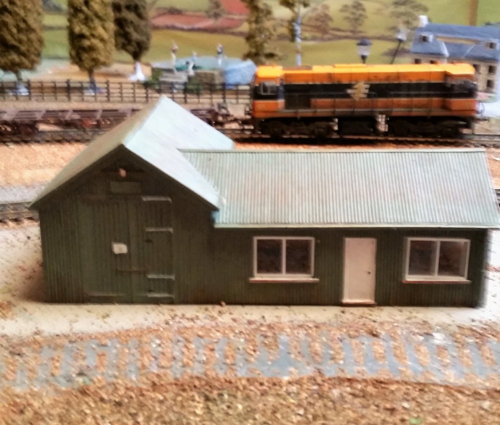

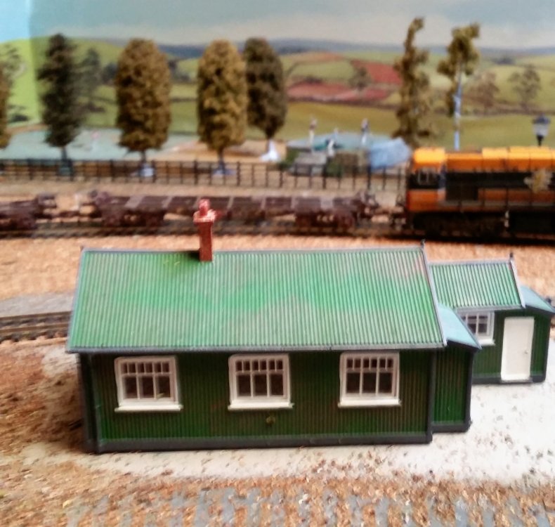

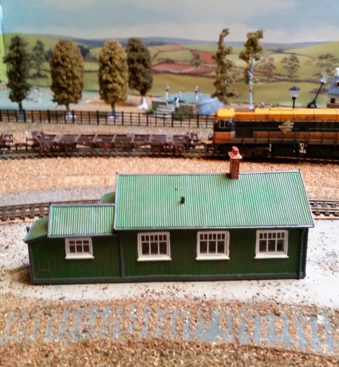

This is an (almost finished) Cavan & Leitrim platform shelter/store using Slater's sheet. I have also used Ambis corrugated sheet.
I can hear the rain.....
