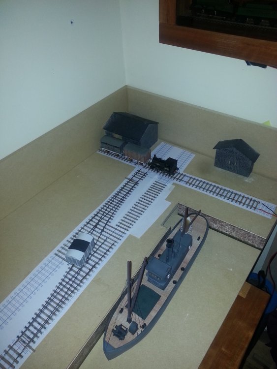

Hello All,
Decided to start a new layout & also dabble in the dark art of P4 21mm.
Quite a bit of work, but not a daunting as I thought it would be; building points is quite rewarding and there are plenty of resources out there to help you.  The bit of info which is a little more difficult to sort out are the stretchers and tie-bars.  Finally settled on using strips of copper clad PCB (on order at the moment) as the other attempts were not really working for me.  In the interim, I decided to get started on some buildings.
The idea is a fictitious Irish Port terminal – goods mainly but some passenger traffic from a small station.  The plan is get some experience in building track and re-gauging locomotives & rolling stock.  A little bit of scenery will help to set the track in its environs.

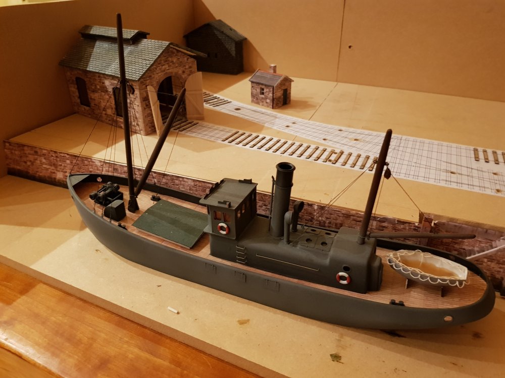

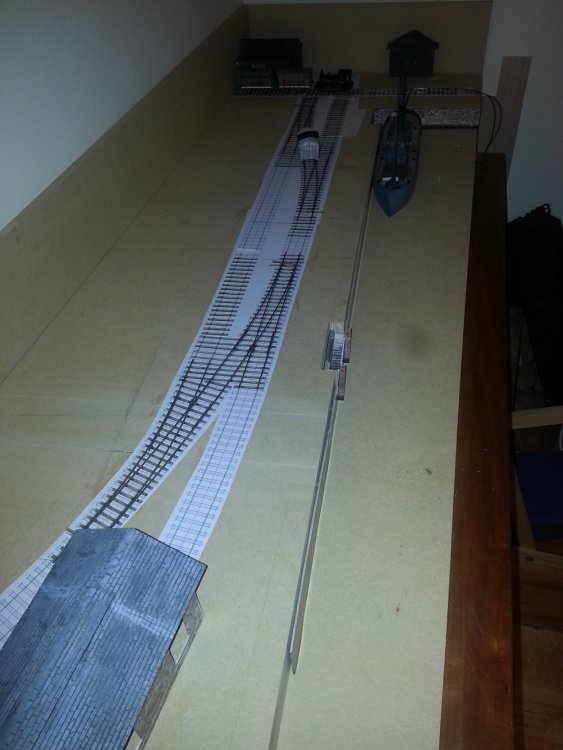

 Humble beginnings:
5aa1a89cda6be_PortLayout-Early1.thumb.jpg.7831d7789437c3bfd9b84fce4fc64645.jpg5aa1a89f0ddda_PortLayout-Early2.thumb.jpg.1b2dc934454908cbbfdba4b8f37a90b3.jpg
Simple track-work with two sets of points & hopefully two wagon turntables at the end to pick up the track running at 90 deg to the mainline.

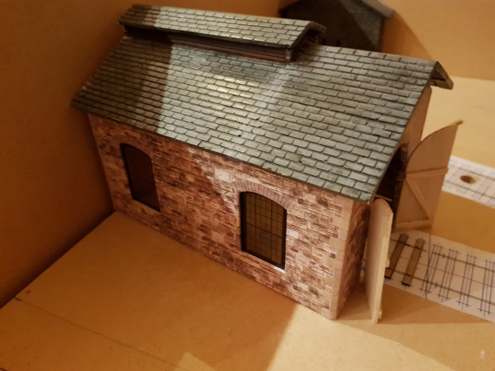

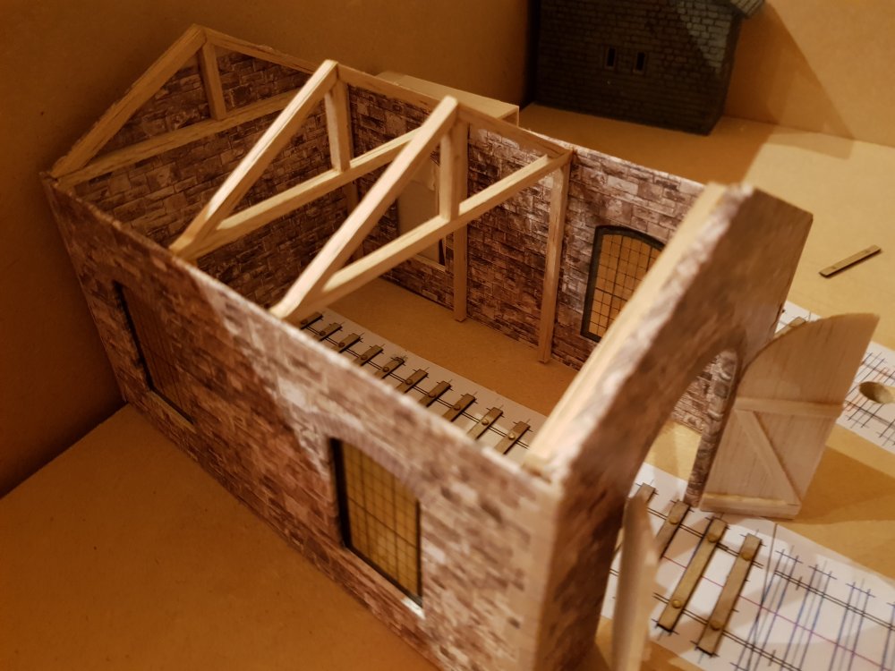

Small engine shed - much more work needed!

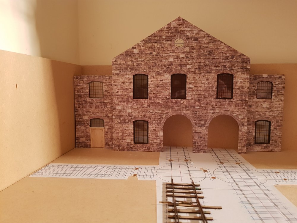

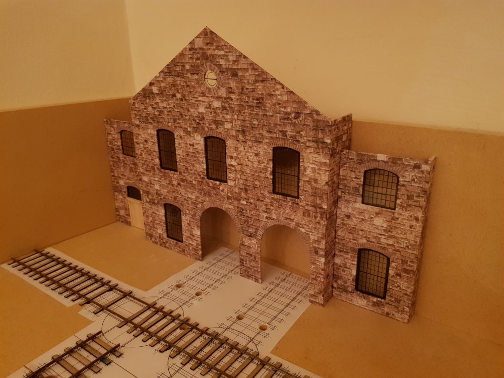

Factory / Warehouse to close out the ends of the track in a slightly more interesting way (?) . Plan would be to have the doors closed.
I'm thinking only one wagon turntable would be active, as there would be a huge amount of work would be replicated for no real benefit.
Long way to go, but this is to give a general feel as to where it is going - hopefully!!

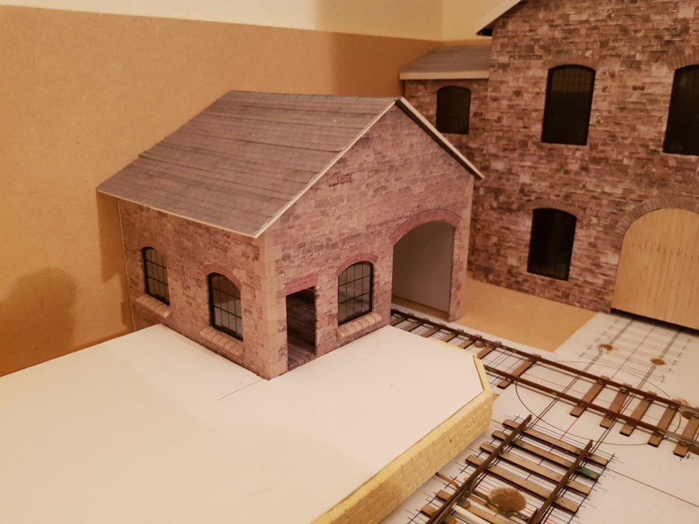

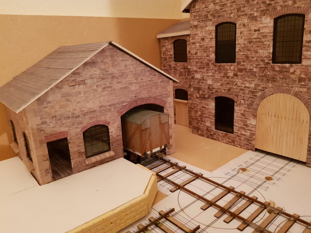

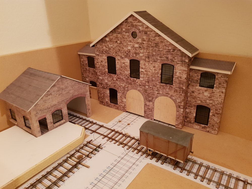

The main factory / warehouse got a little more work & I started on the goods shed.
20180311_224336.thumb.jpg.7561ae42c9f88dd5e50a7b5eaab1ef82.jpg20180311_224342.thumb.jpg.e46cbc30de2a281855798dbc6197f13f.jpg20180311_224352.thumb.jpg.6c0a21ec10504c56eea6b53df12643df.jpg
Shortened goods shed, as there is not much space between the backboard and the wagon turntable - still plenty of work needed to compete.  The platform is an old one I put in place for context.
Really need to put some window sill on that factory!!

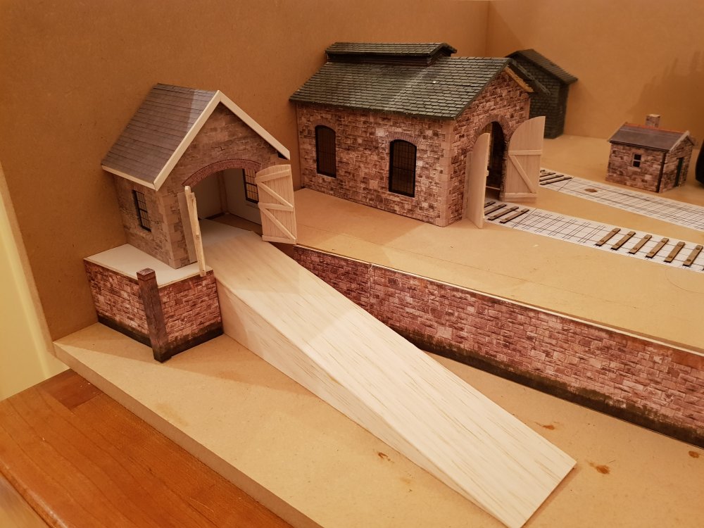

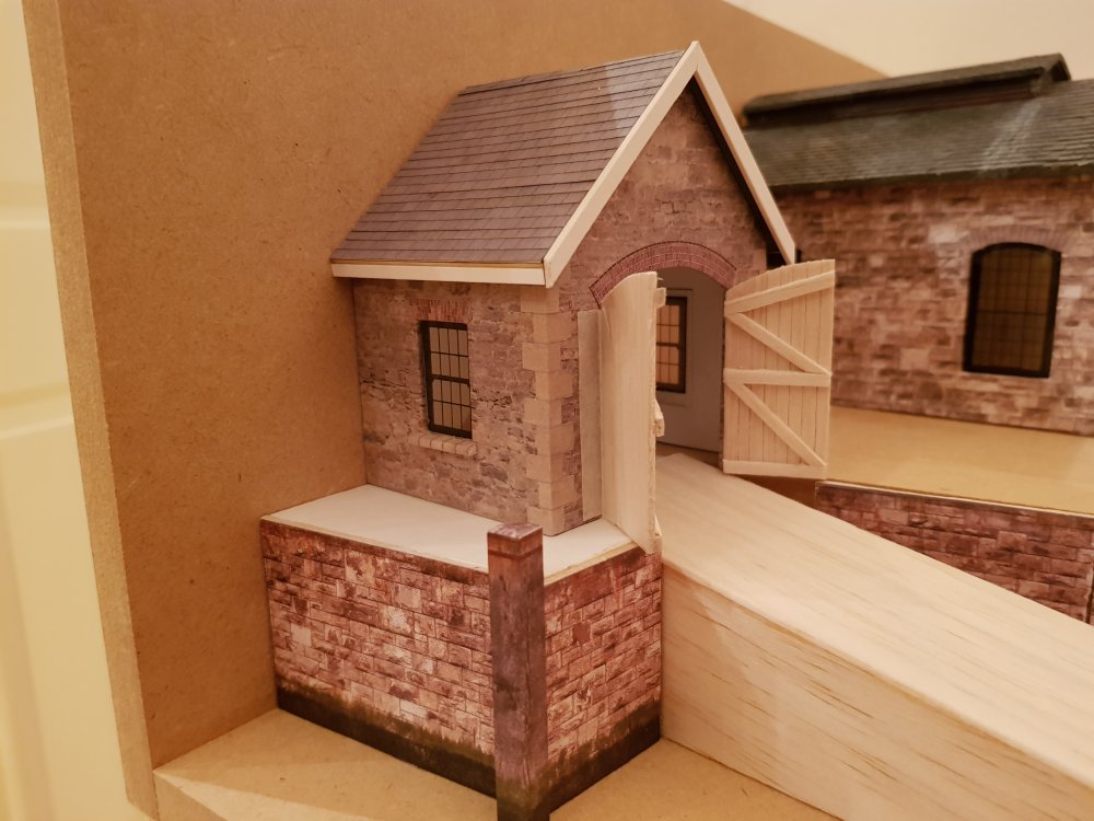

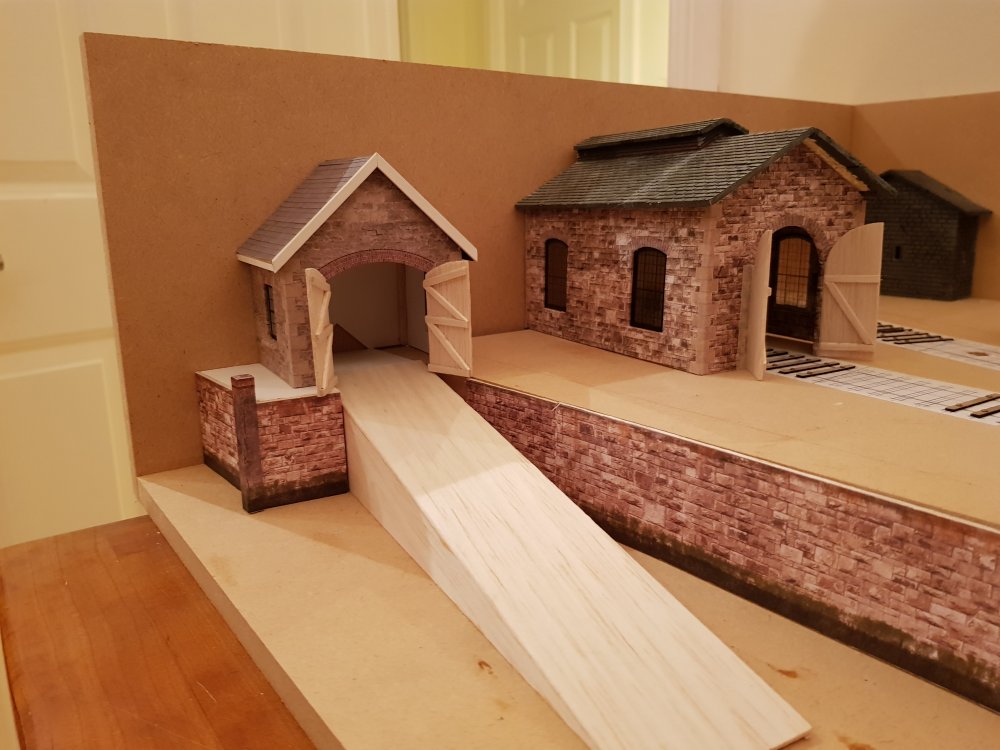

And what every good port should have - A lifeboat station.
20180311_224610.thumb.jpg.afcb143a60afd94a5cd13d19849c9711.jpg20180311_224617.thumb.jpg.7a3df859fabbf903d2f646c8a69bb6d3.jpg20180311_224624.thumb.jpg.cec4ff405ea10ff628aaa2a5be4212f9.jpg
A lot of detailing required on the slip and to tie the boathouse in.  Obviously a lifeboat just poking out of the boat house will set it off nicely.
Masking tape hinges until I can make up a few suitable hinges!!

Your buildings look superb - no wonder the Master Builder Glenderg made his comment.
Love the idea of bringing the Brits into Ireland in the form of the ROYAL National Lifeboat Institution! Incidentally - the work of the Irish boats is featured in the BBC series presntly being screen - all power to their elbow - keeping a fine tradition going.
You're obviously a modeller of no small skills - how about one of the last sailing ships tied up the quay - see "Irish Sea Schooner Twilight" by Richard Scott - none of them were over a hundred tons.
Keep it up - wish I had a quarter of your ability.

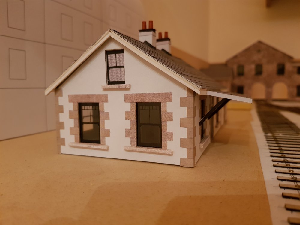

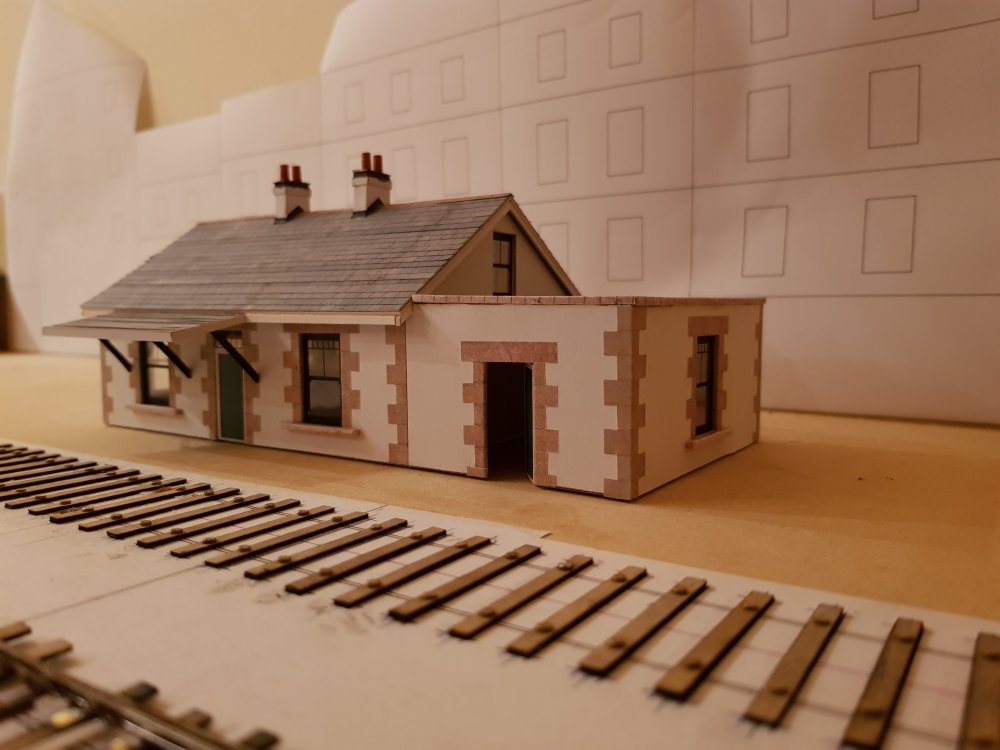

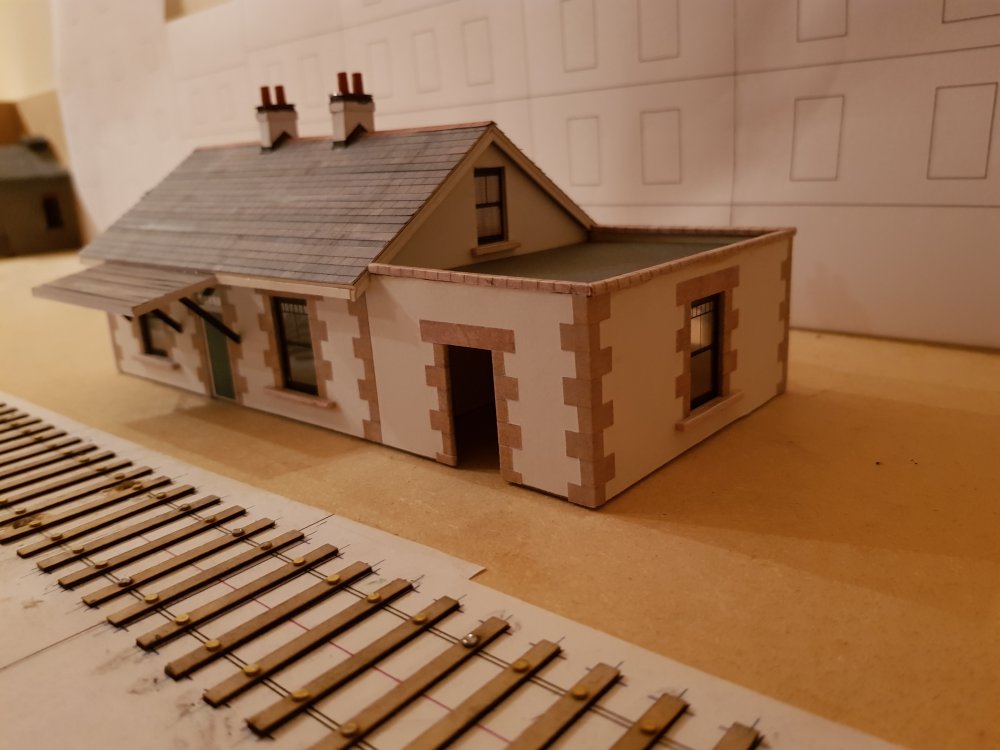

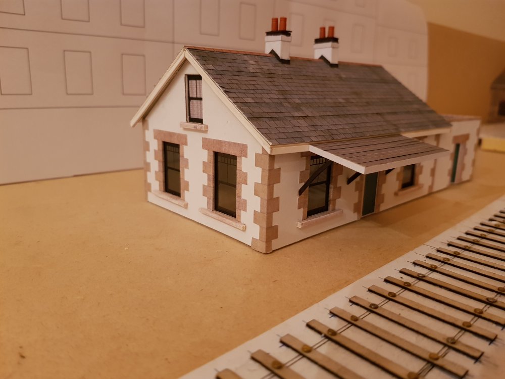

Needed to build a small station house for the layout and looked at a few options but settled on the rather nice building in Florencecourt.  It has a pleasant mix of whitewashed plaster and stone cornices with clear add-on waiting room.  Best of all it's small and allows me a little more room for the backdrop & street scene.
Still working on gutters, down pipes, and signage.   Weathering will be done prior to fixing in place to reduce the finger marks.   On a roll with building, so will probably continue and work on the backscene - you get a general gist from the printout behind the station house.
20180319_001608.thumb.jpg.37366329264eab46d90826bbfdb89d10.jpg20180319_001636.thumb.jpg.419119674d7624d8e682851ba21b09b3.jpg20180319_001653.thumb.jpg.6e4104c15349648ffebc45177985623e.jpg20180319_001710.thumb.jpg.82786bd8dad60d76a3f90078a59b178a.jpg
Need to tidy up some details but it's coming together rather nicely.

Very nice
