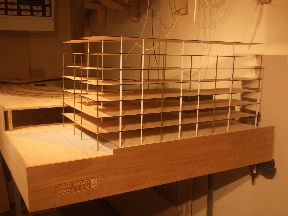

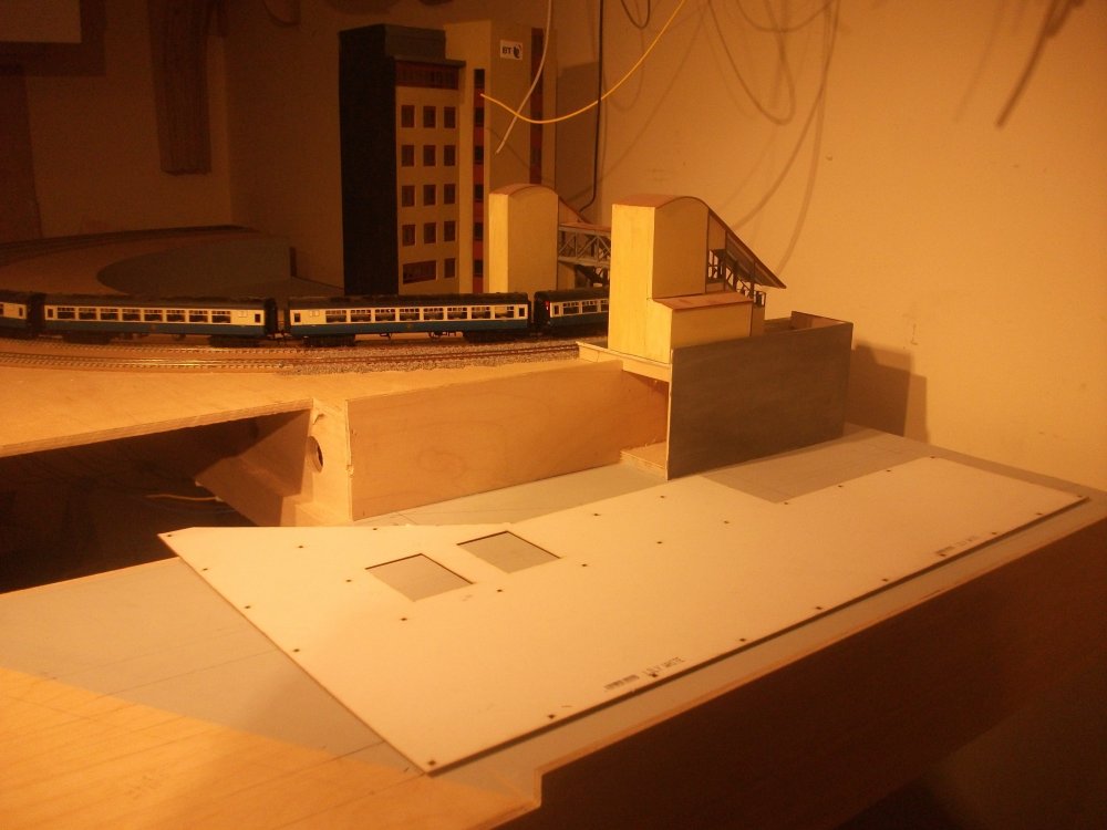

JasonB Posted June 12, 2018 Posted June 12, 2018 (edited) Love the stairwell and lift encased in glass. Looks just like the real thing. Modelling on another level. Edited June 12, 2018 by jason brady

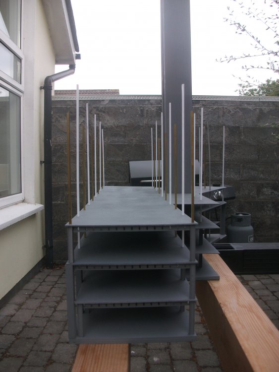

warb Posted July 4, 2018 Author Posted July 4, 2018 Start of google buildings on barrow street all 18 storeys. It will be awhile 8

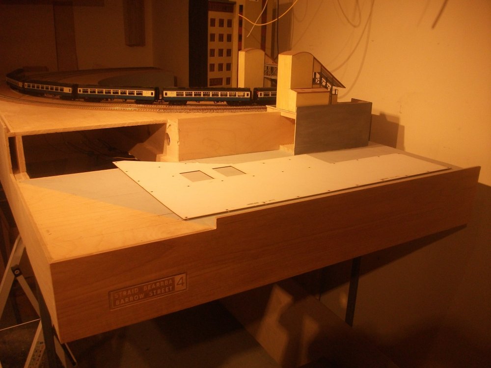

warb Posted July 5, 2018 Author Posted July 5, 2018 David the dimenision of what i can fit are 860mm high x 726mm long x 410mm and this has been reduced also excluding the three storey undergronud car park

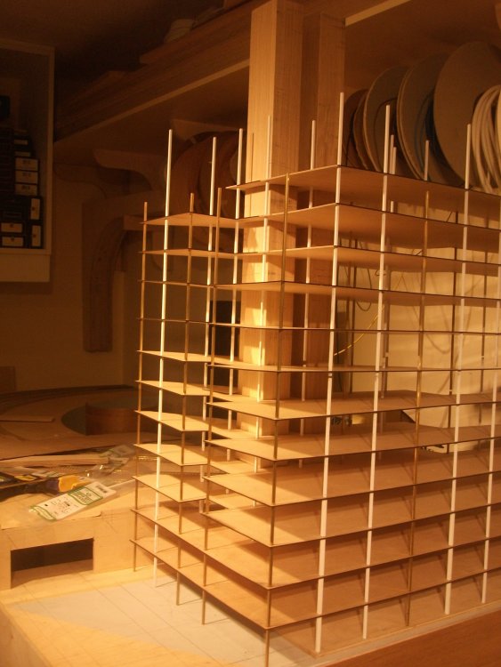

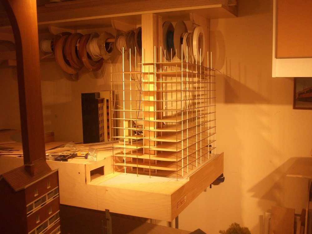

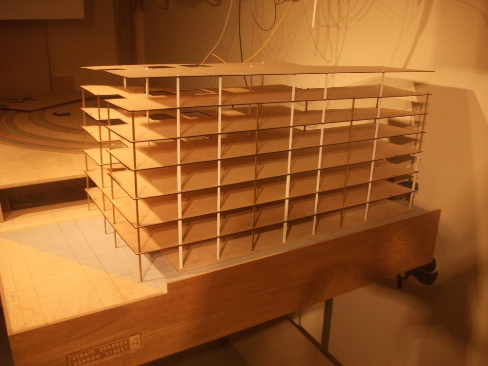

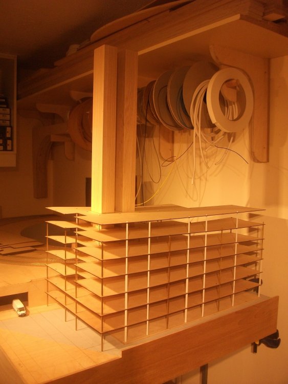

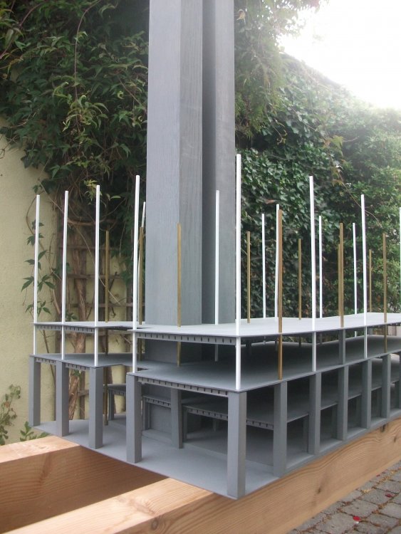

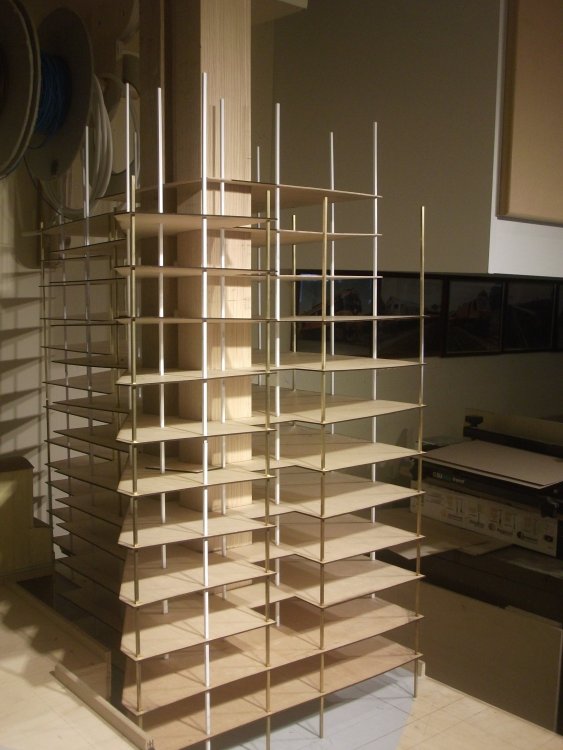

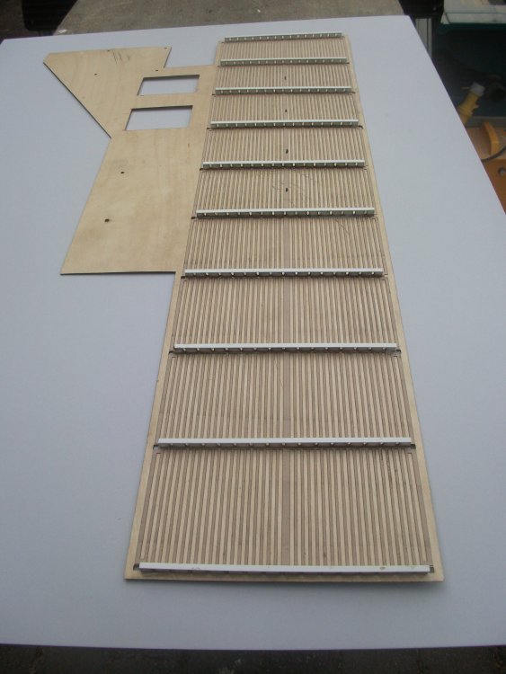

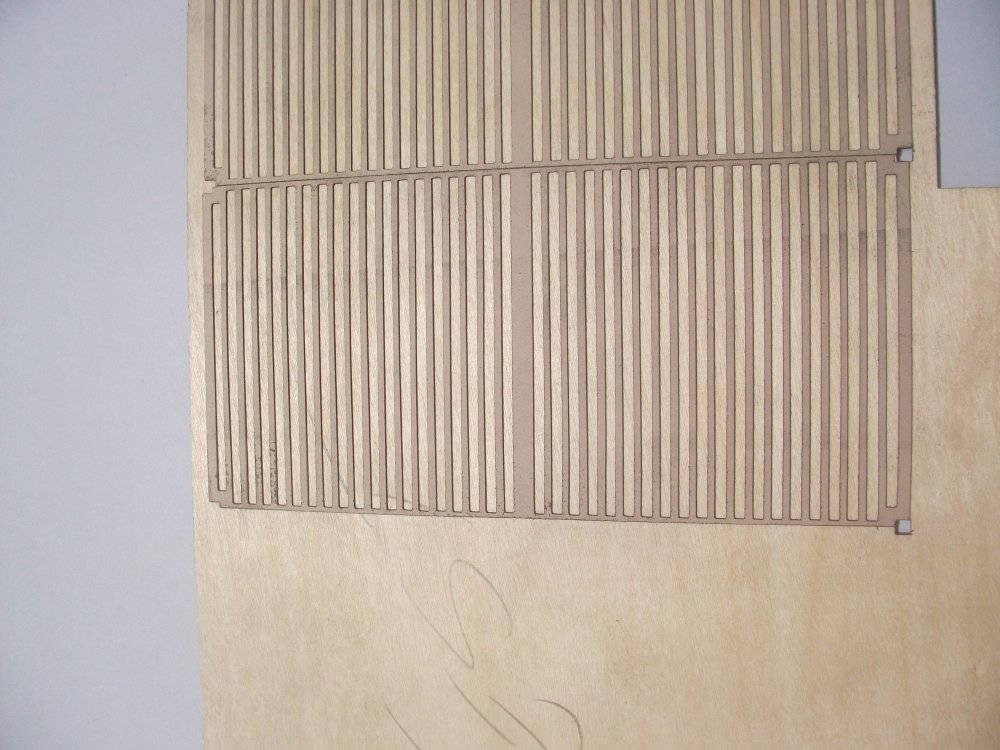

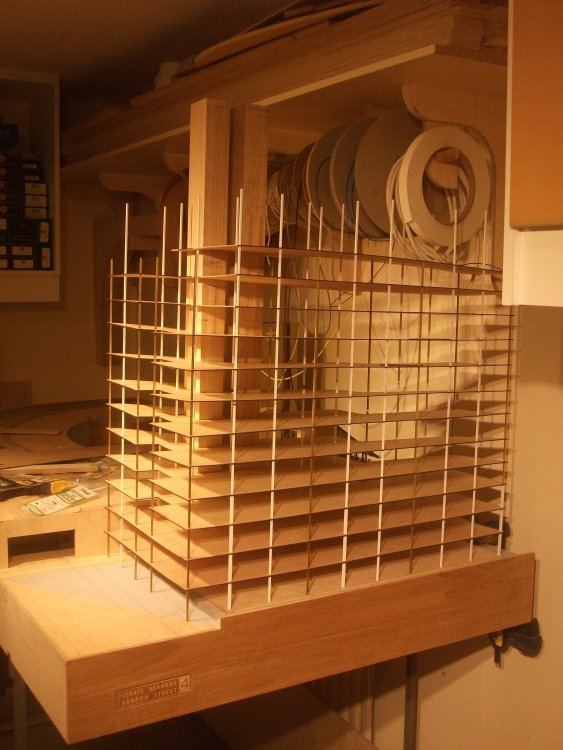

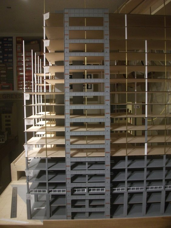

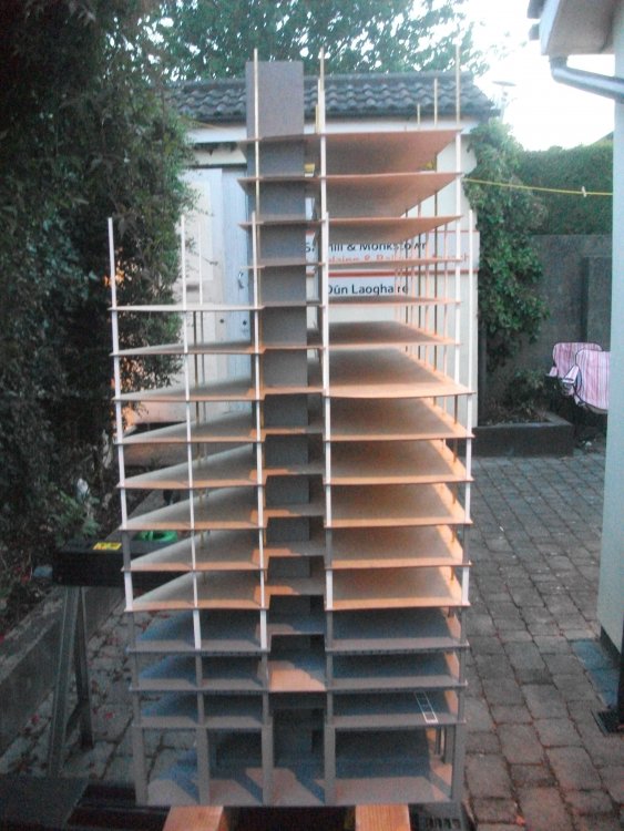

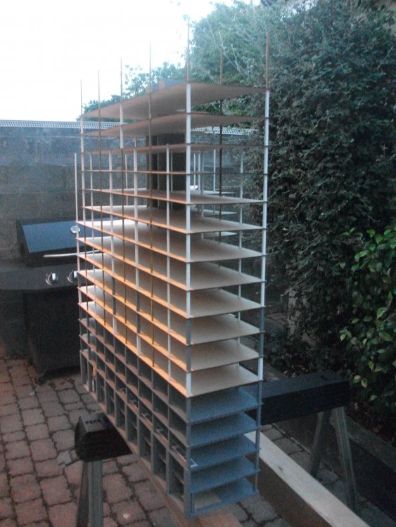

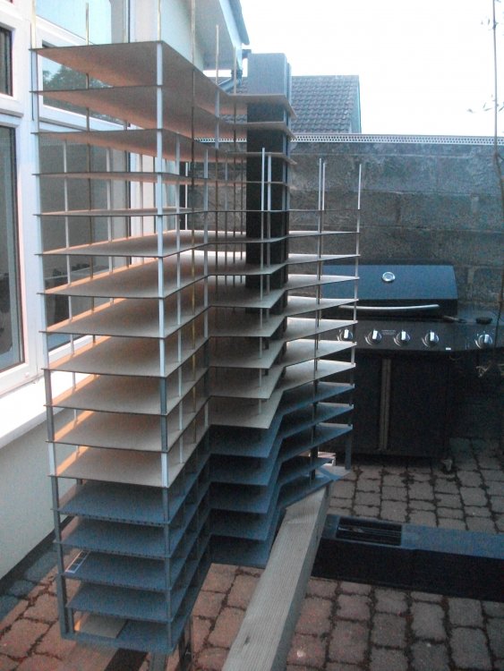

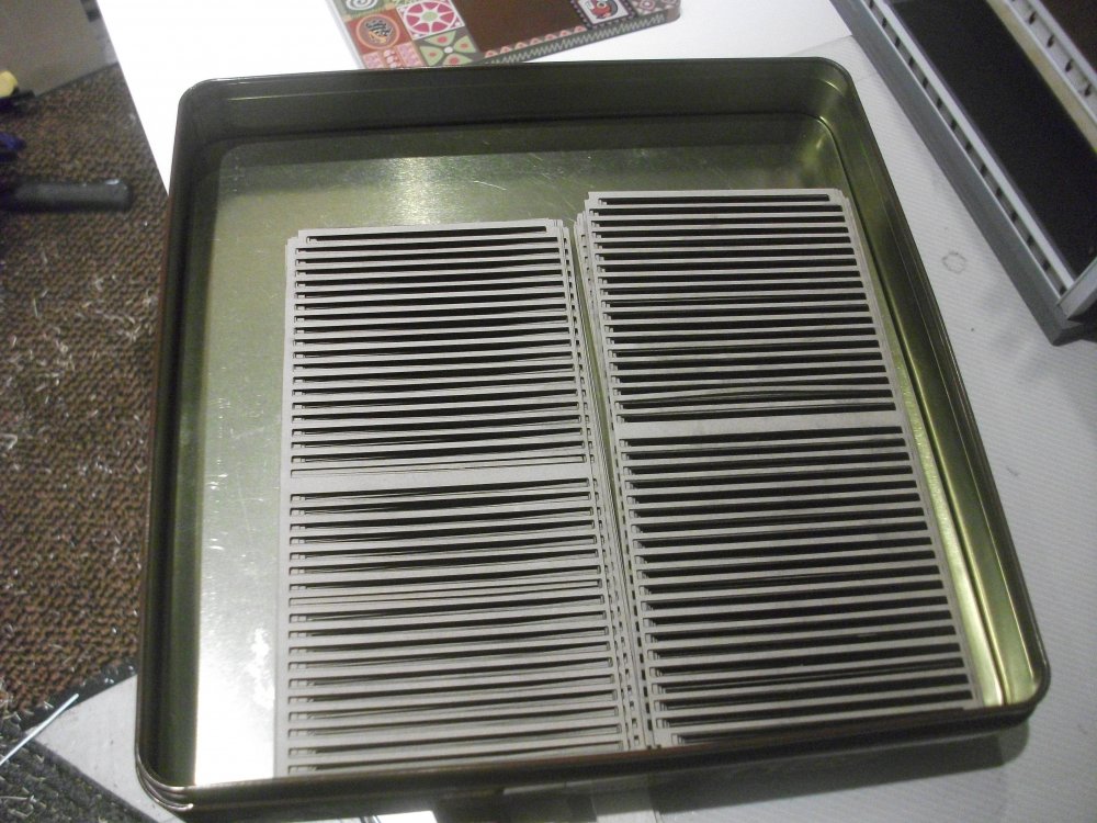

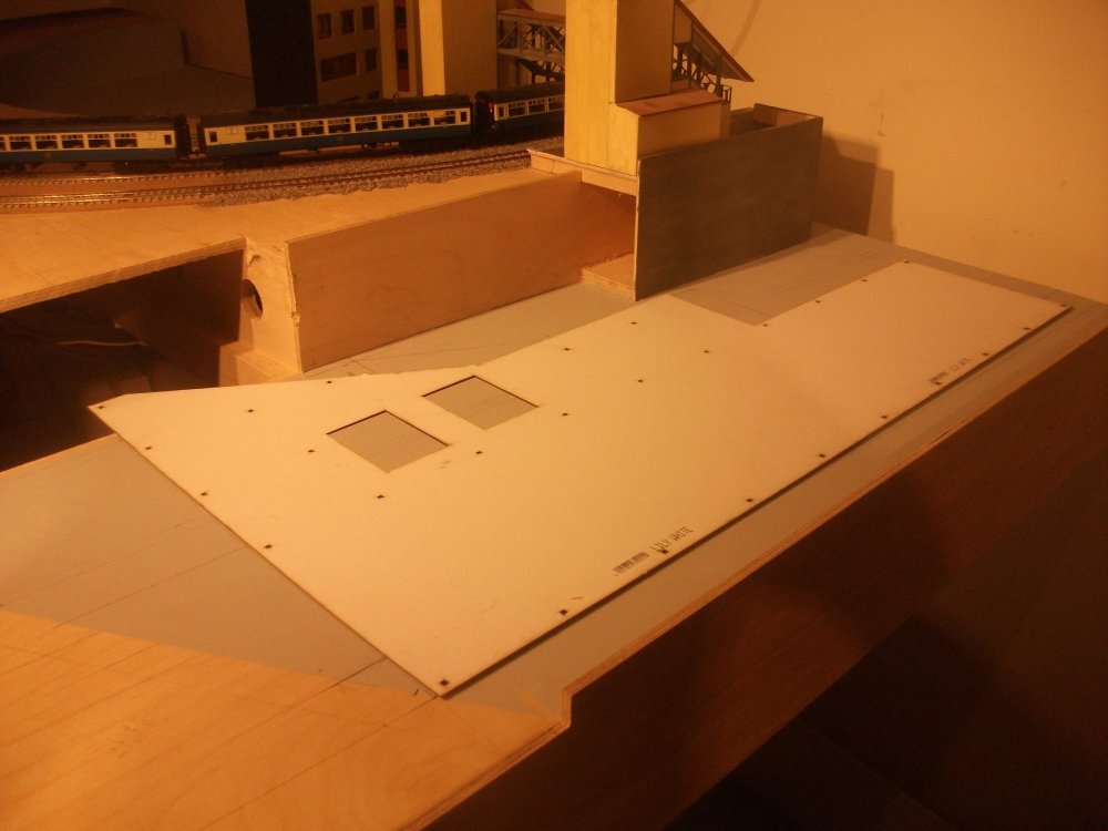

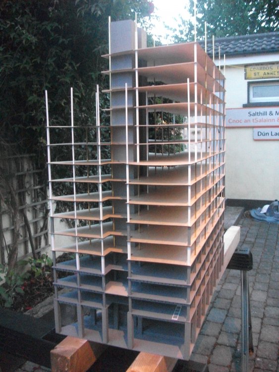

warb Posted July 8, 2018 Author Posted July 8, 2018 First two photos show the ceiling of each floor on test piece to check they work. The other photos show the lift shaft fitted giving overall height of google buildings. 3

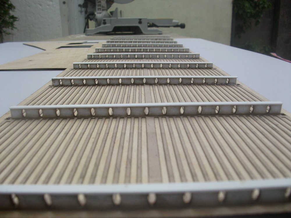

warb Posted July 8, 2018 Author Posted July 8, 2018 Test sample of ceiling complete only 18 to do 1 1

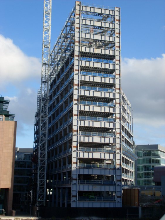

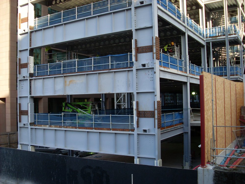

Mayner Posted July 10, 2018 Posted July 10, 2018 25 minutes ago, warb said: more work done  On 7/8/2018 at 6:54 PM, warb said: Test sample of ceiling complete only 18 to do Hi Warb. Nice to see a model of a Composite floor system. Are you modelling the building under construction?  Combination of building elements, shuttering, cranes and other plant would make an interesting and very different model.
warb Posted July 10, 2018 Author Posted July 10, 2018 John Got it in one i will probably do a mixture under construction. The front will be fully glazed only leaving the side and canal end exposed under construction. regards warb 2
Mayner Posted July 11, 2018 Posted July 11, 2018 Very impressive model and structure. Generally with a building of this nature 1-2 floor levels of composite steel decking are installed before the concrete topping is laid, depending on type of decking and span the decking may or may not require propping. These days edge protection and safety netting would be installed to a floor level before the composite decking is installed on a level. The steel decking acts as a crash deck for workers (typically steelfixers & concrete layers) working below the structural steel erectors. Floor design and construction loadings with composite slabs is critical, I had one near miss on a project I was managing about 20 years ago and investigated a couple of composite floor collapses, in two cases the decks were supposedly designed to be self supporting. Service installation/interior fit out can take place on the lower levels once slab meets minimum required strength, it gets a bit more complicated where propping is required as it may be necessary to back prop to lower levels of the building. Generally the planner/project manager would avoid installing cladding to an elevation until structural steelwork and concrete works are complete to the full height of a building to eliminate the risk of damage to the (very expensive) cladding. 1

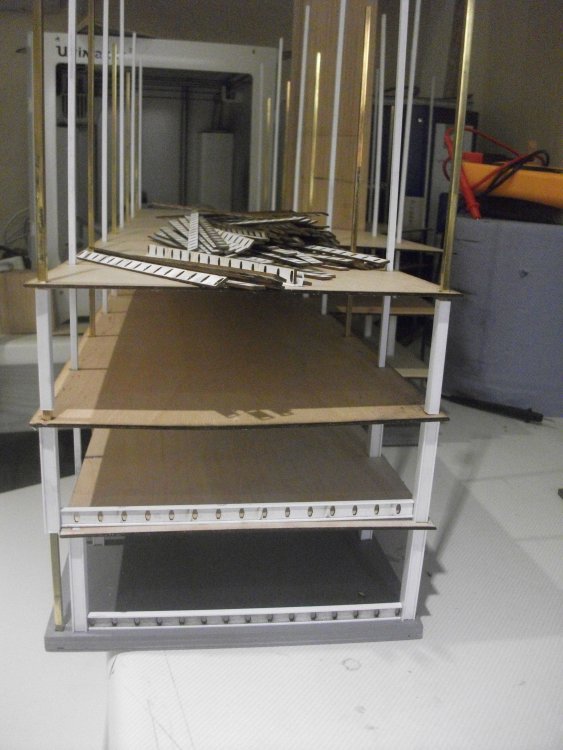

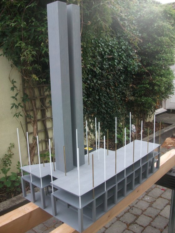

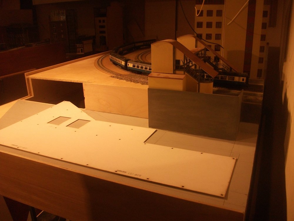

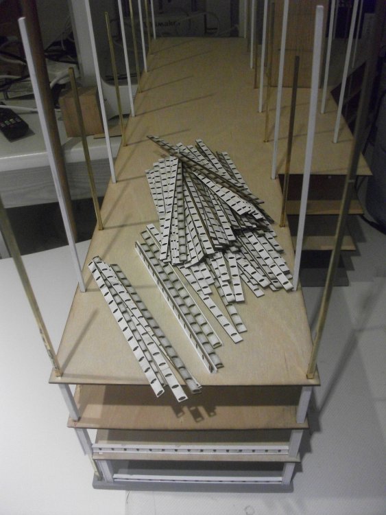

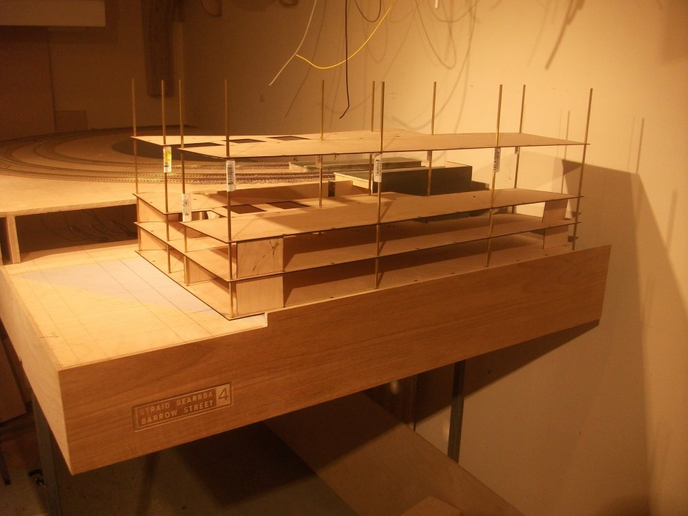

warb Posted July 13, 2018 Author Posted July 13, 2018 some of the parts required for google buildings 3

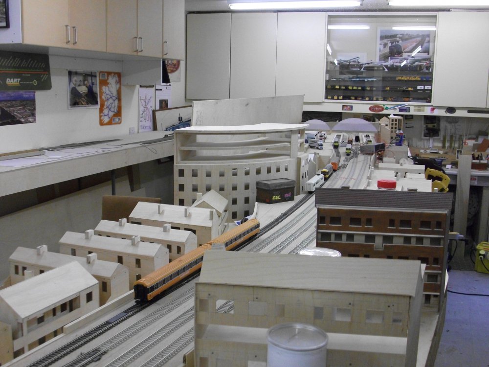

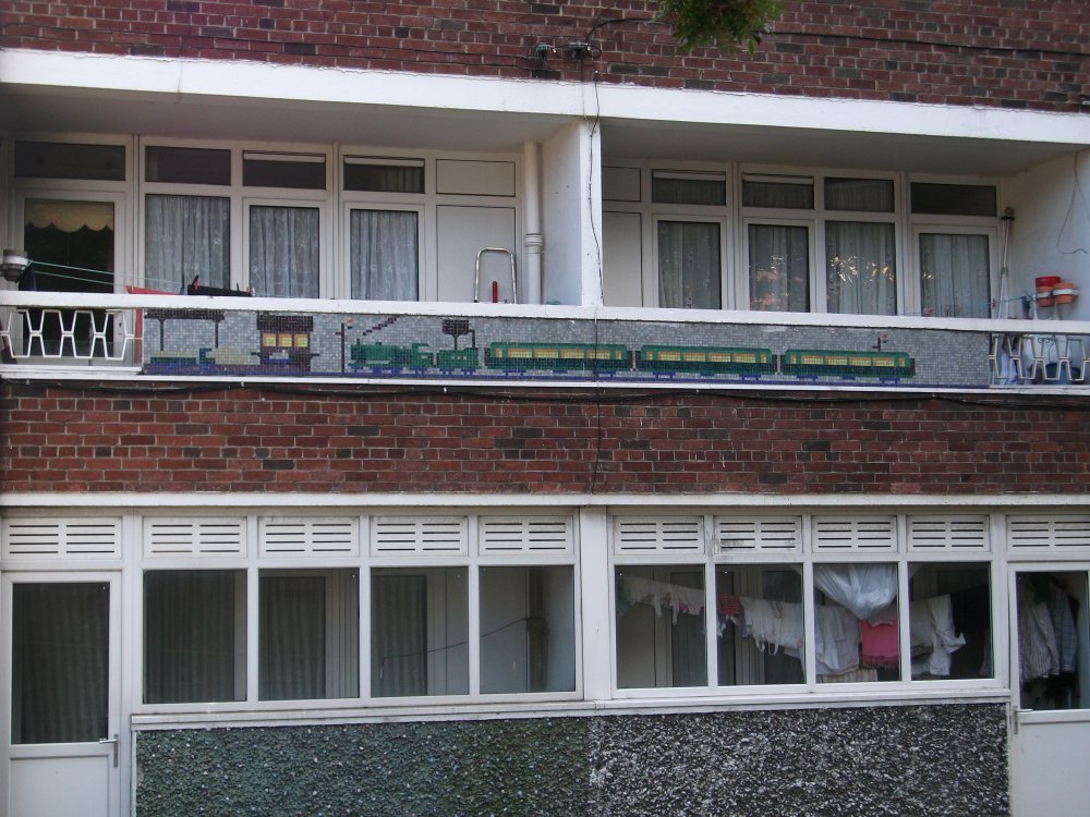

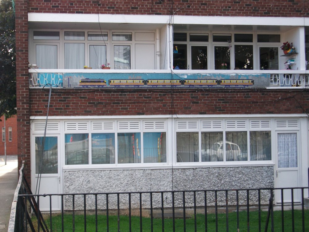

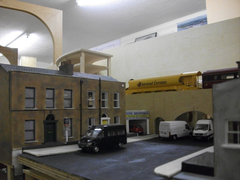

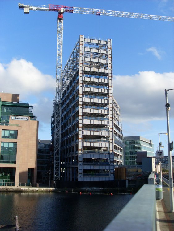

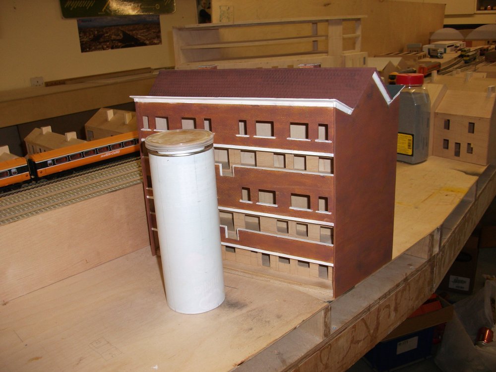

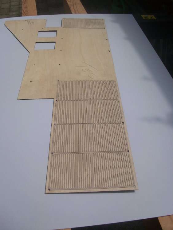

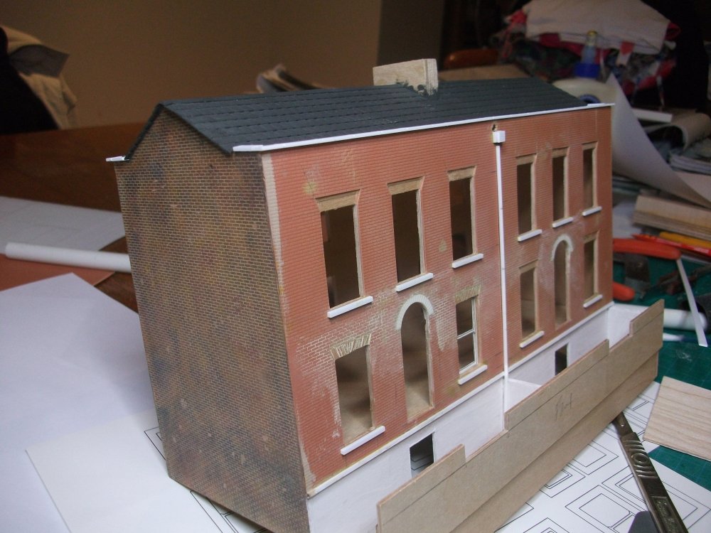

warb Posted July 14, 2018 Author Posted July 14, 2018 Found old photos of the start of barrow street 12 years ago through the years 5 6

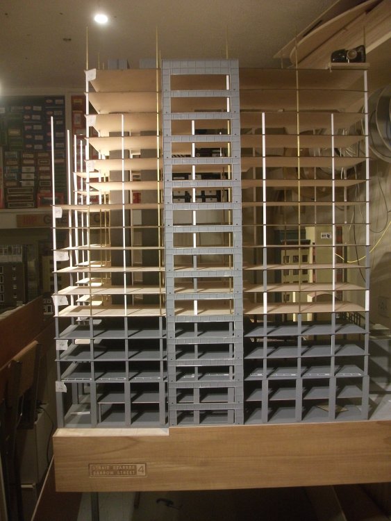

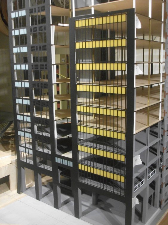

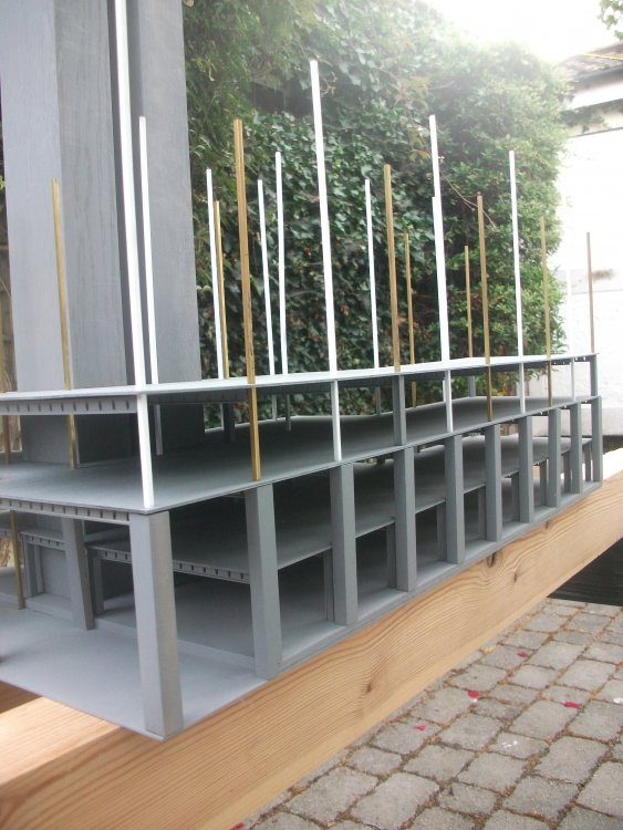

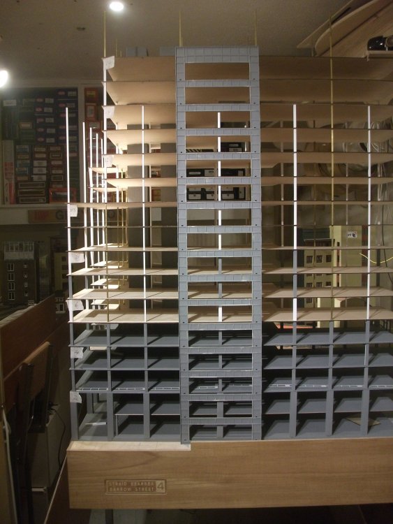

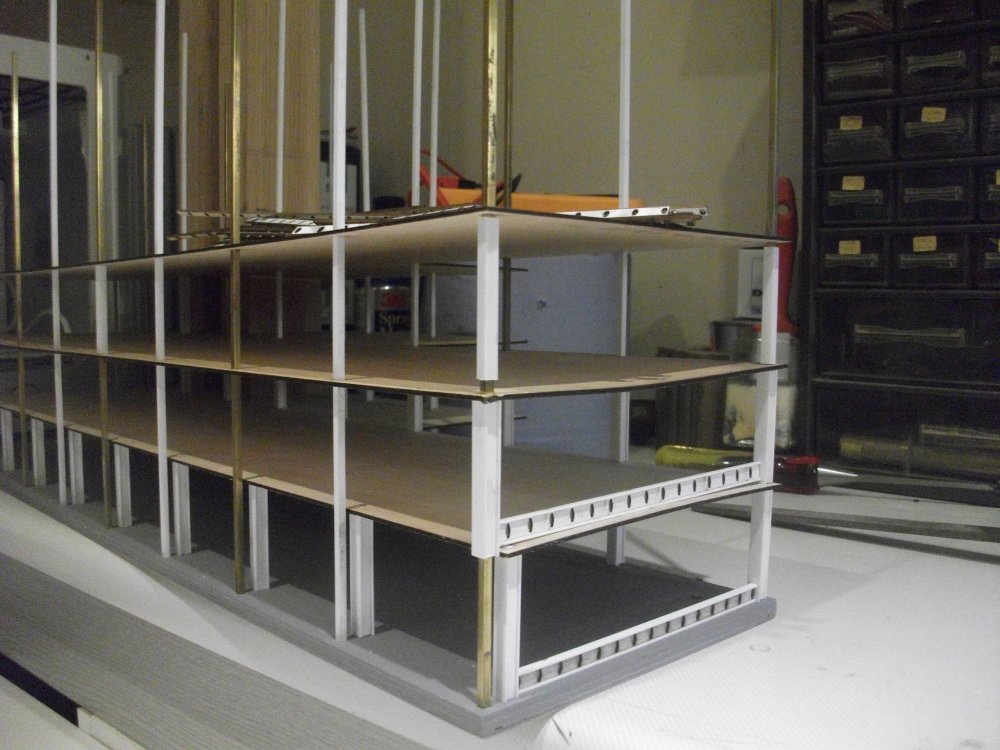

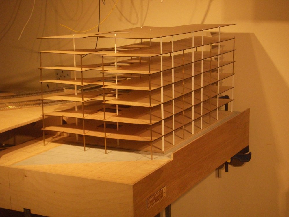

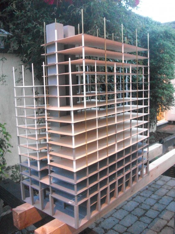

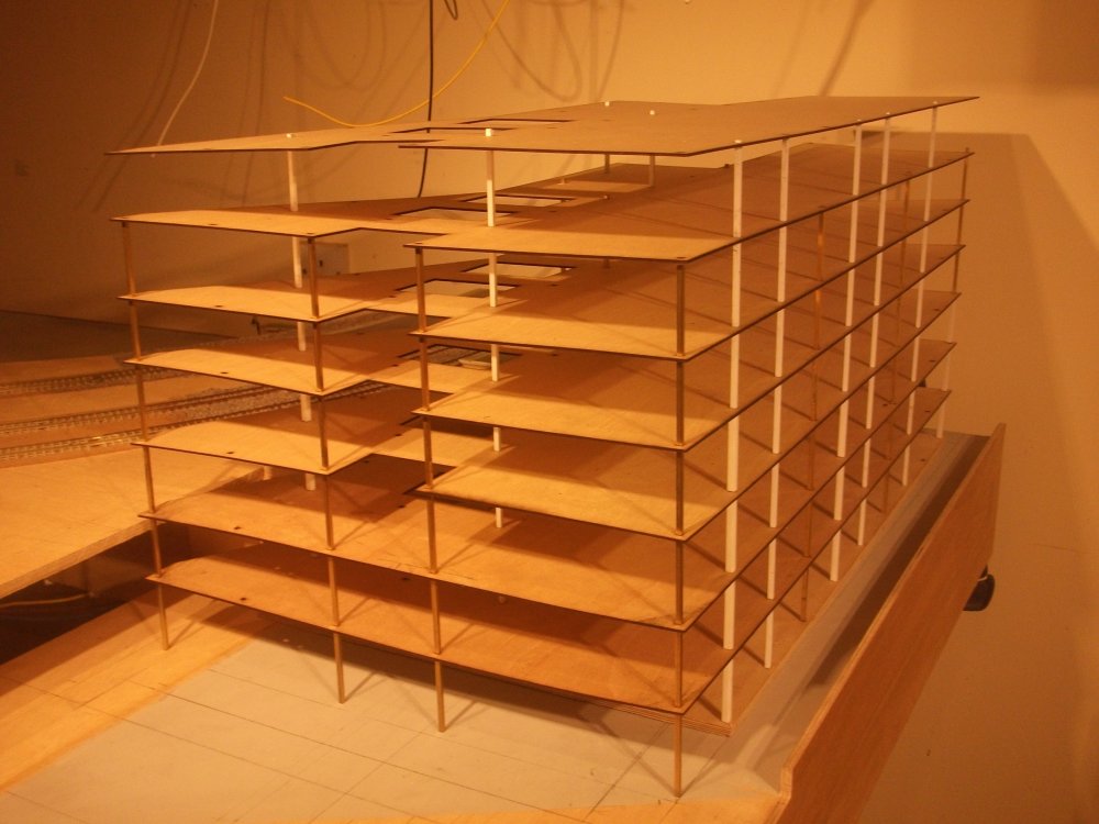

warb Posted July 24, 2018 Author Posted July 24, 2018 Full mock up of google buildings showing the over all size including parts for RSJ's 6 3
David Holman Posted July 25, 2018 Posted July 25, 2018 What a beast! This must be one of the largest individual 4mm scale buildings on a private model railway. Can't think of anything comparable, though did see a 13 storey tower block on a 7mm scale American outline model which was similarly impressive. Notable too for its pre dcc Pacific Fast Mail sound system hooked up to the mother and father of all stereo systems with five foot speaker stacks. When the triple unit diesel started up, the earth moved, as did most of your body's internal organs!  Presume it will fit through the door to the railway room?!?  Stunning stuff. 1

jhb171achill Posted July 25, 2018 Posted July 25, 2018 This is an absolutely stupendous feat of modelling! I know this area very well myself, and have done since I was a small child, so I'm well aware of how perfectly it has captured the atmosphere of the area. A strongly built-up cityscape is an extremely hard thing to do convincingly and this has carried it off so well. Once "scenery-fied", it will be an absolute masterpiece. Very well done, and like many here i look forward to seeing progress taking place, Doubtless many of a certain age here are aware that under the brown paint on the balconies of the flats, are tiled murals of black'n'tan carriages...... These were put in place in the 1960s.

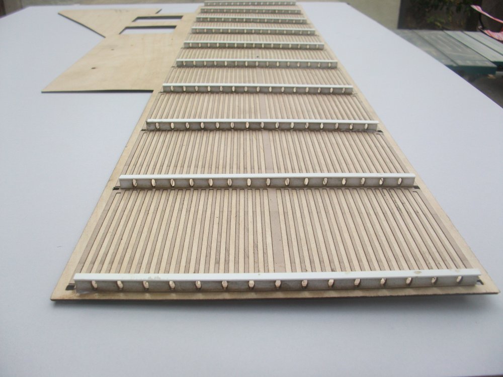

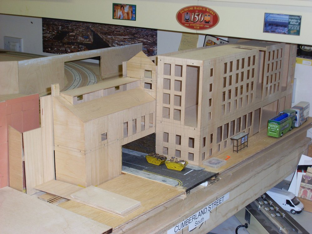

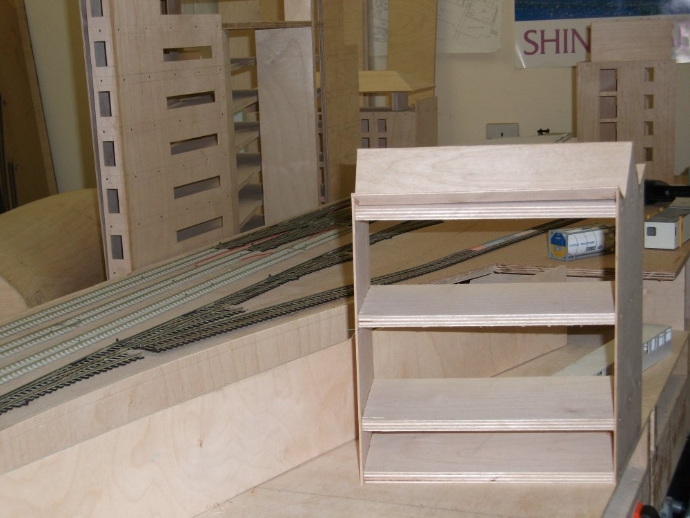

warb Posted July 27, 2018 Author Posted July 27, 2018 Gable end at canal end of google building made up 4 3
Mayner Posted July 28, 2018 Posted July 28, 2018 On 7/26/2018 at 12:41 AM, jhb171achill said:  Doubtless many of a certain age here are aware that under the brown paint on the balconies of the flats, are tiled murals of black'n'tan carriages...... These were put in place in the 1960s. Think there are/were similar murals (including a steam train) on the flats near where the North Strand Rd crosses over the Royal Canal and railway.

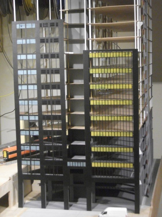

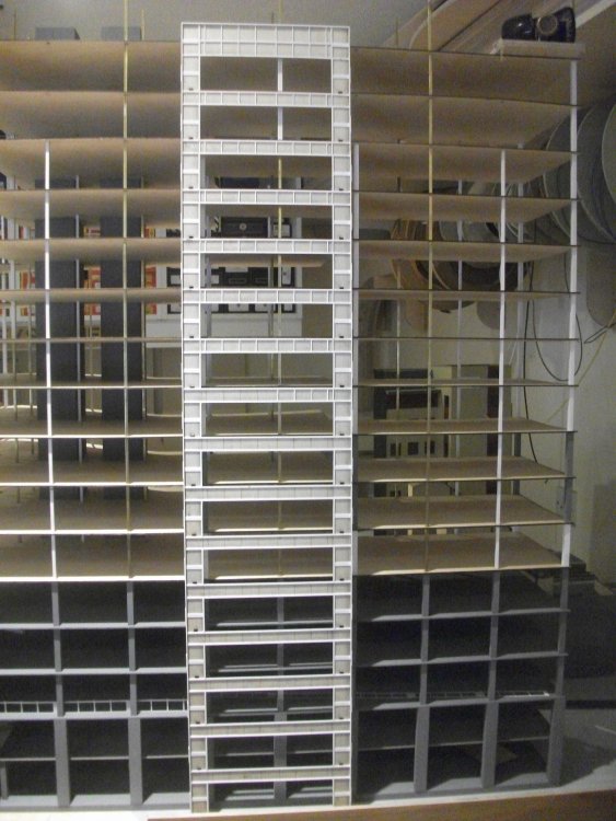

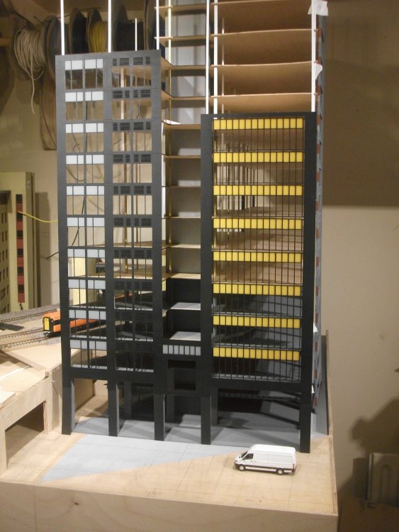

warb Posted August 6, 2018 Author Posted August 6, 2018 mock up of front of google buildings still need work 4
burnthebox Posted August 6, 2018 Posted August 6, 2018 (edited) Without exception this has got to be the most magnificently detailed piece of model railway building ever seen in this country, dare I say anywhere!  I for one have never witnessed craftsmanship like it anywhere, & I know the areas in & around Barrow Street where my late father was born & reared as the detail is off the scale.  I have said cometh the moment, cometh the man, this has got to be an utterly magnificent build. !  Congratulations to you sir, you have set a boundary that I do not expect to see beaten let alone equalled in my lifetime.  BTB Edited September 9, 2018 by burnthebox Spelling 3

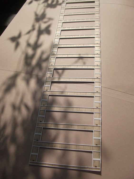

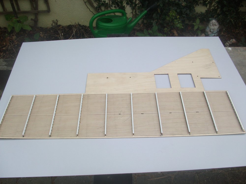

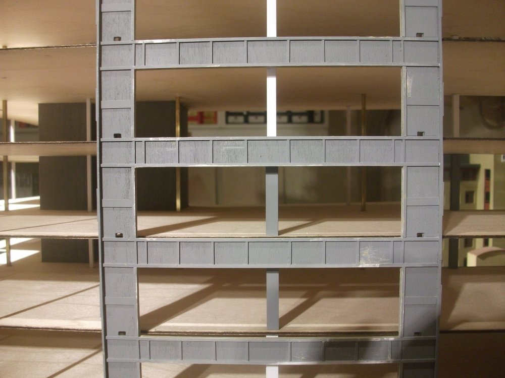

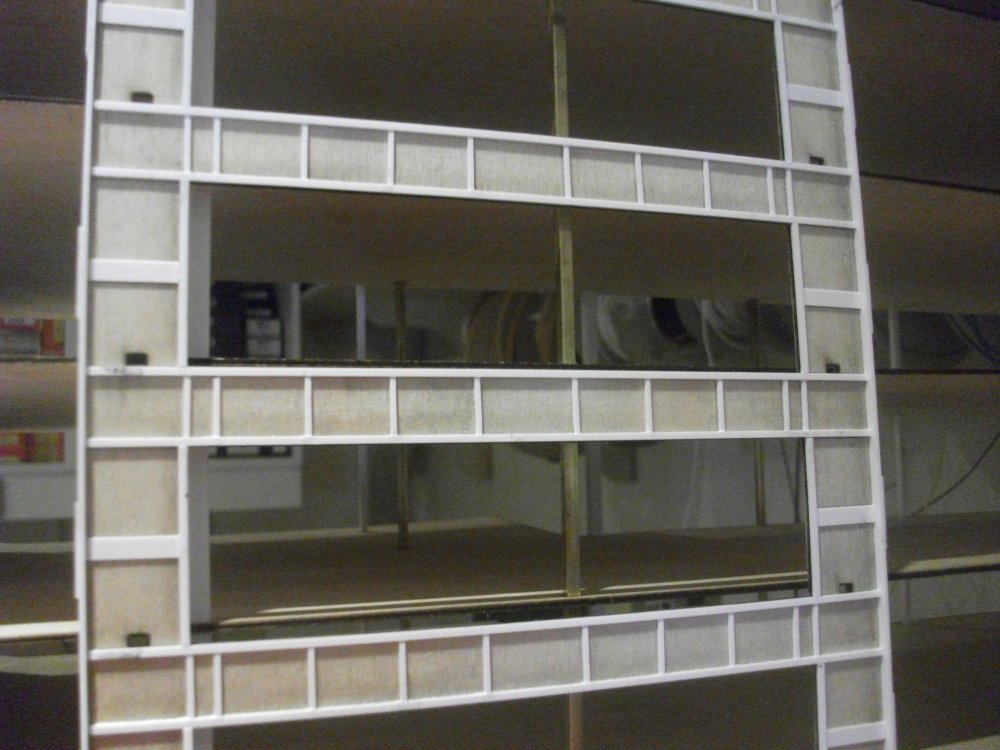

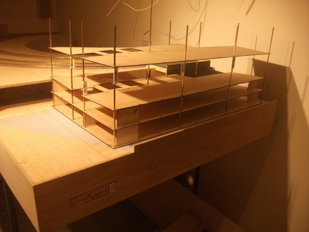

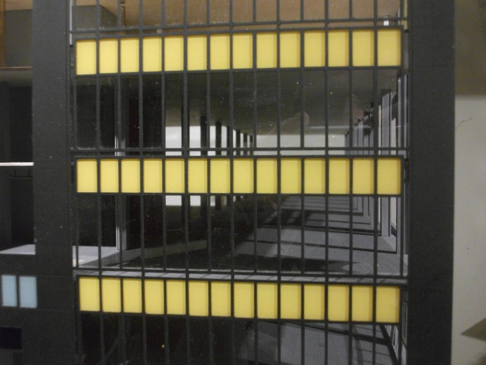

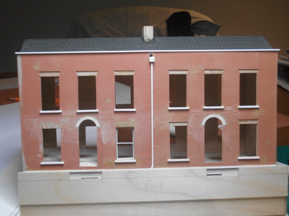

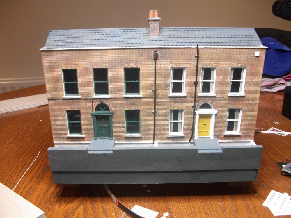

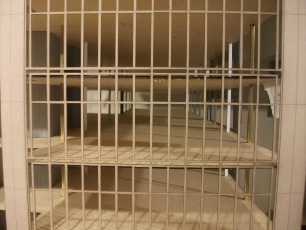

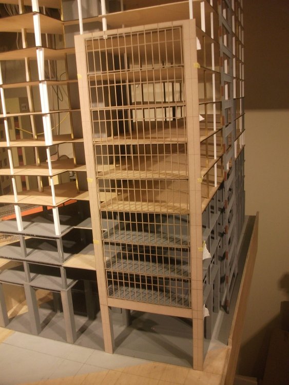

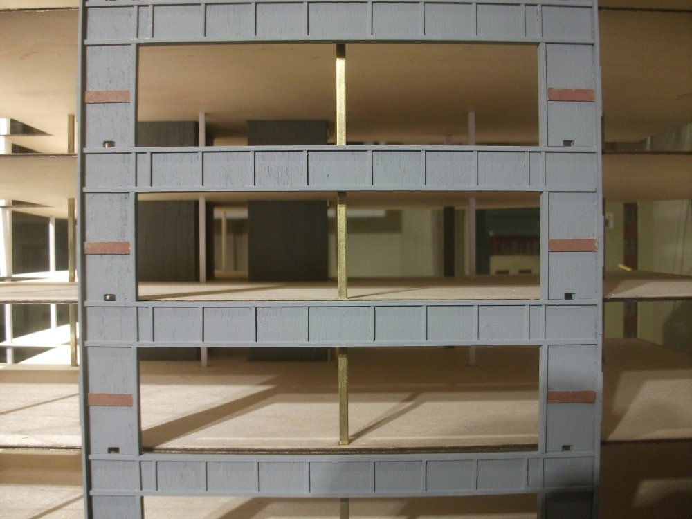

warb Posted August 8, 2018 Author Posted August 8, 2018 After making a mess of the first effort of the front (photo1) I started all over again (other photos) result so far of google building frontage. 5
