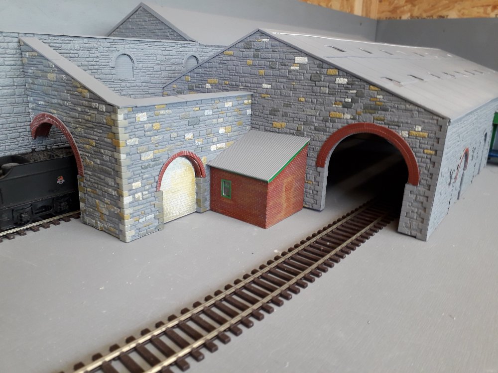

Broithe Posted April 24, 2019 Posted April 24, 2019 Nice! The lichen does often seems to favour particular stones over the others.
GNRi1959 Posted April 24, 2019 Author Posted April 24, 2019 1 hour ago, jhb171achill said: Looks great, Tony! Thanks, I was pleased with the appearance despite its very random application. 5 hours ago, Broithe said: Nice! The lichen does often seems to favour particular stones over the others. Indeed, that I have noticedÂ
jhb171achill Posted April 24, 2019 Posted April 24, 2019 The random application is exactly what looks so good!

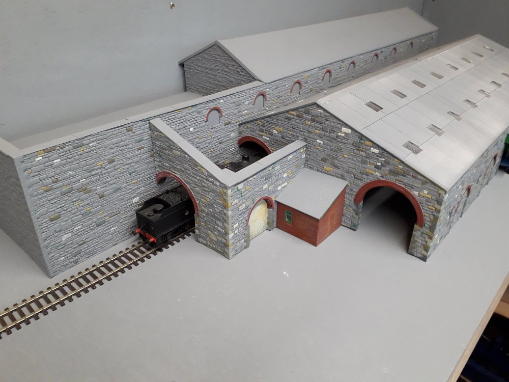

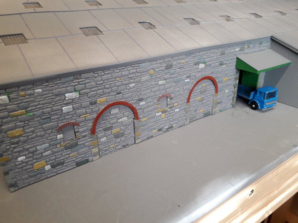

GNRi1959 Posted April 26, 2019 Author Posted April 26, 2019 I have a 5' LED strip above me and a small window. It's a real therapy painting small sections at a time. It does have to look exactly as it was since natural light changes all through the day and the stone changes too. Some progress..... Â 3
GNRi1959 Posted April 26, 2019 Author Posted April 26, 2019 (edited) 11 hours ago, David Holman said: As JB says, it is the randomness that it is all about. That and being bold, but not too bold, with some fairly bright colours to capture the lichen. One thing to remember is to paint under the same lighting as you are going to display the model. Flourescent v spotlights v LEDs all have noticeably different effects. Super work. Thanks everyone, I presume the lichen is painted in rather than the coloured sponge equivalent? More below.... Edited April 26, 2019 by GNRi1959 1
Mayner Posted April 26, 2019 Posted April 26, 2019 The shed looks really impressive Tony, your determination to persevere with Omagh is seems to be paying off. 1

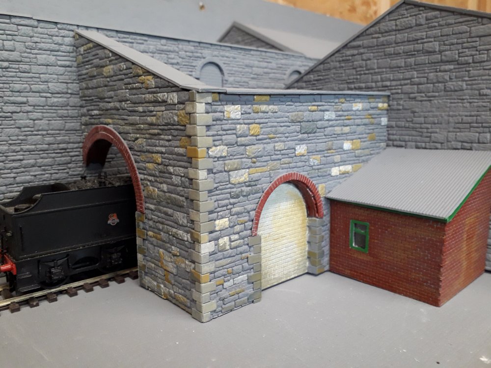

GNRi1959 Posted April 28, 2019 Author Posted April 28, 2019 (edited) Thanks David, some sound advice there. I've tried looking and actual photographs and tried painting as close to what I see but I am building up some sort of colour combinations that look pleasing to the eye. This morning I started on the back retaining wall which housed the UTA depot behind. Â Edited April 28, 2019 by GNRi1959 2

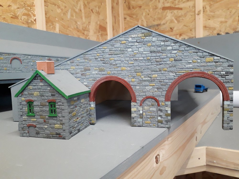

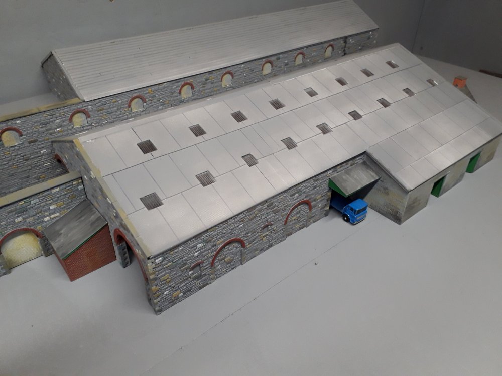

GNRi1959 Posted April 30, 2019 Author Posted April 30, 2019 (edited) Progress moves to the front entrance to the Goods Store and Goods Office. Soon the stonework will be complete and I'll start slating the UTA store roof aboslating Edited April 30, 2019 by GNRi1959 2
leslie10646 Posted April 30, 2019 Posted April 30, 2019 Very nice job, Tony. Keep it up. You'll need an awful lot of wagons for that shed! Come to think of it, I know a guy .........
GNRi1959 Posted April 30, 2019 Author Posted April 30, 2019 (edited) Leslie, the longest siding ran through the entire length of the store, amd had room for four wagons outside the front door. I'll keep Dundalk informed. Edited May 1, 2019 by GNRi1959

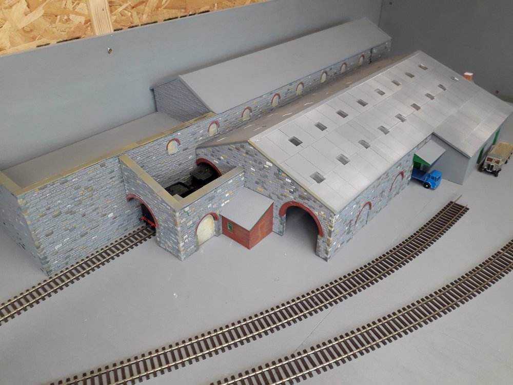

Patrick Davey Posted May 2, 2019 Posted May 2, 2019 And the ‘Model Irish Railway Building of the Year Award’ goes to...... Probably just a trick of the camera Tony but the track in the pic looks correct for 5ft 3!
GNRi1959 Posted May 2, 2019 Author Posted May 2, 2019 Patrick, Thanks for that. I have to paint a small section of blockwork to the extreme left of shot and then I'm ready to start working on all roof surfaces

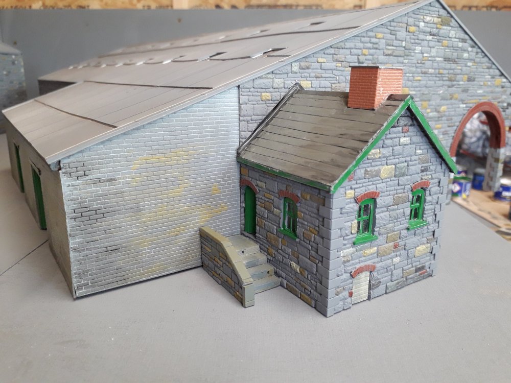

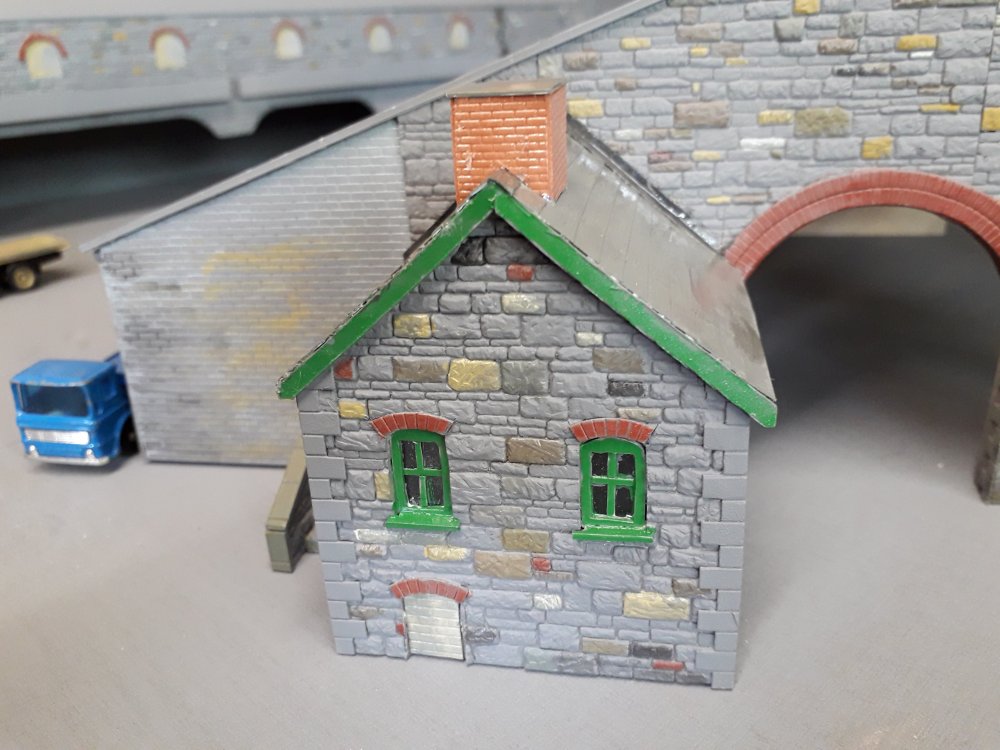

GNRi1959 Posted May 3, 2019 Author Posted May 3, 2019 (edited) Goods Store office secured in place, lead flashing complete and awaiting chimney pot! Incidently, the last Chief Clerk in this office, Paddy McAloon was my next door neighbour until he passed away a few years back. Â Edited May 3, 2019 by GNRi1959 6 2

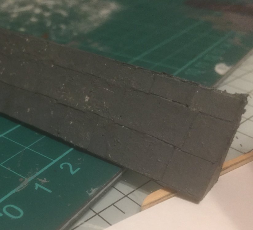

GNRi1959 Posted May 5, 2019 Author Posted May 5, 2019 (edited) This weekend I slated the large UTA transport building roof using fine card that came from old Metcalfe card kits. I cut strips to represent rows of slates and simply glued them down, overlapping each row. I finished the roof with ridge tile. I haven't had time to paint yet but I may scribe tile vertical lines into the strips to be more authentic. Will post pics after painting. Edited May 5, 2019 by GNRi1959 1
