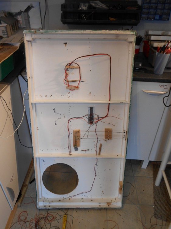

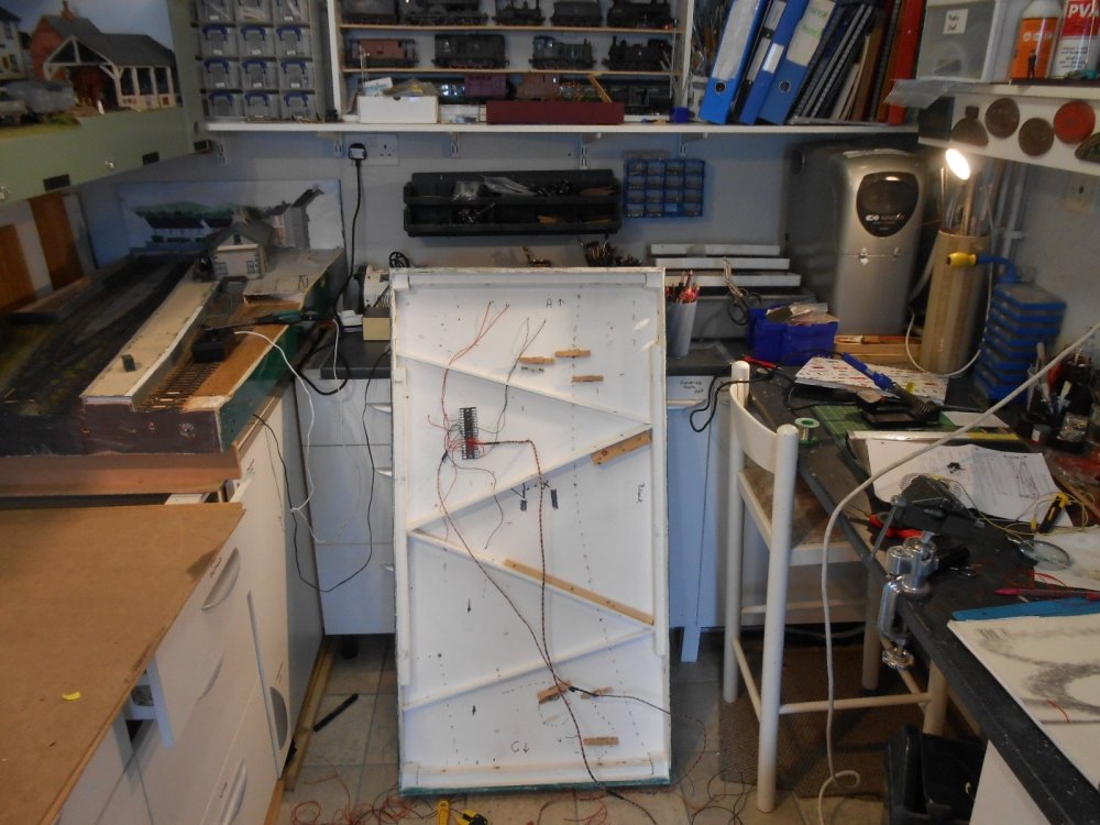

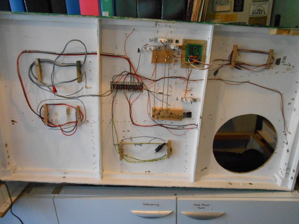

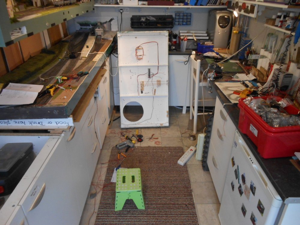

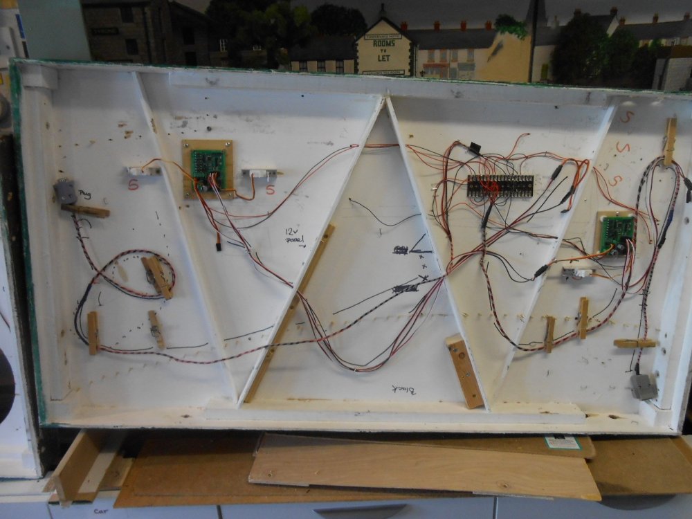

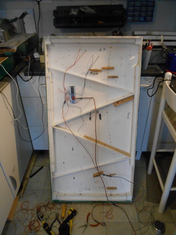

David Holman Posted June 16, 2019 Author Posted June 16, 2019 Organised Chaos Or wiring, in other words. Wiring for me is a necessary evil. Trains won't run without electrickery, but my knowledge is of the 'just enough and no more' variety. However, the biggest problem is my mild dyspraxia - or at least that is how I think of it. Clumsy, a bit, but the main problem is really struggling with anything 'handed'. If there are two ways to put something together, I will do it wrong first, no matter how many times I think about it, while anything with rotational symmetry is a nightmare! Assembling flatpack furniture always takes twice as long as it should do... Wiring a layout is an exquisite type of agony, because you have to reverse what is on top of the baseboard when you wire underneath and likewise plugs and sockets. So, am feeling rather pleased with myself today, because I've managed to rewire the Arigna boards and they work!! I should have taken pictures of the bird's nest of spaghetti that had grown under the original boards, but suffice to say what you can see below is a whole lot neater. Those who know about such things will no doubt have done the job differently, but it works for me. Changes from Arigna are as follows: There is now just a single controller socket on the front of the station board, instead of the four that were there previously. This profligacy was simply because firstly Arigna was operated from the rear at shows, but I needed a front socket for home use. Doubling up both was to accommodate my spare controller, which had a different plug on it. I am sure you are already wondering why I didn't fit the same plug to both controllers, but it seemed like a good idea at the time. I have long realised my mind doesn't always work logically! A Tag strip with 72 loops [2 x 18 double strips] has been fitted under each board. All wiring goes to these first & this is then split and sent to track feeds and baseboard sockets. Staples help keep the wiring fairly neat. Wiring is now just red and black - one colour for each track, with a wiring diagram that tell me which tag strip goes to which feed, socket, etc. Under the Arigna boards, colours were rather mixed at random, using whatever I had to hand at the time. I know... While only 8 wires goes from Baseboard 1 to Baseboard 2 [and only 4 wires from 2 to 3], I have used 15 and 9 pin computer plugs and sockets to keep any stray wires away from touching each other. Baseboard 2's tag strips have leads going from them to the other two boards. In storage or transit, these leads are kept tidy by using clothes pegs hot glued to the underside of the boards. Point and signal control will be by servos, using Megapoints units and a custom made panel. This will be on Baseboard 3 at the fiddle yard end. The Fiddleyard operator will also be the signalman, with the driver at the station end, where all the uncoupling magnets will be too. Although I have no intention of using DCC, it would be nice to have a steam whistle/diesel horn unit, for the driver to call attention to the signalman. Better than shouting down the layout, methinks... Chances are, the signalman will also work the turntable, as it will be easier to align the tracks than from 10 feet away, where the driver will be. Anyway, the above has taken me much of the last week and a lot longer thinking about it. And yes, I did get everything back to front on the first board and had to redo it. Needless to say, a few rude words were uttered. More than a few, in fact. The photos show the undersides of the boards and the chaos that reigned all around me while I was doing it. It took rather a long time to tidy up! 5
Galteemore Posted June 16, 2019 Posted June 16, 2019 (edited) I do sympathise, David, and I suspect Catweazle was on to something. I imagine he was a clockwork or live steam man. I’m always glad when the DC is flowing where it should be - one of the jobs I hate doing! As for ‘knowing just enough and no more’ - well that’s what I aspire to!! Edited June 16, 2019 by Galteemore

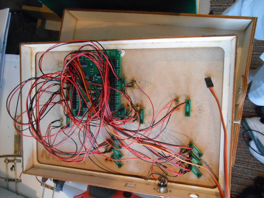

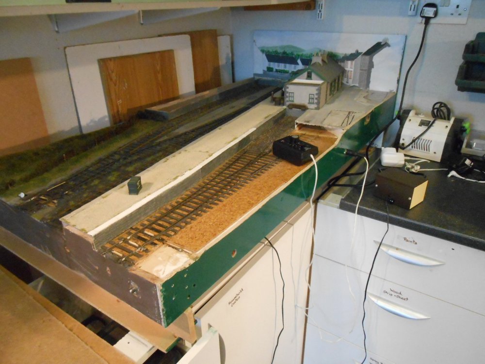

David Holman Posted June 28, 2019 Author Posted June 28, 2019 More Wiring Trials Spent the last week faffing about with point control wiring. I've invested a fair wedge of my hard earned on a Megapoints control system. This has included: A custom made control panel, complete with Belmullet lettering and mimic diagram A master control board, switches and LEDs to go in the panel and which work all the points and signals via a single network cable. Three Servo Driver boards, each controlling four points or signals, which go under the baseboards. The Megapoints stuff also requires its own 5 amp, 12v supply, plus several network cables to join the Servo Drivers together. Hence the under baseboard wiring has grown a bit, to say the least. However, the servos only cost £1.80 each [about a tenth of the price of Tortoise point motors and associated switching], while the entire system is pretty much 'plug and play', requiring the minimum of soldering. It is expensive though. So, what I now have is as follows: A mimic control panel with a lot of spaghetti inside. This comprises leads from the push button switches and LED indicators [green/green for point routing and red/green for signals], which go to terminals on the main processor. A 12v supply goes in from the transformer, with just a three strand network cable going to the layout, instead of around 30= wires if I had used ordinary point motors and toggle switches Baseboard 'C' [nearest the fiddle yard] will have the mimic panel fixed to it with a couple of quick mount plates. A single servo driver has four leads going from it to the three arm signal as seen on Arigna Town, plus the main turnout on entry to the station. There is then another three strand network lead going to the middle scenic board 'B'. Baseboard 'B' has two servo drivers. The first one has two leads to the double slip, with the other two going to what will be two new starter signals at the platform end. The second servo driver covers the point to the loco shed on Baseboard B, then two more network leads go to Baseboard 'A' to work the loco release crossover and the point to the end loading dock off the bay. On the one hand, much of it is fairly straightforward, but with my aforementioned ability to get things back to front, there has been a fair amount of bad language and a lot of head scratching to get it all set up. The system is quite clever, because it enables you to reverse the switches to ensure the lights on the mimic panel are going the right way, while the signal controls allow you to have them bounce and do the 'double pull' as seen on the real thing. In addition, the range of movement on the servos is controllable too - handy for ensuring points close properly. The downside appears to be that the servos, while cheap, may not be all that reliable, so I have ordered some spares already! It may well be prudent to protect the servo drivers with some sort of cover too, eventually. The photos may, or may not make the above clearer... 5 1
Mike 84C Posted June 28, 2019 Posted June 28, 2019 Whooo red and pink spaghetti !! thats far toooo clever for me David 1 1
David Holman Posted June 29, 2019 Author Posted June 29, 2019 A trick of the light, Mick. Track wiring is red and black, network wiring is red, white and black, while for some reason, the servo leads are red, brown and yellow. My mobile phone case is VERY pink though, but only because that was the only colour they had. Even so, still manage to lose round the house!

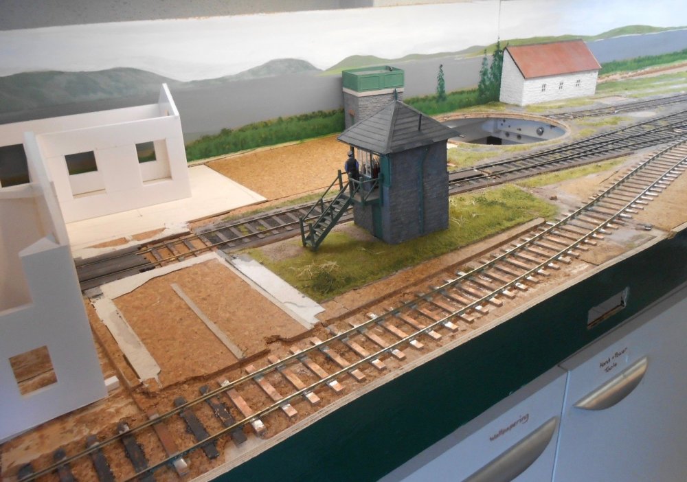

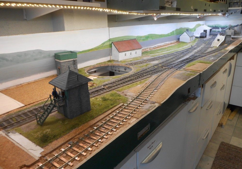

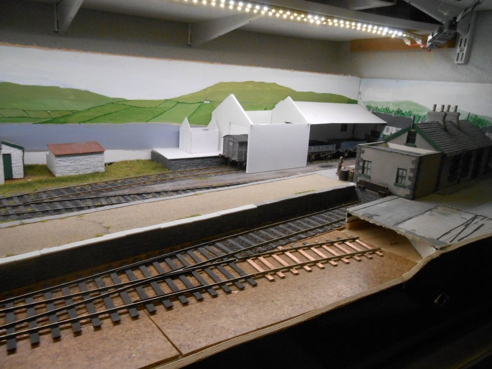

David Holman Posted July 28, 2019 Author Posted July 28, 2019 Getting creative at last Having spent what seemed like an age with the electrics, even though they are not yet complete, I really needed to do something creative for a change. The recent focus has been on the back scenes, as these will go a long way towards defining the setting of the layout. However, before that I needed to get the layout set up as it will eventually be when exhibited again. Arigna Town had built in legs on all baseboards, but these required lots of coach bolts, plus I wanted to be able to use the trestles and beams from Fintonagh as storage space in my workshop is tight. A slight problem is that Fintonagh is just under 3 metres long, while Belmullet [like Arigna] is nearer five. Therefore what I have done is to make extension pieces to the longitudinal beams used under Fintonagh, so they now take the three scenic boards of Belmullet. The sliding/rotating fiddle yard keeps a single pair of hinged legs, adjusted to match the 120cm track height, and piggy backs off the end of the three scenic boards. With that settled, I could then focus on making new back scene boards. These will eventually be in two parts - a permanently attached 'landscape' layer, with separately attached 'skyboards', behind. If I had gone with an all in one back scene, high enough to be covered by the front pelmet, it would have made the baseboards too big to get in the car for transport. I did think about having the sky on a separate, fabric back scene and may yet still go for this, but the structure the latter would require would be complicated and require more setting up time at shows. At the moment, the back scene includes sky on it, simply because I am 'blocking in' the main scenic elements, to help me visualise what the scene will look like when it is finished. Had a railway actually been built to Belmullet, like as not the station would have been parallel to the Blacksod Bay shoreline and a right angles to the canal built to join it to Broadwater Bay. Hence the scene tries to represent a bit of the Belmullet peninsula on the right hand side, with it then opening out to the dark and brooding Achill Island in the distance. The latter section is one I'm so far fairly pleased with, but the peninsula section is currently looking too bright - even for Ireland's vivid greens, so will be toned down as more detail is added. However, I don't want the back scene to dominate the model railway. Other 'blocking in' work has been to make shells for the new buildings and cut out spaces for ones that are being recycled from Arigna. The latter include the signal box, station building, water tower, cottage and barn. The new loco shed and goods shed will both be covered in Wills 'random stone', while in the corner, next to the goods shed will be a 'co-operative' warehouse clad with corrugated iron from the same source. Front left will be a small representation of a distillery - offices full relief, the rest very much low relief. Not exactly prototypical, but it adds a useful extra source of traffic for more interesting operation. One other thing I've done is to transfer the LED strip lighting from Arigna to the underside of the shelves above where the layout mostly lives. This is important as I need to paint the back scenes in the same light as they will be exhibited - it is amazing how much difference different sorts of lighting can make to your palette. 7 2
NIR Posted July 28, 2019 Posted July 28, 2019 (edited) A good impression. A lot of backscenes seem to be taken too high too soon. Even in hilly areas inclination is not really that much, outside of an Alpine valley. Sea inlets too, modernist geometric shapes with lots of straight lines and acute angles, just as you have it. Edited July 28, 2019 by NIR

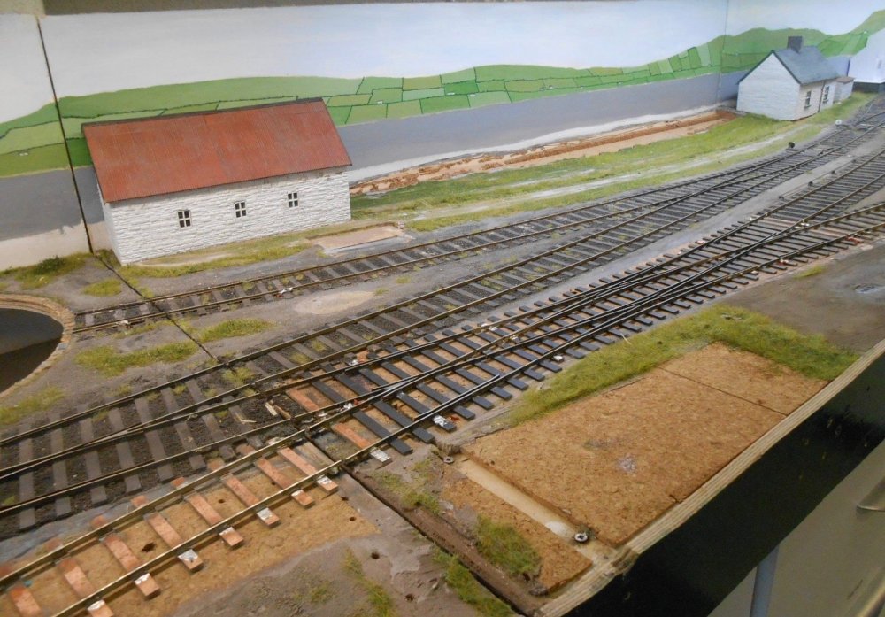

David Holman Posted July 28, 2019 Author Posted July 28, 2019 Thanks JB, it is all soldered construction. The plain track is my work, but the double slip is by Marcway - all £180 worth of it. Well outside my abilities, so a necessary investment. 2

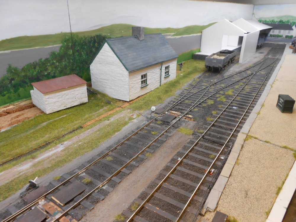

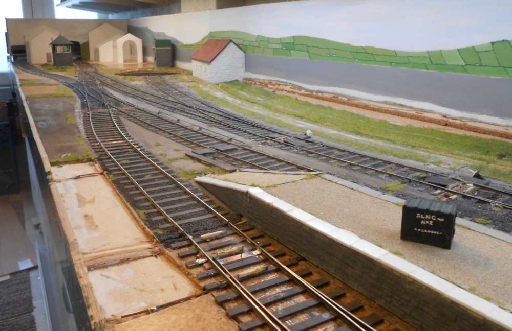

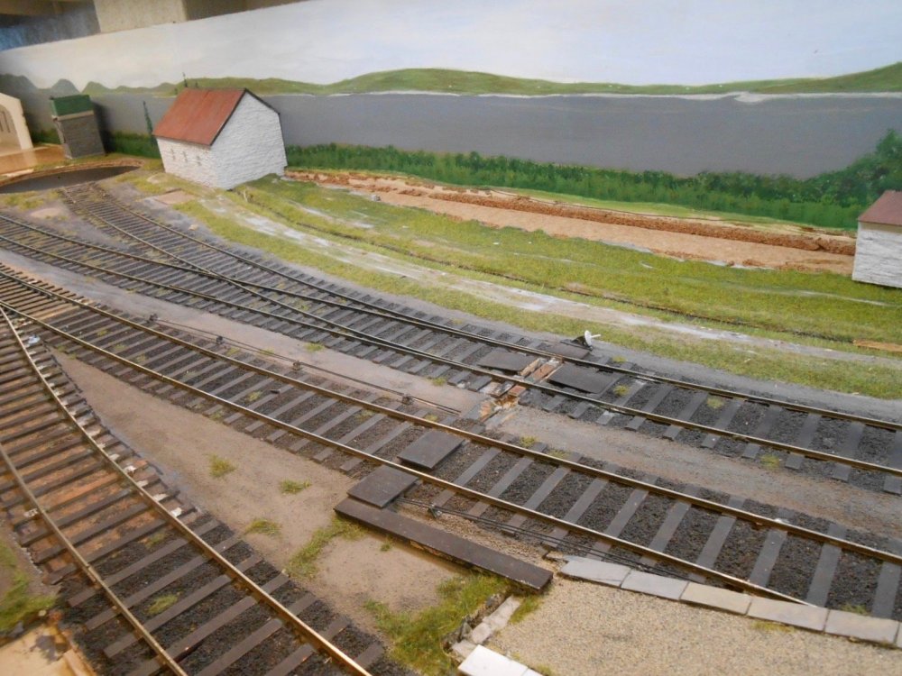

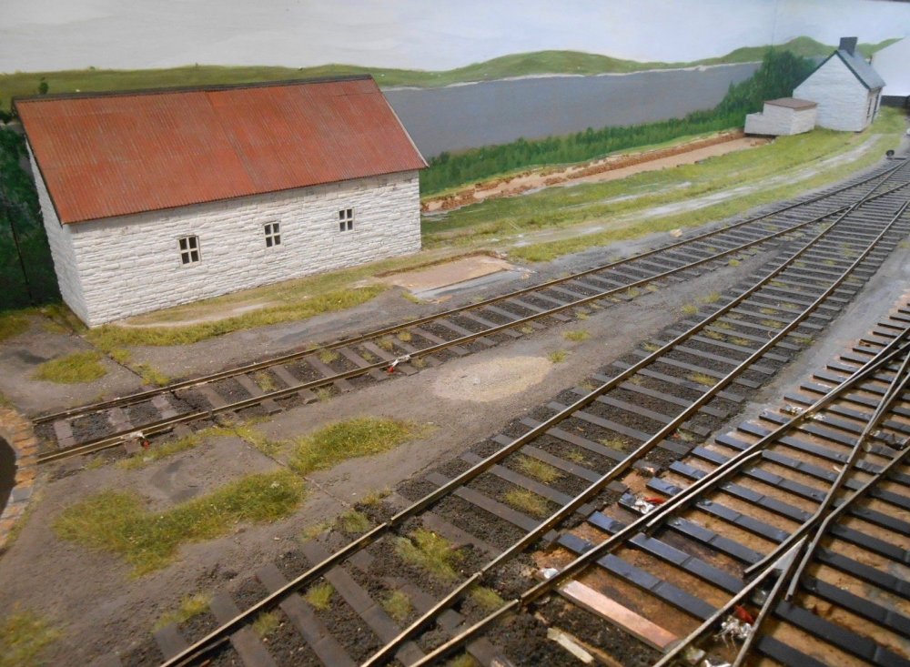

David Holman Posted August 4, 2019 Author Posted August 4, 2019 Adjusting tone and topography A quick comparison with last week's photos should show that the land has shrunk and the water level has risen. Fortunately not global warming just yet, so nobody needs to go out to source gopher wood or animal pairs for now. However, it was obvious that for this part of the Mayo coast, everything was just a bit too big and bright. Google Maps and Google Earth are very useful in helping to get an idea of a landscape far away from home and there are some excellent pictures online too, so the last week has been spent adjusting things accordingly. It is not in any way 100% accurate, but I hope I'm starting to capture the feel of the low lying, almost treeless Mullet peninsula, with Achill Island brooding in the distance. The latter should really be even lower on the horizon, but the back scene topography needs to be as high as the loco shed roof, while as mentioned last time, the sky behind will be on separate boards. I've pondered long and hard about the relationships between the 3D scenery and the 2D back scene - including doing away with the barn and cottage. A long of time has been spent just sitting in front of the layout, trying to visualise things and several sketches have been done too. At the moment, the buildings will stay, though I've angled the cottage to be parallel with the track in the look. The goods shed has been made longer, but also lower, so its roofline roughly matches that of the Co-op store next door. Mrs H has given her approval - she has a good eye for proportions, though this perhaps begs the question of what she sees in me. An unfinished project probably! Perhaps the biggest problem has been how to hide the baseboard joins in the back scene. I considered making the buildings removable [as on Fintonagh], but they would take up a fair bit of extra space when transported. Well painted trees can do the trick, but the area seems rather tree-less. However, checking photos again shows a few conifers, while some of the farmsteads look like they have windbreaks planted, so this is what I've done. The tones of the distant peninsula have been build up with numerous thin washes of acrylic, while I've done away with all the hedgerows and drystone walls. The more distant the landscape, the easier things get as everything tends to blur into a blue/grey, but middle distance requires a bit more colour [albeit pale] and detail. Whether additional washes will be added, depends on how it looks when I next go in the workshop, though the foreground certainly needs more work [it will probably wait until I start the actual ground cover, so I can best match the colours] and the two ends have had little done to them yet. 9

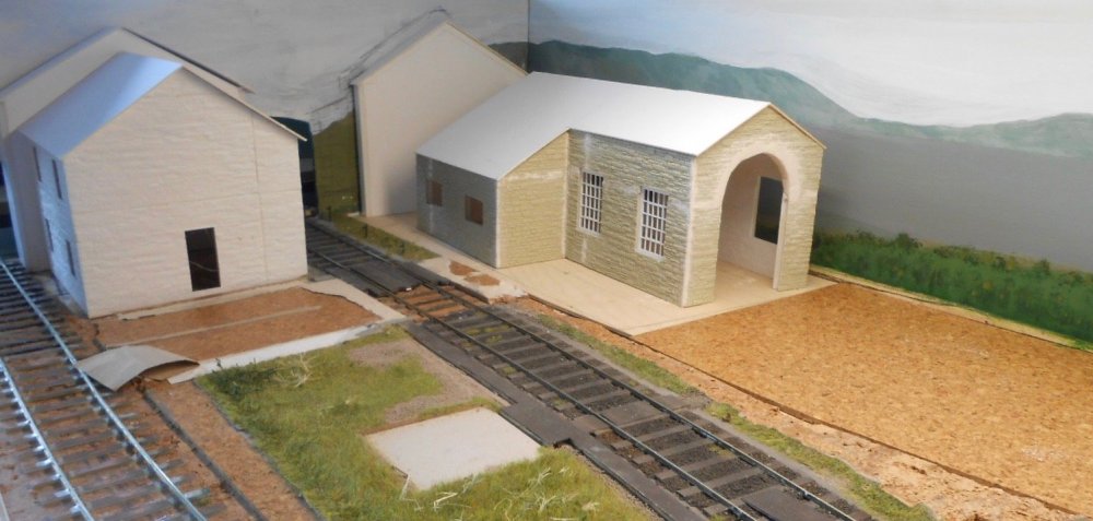

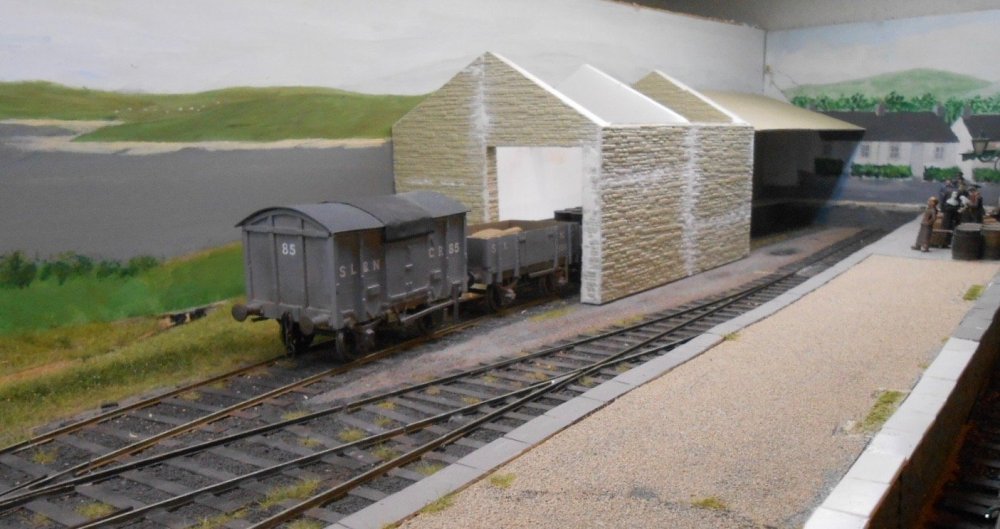

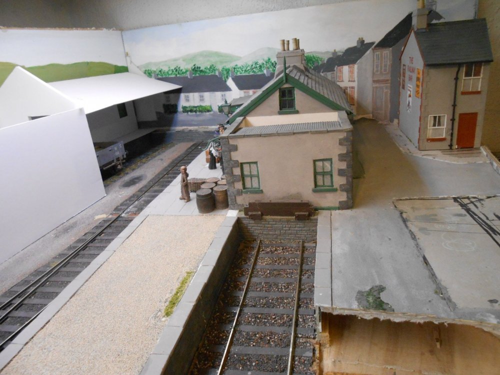

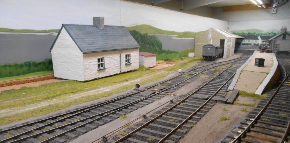

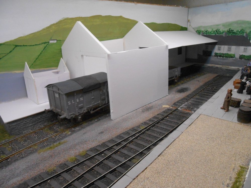

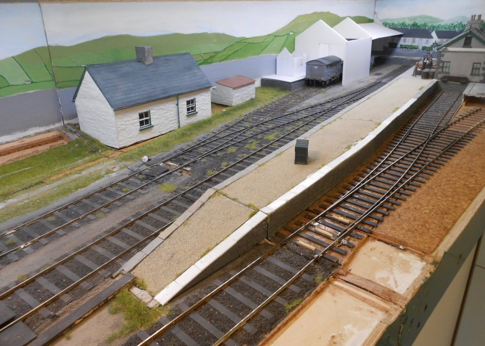

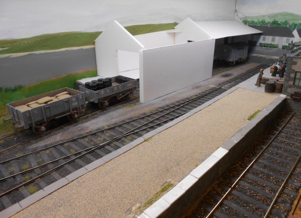

David Holman Posted August 18, 2019 Author Posted August 18, 2019 More 'blocking in' work recently. not very exciting, but gradually builds up the overall scene. The goods shed and loco shed have both been covered in Wills 4mm scale random stone, while the other buildings are rendered stone from the same source. The goods shed is about 3/4 relief, so a very odd shape, which has been done very much by trial and error - lots of both in fact! The windows on the loco shed are from York Modelmaking. With micro strip now costing around 50p for a 30cm length, ready made, laser cut frames are increasingly both attractive and cost effective. Other work, if you can call it that, has been a case of spending quite a lot of time just looking at the layout. Not hours on end, but little and often, in an effort to try and visualise the scene and get the overall balance looking right. Hence the cottage will probably now move to the right hand end of the middle board, so there is room for a bit of hard standing/goods yard effect next to the goods shed. 10

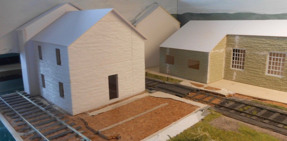

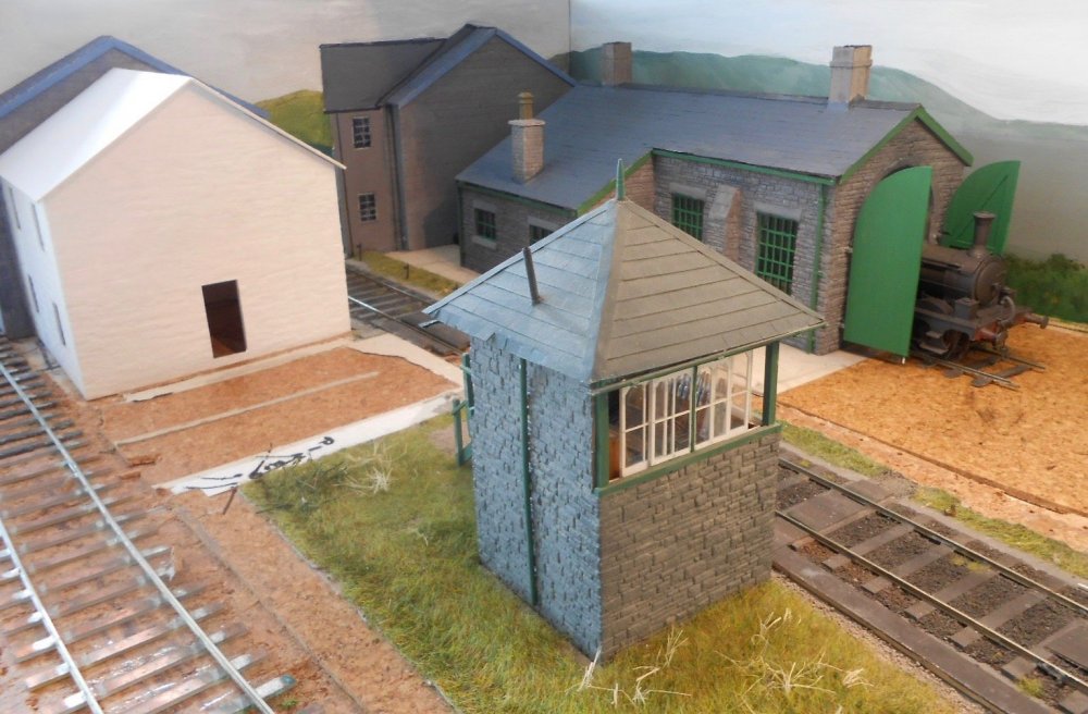

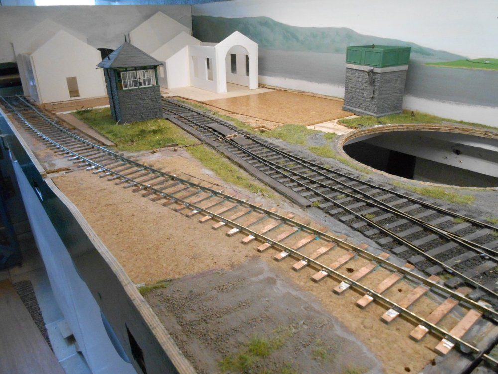

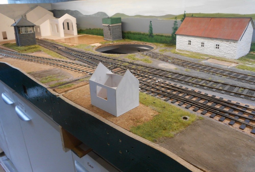

David Holman Posted September 8, 2019 Author Posted September 8, 2019 More visualising Having got a fair way with the loco shed, I next wanted to sort out how it will 'sit' in the lefthand, rear corner of the layout. In an ideal world, both the landscape and separate, sky, back scene boards would be curved at about 10-15cm radius, to avoid a right angled corner in the scenery. However, this is not practical [at either end], so a bit of subterfuge is required. What I'm doing is to use a 'flat' - essentially a 1 cm deep gable end of what is meant to be part of a whisky distillery. This is angled slightly, so that when viewed, the lack of depth won't be apparent. In addition, I've painted another section of this building on the back scene, but at right angles to the 'flat'. Between the signal box and the white building [which is the admin section of the distillery], there will be a scots pine, about 20cm high, which I'm hoping will help to hide some of the above too - including the hole in the sky, where the main line exits to the fiddle yard. The Belmullet Distillery - home of Blacksod Bay Whisky - will be a useful source of traffic to the railway, with not just grain in & booze out, but also peat to fire the boilers. There are of course peat workings nearby and this also gives me the excuse to build and run two or three of those splendid 'peat wagons', made from converted WL&W six wheel coaches, by boarding up the windows & removing the roofs. 5

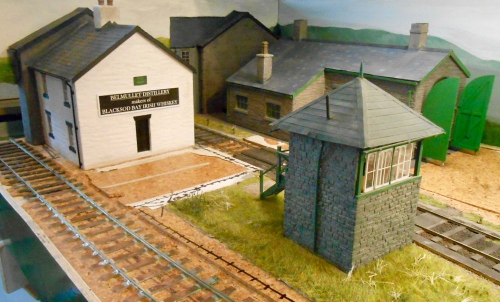

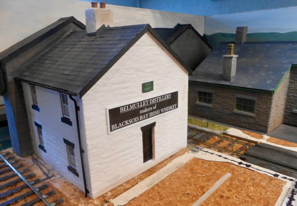

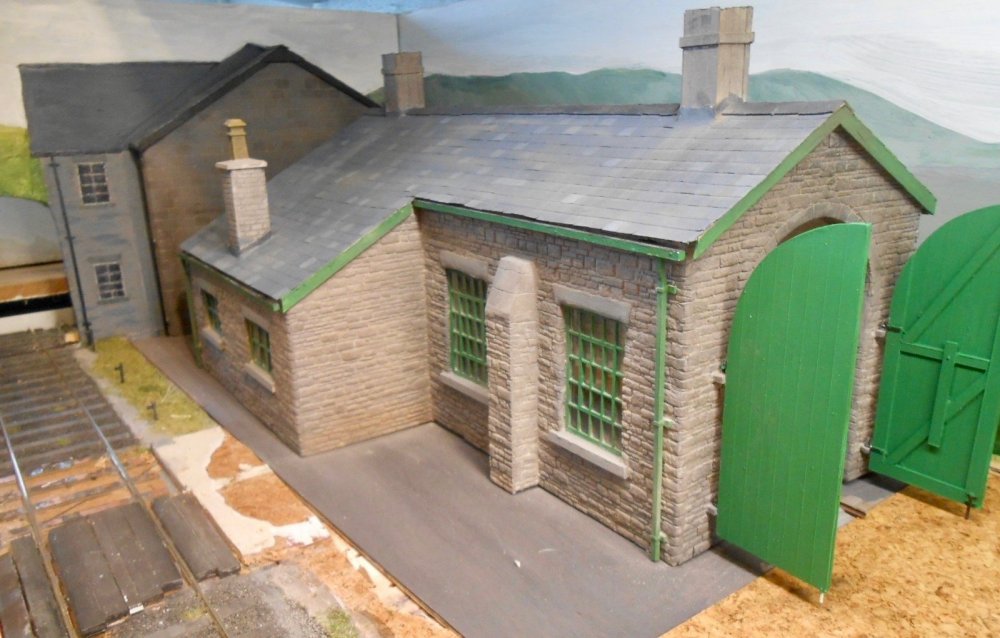

David Holman Posted September 25, 2019 Author Posted September 25, 2019 The left hand end of the layout is starting to come together, with the addition of part of a distillery and some weathering to both this and the loco shed. Not sure whether those of you in the Republic have access to BBC 1, but a lovely programme over the last couple of years has been 'The Repair Shop', where highly skilled individuals are challenged to bring interesting objects back to life. Needless to say that Steve, the clockmaker, is a bit of a hero, but I love them all and frequently take inspiration from the patient, gentle approach they all take to their work. Kirsten, the ceramics expert is another favourite, particularly for the delicate way she overpaints repairs made to broken pottery. Frequent, light washes of colour are the norm, rather than go in with just one or two coats. Would love to say this is my method, but am afraid I tend use to one or two fairly solid coats of the base colours and then start altering tones from there, using a variety of media. Hence for the stonework on all the buildings, light washes of acrylic in lighter tones than the base colours go on first, then a few individual stones are picked out in darker or lighter tones with a fine brush. Once this is dry, I get out the weathering powders and again using fairly light tones, give all the walls a good dusting over, working the powders into the mortar lines as I go. Most of it ends up on the workbench [or better and old tray, when I remember], but the main thing about the powders is they completely flatten the paintwork, so you have an absolute matt finish. The powders also make the window glazing nice and dusty too. The slate roofs are done much the same way, with individual slates picked out in lighter tones [essentially blue, black and a lot of white, very watered down] and again once dry attacked with weathering powders. I find pale browns and beiges soften the roof quite well, but pay particular attention to the direction of the dusting. On the walls, a general scrub usually works, but on the roofs, the powders need brushing downwards from the ridge tiles, to simulate the action of rainwater running off. Worth comparing the photos below with earlier ones to see the difference. Hopefully, they are subtle! The distillery has been labelled as 'The Belmullet' and it produces 'Blacksod Bay Irish Whiskey' [note the e], the lettering being done on the computer and the the print off stuck to some thin plastic sheet with a micro strip border. 7 4
warb Posted September 25, 2019 Posted September 25, 2019 top class modelling coming together nicely as usual
PorkyP Posted September 25, 2019 Posted September 25, 2019 The streaky slates look good, I'll have to pay more attention next time I'm up a ladder fixing broken slates, (that i end up doing occasionally) I'll often use little strips of lead to hold up a replaced tile which leaves a small visible 'tab' in the middle of the bottom edge of a tile, probably a bit tiny to do in model form tho it's a common repair bodge on old slates!

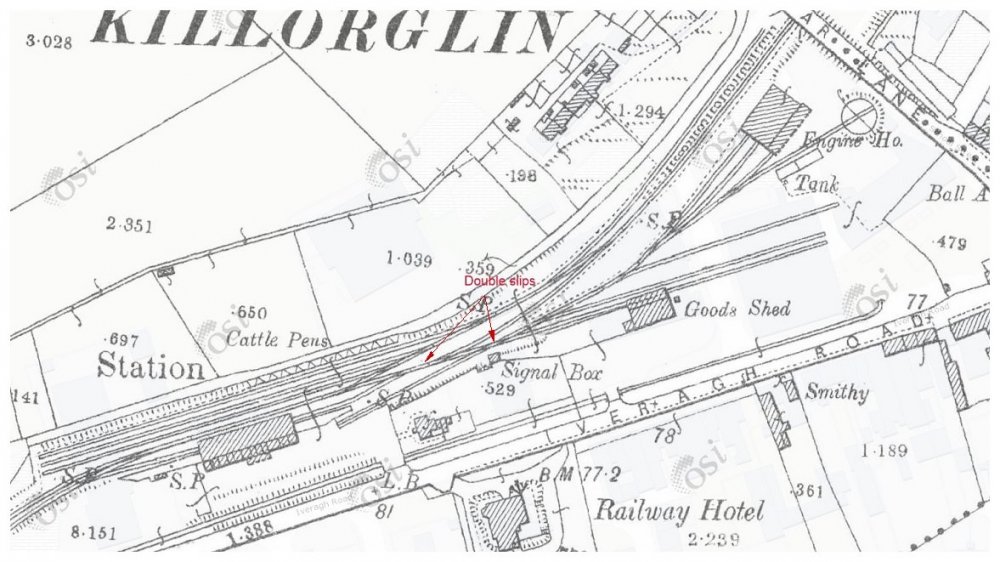

Mayner Posted September 28, 2019 Posted September 28, 2019 Killorglin was a good example of the use of double slips in a GSWR branch line context with two double slips on the crossover from the main running line to the goods yard. Paul Greene's Kilbrandon Layout is based on Killorglin. http://killorglinarchives.com/killorglin-railway-station-1958/ Killorglin was originally the terminus of the line from Farranfore before the branch was extended to Valencia, the station had a fairly impressive overall roof similar to Tullow with wooden rather than masonry station building, stations on both the GSWR Valencia Harbour extension and Kenmare branches were to a standard corrugated iron design, though the WLWR used a standard rendered masonry design of station building on the line north from Tuam to Collonney Junction built during the same era as a "Balfour Line" to Belmullet. 4 1
David Holman Posted September 29, 2019 Author Posted September 29, 2019 Wow, that is good company. Many thanks.
