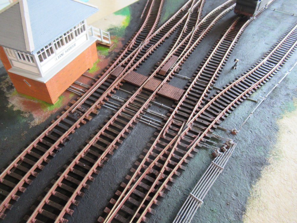

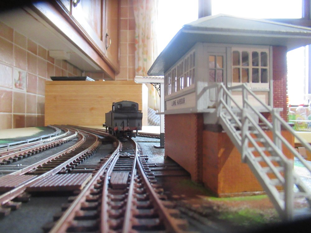

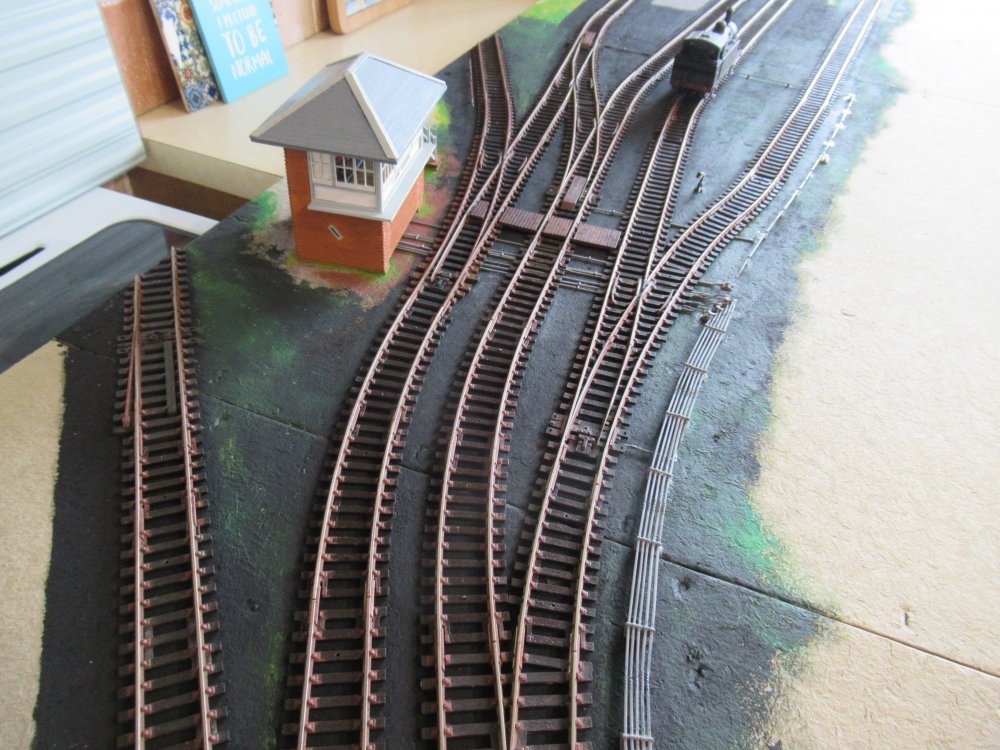

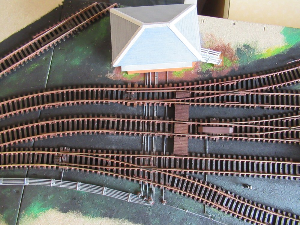

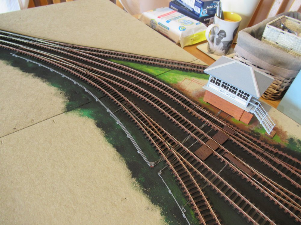

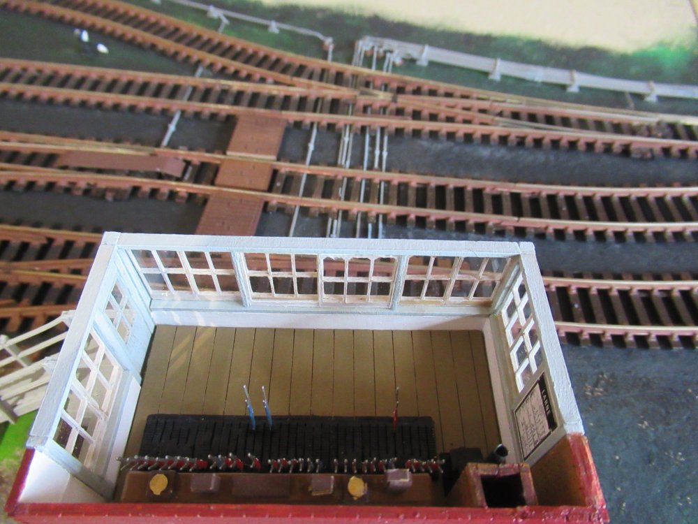

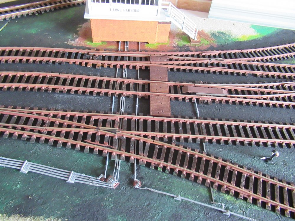

The Signal and Telegraph Gang have been working on the six rod run for a few weeks now. The run is being assembled in two sets of three rods each. The first set being assembled is the set furthest from the running rails. Looking down from the bridge on the Olderfleet Road gives a good impression of what has been achieved so far.
The set being assembled has already been connected to the associated levers in the cabin.
The cranks are arranged at different heights to prevent any one rod from fouling any other.
The rod furthest from the running rails is connected to Lever 21, which controls the point giving access to the Short Up Siding with buffer stop (yet to be included).
The next rod is connected to Lever 19, which controls the point giving access to the Longer Up Siding (which extends beyond the scope of the layout) and hence to the Short Up Siding and the final rod of the three, as far as I can ascertain, connects to Lever 6, which gives access to the siding behind the Signal Box which runs along parallel to Harbour Road.

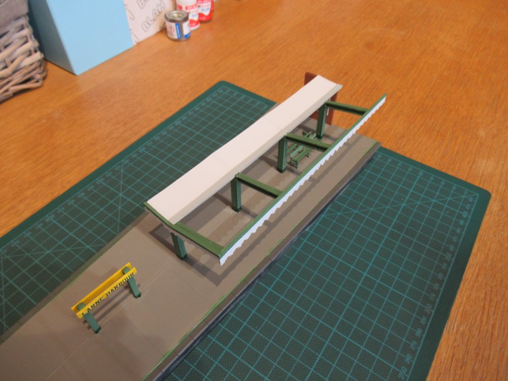

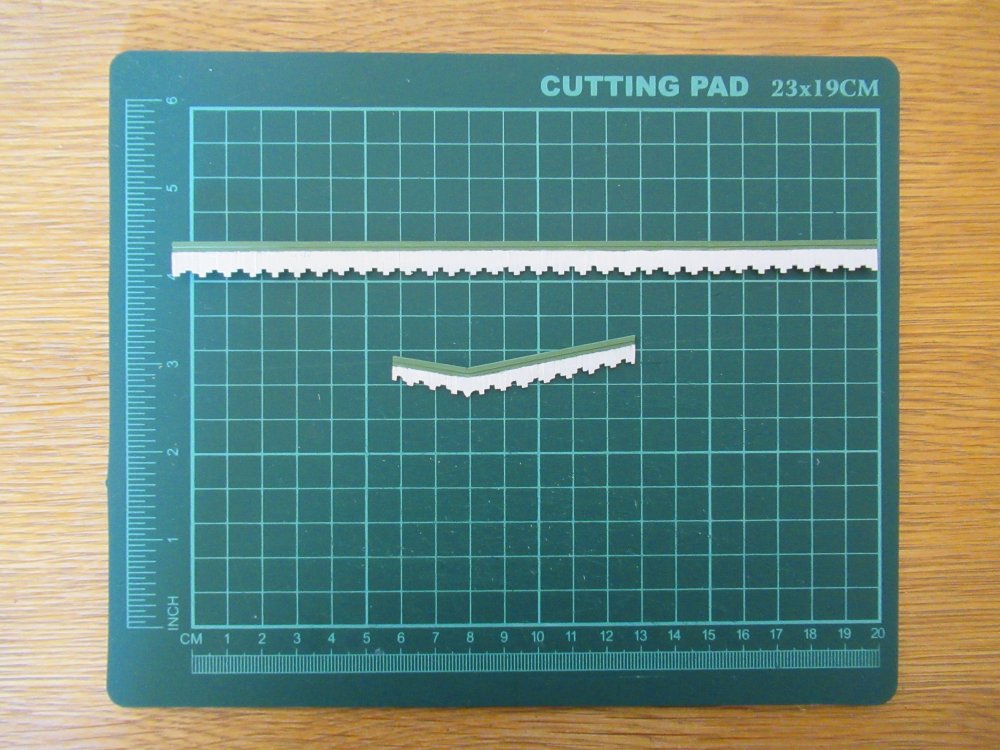

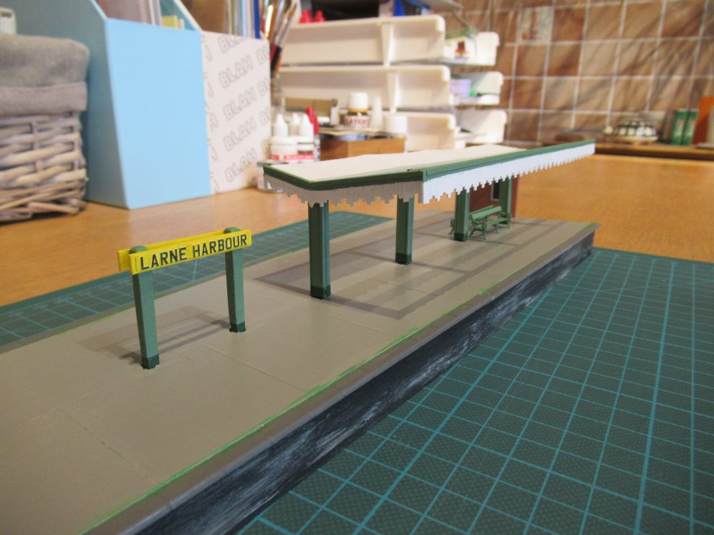

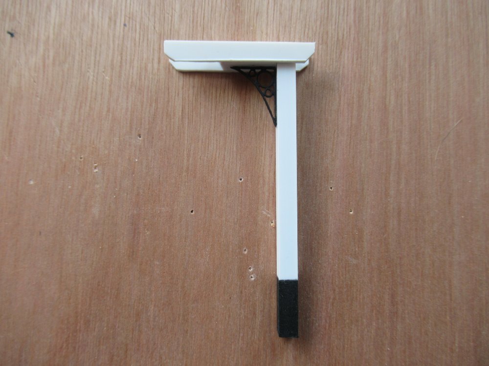

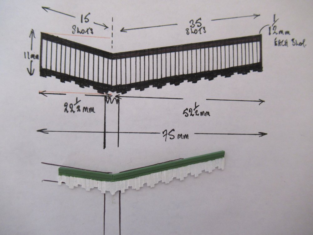

Time for some more work on the canopy. As mentioned in a previous post, the photo in Ian McLarnon Sinclair's Along UTA Lines (courtesy Station UK 29829) has been used as the best available end-on view. I've made a sketch from that and then modeled using Plastikard and 1.5mm x 0.5mm Plastruct Styrene Strips. I've used 5mm, 6mm and 7mm strips to model the pattern as close as possible. The long platform section has 125 strips!
This is the valence now added to the stantions and the rear corrugated roof added.
I have not put in the roof on the front section yet, as I am hoping to include some translucent corrugated strips.
This photograph is by Des Fitzgerald and is produced in Derek Young's The Ulster Transport Authority in Colour. As mentioned before, it has given me a lot of detail about the platform face and the state of the trackbed in the platform area and also helps a lot in proportioning a model in limited space. For example, a 46 foot Jeep will sit between the start of the platform ramp and the Swan Neck Lamp and then the distance between the Swan Neck Lamp and the Station Nameboard etc., so it allows me to realistically model the start and give some perception of a very long platform........
........... and so this is my version, so far. Gaugemaster GM816/819 is an almost identical version of the Swan Neck Lamp, but very difficult to source at the moment. I have a rake of UTA carriages so all that is missing is the Jeeps. Just waiting on IRM! 🙂
  • Like 8

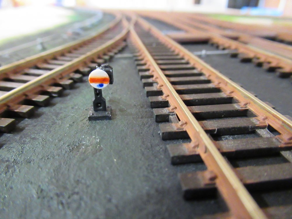

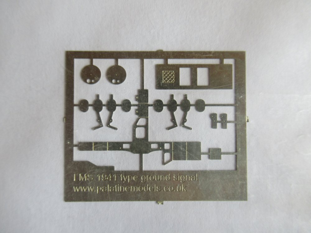

And now for something completely different, as they say. At the harbour I have recently been focusing my attention on ground signals. In 1969 there were eight ground signals still in place at the harbour. I will include five of these on my layout. Omitted is the signal linked to Lever 26 which controlled exit from the minor harbour sidings to the Down Main Harbour Siding line, which was connected to the Down Main Line, and I have lifted these ridings ie. no room for them. Also ommitted is the double stacked signal linked to Lever 16 which controlled entry to the Down Main Harbour Siding. This is omitted because although the Down Main Harbour Siding is still in place in 1969, it is about to be lifted (and I only have room for the start of this siding).
For 4mm modelling there is very little available, mainly the Ratio 465 plastic kit and the MSE fret. The Ratio kit is decidedly GWR. The lamp and back blinder are totally wrong for the LMS! I have built up two Ratio signals and adapted them as much as possible, but very difficult in such a small scale!

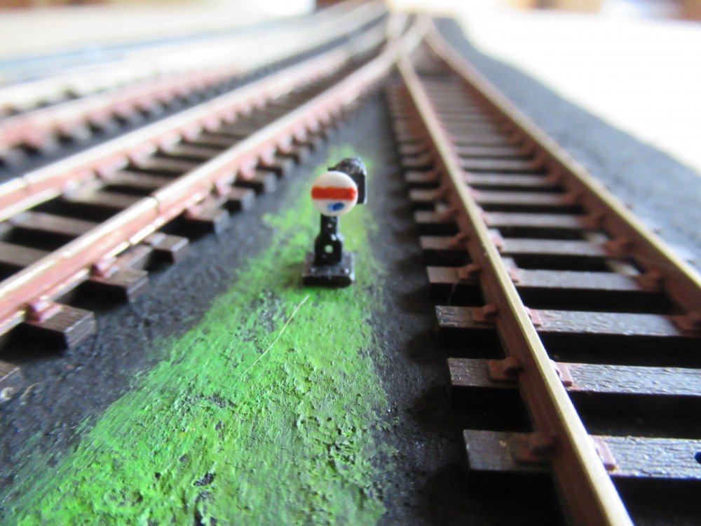

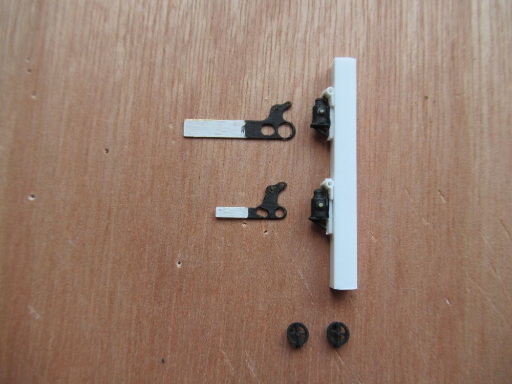

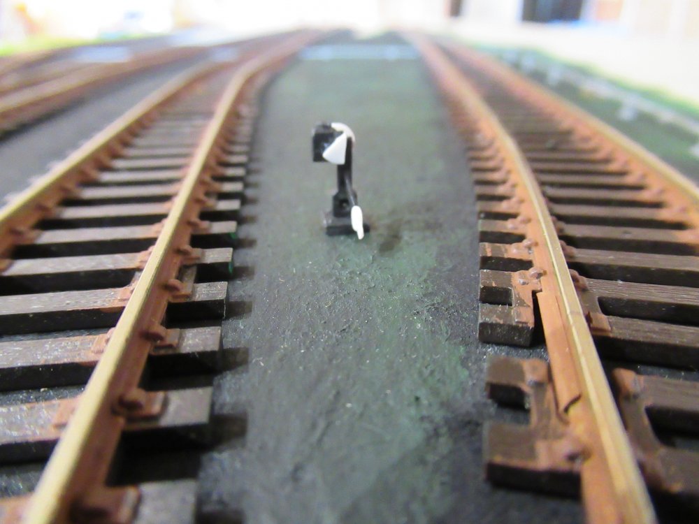

This is the signal controlled by Lever 17 which controls exit from the Down Harbour Road Siding, which runs behind the Signal Cabin, out unto the Down Running Line.
This is the signal controlled by Lever 18 which controls exit from the Up Long Siding and eventually out unto the Up Running Line via the Upper Quadrant Shunting Signal controlled by Lever 20. Lever 18 controls two ground signals, this one, and another for the Up Short Siding with buffer stop. Two discs controlled by the one lever, so some more research to be carried out there! Perhaps half pull and full pull! We'll see.
I have cut out and glued on the little triangular back blinder to make it look more LMS prototypical.
To be honest, I am not really too happy with these. They're not up to the standard I like to attain, so I'll probably use this as a learning curve and start again using the MSE fret.
This leaves the double stack ground signal almost in front of the Signal Cabin. This signal is controlled by Lever 22 and controls access to the two platform roads. The top disc controls access to the line on the left, ie. Platform 2, the former Narrow Gauge Platform and the bottom disc controls access to the line going straight on, ie. Platform 1, the main and long platform. I have decided to put a lot of effort into this one and build it as carefully as possible and provide for a future working disc signal. This causes an authenticity problem though. Larne Harbour was resignalled by the LMS in 1932/33, so the ground signals are most likely, and look like, the older type, but it's stated that the older type LMS Ground Signal dates from 1934! In order to have any chance of a working signal I have decided to use poetic licence and use the standard 1941 LMS ground signal as produced by MSE, and also this handy little fret produced by Palatine Models. The discs on this are particularly good. Any working stacked discs I've seen are made from the 1941 pattern.

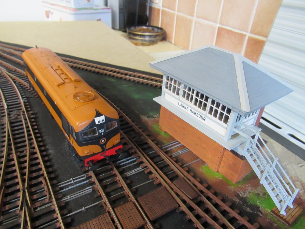

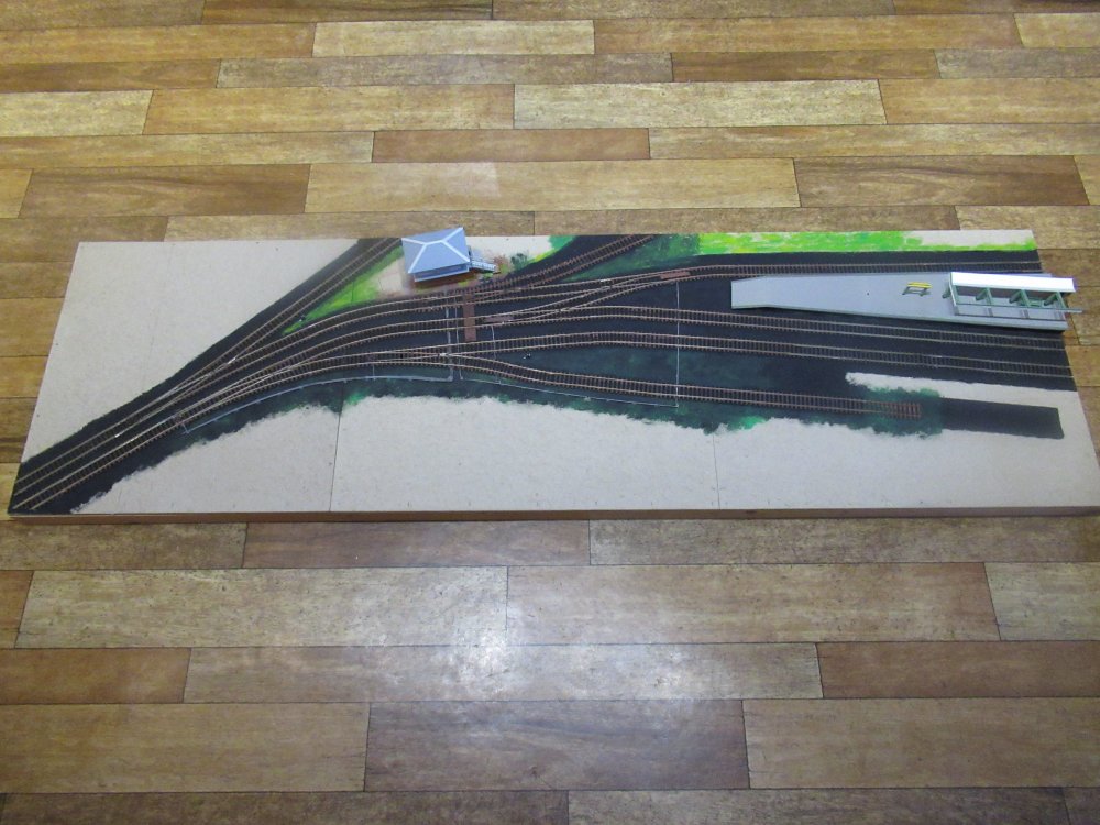

Last Birds Eye View was October 2020, so I thought it was time for an update. 6' x 2' board (to fit into 6' x 2' alcove). Olderfleet Road bridge bottom left corner, rough stone wall along siding along Harbour Road. Harbour Road and walls of Aluminum Works top left, house shown in many photos bottom right, and possibly Lobitos Storage Tank! Eventually, I hope to paint backscenes on three sides to give perspective. Long way to go, but enjoying it so much................
Edited by LARNE CABIN

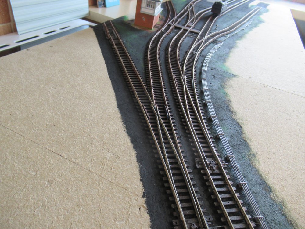

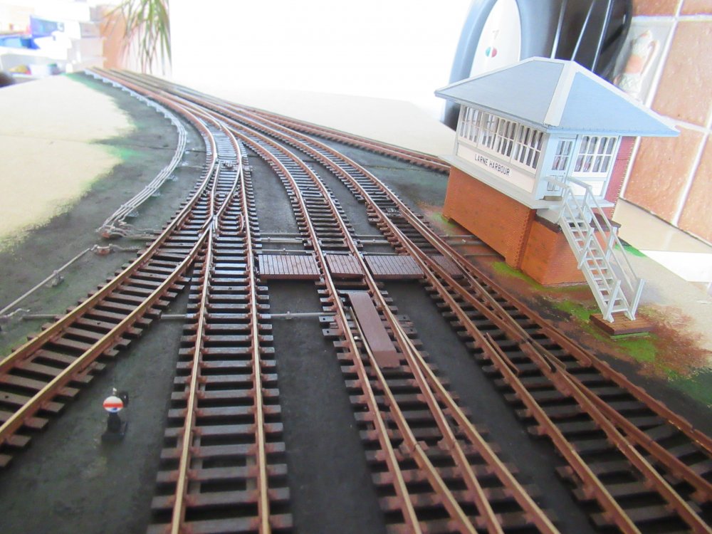

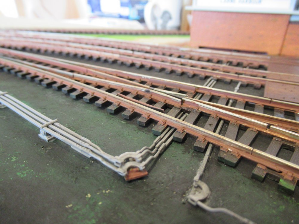

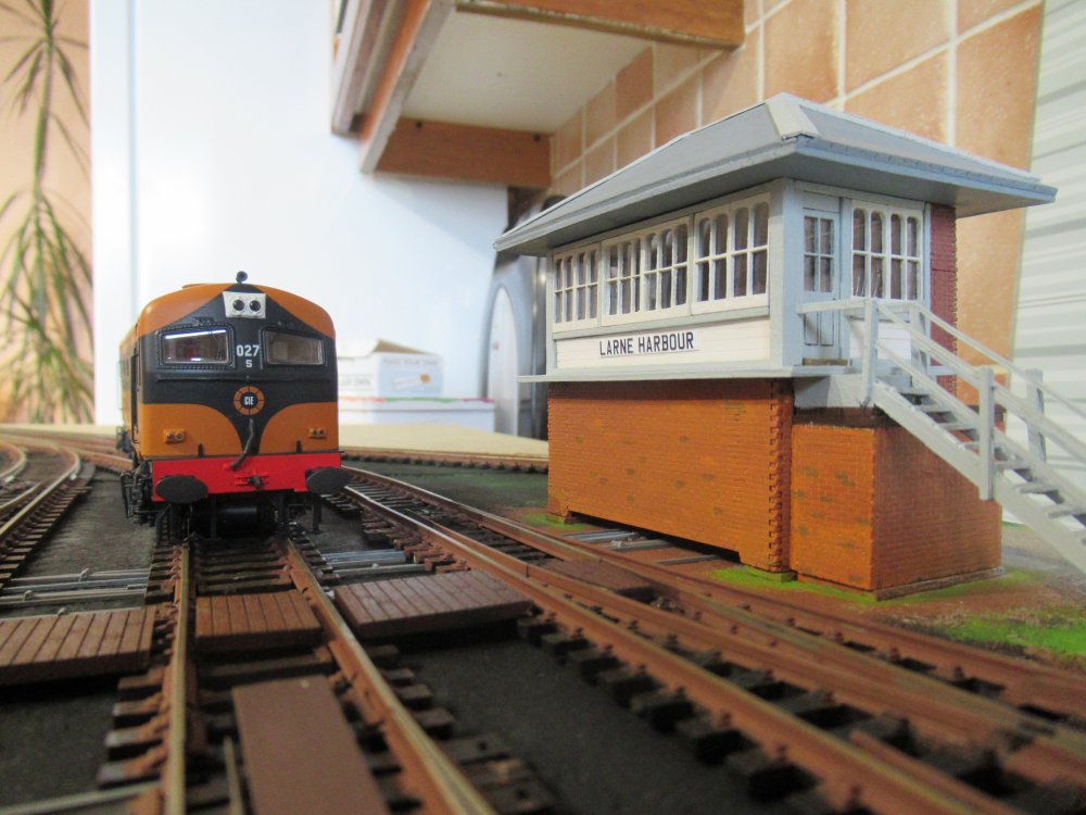

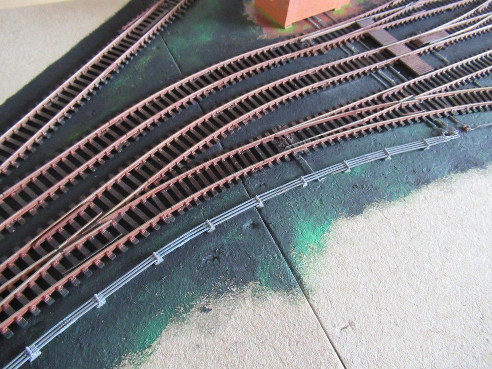

The 4th run has now been installed, right down to the bridge (or the fridge, in this case) .......
and connected to the lever frame.
The 4th, 5th and 6th runs will have to be installed one at a time as the curve makes it difficult to install more than one run at a time and keep the alignment correct. Each outer run becomes slightly longer than the previous run, so a little insert has to be deployed to keep the alignment correct.
This caused a right rumpus when the P W Inspector turned up unexpectedly to see how the gang were getting on! The Gang Foreman got a right telling off. I caught this conversation between two of the older and more experienced men in the gang. They were relating what they had overheard, with some amusement, I might add!
"Yer man maun be doon frae Bellamaina hey, hes a bit o ane strang brogue, yer man says 'onie eejit kens thon ootside o a bend be a wee bit langer nor thon inside, sae yis shud hae stairted on thon ootside rin an shoartened thon rins as yis moved in ........ noo yis hae tae lengthen iverie rin as yis move oot, bot sure a sappose yis is doin a good jab o it' ".
Translated into English that reads "The man must be down from Ballymena [a town in County Antrim, Northern Ireland, many of it's population having a strong Ulster- Scots accent], he has a strong accent, he says 'any idiot knows the outside of a curve is a bit longer than the inside, so you should have started on the outside run and shortened the runs as you moved in ......... now you have to lengthen every run as you move out, but I suppose you are making a good job of it' ".
So there it is, we all learn as we go along, and the Gang Foreman will know better next time!
Hope to get the 5th and 6th runs completed soon and then have a look at signal pulleys!

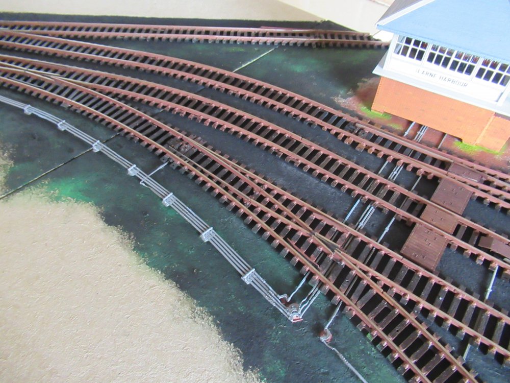

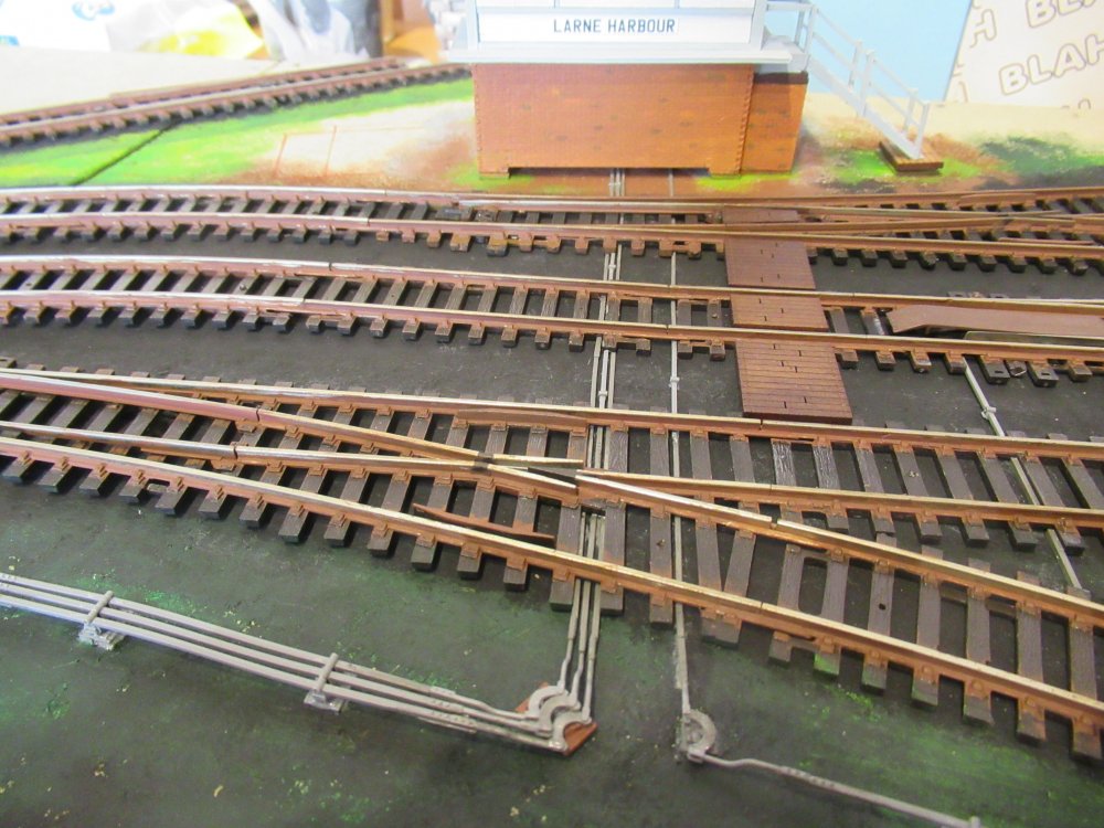

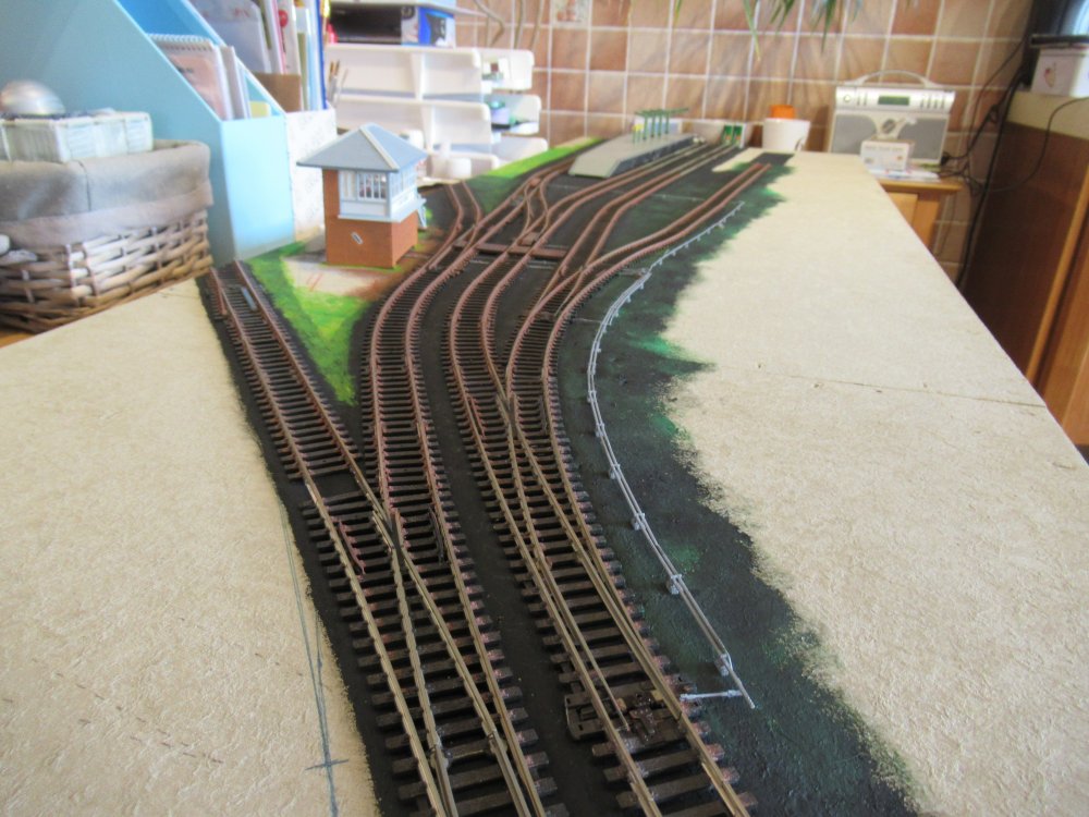

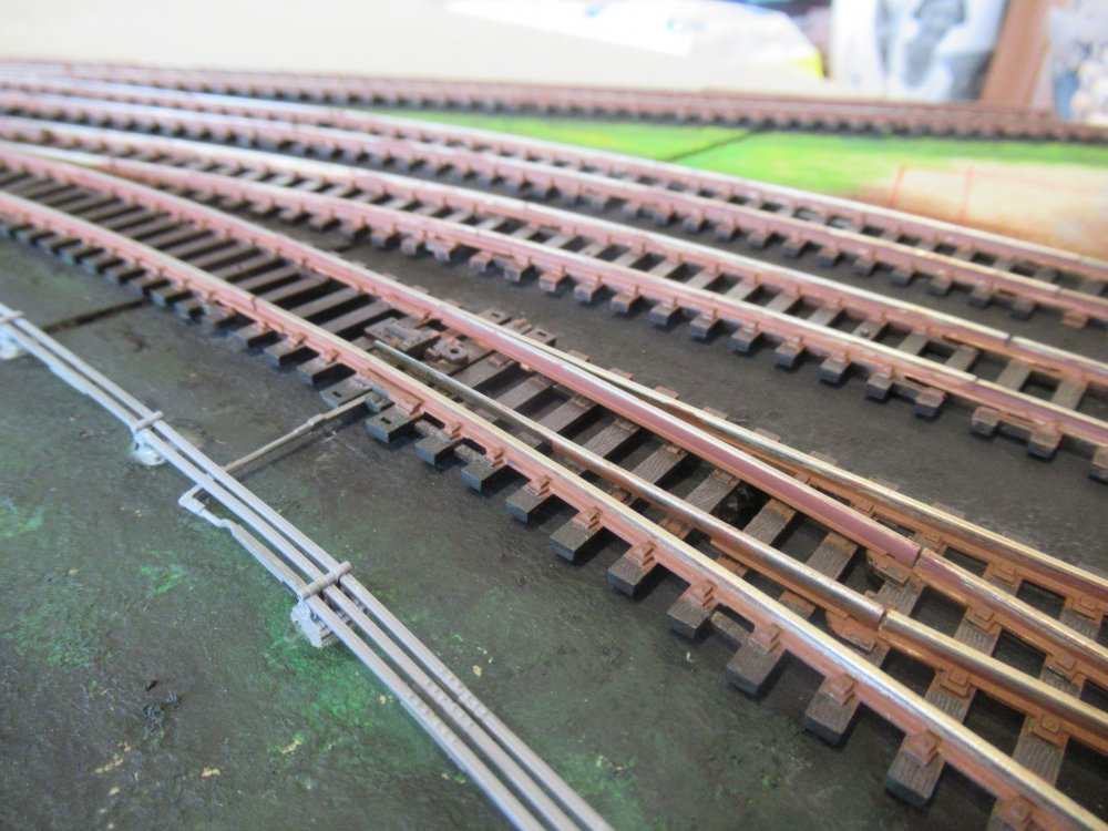

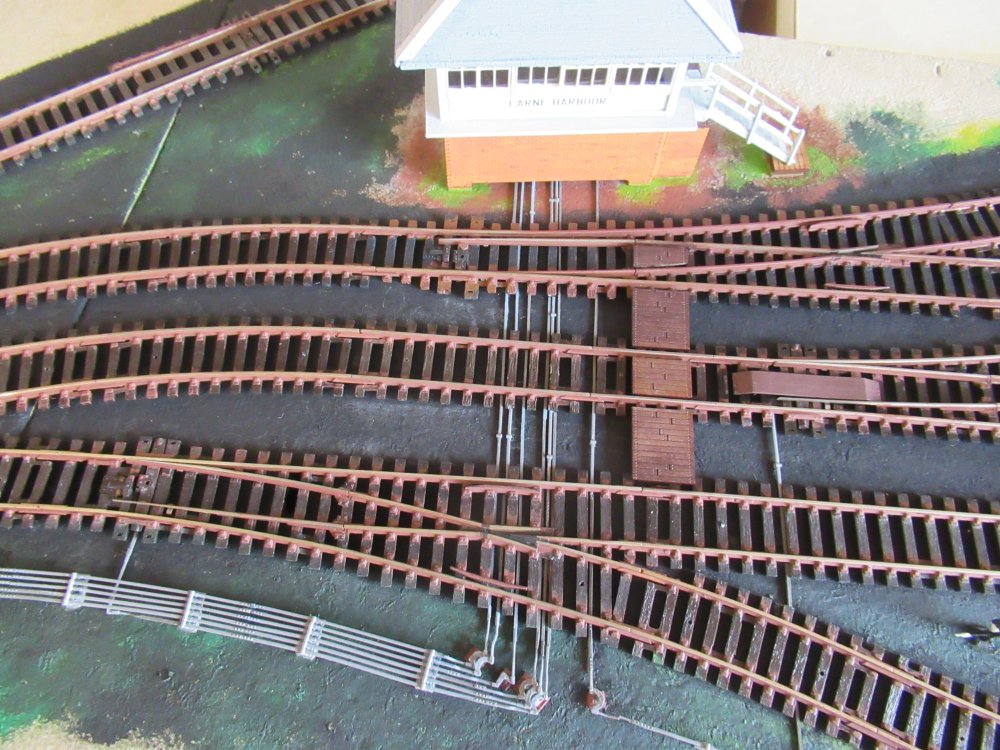

The six rod run is now complete! All rodding installed and all connections made to the lever frame. A few minor alignment adjustments to be made before the P W Inspector comes down again from Ballymena later in the week (so expect some more Ulster-Scots dialect again soon!).
Note that no ballasting had been attempted yet! I am hoping to include some signal pulleys etc. before any ballasting.
375615850_Phase2nRodding.thumb.JPG.2563749ad1388accaaeae3324248fb9e.JPGI324196192_Phase2mRodding.thumb.JPG.423ac82210258b346ef5b40a8627eff7.JPG
When I first started out on the rodding, I thought after a few attempts, why am I doing all this, it's a huge task, but then I thought of the ultimate aim, realism and a photo of a model that someone has to look twice to decide if it's real or not. @Noel 's Gort Station is truly inspirational and something to strive to emulate.

On 5/10/2021 at 2:25 PM, jhb171achill said:
What did you use for the point rodding and associated gubbins?
@jhb171achill , the point rodding, cranks, downset drive joints etc., are all Wills Kits, SS89 Point Rodding and SS90 Point Rodding Extension Kit. It is very difficult to neatly line up the rods, so I watched a video on Utube which showed how to put a little styrene strip under each join. This makes it much easier to line them up neatly and makes a much more sturdy joint. I used Plastruct Styrene Strip 0.5mm x 1.5mm for this.

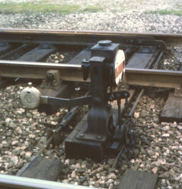

There are three sets of semaphores within the area being modelled. The simplest is the single shunt signal connected to Lever 20 and controlling exit from the Up Sidings out unto the Up Running Line. The second is the bracket signal, close to the cabin and connected to Lever 30, controlling exit from the Down Harbour Sidings out unto the Up Running Line. The third is the impressive and defining feature, the Platform Starter, with the two main Signals, the Up Platform 2 Starting Signal connected to Lever 31, ,the Up Platform 1 Starting Signal connected to Lever 32, and the two shunt signals, Lever 11 from Platform 1 and Lever 12 from Platform 2.
As my first project, I have started with the bracket signal. There are two reasons, first I have never built a signal before, so this will give me some practice before attempting the challenging Platform Starter and secondly, if I have this signal in place it will allow me to begin completing the area around the cabin, telegraph poles, ballasting etc.
I have used this 1985 photo, ©Jonathan Allen, to give me the detail of the signal, position, size, structure etc., it really is a sturdy structure........
© Jonathan Allen
It's amazing how you can look at a photograph time and time again and not see the obvious. I pondered for months on how this signal connected to the lever frame, as there was no evidence of any pulleys etc. on the ground! Then it just dawned on me. If you look closely you can see just above the rail, a rusty signal wire, passing through a pulley post to the crank at the base of the signal base post.......
........ and again here we can see the rusty signal wire continue to the box and presumably enter the locking room via the hole created by removing a few bricks.

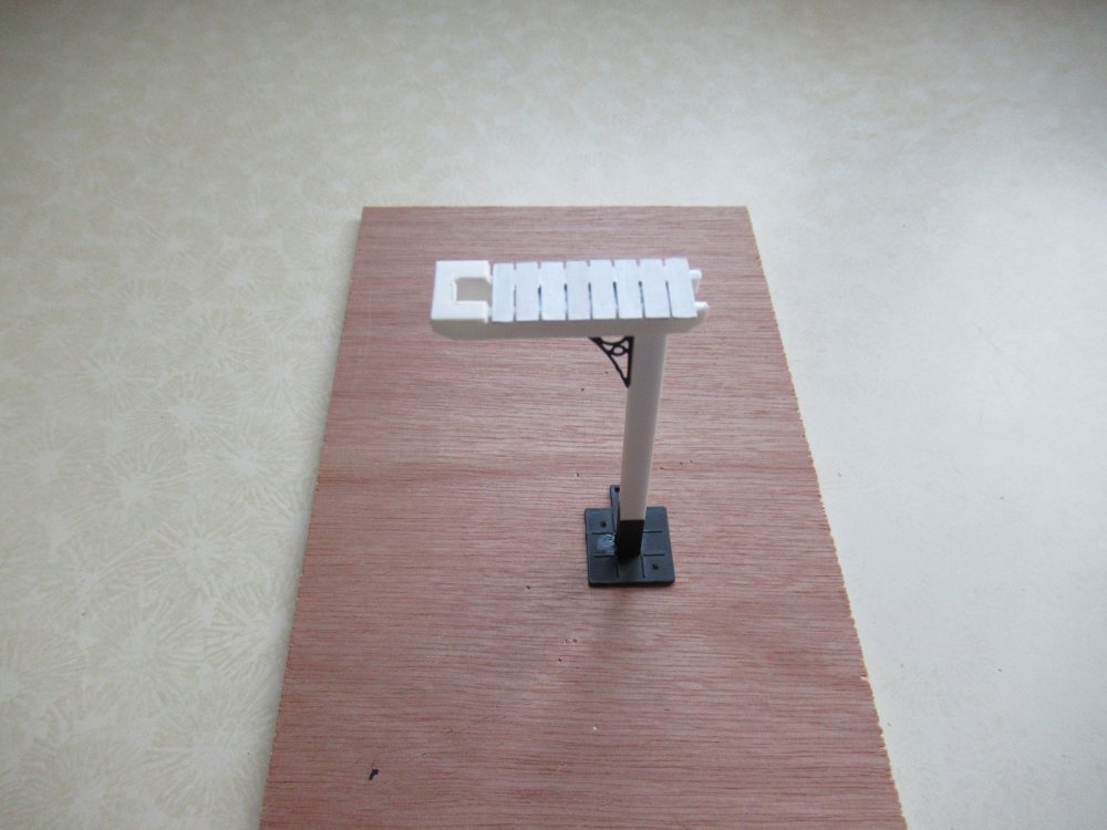

To get as an authentic look as possible, various materials have been used. The base post is Plastruct Styrene Rod, 4.8mm square, the trimmers are made from plastikard and the bracket is of course from a MSE fret.........
.........the landing has been added, MSE fret, and the base for the doll, plastikard .........
.........just checking the height next to the cabin before too much detail is added.......
.........the start of work on the doll, the doll is Plastruct Styrene Rod, 4mm square, the lamps and lamp brackets are from a Ratio Kit, the arms are from an MSE fret and the pulleys are 3d design. I haven't decided yet whether to paint the arms or use transfers. I'll probably use transfers as they will be neater and I am so pernicity about detail. The spectacles will probably be the most difficult part!
.........by the next post I hope to have the detail complete. The idea is that the wire from the short shunt arm will come across the trimmer via the two pulley wheels and down the base post to the crank and hence under the baseboard, so that eventually it will be operational. A wire from the crank will pass through a pulley post and into the box, as a dummy from the main arm, which will not be operational, so more later.........
