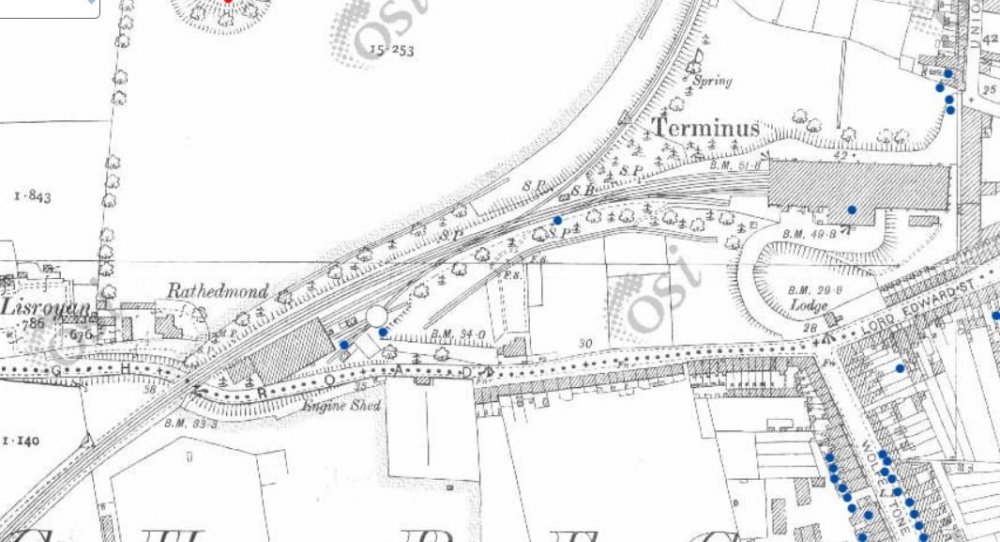

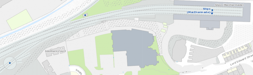

I can't speak for Limerick or Galway,  but Sligo had no run round loops at the station:-
The two centre roads (now only one) were used for carriage and rolling stock storage and regularly full to capacity.
There doesn't appear to be any run round facility without blocking both main lines so presumably a station pilot was used here.
If my scaling is correct then the whole station from the back of the engine shed to the end of the station building would fit in 9' x 2' in 2mm scale...........hmmm.........

I think Sligo's two platforms were an arrivals platform and a departures platform, the platform on the left when arriving and the platform on the left (the other one) when departing, so the arriving coaches were pulled out and set back into the other platform.

As already mentioned, trains arrived in Sligo at the left hand platform, furthest from the station building. The train locos would then propel the coaches back out of the station well beyond the signal cabin where they would run round the train and then propel back to the right hand/near platform. This was certainly the procedure in the late 80's/ early 90's.

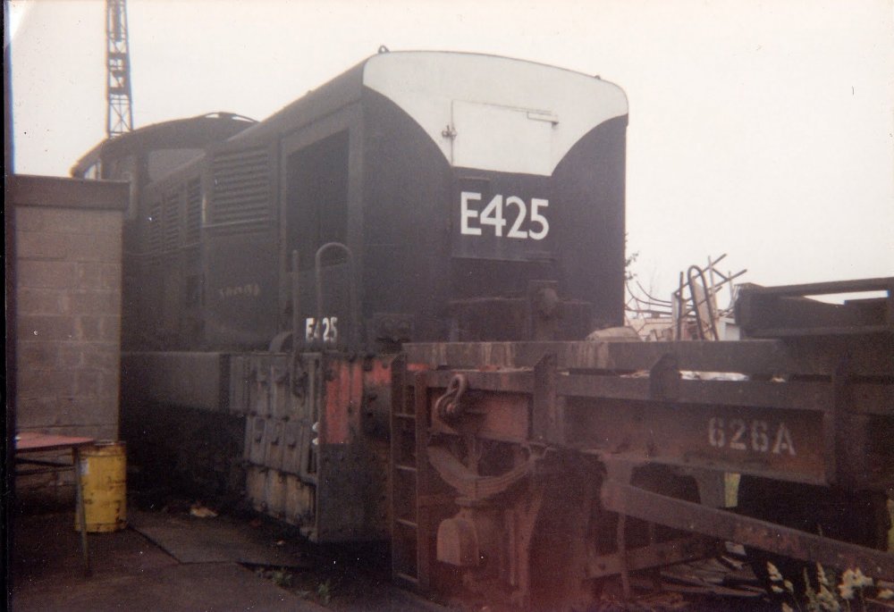

I have a (rubbish) photo I took on an MRSI trip to Inchicore in, I think, 1989 of withdrawn Maybach E425 and it has the name 'Sambo' chalked on one of it's engine compartment doors. A reference to a previous pilot engine perhaps?

Wow!!  That's exactly what it was a reference to - that would make an interesting display nowadays!

I'm intrigued,  If the train was propelled past the signal box then, from the track plan posted there is only one crossover so the train can't run round.
I can see that working on the modern rationalised layout as the line reduces to single track.
https://photos.signalling.org/picture?/19486/category/1974-2000_may
I don't know when the line was singled, prior to that was there another crossover not shown on the OS plan?

All - the track plans on OS maps often omitted points and crossovers. I saw one, one time of Strabane which didn't show the Letterkenny line as being connected to the rest at all. The absence of a suitable crossover in the above doesn't mean it wasn't there - it had to be. But as others have already said, there were no turnout up against the buffers - just the four parallel track we all remember.

Hi Angus, I'm not sure of the exact track layout in those days but I'm pretty sure that was the procedure. One of Gerry Conmy's videos on YouTube ( Trains at speed, Ireland part 3 or 4 perhaps) shows 2 141's backing out of Sligo and then reversing in to the other platform, and I witnessed it myself back in the day!

Checking some more plans on the Historic Environment viewer the cross overs are shown in a different position which correlate to MD220's memory and the signalling schematic in the link.
https://webgis.buildingsofireland.ie/HistoricEnvironment/
The link above didn't work sorry!
So, either the cross overs were shifted back at some point or the 25" drawing is wrong.
