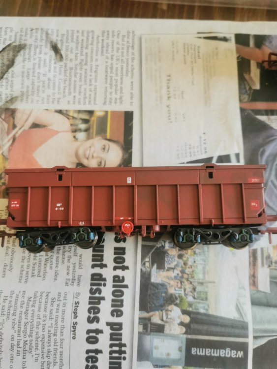

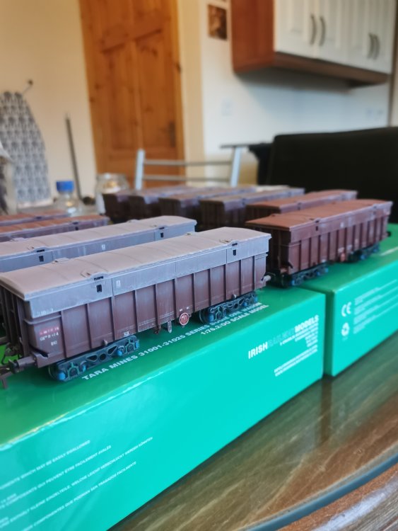

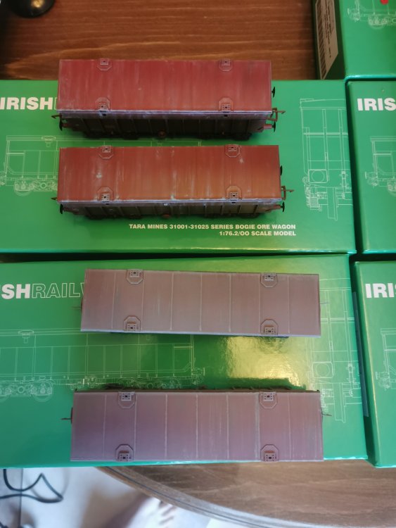

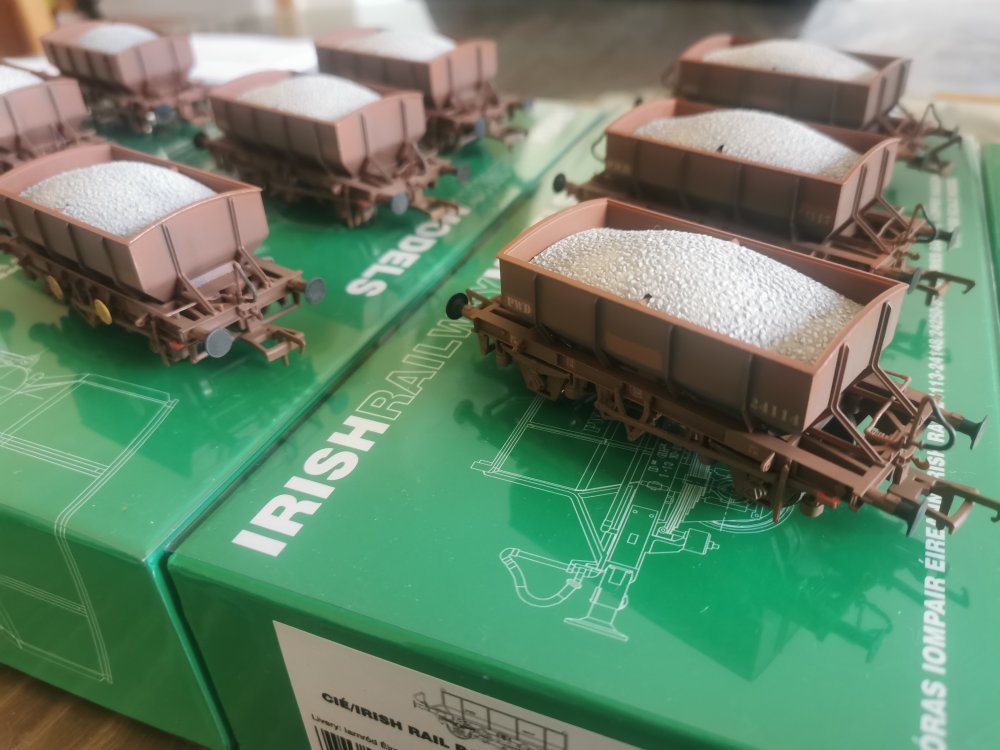

Dempsey Posted October 12, 2020 Share Posted October 12, 2020 First in line of my weathering projects has been my 10 Tara mines wagons from Irish Model Railways which I've spent the last few days working on and I'm extremely happy with the results. First layer of dry brushing. Second layer. Airbrushing of the lid and along the upper portion of the wagon Airbrushing of the lower portion of the wagons with frame dirt to finish it all off. All that remains is to apply grease marks to the buffers and varnish. Very happy with how they all turned out with a good varied look throughout the 10 wagons. Look forward to hearing your thoughts as always. 14 1 Quote Link to comment Share on other sites More sharing options...
Noel Posted October 12, 2020 Share Posted October 12, 2020 Excellent 1 Quote Link to comment Share on other sites More sharing options...
RedRich Posted October 12, 2020 Share Posted October 12, 2020 Excellent work. The best weathered models are always the ones where the modeller weathers what he sees on the prototype and not what he thinks it should look like. You have done the former. Rich, 4 1 Quote Link to comment Share on other sites More sharing options...
Dempsey Posted October 12, 2020 Author Share Posted October 12, 2020 Just now, RedRich said: Excellent work. The best weathered models are always the ones where the modeller weathers what he sees on the prototype and not what he thinks it should look like. You have done the former. Rich, Thanks Rich, Google images is a great resource and of course the people who go out and share the pictures they've taken. Quote Link to comment Share on other sites More sharing options...
Strimmers Posted October 12, 2020 Share Posted October 12, 2020 Pure dacent 1 Quote Link to comment Share on other sites More sharing options...
RedRich Posted October 12, 2020 Share Posted October 12, 2020 Flickr is fantastic for pics of rolling stock from all angles from the ground and from above covering most angles. The Tara's are arguably one of IRM's finest wagons. I love the prototype Rich, 1 Quote Link to comment Share on other sites More sharing options...
Dempsey Posted October 12, 2020 Author Share Posted October 12, 2020 I really like them myself. The only thing I've noticed is if you attach the vacuum pipes the couplers seem to hit off them when turning . I dont know if its to do with the tension locks they come fitted with or is it dependent on the radius curve you use or if a different type coupler would be better Quote Link to comment Share on other sites More sharing options...
flange lubricator Posted October 12, 2020 Share Posted October 12, 2020 Nice weathering job, not too much but enough . 1 Quote Link to comment Share on other sites More sharing options...
DJ Dangerous Posted October 12, 2020 Share Posted October 12, 2020 Absolutely fabulous! 1 Quote Link to comment Share on other sites More sharing options...
Dempsey Posted October 12, 2020 Author Share Posted October 12, 2020 Thanks everyone. Guinness liners next and I've 16 of them to do. 1 Quote Link to comment Share on other sites More sharing options...

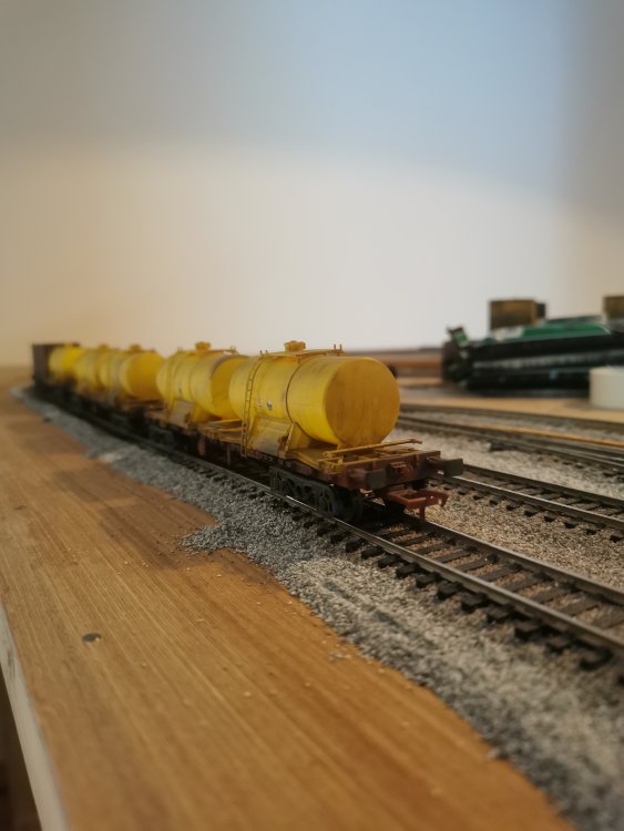

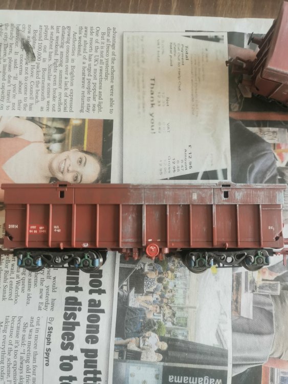

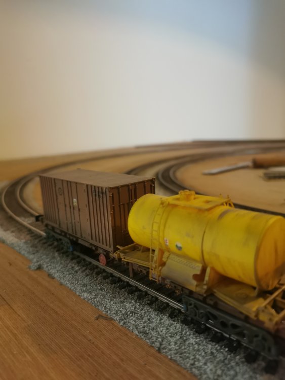

Dempsey Posted November 6, 2020 Author Share Posted November 6, 2020 Next on the weathering bench were my resently acquired weed spray wagons. Thought i had gone somewhat over board although accidentally however i did manage too find some images that show the real ones in a similar state. As always your thoughts and comments are appreciated. 13 Quote Link to comment Share on other sites More sharing options...
Strimmers Posted November 6, 2020 Share Posted November 6, 2020 top class work what method of weathering was this achieved with? 1 Quote Link to comment Share on other sites More sharing options...
Noel Posted November 6, 2020 Share Posted November 6, 2020 Really nice job. Transformative to the pristine dayglo yellow 1 Quote Link to comment Share on other sites More sharing options...
Dempsey Posted November 6, 2020 Author Share Posted November 6, 2020 37 minutes ago, Strimmers said: top class work what method of weathering was this achieved with? Just light dry brushing with small amounts and cooper and browns to give the effect of bleed through rust. Then watered down railmatch frame dirt with thinners and misted the model with a few coats. The over thinning allowed the paint to run and gives the streaking effect as if washed off with rain. 3 Quote Link to comment Share on other sites More sharing options...
popeye Posted November 6, 2020 Share Posted November 6, 2020 That looks great, nice job. 1 Quote Link to comment Share on other sites More sharing options...
Rob Posted November 6, 2020 Share Posted November 6, 2020 Absolutely fantastic- looks brilliant. 1 Quote Link to comment Share on other sites More sharing options...

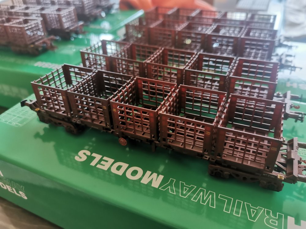

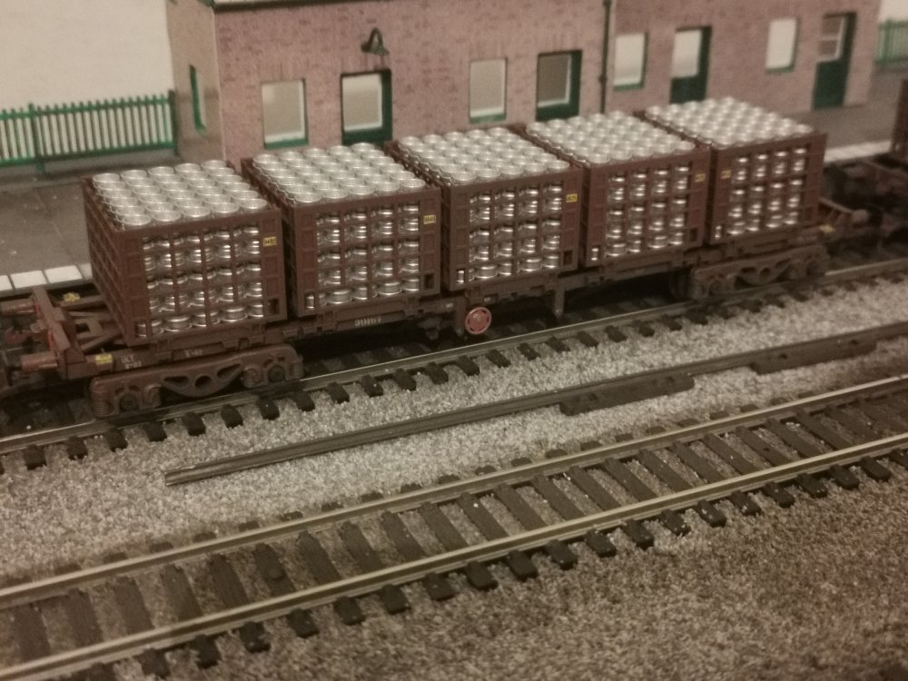

Dempsey Posted November 26, 2020 Author Share Posted November 26, 2020 Next on the weathering bench is the guinness wagons. Kept it simple by dulling down the paintwork on the cages, frame and bogies with a coat of frame dirt along the bottom to finish. Hope you enjoy. And since i have a new addition in a class 121 seemed fitting for it to take them for a spin VID_20201126_172317.mp4 VID_20201126_172317.mp4 VID_20201126_172317.mp4 9 1 Quote Link to comment Share on other sites More sharing options...

jhb171achill Posted November 28, 2020 Share Posted November 28, 2020 Many of those containers ended up looking almost like they'd been PAINTED brown instead of orange in the first place, due to the uncleaned brake dust patina all over them! The above looks very realistic indeed.... 1 Quote Link to comment Share on other sites More sharing options...

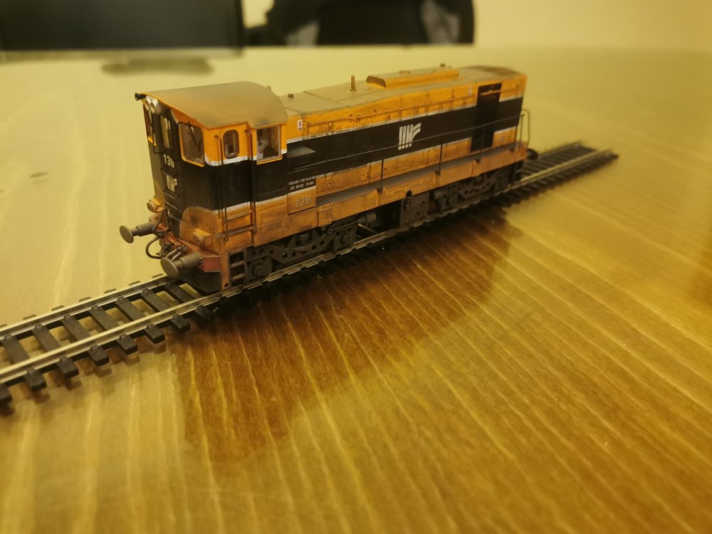

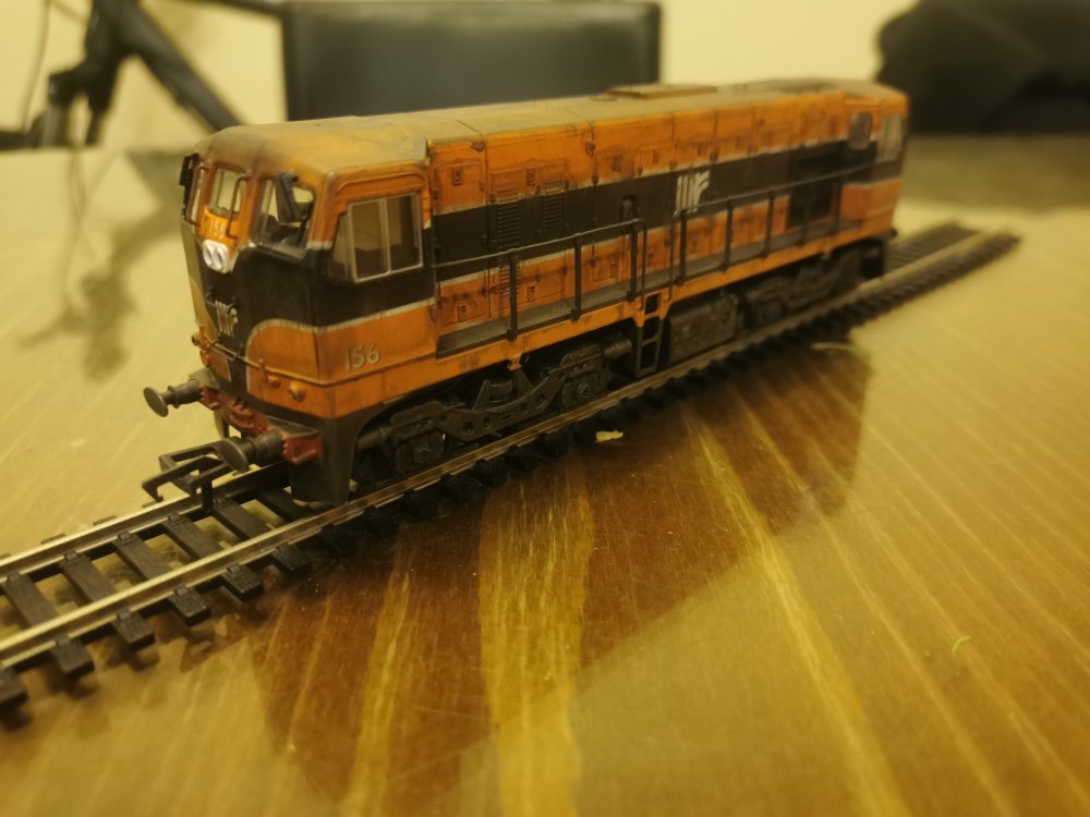

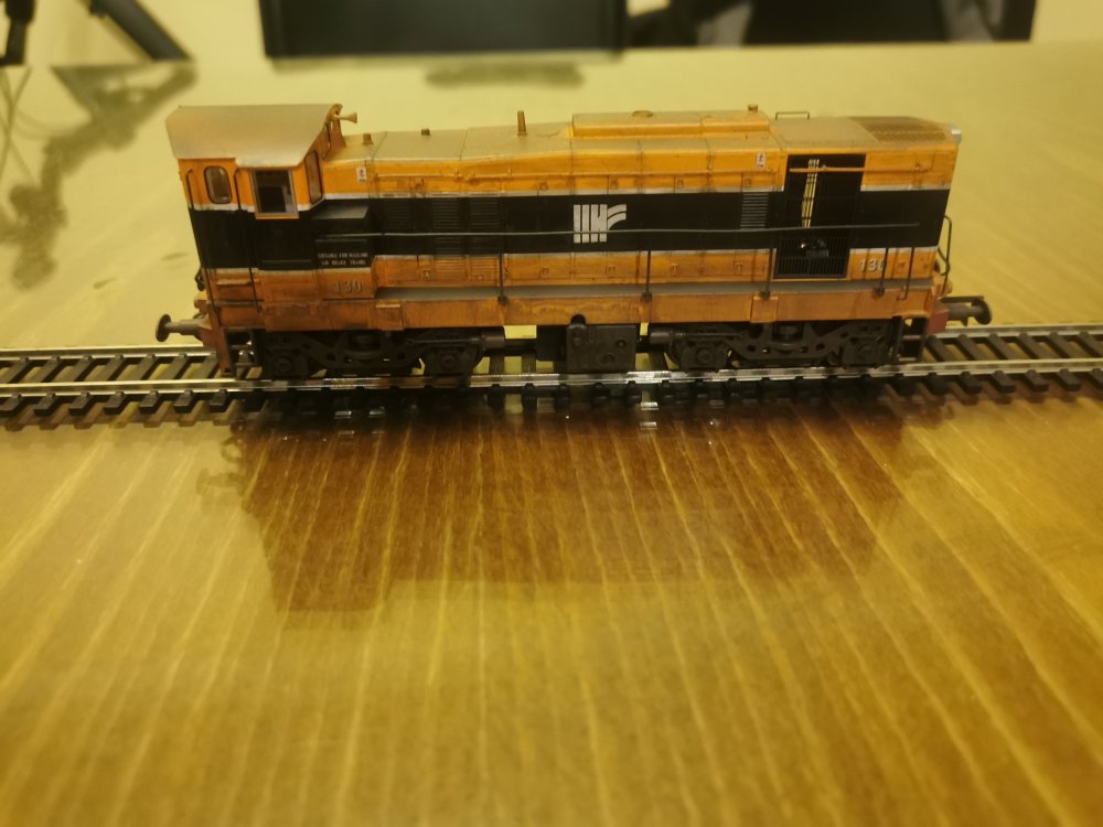

Dempsey Posted January 3, 2021 Author Share Posted January 3, 2021 Latest project saw no.156 receive the weathering treatment. 8 1 Quote Link to comment Share on other sites More sharing options...
Noel Posted January 3, 2021 Share Posted January 3, 2021 Very nice job. Pleasing result seems just right, not over cooked. 1 Quote Link to comment Share on other sites More sharing options...
Dempsey Posted January 3, 2021 Author Share Posted January 3, 2021 Cheers Noel. Bit of practice before the 121 gets the same treatment Quote Link to comment Share on other sites More sharing options...

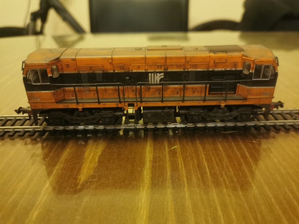

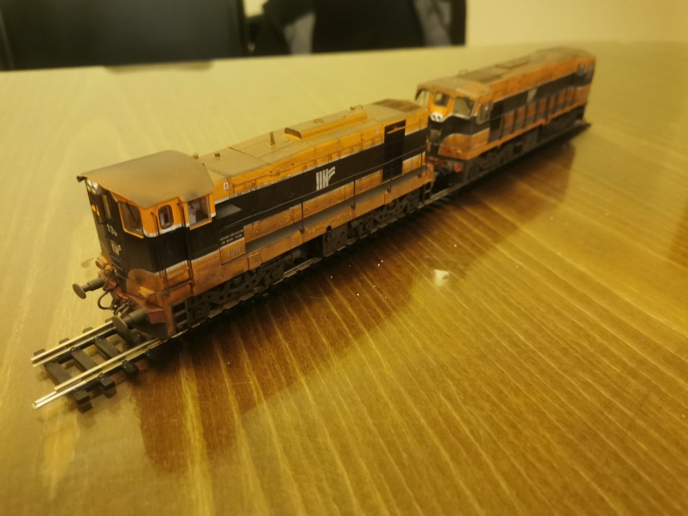

Dempsey Posted January 4, 2021 Author Share Posted January 4, 2021 No.130 given the same treatment as above as I intend to run both 156 and 130 together in the future. Thoughts and comments as always are appreciated. 6 2 Quote Link to comment Share on other sites More sharing options...
Noel Posted January 4, 2021 Share Posted January 4, 2021 Excellent job and superb result. The pair look great together. 1 Quote Link to comment Share on other sites More sharing options...
irishthump Posted January 4, 2021 Share Posted January 4, 2021 Very nice! They look like they’ve been coupled together for ages! 1 Quote Link to comment Share on other sites More sharing options...
Dempsey Posted January 4, 2021 Author Share Posted January 4, 2021 3 hours ago, Noel said: Excellent job and superb result. The pair look great together. Much appreciated thank you. I'm delighted with how they both turned out. 1 Quote Link to comment Share on other sites More sharing options...
Dempsey Posted January 4, 2021 Author Share Posted January 4, 2021 2 hours ago, irishthump said: Very nice! They look like they’ve been coupled together for ages! They'll be working together a lot 1 Quote Link to comment Share on other sites More sharing options...

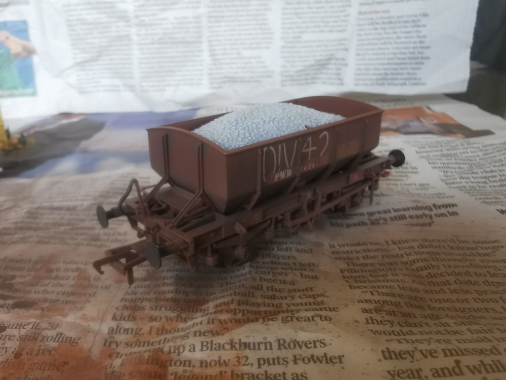

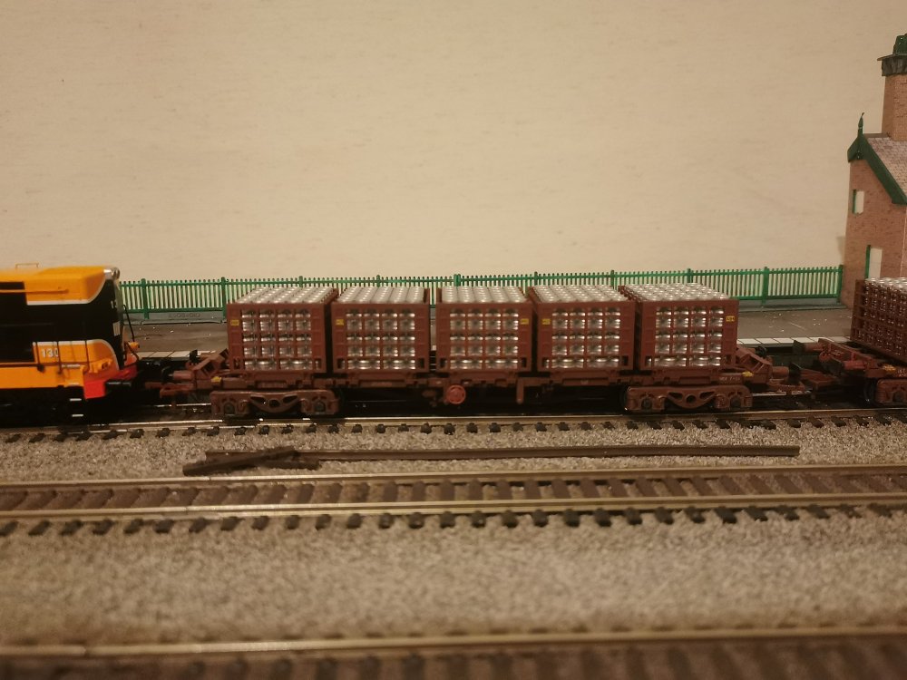

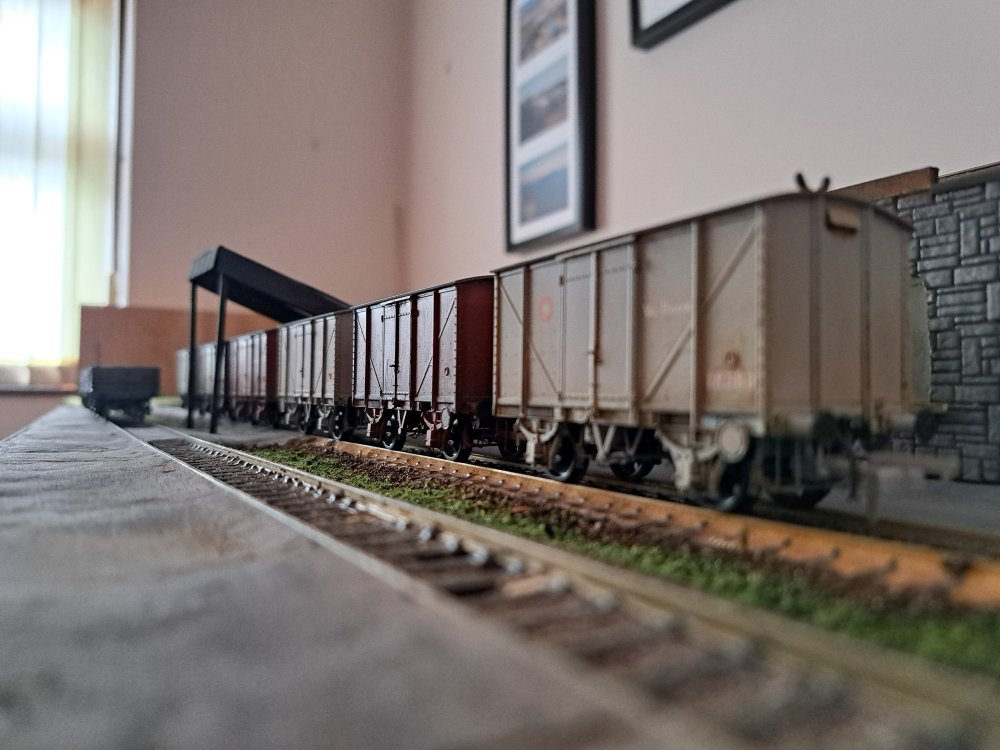

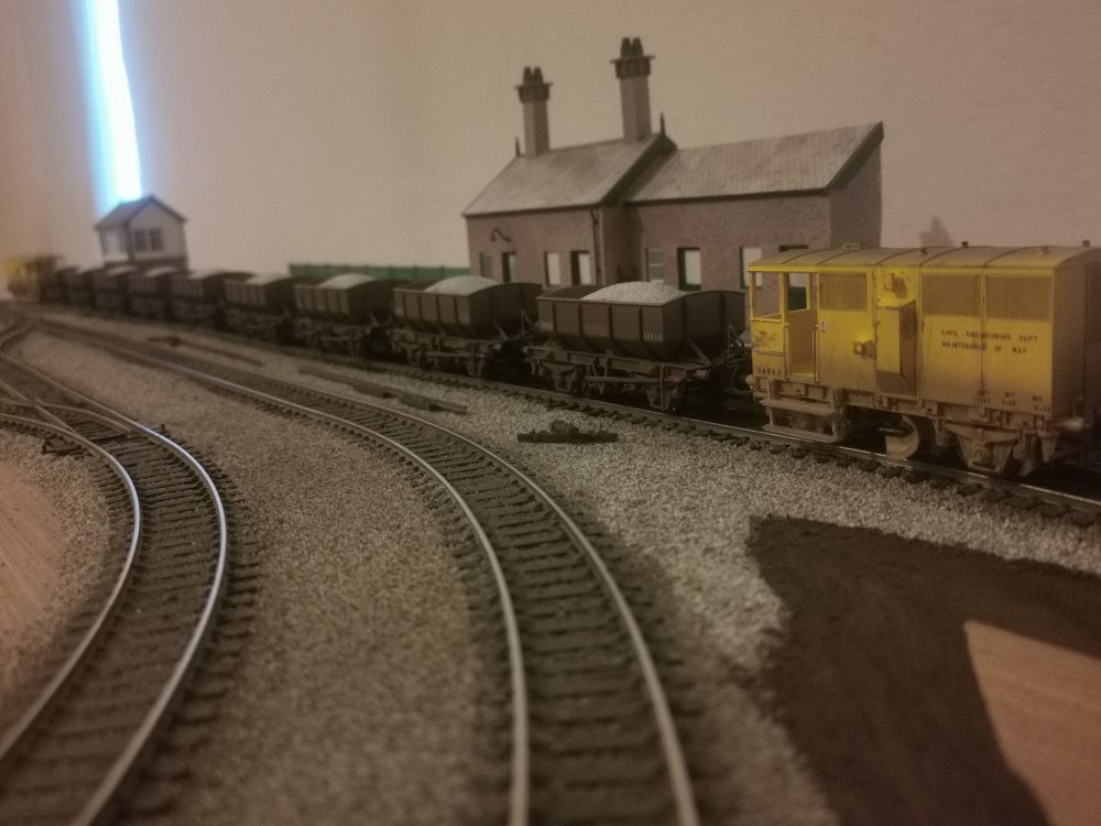

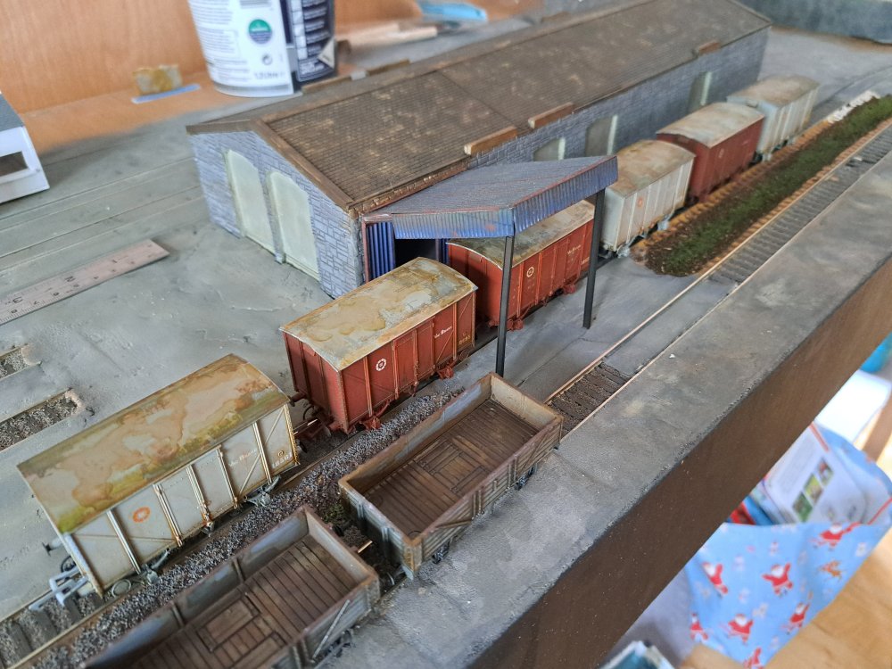

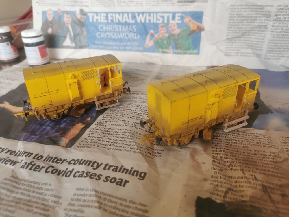

Dempsey Posted January 22, 2021 Author Share Posted January 22, 2021 Latest project the is the IRM ballest plough and wagons. Thoughts and comments as always are appreciated. VID_20210122_161501.mp4 8 1 Quote Link to comment Share on other sites More sharing options...
irishthump Posted January 22, 2021 Share Posted January 22, 2021 I'd try some light washes on the ballast wagons to vary the overall colour but that's just me. The plough vans are spot on though, they look fantastic. Overall, really nice work. 1 Quote Link to comment Share on other sites More sharing options...
Dempsey Posted January 22, 2021 Author Share Posted January 22, 2021 Unfortunately the camera wouldn't pick up the base layer work I had done on the wagons. I'm really happy with the end result. 1 Quote Link to comment Share on other sites More sharing options...
