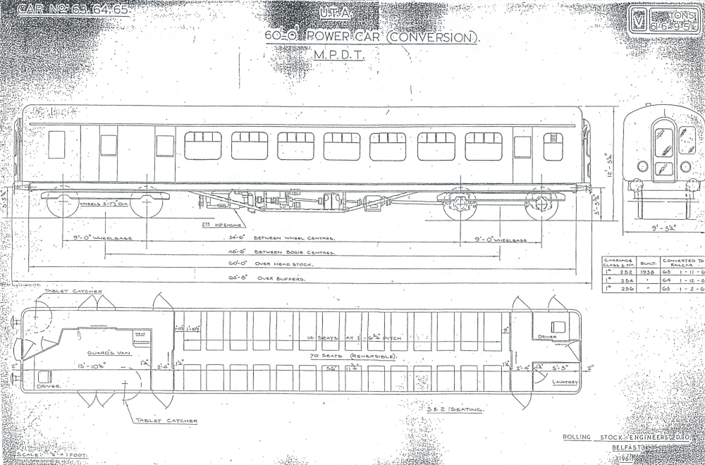

Lambeg man Posted November 21, 2022 Posted November 21, 2022 22 minutes ago, airfixfan said: 63 to 65 had standard MPD cab ends as above. Except that they were left hand drive as opposed to right hand drive (as seen above) in all the other MPD's. Quote
airfixfan Posted November 21, 2022 Posted November 21, 2022 Forgot the obvious as I used to see them nearly every day Quote
Lambeg man Posted November 21, 2022 Posted November 21, 2022 (edited) Also noteworthy is that the end on the right hand side of the drawing had only one cab window, while the Guard's Van end had the conventional double cab windows. Edited November 21, 2022 by Lambeg man 3 Quote
Darius43 Posted November 21, 2022 Author Posted November 21, 2022 1 hour ago, Lambeg man said: Also noteworthy is that the end on the right hand side of the drawing had only one cab window, while the Guard's Van end had the conventional double cab windows. That last photo is fantastic as it shows the bogies to be more like early BR DMU bogies rather than the LMS/NCC type bogies of the earlier MPDs. Thanks for posting it. Cheers Darius 1 1 Quote

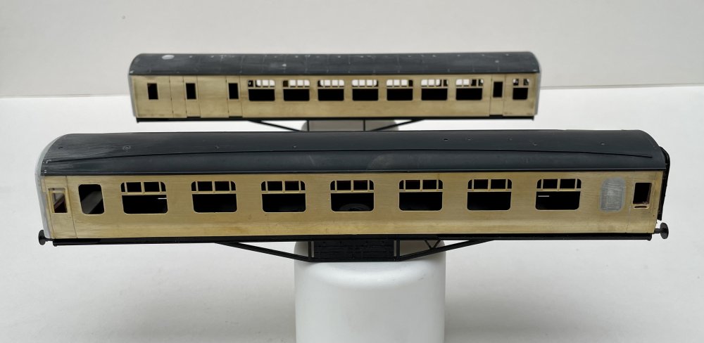

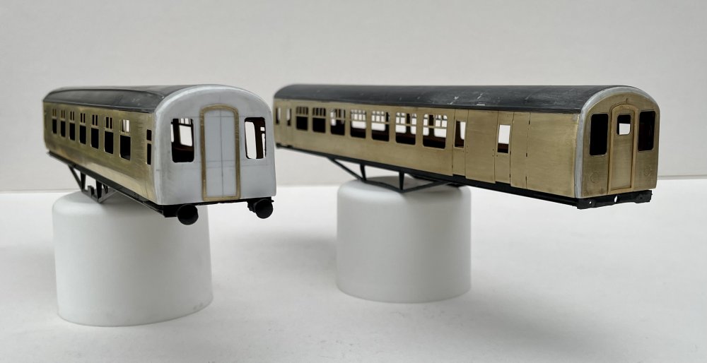

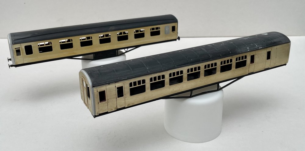

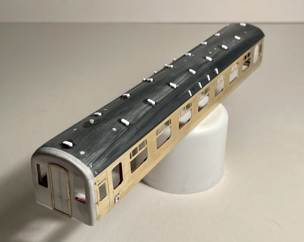

Darius43 Posted November 22, 2022 Author Posted November 22, 2022 Side panelling and roof details added. Cheers Darius 6 3 Quote

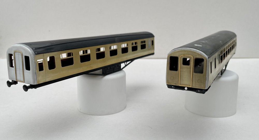

Darius43 Posted November 22, 2022 Author Posted November 22, 2022 Primer coat applied. Cheers Darius 11 2 Quote

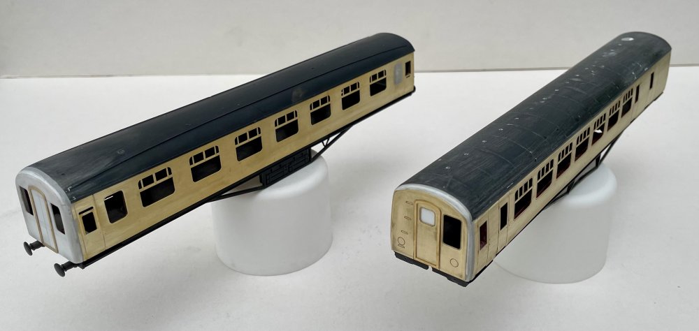

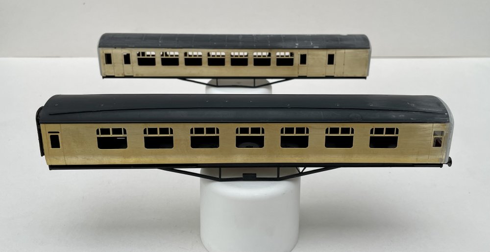

Darius43 Posted November 23, 2022 Author Posted November 23, 2022 Dapol coach chassis modified to accept a Hornby DMU motor bogie and trailing bogie. Test fit of coach body to chassis. I still have to fit the chassis undergibbons. Cheers Darius 3 5 Quote

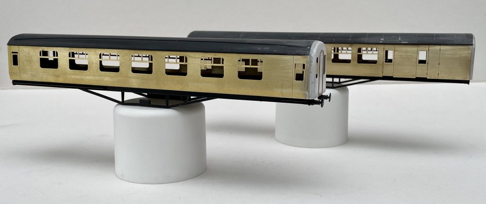

Darius43 Posted November 24, 2022 Author Posted November 24, 2022 Dunpaintin. I added undergibbon parts “hewn” from spare MTK white metal DMU undergibbon parts - suitably cleaned up before fixing. Cheers Darius 9 4 Quote

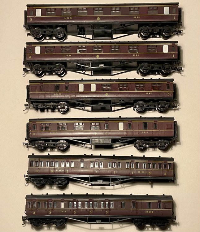

Darius43 Posted November 28, 2022 Author Posted November 28, 2022 (edited) Thanks to Galteemore, Larne Cabin, DB Joe and Noel for their kind words and encouragement- and to Lambeg Man for both that and the excellent photos. Some more MPD material has arrived courtesy of eBay… Cheers Darius Edited November 28, 2022 by Darius43 4 Quote

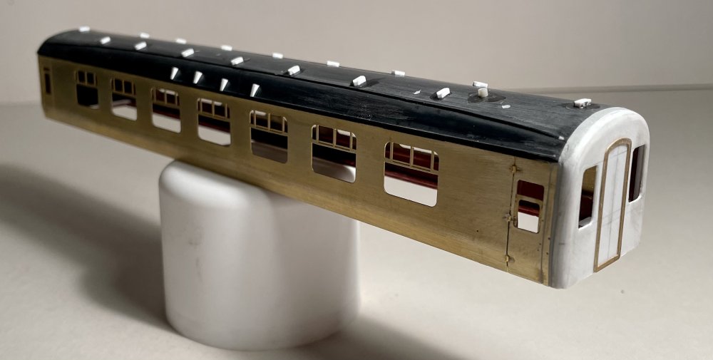

Darius43 Posted December 1, 2022 Author Posted December 1, 2022 Work started on MPD No.65. Cheers Darius 5 Quote
Robert Shrives Posted December 1, 2022 Posted December 1, 2022 Good to see ebay purchases came with Kaydees - a bargain move! I look forward to seeing this one fly through the works! Robert Quote
Darius43 Posted December 1, 2022 Author Posted December 1, 2022 Alas the previous owner glued the Kadees in… Cheers Darius Quote
Robert Shrives Posted December 1, 2022 Posted December 1, 2022 4 minutes ago, Darius43 said: Alas the previous owner glued the Kadees in… Cheers Darius Shame but possibly recoverable.. Have to say with No5 coupler boxes I fix a screw in the hole and then lightly glue box to stop any wayward rotation. Robert 1 1 Quote

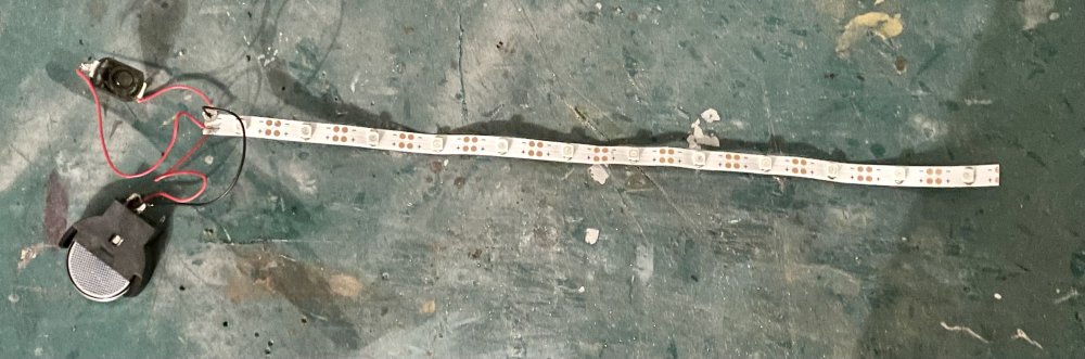

Darius43 Posted December 2, 2022 Author Posted December 2, 2022 On the plus side, two of the coaches were fitted with battery powered LED lighting strips with mini push button operation. These have been salvaged. Cheers Darius 1 Quote

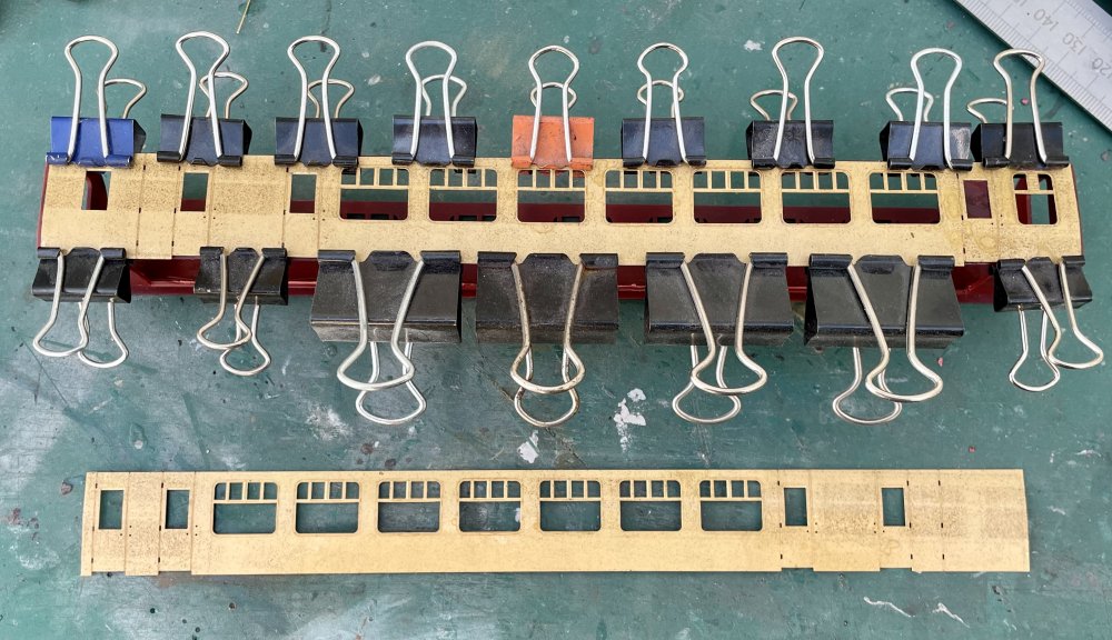

David Holman Posted December 2, 2022 Posted December 2, 2022 Now we know why there is a sudden world shortage of bulldog clips. 5 1 Quote

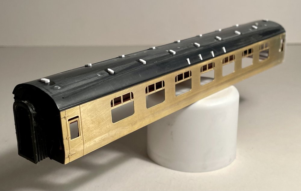

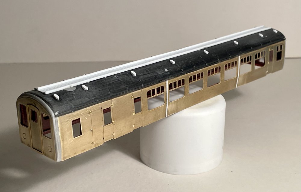

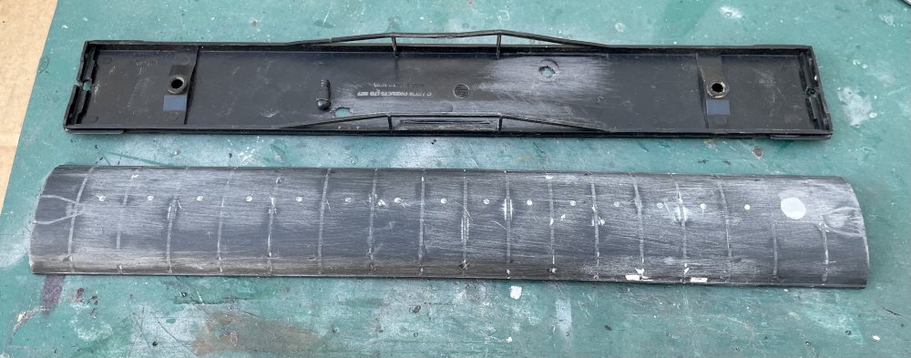

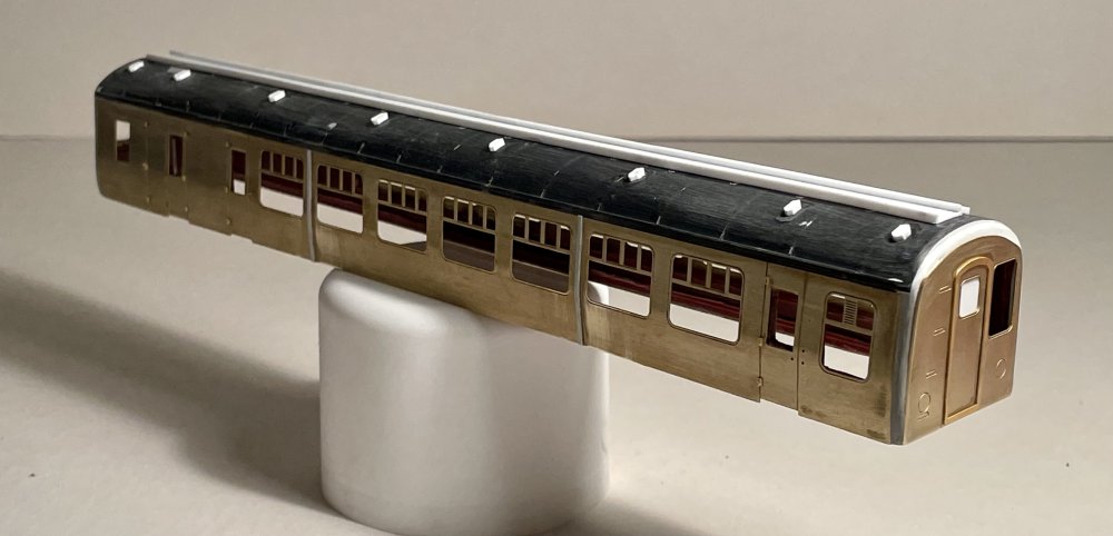

Darius43 Posted December 4, 2022 Author Posted December 4, 2022 Some more progress. Cheers Darius 3 3 Quote
Robert Shrives Posted December 4, 2022 Posted December 4, 2022 Great progress. Good to see coaches being used so quickly. Liking the plasticard end . Loads of hinges to add next! Robert 1 Quote
Darius43 Posted December 4, 2022 Author Posted December 4, 2022 Roof vents etc. added. Cheers Darius 3 1 1 Quote
