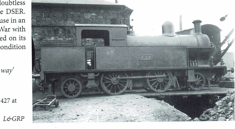

The six "Mansion House" tanks did not last for too long in their original condition on the DSER. Five were requisitioned for Industrial use and returned to Great Britain during WW1. the sixth was #64 later GSR 427 was rebuilt by the DSER with a new boiler, cylinders and cab that it looked more like a South Eastern than an ex-LNWR Loco
DUBLIN, WICKLOW & WEXFORD RAILWAY - 60 EARL OF COURTOWN - Webb LNWR 2-4-2T, built 1883 by Crewe Works, LNWR No.2502 - one of 6 similar engines purchased 1902 - sold 1917 to Inland Waterways & Docks Co. - 1919 scrapped.
Curiously in my mind the WLWR pair of 2-4-2Ts that passed to the GSWR and later GSR resemble the LNWR 5'6" '2-4-2T Radial Tanks also produced by London Road Models and once available as a GEM Whitemetal kit,
Class F5 - 491 - Cork and Macroom Direct Railway 2-4-2T - built 1891 by Vulcan Foundry, Works No.1315. as WLWR No.13 DERRY CASTLE - 1901 to GSWR as No.266 - 1914 sold to CMDR as No.6 - 1925 to GSR as Class F5 No.491 - 1934 withdrawn. Class F 4 - 267 - 2-4-2T, built 1891 by Vulcan Foundry & Co., Works No.1316, as Waterford, Limerick & Western Railway No.14 LOUGH DERG - 1901 to GS&WR as No.267, 1925 to GSR - withdrawn 1935 - seen here at Inchicore Works in 1938.
Main downside is that the ex-LNWR and WLWR 2-4-2T had a quite short life by Irish standards withdrawn by the late 1930s

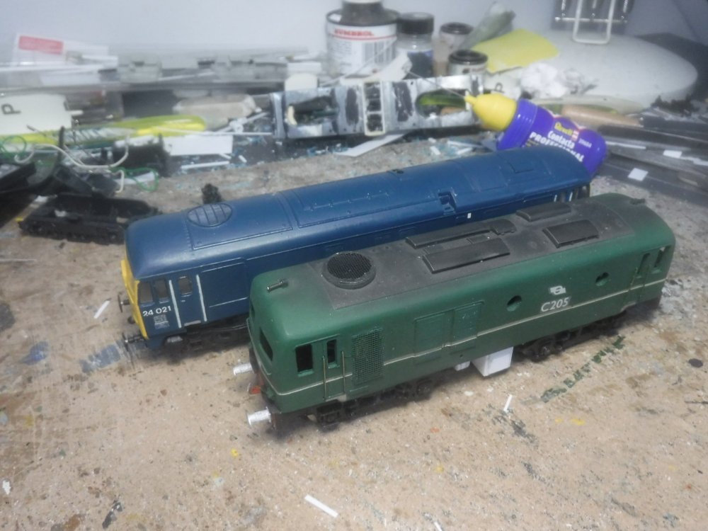

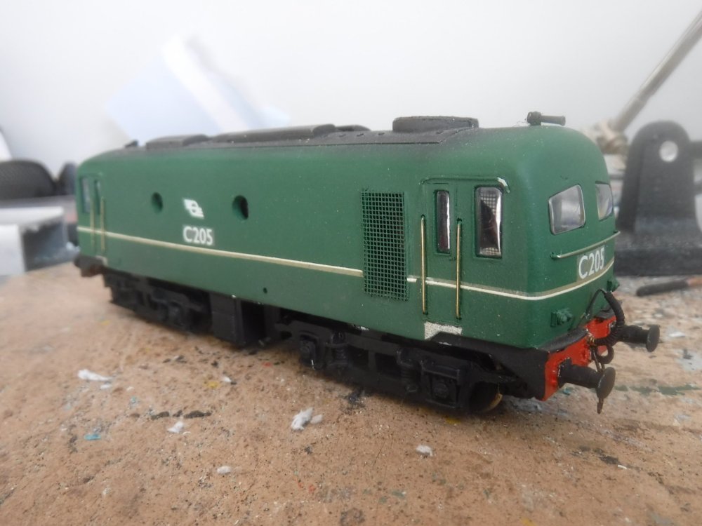

Hi Mike,
I built one of those a couple of years ago for my mate in Sligo and used a Hornby class 29 chassis with slightly modified bogies.
Scrubs up reasonably !
Next to one of my Hornby class 24 conversions as a size comparison.

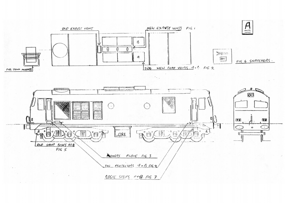

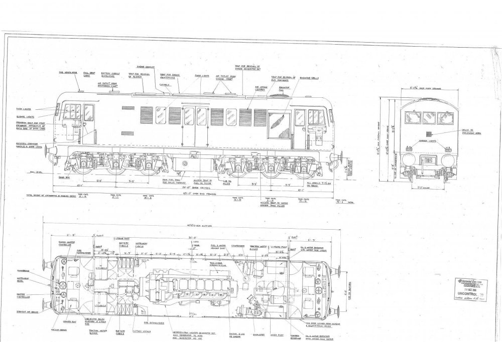

I do like @LNERW1 idea of using a Lima class 33 body as a basis for a body of an A or C class although the bogies are all wrong. The C class could be cut and shut using Hornby class 29 bogies and the off cut from the body might do to space out for a C class using class 31 bogies. The B class might also be made form a lima class 33 body and class 31 bogies.
Scratch building and cutting and shutting really aren't all that difficult especially when using an existing body as a conversion.
Get busy lads;

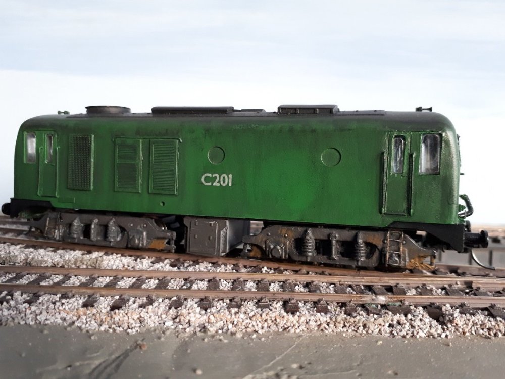

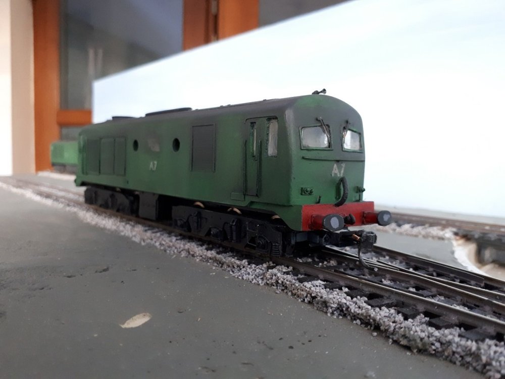

Here's a couple of pictures of my three diesels.  The B101 has moved more than the photo shows, its now got windows and is transfered up and just need window wipers and a good dose of oil, muck etc; over its body! Cutting the windows from plastic Ferro Rocher boxes was very tedious! But is better than the vac-formed windows of the Silverfox kits. The Sulzer kit is from that man Weshty!
All run on Hornby motor bogies and chassis but no old pancake motors!

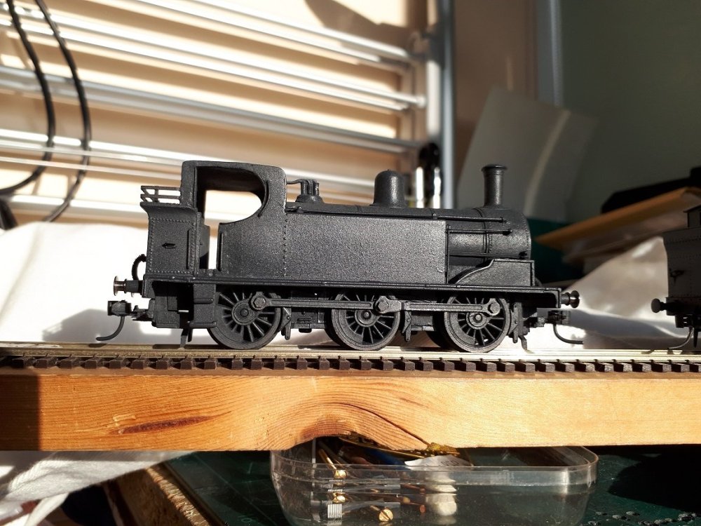

I have posted all these years ago!! but here's a couple more. The van is a tarted up Parkside PalVan  and the last one is one that didnt make the transition  and got filed in the parts bin!

I like the 201 Class 0-6-0T (converted from a Hornby J83?)  basically tank engine version of the J15 appear to have been mainly used for shunting in Dublin and Cork and passenger and goods trains on the West Cork.
A 201 apparently converted from a Tri-ang Jinty appeared in series of articles on building corrugated iron buildings from card in the Railway Modeller in the early 1970s. The shape of the cab roof was the give away!

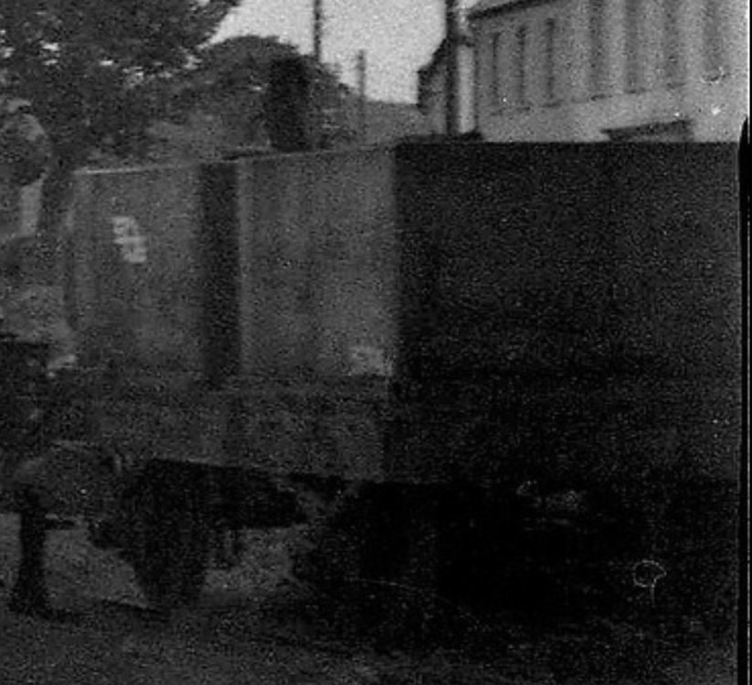

I know the answer is probably “no” (because nothing could be that easy) but were rectangular tank wagons ever used in Ireland in the days of steam?

Something like this was used as a “portable water tank” there was one down in courtmac during the beet season.
Biggest problem is….there was two seperate square tanks as a pose to one large one

John, spot on with the 201 from the Hornby J 83? its the ex NBR model. Daft as it sounds the inspiration was the chimney I thought it looked very GSR'ish and I worked back from there! The cab roof was quite difficult to form with no wrinkles in it.

They used trains of old loco tenders to take water out to places where the local supplies weren't kind to boilers. Mend and make do.

The Midland Great Western had a two rectaangular tank wagons 1108 & 1967 used for cresote traffic between the North Wall and Liffey Junctionsleeper depot and cresoting plant. The Midland bought a pair of RCH pattern tanks (5'8" diameter) for cresote traffic from Charles Roberts in 1915. Its possible both types may have lingered on in service into CIE days. (Notes MGWR Wagon Stock P O'Cuimin  IRRS Journal 1969?)
Haven't seen a photo of either type of wagon, its possible that the other large companies may have used similar wagons to transport cresote from the ports to their cresote plants.
