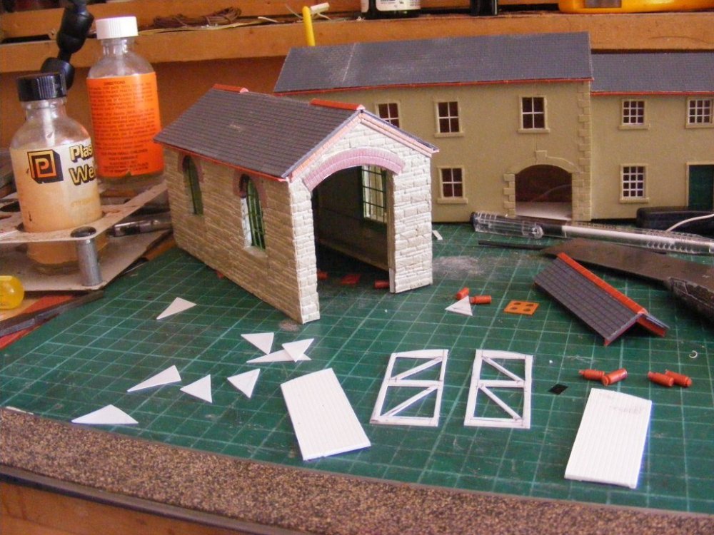

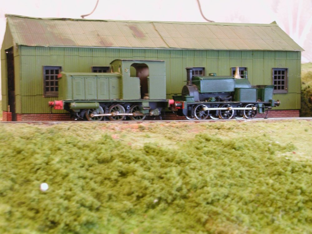

I usually scratchbuild buildings from photos or drawings using plasticard or the Will's Scenic Material's packs. The low-relief buildings on Keadue were scratchbuilt in .040" plasticard with Wills windpows and doors, and are based on photos of buildings in towns and villages in County Roscommon.
Stone buildings are mainly Wills Coursed stone with details like quoins, lintols and door jambs recessed into the stonework, corrugated iron Wills corrugated iron or asbestos, with Wills translucent roof sheets or Ambis corrugated iron where a thin edge is needed like roofing iron.
1257678099_mypicturesbackupfile2004041.thumb.jpg.68252fd5e54726c07665d5bfd2e6b1d0.jpg
