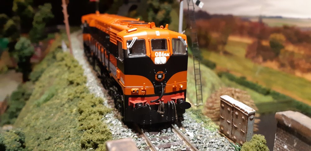

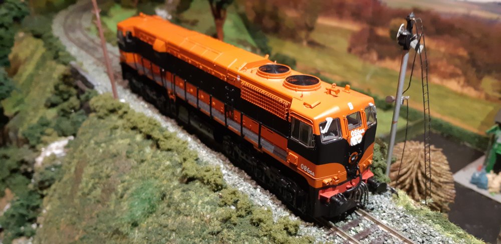

enniscorthyman Posted November 25, 2018 Author Posted November 25, 2018 Just finished a rebody of 078 to 086sa. 5 Quote
Noel Posted November 25, 2018 Posted November 25, 2018 Hi Eamon did you swap the body with one of @WRENNEIRE's spares? Â Quote
JasonB Posted November 25, 2018 Posted November 25, 2018 1 hour ago, enniscorthyman said: Just finished a rebody of 078 to 086sa. I've a couple of these to do myself. Seems straight forward enough. Did you have any hassle swapping them over Eamonn?  1 Quote
enniscorthyman Posted November 25, 2018 Author Posted November 25, 2018 3 hours ago, Noel said: Hi Eamon did you swap the body with one of @WRENNEIRE's spares? Â I did indeed,Noel.I got 161sa body as well to change over onto 156. 1 Quote
jhb171achill Posted November 25, 2018 Posted November 25, 2018 I was thinking of renumbering the 141s I have, to my "personal favourites" B145, B150 and B155. All too often, numerals available are the wrong font, size, or both. Some are BR arial style, fer gawds sake. Does anyone have any ideas as to accurate-appearance numerals for a black'n'tan 141? (OR A, C, B101, B121 etc....)? Quote
enniscorthyman Posted November 25, 2018 Author Posted November 25, 2018 (edited) 8 hours ago, jason brady said: I've a couple of these to do myself. Seems straight forward enough. Did you have any hassle swapping them over Eamonn?  Be very very carefully with the marker lights.I broke  two of the clear tubes that fit into the holes behind the marker lights,and they are very fragile.The black tape around the lighting pcb has to block out any light bleed.When changing the cabs,you can undo the roof mounted pcb for the cab lighting and fit into new cab. Edited November 25, 2018 by enniscorthyman Quote
JasonB Posted November 25, 2018 Posted November 25, 2018 1 hour ago, enniscorthyman said: Be very very carefully with the marker lights.I broke  two of the clear tubes that fit into the holes behind the marker lights,and they are very fragile.The black tape around the lighting pcb has to block out any light bleed.When changing the cabs,you can undo the roof mounted pcb for the cab lighting and fit into new cab. Cheers Eamonn. Quote

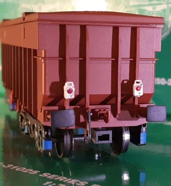

enniscorthyman Posted July 21, 2019 Author Posted July 21, 2019 I stuck on two rear lamps on one IRM Tara.I think they look nice. 13 Quote
JasonB Posted July 21, 2019 Posted July 21, 2019 Always a nice little addition to the last wagon or coach in a rake, and a must in my opinion. Sometimes the smallest of detail makes all the difference. Coupler removed aswell I noticed   2 Quote

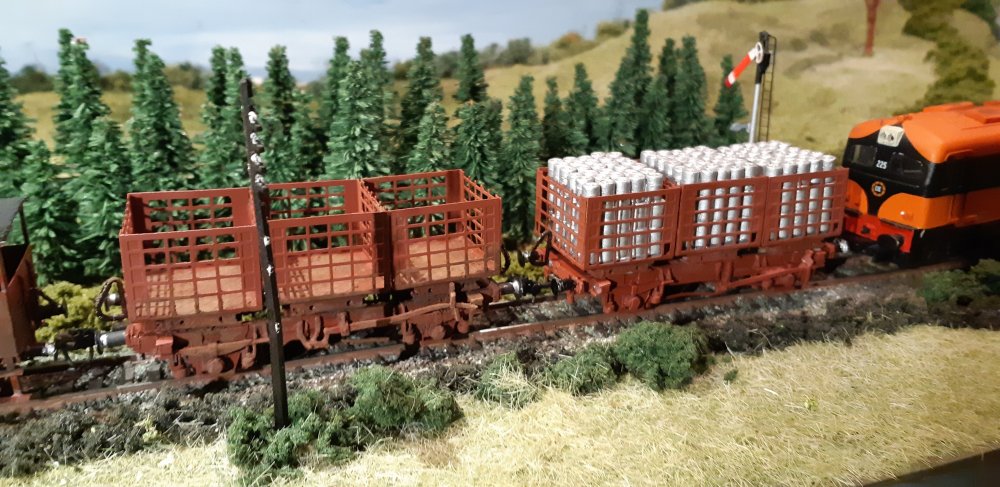

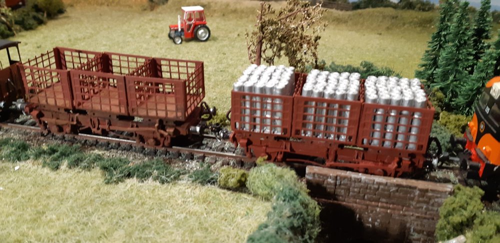

enniscorthyman Posted September 1, 2019 Author Posted September 1, 2019 Just finished work on two MIR beer wagons which are running well now.The chassis on one was a bit out of alignment, which I suppose is to be expected on a white metal kit. 15 Quote
RedRich Posted September 1, 2019 Posted September 1, 2019 They look very nice Eamonn and well made. One of MIR's better kits. Rich. 1 Quote

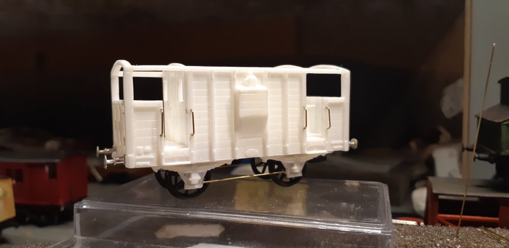

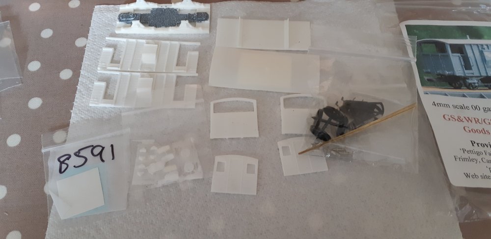

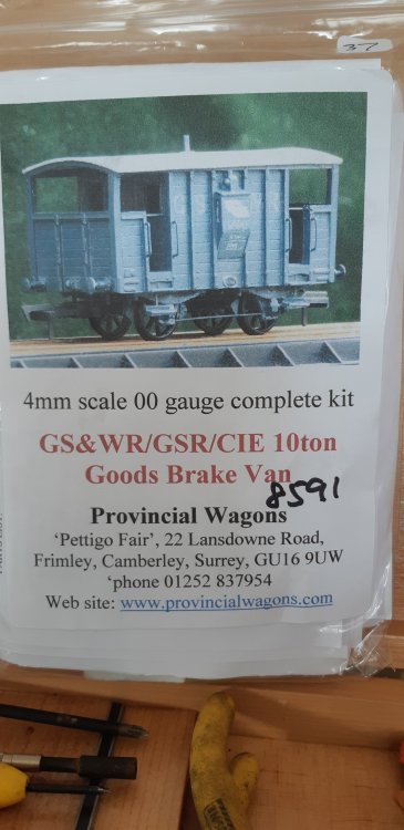

enniscorthyman Posted October 29, 2019 Author Posted October 29, 2019 I purchased one of Leslie's nice Brake Van's at BlackRrock,so just getting ready for the build. 6 Quote

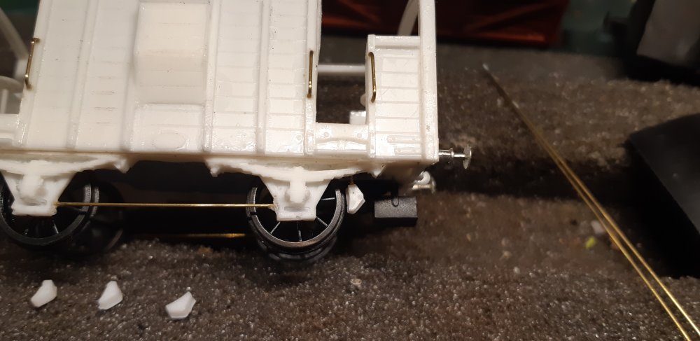

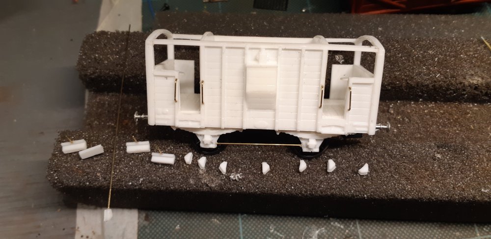

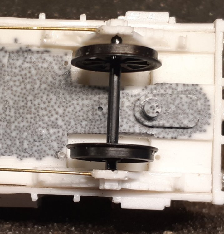

enniscorthyman Posted October 31, 2019 Author Posted October 31, 2019 More work on the Brake van. The most tricky part I found was the brake blocks,but thankfully some pre drilled holes certainly helps. 10 Quote
leslie10646 Posted October 31, 2019 Posted October 31, 2019 (edited) Coming along very nicely, Eamonn, the effort will be well worth the result - a delightfully antique and long-lived brake van! Thanks for sharing the "work in progress". Plenty more, where they came from for those of you who haven't got one yet! Edited October 31, 2019 by leslie10646 1 Quote
jhb171achill Posted October 31, 2019 Posted October 31, 2019 An excellent van. These things are just as appropriate to modelling the early years of the 20th century - an era not often covered - right through GSR days and on through CIE times. The last such beasts were still to be seen into the early 1960s and one or two even managed to make it into the black'n'tan era. They can be used alongside the more modern standard CIE vans. Until closure in 1961, West Cork had some truly venerable vans of various types. Quote
David Holman Posted October 31, 2019 Posted October 31, 2019 Hate brake blocks! The van is coming on nicely though. 1 Quote

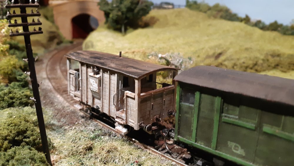

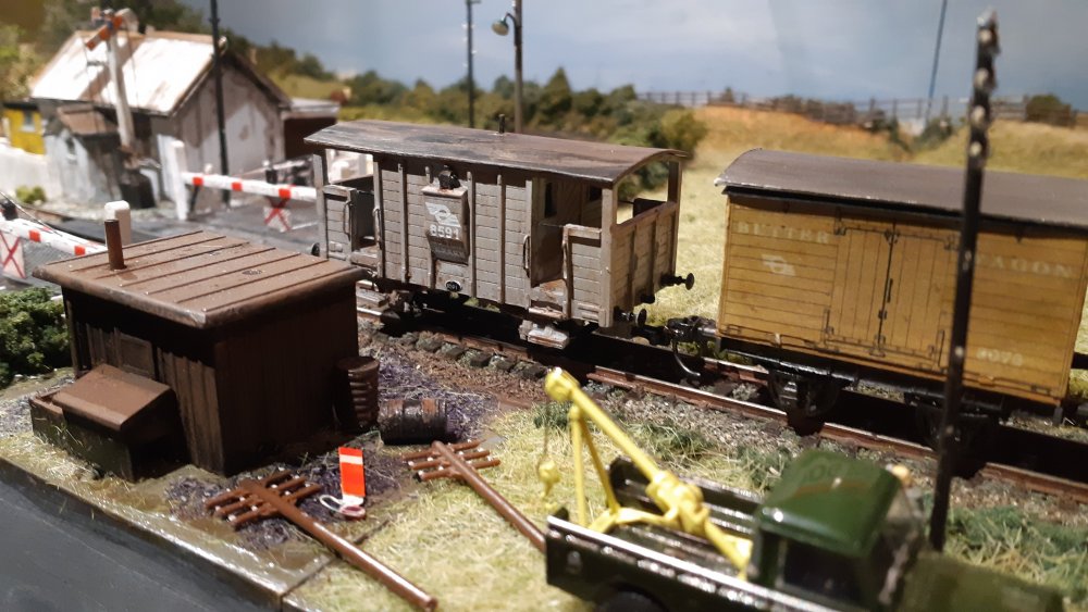

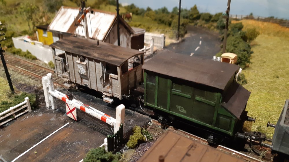

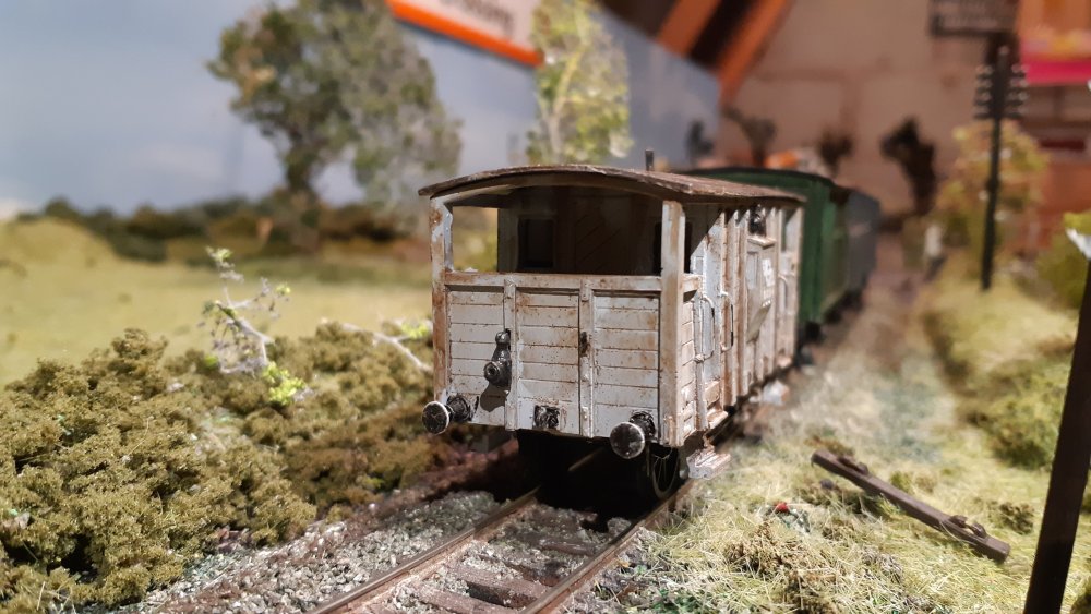

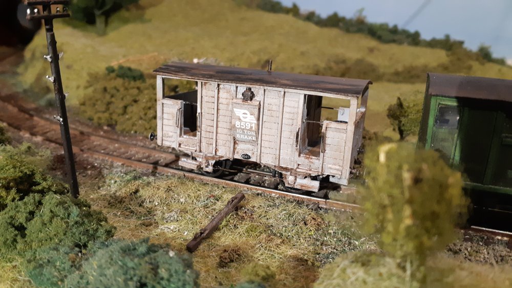

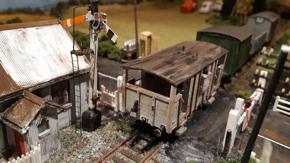

enniscorthyman Posted November 6, 2019 Author Posted November 6, 2019 Just the Provincial Wagons Brake van. 12 1 Quote
leslie10646 Posted November 6, 2019 Posted November 6, 2019 Oh Eamonn, you've made my lovely brake van dirty - almost as dirty as they seemed to get latterly! I have one photo where the blessed thing was BENT at one point - must look for it! Terrific. God bless Andy C who first made me think of that particular van. Thanks for posting it - a work of art! 1 Quote
David Holman Posted November 6, 2019 Posted November 6, 2019 The horsebox is rather nice too. 1 Quote

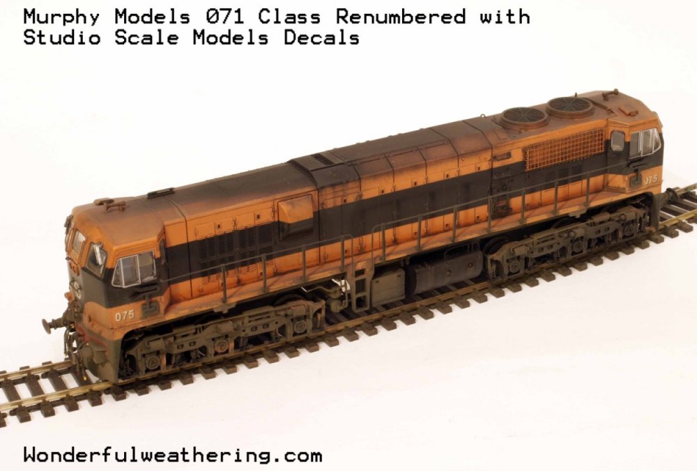

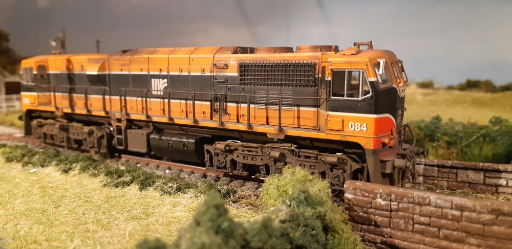

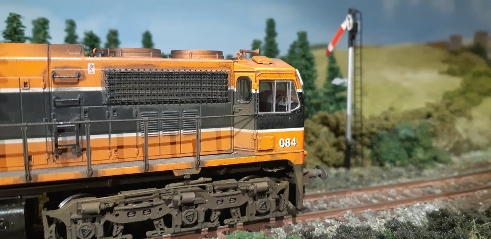

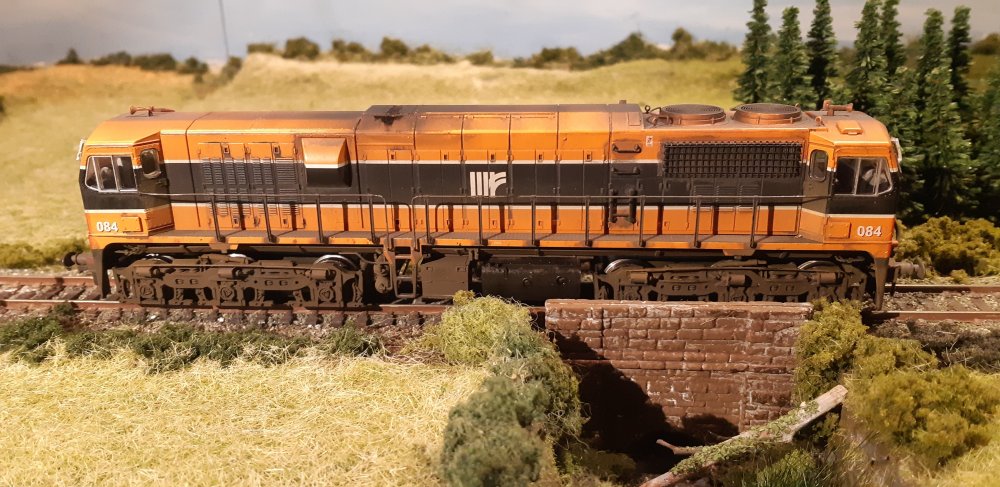

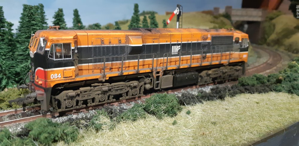

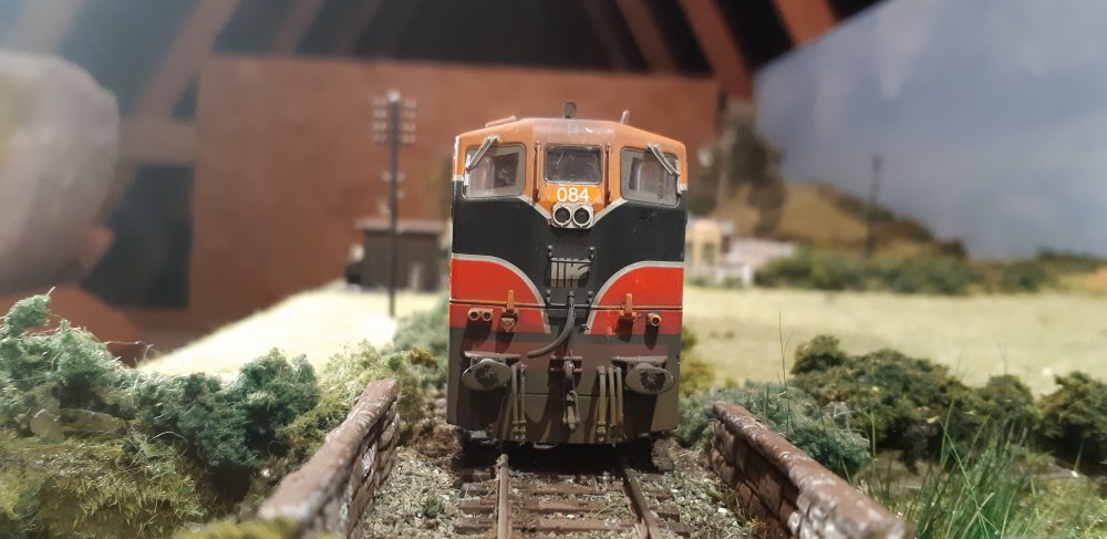

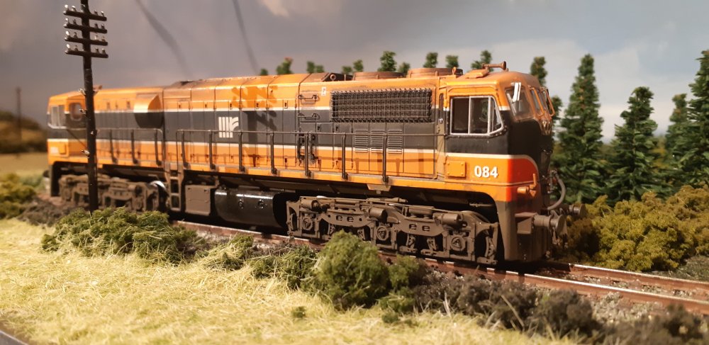

enniscorthyman Posted March 9, 2020 Author Posted March 9, 2020 Some repair work on 084,which I renumbered from 075.A broken lamp iron was replaced,and some of the handrails supports were glued back into place.I think she is looking well now. The weathering was done by George Norman. 6 2 Quote
StevieB Posted March 10, 2020 Posted March 10, 2020 Whose numbers did you use for the re-numbering exercise? I have a number of 141/181’s awaiting to go through this exercise. Stephen Quote
Georgeconna Posted March 10, 2020 Posted March 10, 2020 Hi StevieB http://www.studio-scale-models.com/TLocos.shtml Railtec also do them. https://www.railtec-models.com/showitem.php?id=1147 Â 1 Quote
Noel Posted March 10, 2020 Posted March 10, 2020 14 hours ago, enniscorthyman said: Some repair work on 084,which I renumbered from 075.A broken lamp iron was replaced,and some of the handrails supports were glued back into place.I think she is looking well now. The weathering was done by George Norman. Superb job. Really tastefully done. Love the detail of the weathering (eg base of stanchions) and that it is not over cooked. Class job Quote

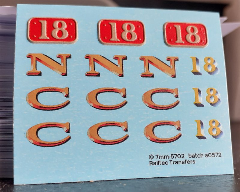

railtec-transfers Posted March 10, 2020 Posted March 10, 2020 (edited) 1 hour ago, Georgeconna said: Railtec also do them. https://www.railtec-models.com/showitem.php?id=1147 Â Â The full range of Irish decals is gradually becoming available again, taking advantage of the later spot printed technology which means that there's no superfluous carrier film to cut out. More info on this here: https://www.railtec-models.com/railtec-benefits.php The 3d tech has also been leveraged to reproduce some of the NCC plates with very pleasing results. The "18" plates are 3d, just for clarity. The plates themselves are raised from the backing, with the border, mounting bolts and "18" text additionally raised, like the real things. (A shout out must go to Tony Mirolo for going above and beyond in helping with the NCC detail). There will also shortly be released a "201 loco number of your choice with matching 3d plates". Steve Railtec Transfers - See what sets Railtec apart! http://www.railtec-transfers.com/railtec-benefits.php Web: http://www.railtec-transfers.com/ Facebook: http://www.facebook.com/RailtecTransfers Instagram: https://www.instagram.com/railtectransfers/ Railtec are the only transfer supplier trusted and used by Pete Waterman OBE, and our products are used by thousands more including Bachmann Europe, Direct Rail Services, GBRf, Little Loco Company, the N Gauge Society, Silver Fox Models and Peco. Come and see us! We will be at: - MMRG, Derby Roundhouse, UK :: 09-10 May 2020 - Warley, Hall 5, Birmingham NEC, UK :: 28-29 Nov 2020 Â Â Â Â Edited March 10, 2020 by railtec-transfers 5 Quote
enniscorthyman Posted March 10, 2020 Author Posted March 10, 2020 7 hours ago, StevieB said: Whose numbers did you use for the re-numbering exercise? I have a number of 141/181’s awaiting to go through this exercise. Stephen Stephen,I used Studio Scale Models decals.George had renumbered 080 to 075 for me,but I thought I would have a go at a new number. Quote

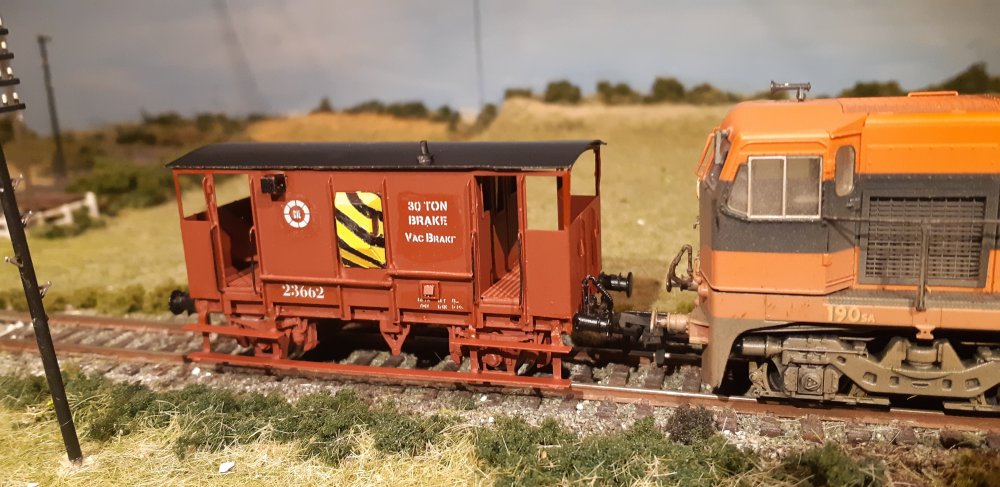

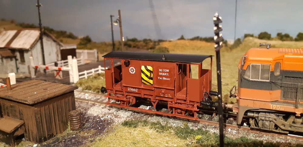

enniscorthyman Posted April 19, 2020 Author Posted April 19, 2020 Just finished a SSM 30 ton brake van.I gave her a test run behind 190 and all is well.Some minor work to do as the roof is sticking up in one place. 20200419_162628.mp4 5 Quote
Midland Man Posted April 19, 2020 Posted April 19, 2020 On November 6, 2019 at 4:09 PM, enniscorthyman said: Just the Provincial Wagons Brake van. First of all class work on the new post and second how did you build the horse van? 2 Quote
enniscorthyman Posted April 20, 2020 Author Posted April 20, 2020 Hi Midland Man,the horse van was built by a friend who gave it to me. As far as I know it's a alphagraphix kit on a Parkside Dundas chassis. 1 Quote
Noel Posted April 21, 2020 Posted April 21, 2020 Gorgeous. Those two brake vans are delicious in every way, build, decor, weathering, they reek of atmosphere. 1 Quote

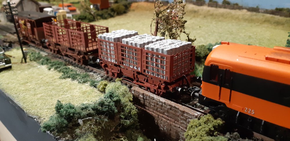

enniscorthyman Posted Sunday at 20:41 Author Posted Sunday at 20:41 I was just looking at my workbench here and noticed i haven't posted anything in a long time.Anyway today I renumbered C class 225 to 209 using Railtech decals. 10 Quote
