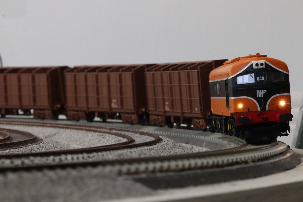

GM171kk's layout.

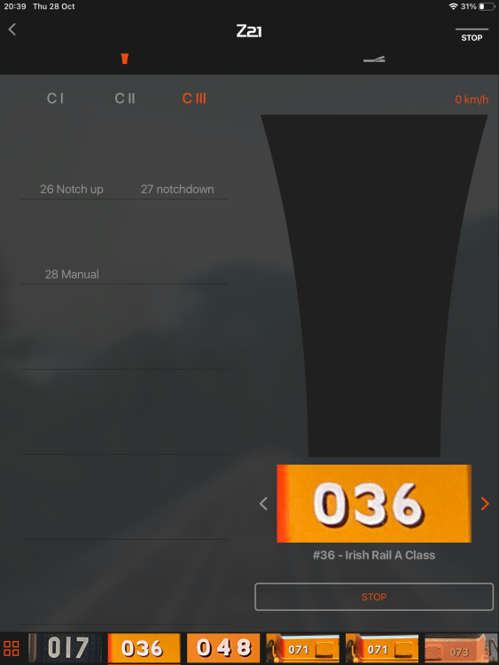

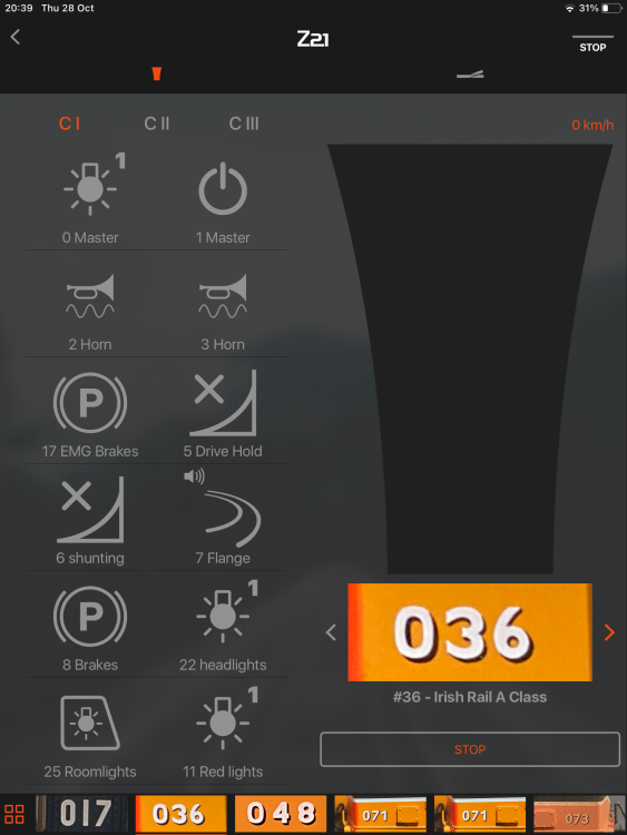

6 hours ago, BosKonay said:
If it helps, this is the function list on the A Class LokPilot chips.
For me it's:
F0 Directional white marker lights
F1 Red marker lights (fan end)
F2 Red marker lights (other end)
F3 Shunt mode
F4 Nothing
F5 Nothing
F6 Nothing
F7 Both cab lights
F8 Shunt lights (fan end)
F9 Shunt lights (other end)
Link to comment

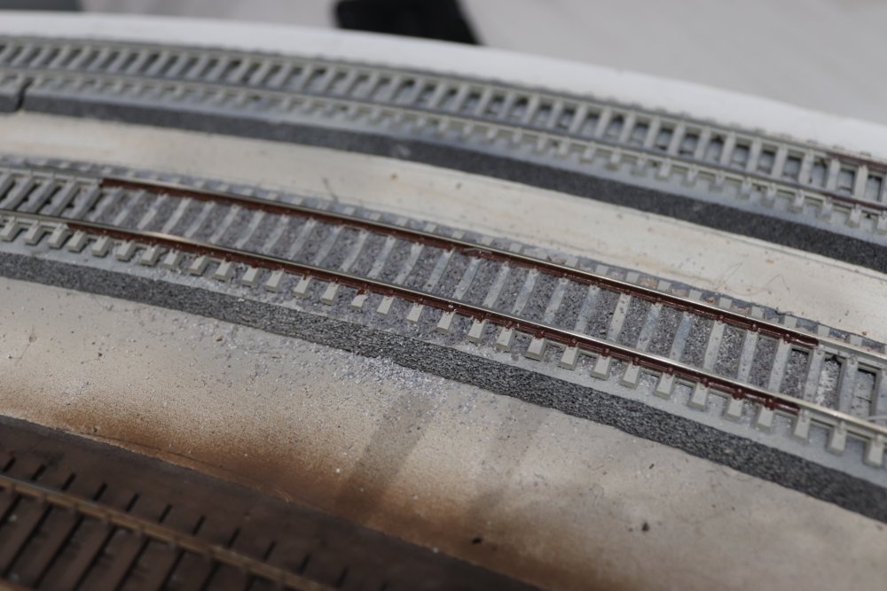

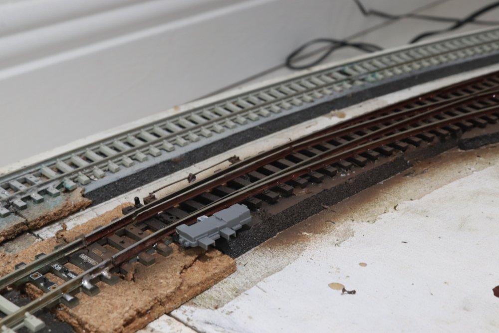

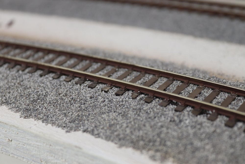

The As derail no more than other stock. The main problem items the joins in baseboards. The track flattens out a bit and also lowers as I had to make the bed solid at the joins in order for it to not move and mess up track alignment.
The other issue is that I have points right next to the baseboard joins. So when the derailing happens it's usually because one wheel set is hovering above the rails as the other wheels are sitting on track that it's slightly higher in level. This results in the free wheel set derailing and causing a short. The MM 071s are the worst culprit for this.
As can be seen in the photo below the level difference is very slight but the problems it causes means I can't run trains...
Edited by gm171 kk
Link to comment
Yep that sounds like a problem alright! part of the issue is the finer flanges on more modern models are less tolerant of uneven track. With the old Lima and Hornby "pizza cutter" wheel flanges that sort of thing really didn't matter. The long wheelbase of the 071 won't help matters either.
