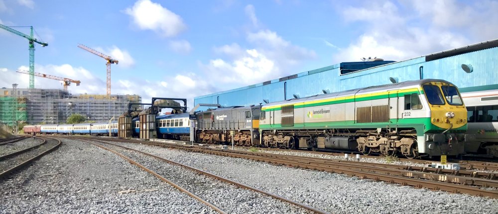

232 was the first 201 to work a passenger service in multiple with 078 when it worked an RPSI special to Cork and Kerry in October 2018,

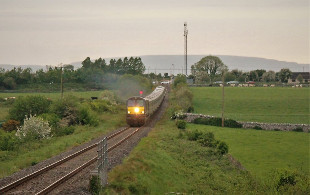

216 was the first 201 class locomotive to work between Ennis and Athenry on the WRC hauling the Belmond grand Hibernian Mk3 set-second photo shows the train having passed through Ardrahan level crossing heading for Athenry and then Dundalk
