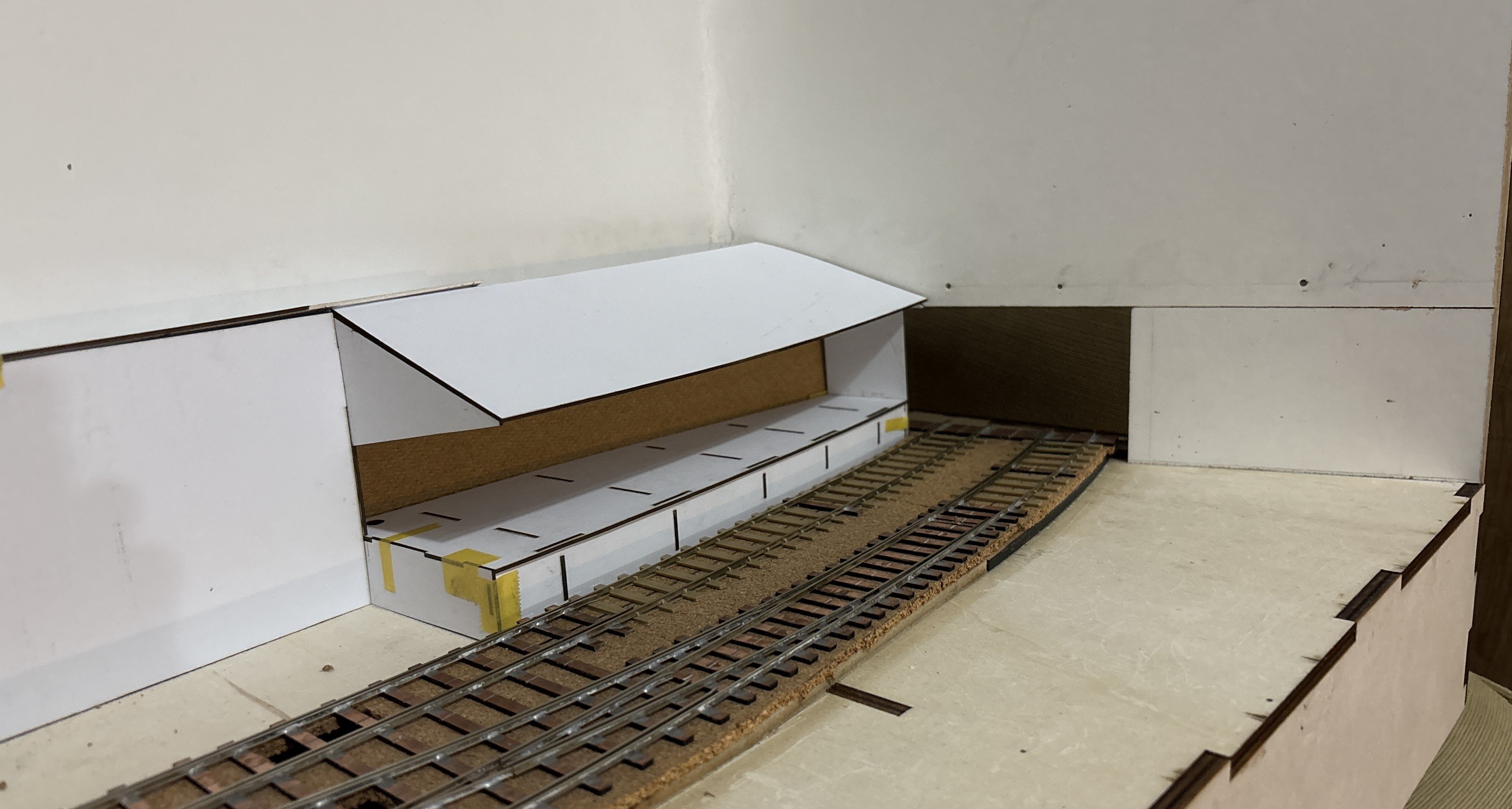

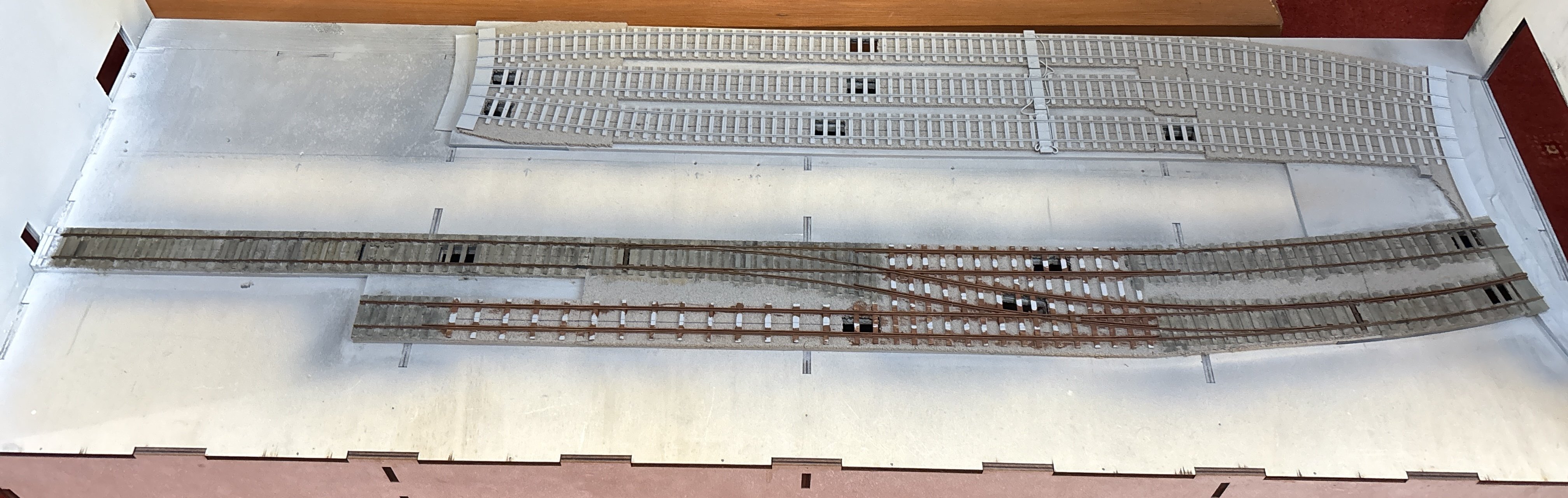

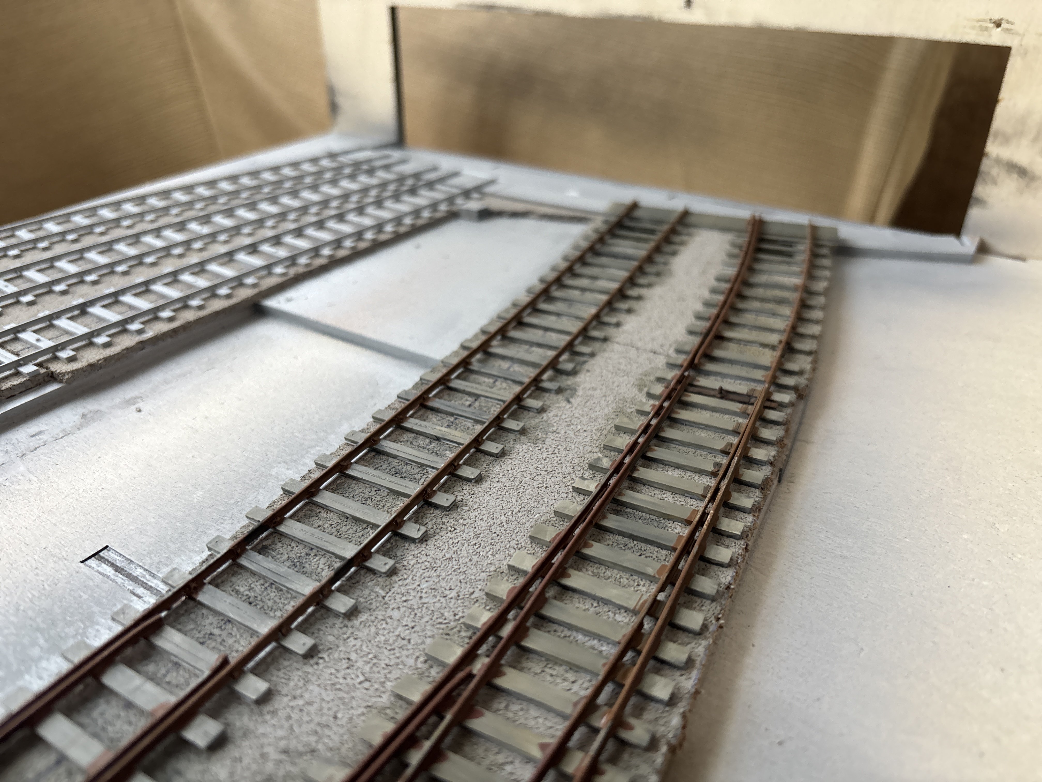

Mol_PMB Posted November 18 Author Posted November 18 Back to Quartertown Mill, I've been playing with the CAD and laser-cutter to rough out a platform and mill building shape. I was delighted to find that a local stationers stocks good quality 1.5mm card for a few quid per A1 sheet, which is ideal material for this sort of exercise. This is truly a job for the lazy man's scalpel! I'll do similar rough mockups of the other buildings to get a feel for how they look, and if the layout seems balanced. At present I've just estimated dimensions from maps and photos, so there is certainly scope for some tweaks. Once I'm happy I can use the rough CAD as a basis for the more detailed and robust structures. 9

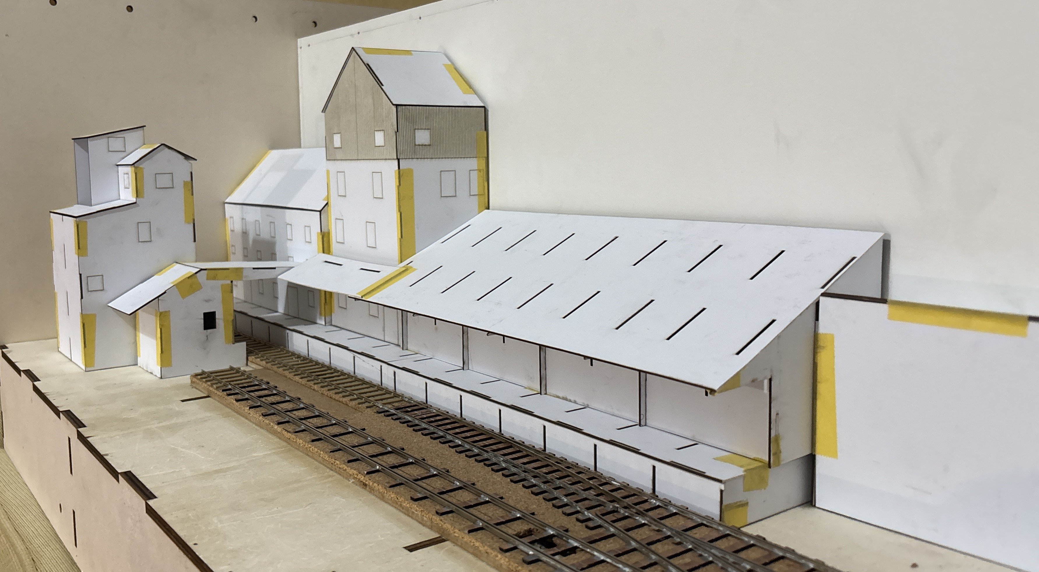

Mol_PMB Posted November 20 Author Posted November 20 More progress with the mock-up buildings. I'm afraid that even with computer-aided toys, my progress at rough mock-ups is far slower than Darius's construction of complete finished buildings! This is definitely proving a useful exercise. With few absolute dimensions to work with, and photos from a limited range of angles, making the mock-ups helps me to see how the buildings fit together and whether the proportions look anything like the photos of the real thing. I've already identified some dimensional tweaks that are needed, but I feel I'm creating the right atmosphere. The 141 has yet to be re-gauged - it's sitting on the checkrails which are at 17mm gauge. 9 1

Tullygrainey Posted November 22 Posted November 22 That’s shaping up beautifully. I like the tight arrangement of the industrial buildings. Lots of shapes, levels and angles. Even in mockup they look great. 1 1

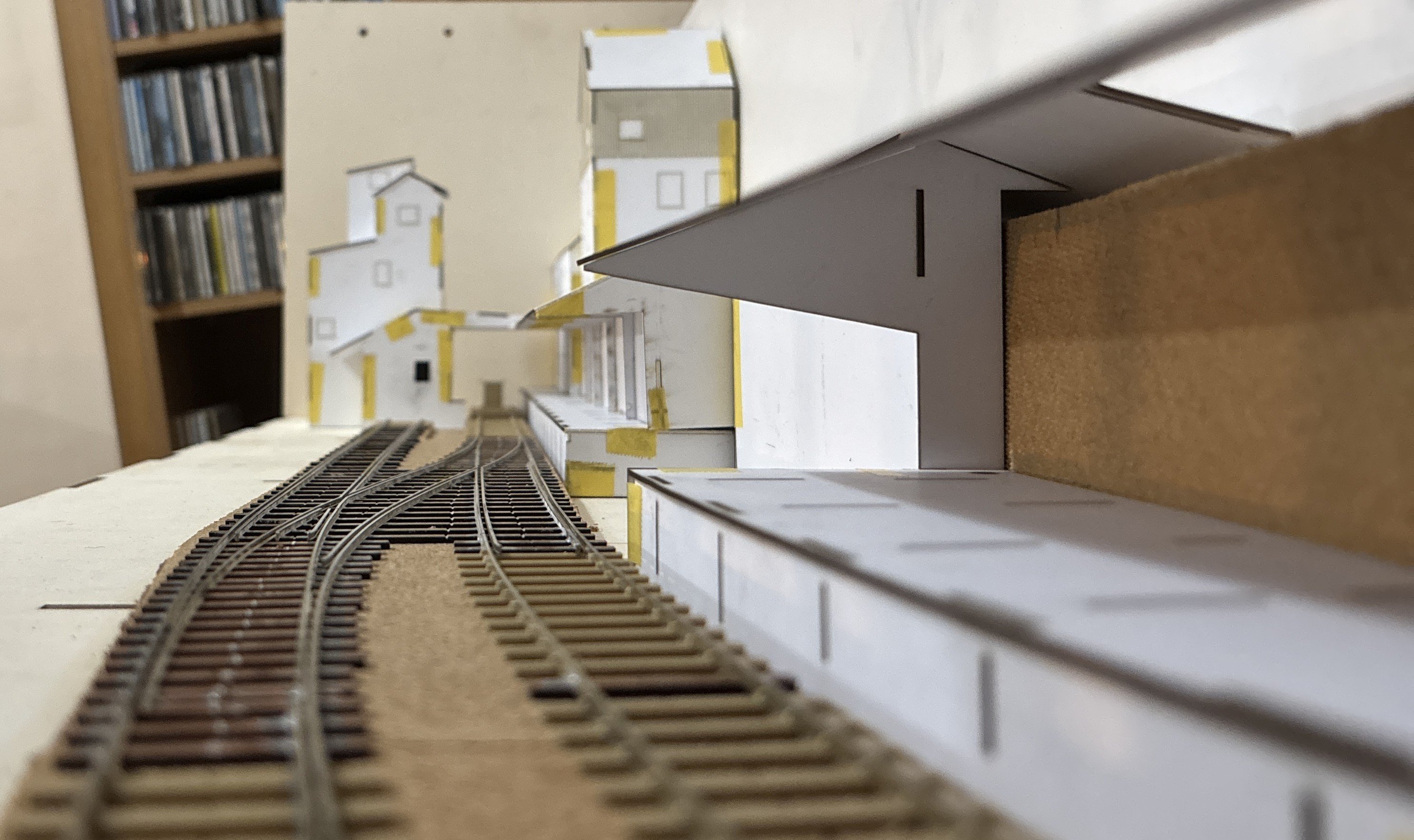

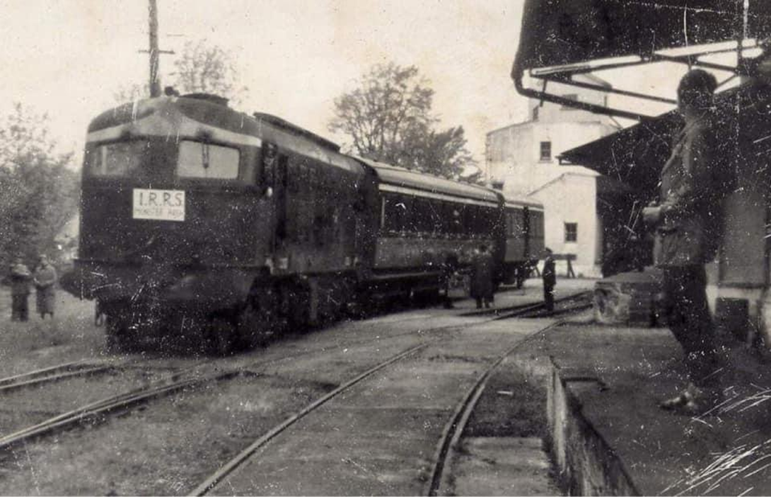

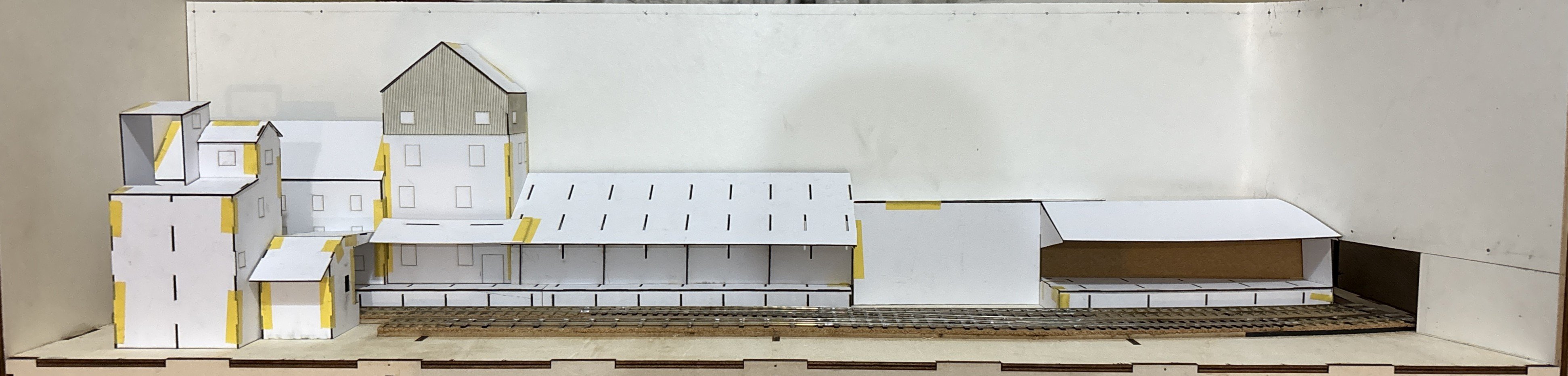

Mol_PMB Posted November 23 Author Posted November 23 A bit more progress with the backscene and the building mock-ups. I'm getting close to what I want now. Broadside view: Main mill buildings; I've shortened the nearer one by one bay: The loading bay near the exit to the fiddle yard: And a gricer's eye view: Which can be compared to this view of the real thing: 10 1

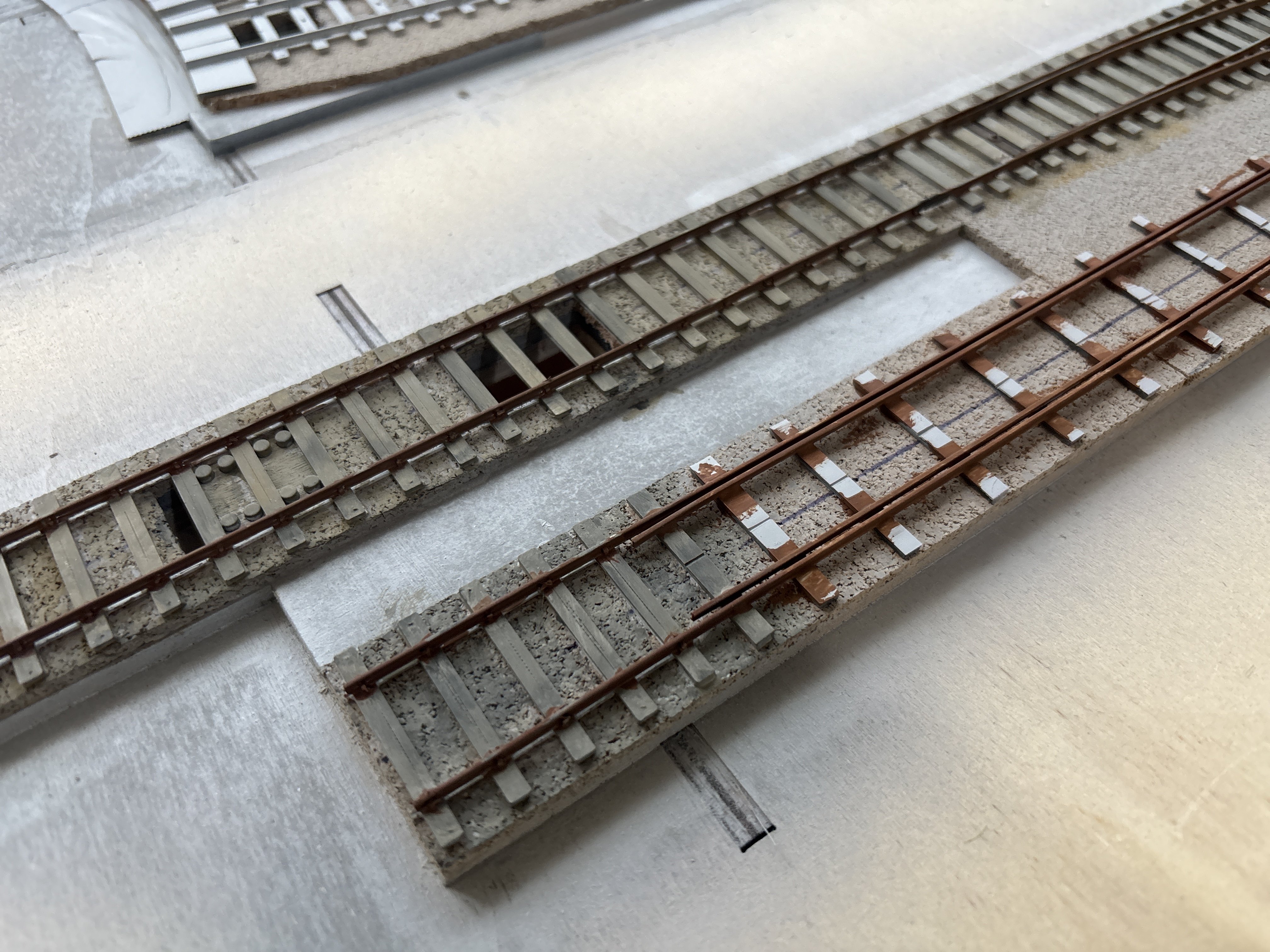

Mol_PMB Posted November 27 Author Posted November 27 Weighbridge: I drew this up during the first half of this evening's IRRS talk, then laser-cut it and slapped some paint on. I'll probably fine-tune some of the engrave depths and do a final version for installation. I'll also need to put some slots in the rail heads to match the ends of the weighbridge. 4 2

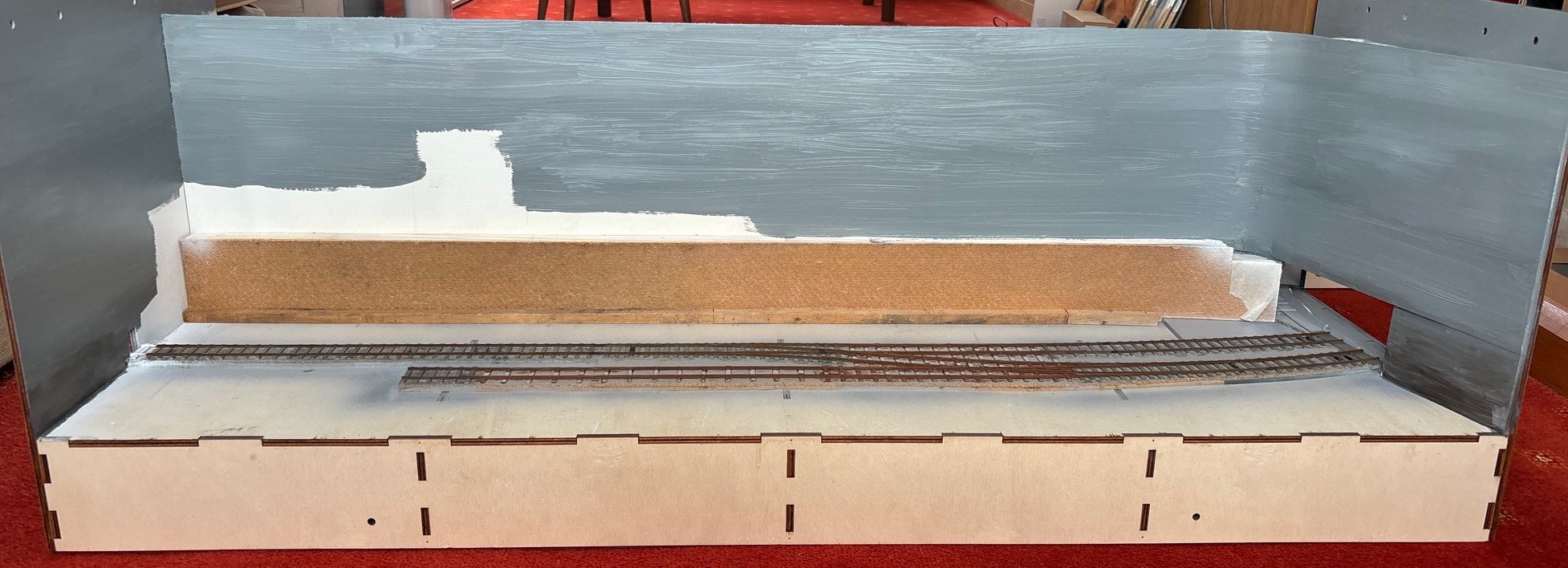

Mol_PMB Posted November 29 Author Posted November 29 Weekends are a precious resource at this time of year as they give an opportunity to work in daylight, even if it is the grey northern skies outside. Consequently the kindergarten art class has made some more fumbling attempts. I have painted the sky in shades of pale grey (it looks darker in the photo than it really is), with a blend towards brown as it nears the ground. I've deliberately varied the shades a bit, and I may well add some more variation in the sky as a second coat, or maybe using an alternative technique like a sponge to give some cloudy effects, Not sure about that yet - if I do they would still be in shades of grey. I then took the tree trunks I prepared previously and added some foliage. Like the trunks, my first attempts were awful but by the time I got to the best trunk I was beginning to think I've got the hang of it. It's going to be autumn at Quartertown Mill. I am now working on developing the laser-cutting artwork for the buildings. I have already made one platform and am now working on the old mill building. 7

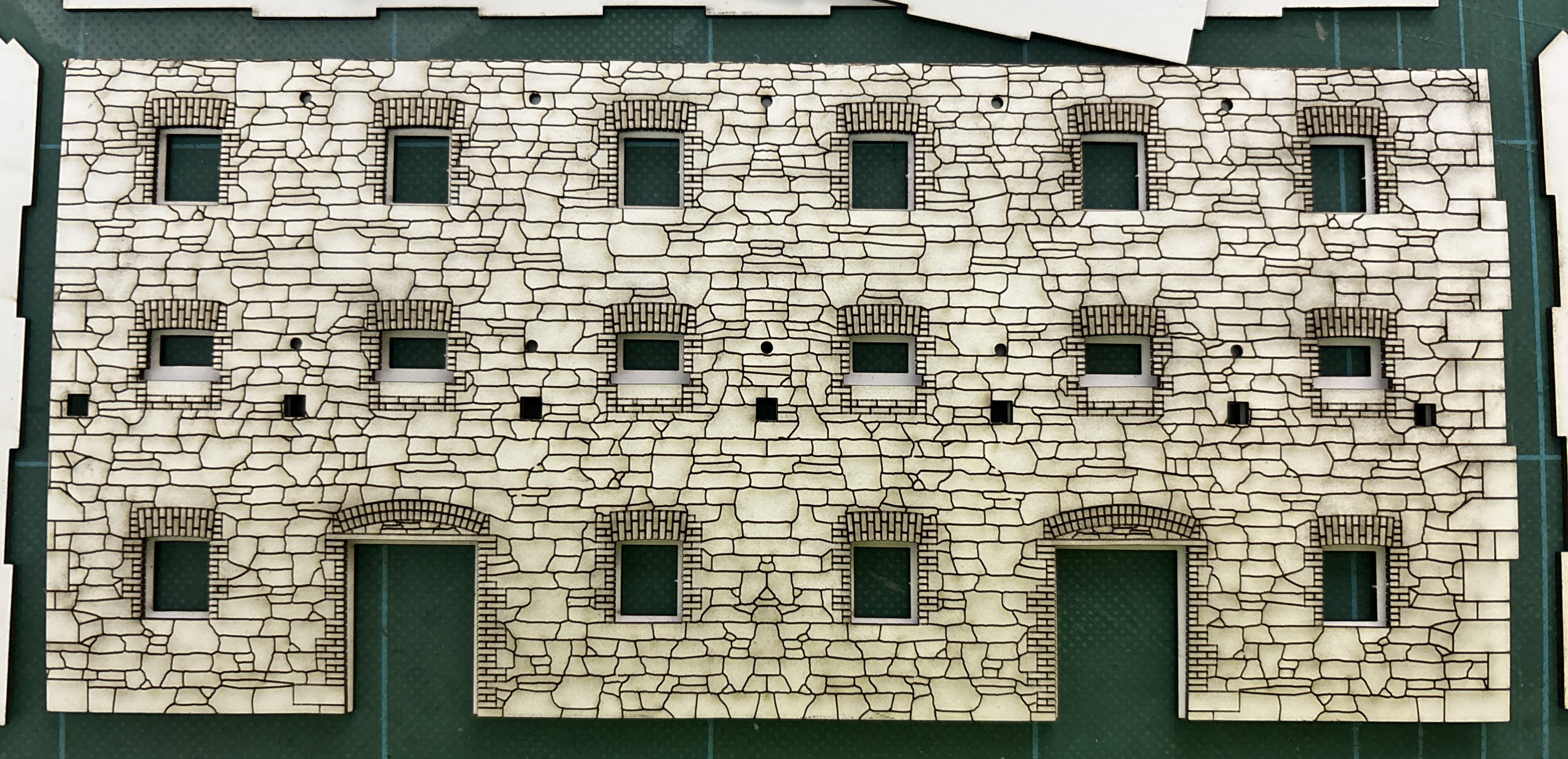

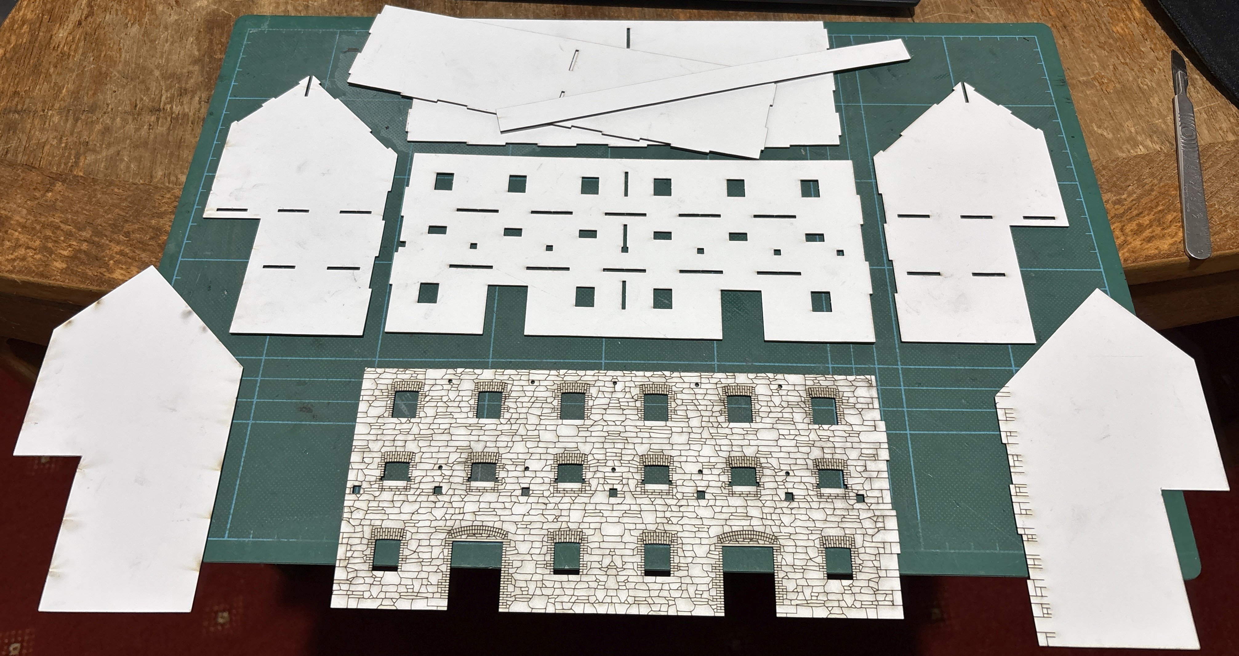

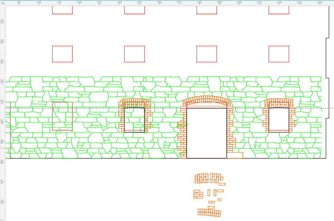

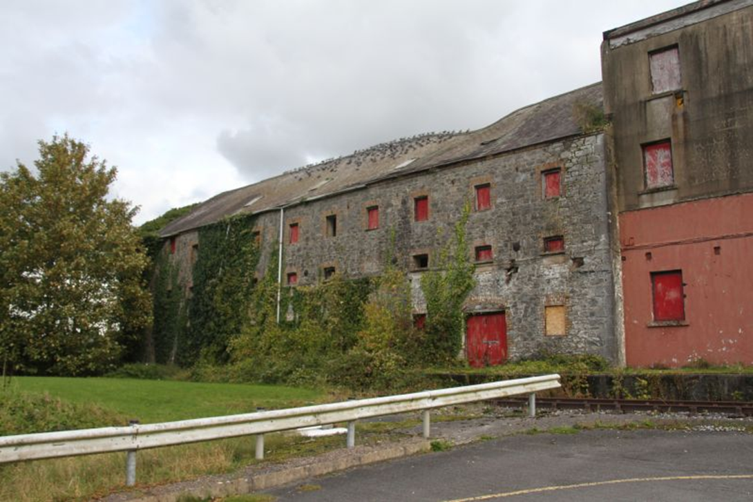

Mol_PMB Posted November 29 Author Posted November 29 This evening's work is most of a kit for the oldest mill building on the layout. I still need to do the roof, some internal bracing and small parts like windowsills, doors and window frames. This shows how the two layers of the front overlay: This is all laser-cut from 1.5mm card. I'm trying to decide the order of assembly, particularly with reference to: sealing the card painting the parts assembling the shell assembling the outer skin My gut feel is that the outer skin should go on after most of the painting is complete, as this will make it much easier to have the window frames in a contrasting colour. And that then of course raises the question - what colour? All the old photos are black and white, and don't show much of this building anyway. The more recent scheme was black outer frames, and red doors, red blanking panels for the windows. I doubt it would have been like that when the mill was in use. Any suggestions for a paint scheme? 4
Galteemore Posted November 29 Posted November 29 It’s not so far fetched to say that it may indeed originally have been red. This was the default colour in Ireland, not because it warded off evil spirits, but because (owing to its oxide base) it was relatively cheap. 1 1
Mol_PMB Posted November 29 Author Posted November 29 Just now, Galteemore said: It’s not so far fetched to say that it may indeed originally have been red. This was the default colour in Ireland, not because it warded off evil spirits, but because (owing to its oxide base) it was relatively cheap. Ah, that’s very useful information. In England, green was more common. This isn’t the same building but it is the same mill, and at a much earlier date. Here the entire window frames look dark and they could well be red which looked dark in early photos. I could do worse than look through Ernie’s colour photos from the 1950s/60s and see how other buildings were painted. 1

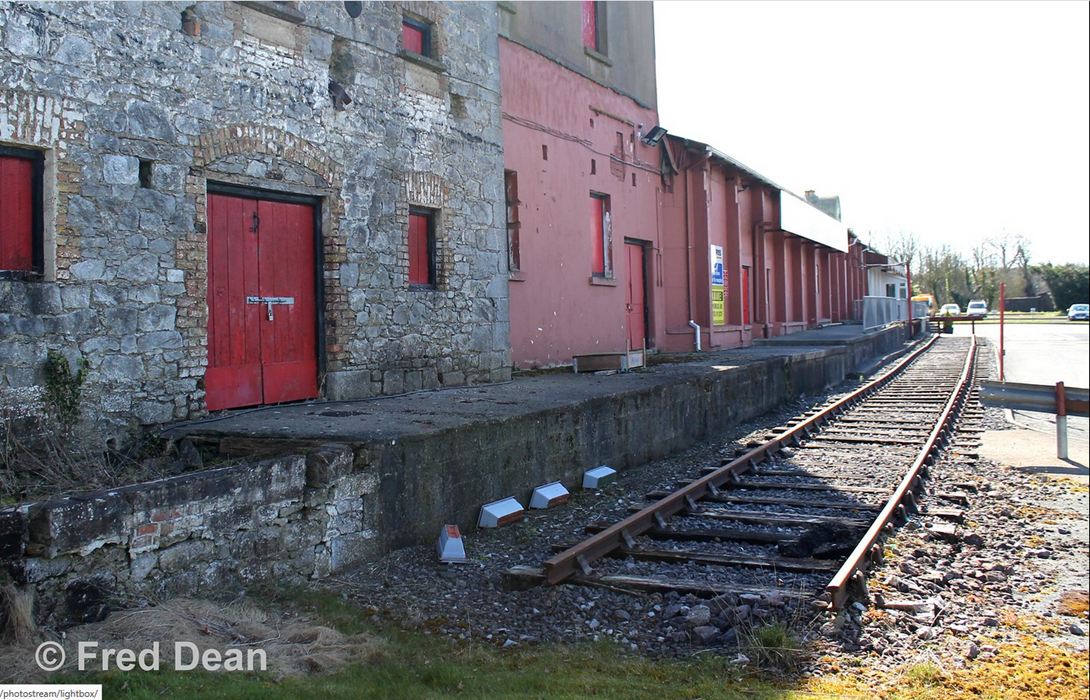

jhb171achill Posted November 30 Posted November 30 2 hours ago, Mol_PMB said: Ah, that’s very useful information. In England, green was more common. This isn’t the same building but it is the same mill, and at a much earlier date. Here the entire window frames look dark and they could well be red which looked dark in early photos. I could do worse than look through Ernie’s colour photos from the 1950s/60s and see how other buildings were painted. Green was used here too. Certainly, several of the canal companies used it, though they used red too. Quite possible that any given building had both at different times. 1
David Holman Posted November 30 Posted November 30 Google photos of the Rathmelton quayside show red doors, with very peeling paint, suggesting it had been that colour for quite a while. Indeed, enlarging your photos shows the same. They also show it's not exactly the finest stone that's been used. Rubble would be a better description and even the brickwork around the openings looks decidedly second hand! All adds to the charm, of course and some talc to texture the paint might not go amiss. 1 1
