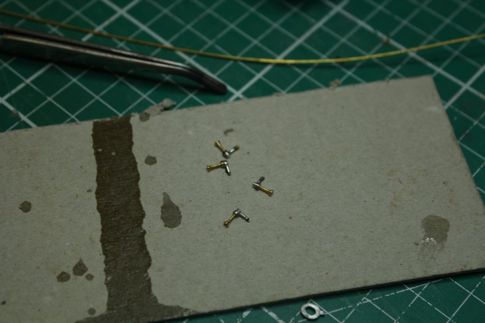

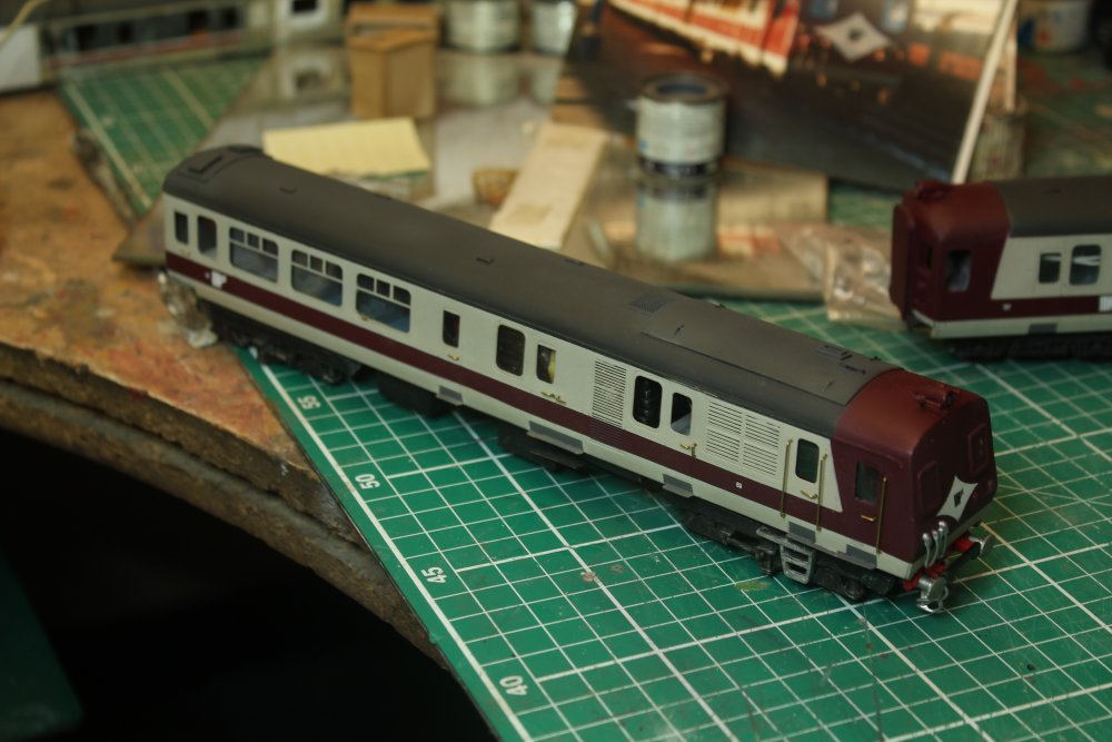

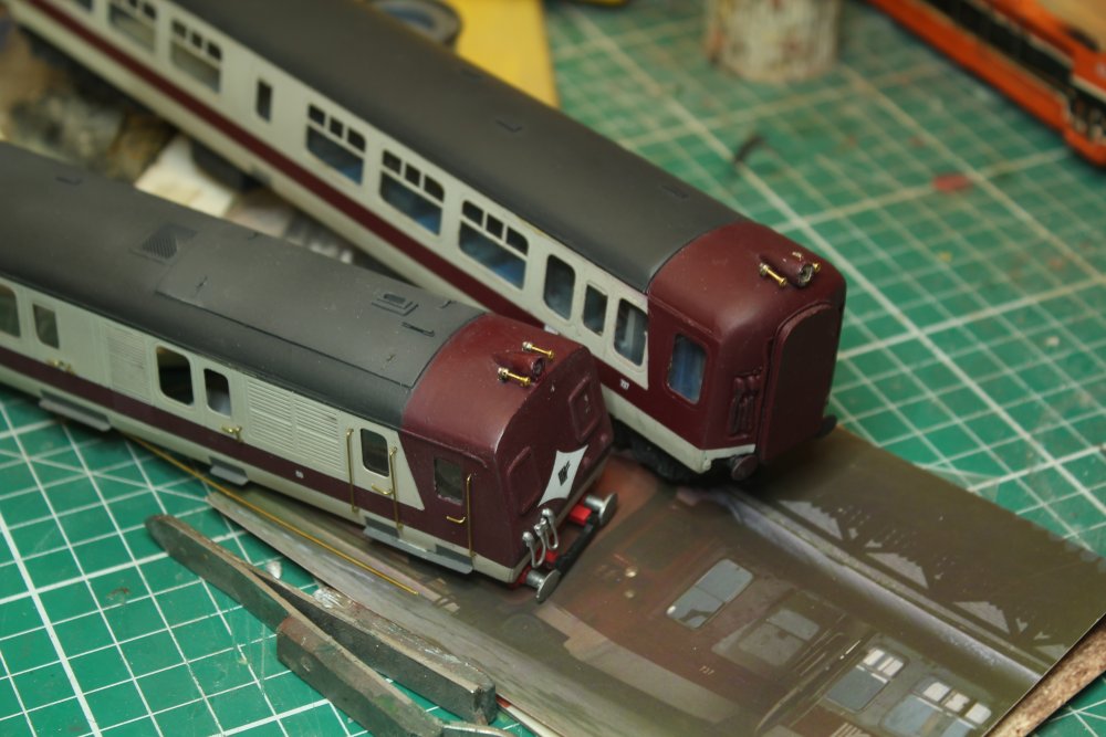

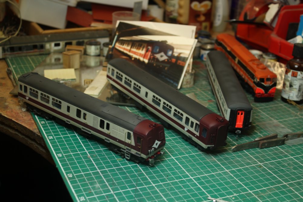

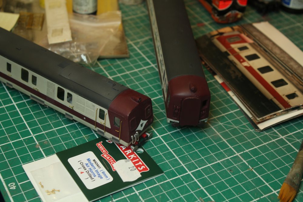

Hi Lads,
To my embarrassment I still have the 80 not quite completed but I will have it done and dusted by the end of the month, Got the Handrails and Door handles on, The Air horns, The footsteps and the coupling on earlier.
An 071 is next to complete and send away or it wont be safe to walk about the midlands......Here a few shots of the latest push.

Finally have this 80 class running, The wheels on the coaches are not suitable for my code 75 as the flanges are too big but it runs. I can only run it on the inside as the bogie frames on the motor coach rub on my 3rd rail.

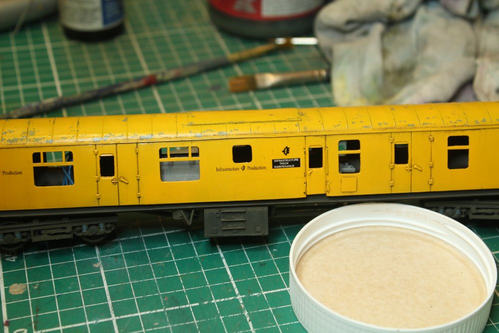

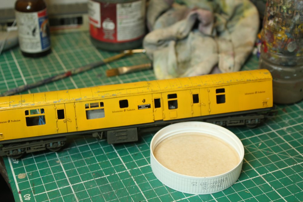

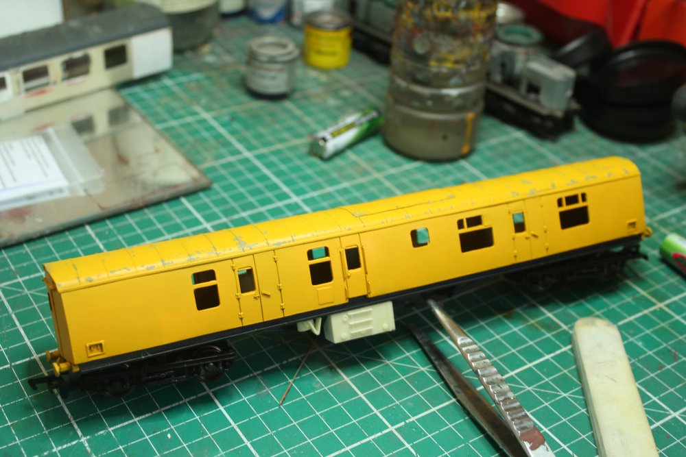

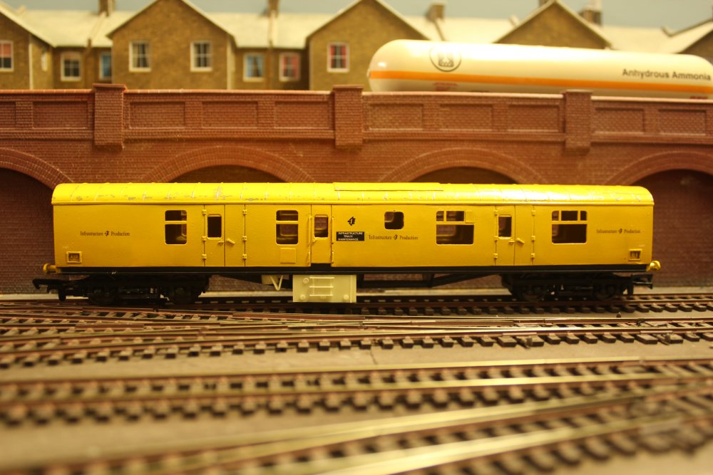

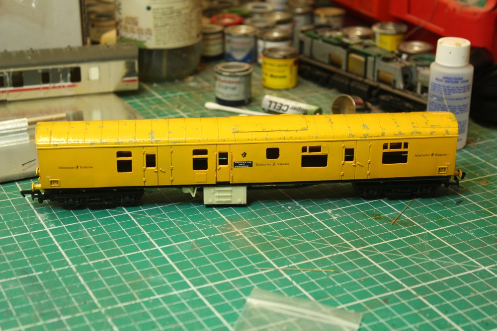

In between bits n bobs got the Silver Fox Van kit so working on this now. Need to put that bar across the doors on too, Is that on both sides?
Also sperate hand rails and Lamp Irons will be on plus I might out the console inside too.
Started the Roof Weathering base on Brian Solomons Pictures.
image.png.daef11a3658dc4be41eef94e30e0a5b5.pngIMG_7029.thumb.JPG.43db2d2cc4bfb4ea65f62ac94ef24a3b.JPG
  • Like 8
  • WOW! 2

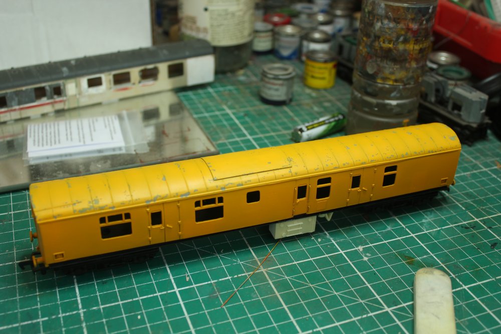

No probs,
Spray the primer, Used some pre-shading using Black and white, You can just about make out the white areas coming through.
Then used a Sponge with Maskol and dabbed it over the Gray (did not want to use a Metal Colour) Left it dry Spray the yellow and rubb off the Maskol with a Cotton bud. I did not want to over do the Roof as it is a bit worse in the pictures of the real thing.
http://briansolomon.com/trackingthelight/2015/08/19/irish-rail-weedsprayer-at-heuston-station-18-august-2015-three-photos/irish_rail_074_w_weedspraying_train_at_heuston_dscf5054/
The white pre shading brings up a slightly different hue yellow as indicate in the ring below, Give a Small bit more interest in the overall Yellow.
I added Top hats to the Bogies too for that bit of extra glide not that it needed it I'd say.

2 hours ago, Georgeconna said:
Thinking about Weathering the rest of the Weedspray now. Just worried about the printed Markings coming off with my usual spirits based method.
One of the transfers lifted on an RTR SF weed van when I was applying water based powder wash, luckily I was able to get it back on and in position. I don't think the RTR versions were sealed with varnish.
One of the Reasons I got the kick Noel, tis the IRM printed Transfers I noticed came off with another chaps efforts , I normally used Enamels for the Weathering, Thats what I am used to so Reluctant to go off Piste using some other stuff.
Looking good there George, roof looks great. What gloss coat do you use to seal it. I applied Humbrol gloss coat to mine before xmas and its still tacky and that was after 5 mins of stirring it. ( Humbrol never again!!)
Humbrol mate, Sprayed a coat @ 7pm this evening Placed the coach over a heater on low (dont want the yoke to warp) and it cured by 2200hrs. Second coat went on an hour ago.
I heated the paint beforehand though.
Decals tomorrow if I can get time as we are all called in to clear customs backlogs over the weekend and for the next 2 weeks for so. Tis nuts but look on the bright side those A are a coming!

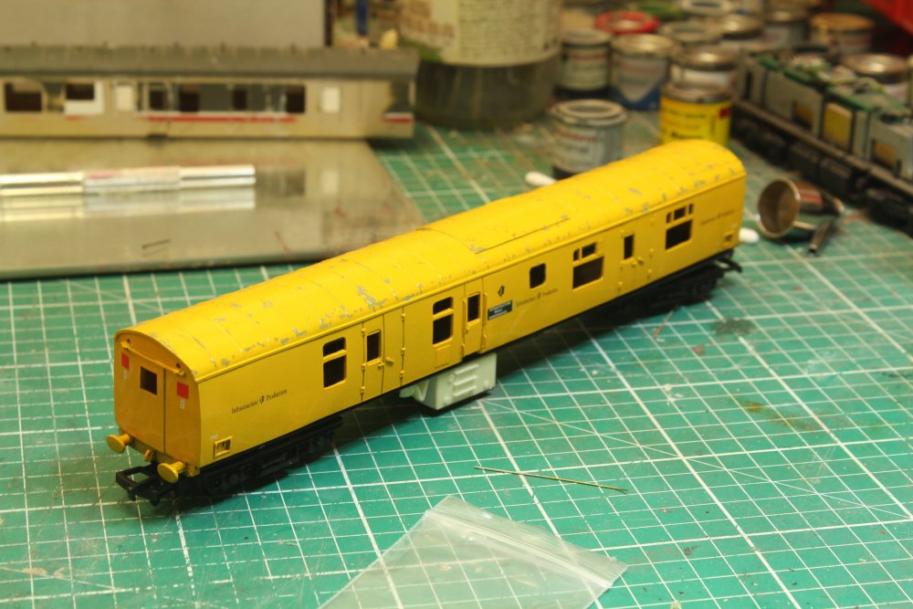

2nd Coat of Varnish on and the Decals went on with no issues and bedded down nicely, They a Fragile though and some have the carrier film across the logo so need slitting with a sharp scalpel, I used a Point logo from a spare sheet I had as the S/Fox on was just solid plain black with no yellow.
Just notice now the door Hand rails should be one piece and not 2 as depicted on the Resin Casting. Balls.
Need to seal the deIMG_7041.thumb.JPG.3b2d528d54cf42be6d0147f6ef577ca9.JPGIMG_7037.thumb.JPG.8a76870db5c3b5579521fed67e6fadcc.JPGIMG_7041.thumb.JPG.3b2d528d54cf42be6d0147f6ef577ca9.JPG    al next, Leave to dry for a few days and a tad of weathering.

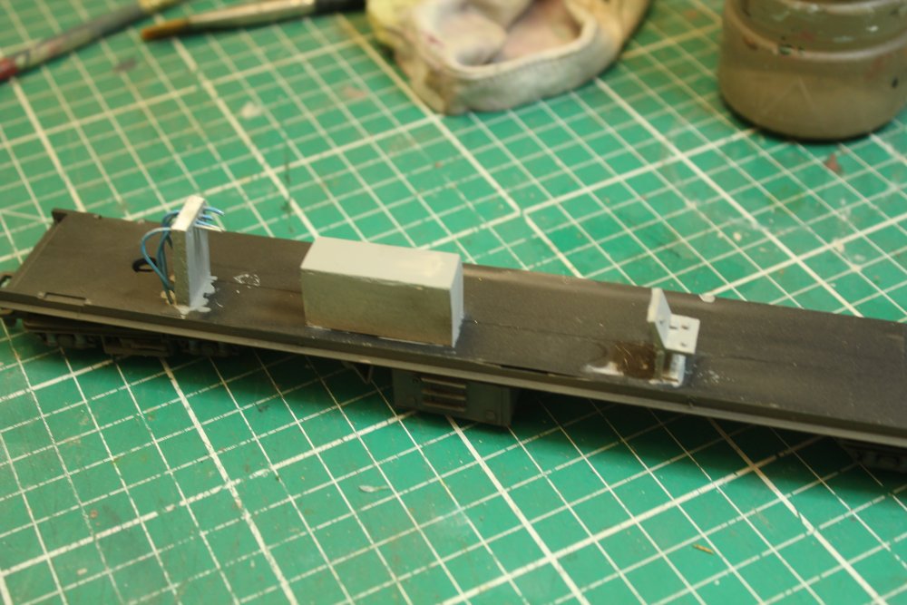

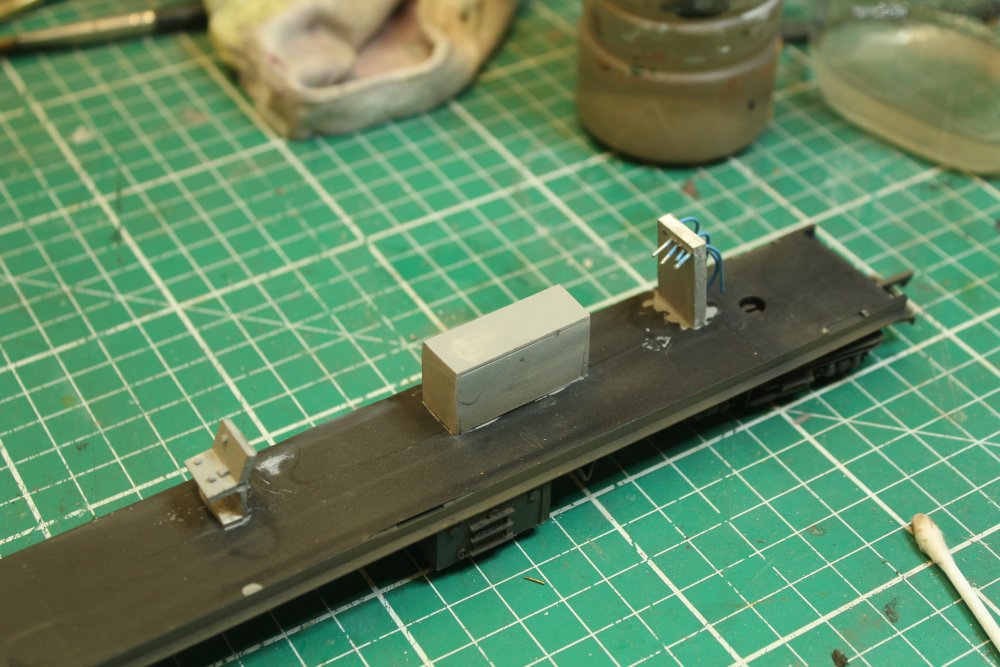

Small bit more on the Weedy.
could see some gubbins inside to coach in Brians pictures, Some control panel, a Tank and some piping jsut about seen so said what the heck After all I am up against the super weed spray pack.
Gotta put that little Exhaust pipe in too
Started some weathering too with the frames and bogies done, Not gonna over do it too much.

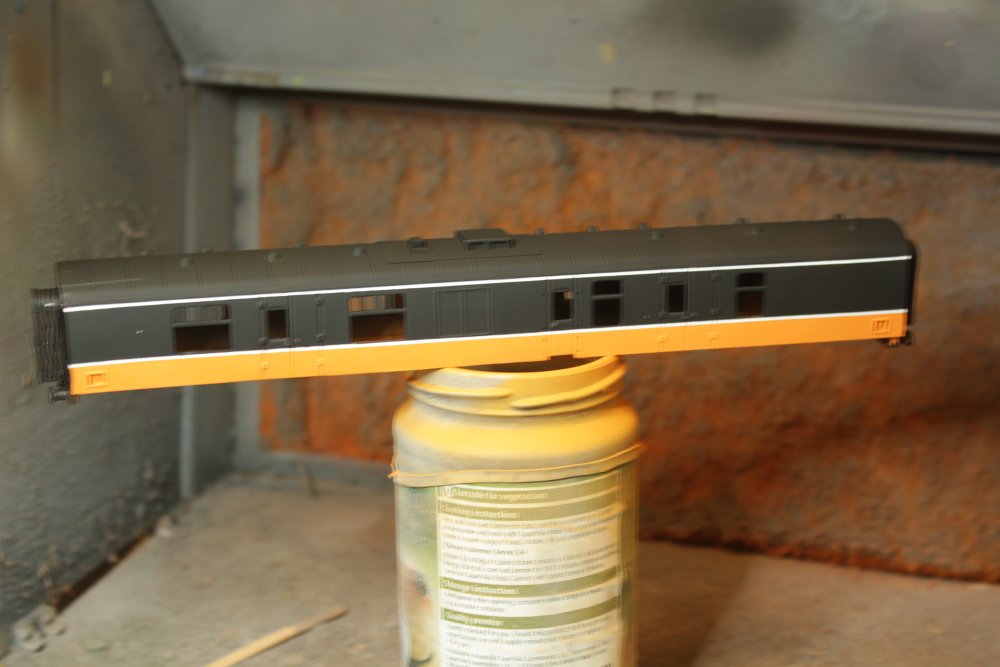

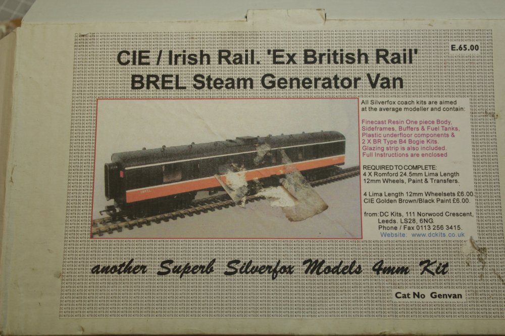

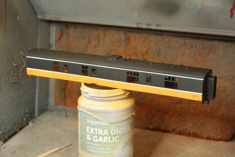

With the A class arriving a such a lovely runner I dug out a few cravens and though I  had made a Gen Van but nope the kit sitting there waiting so I started on that. Simple enough, Resin is nicely cast. RAL 201

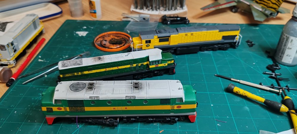

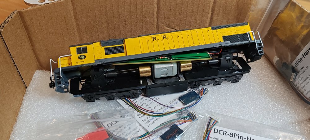

Hi all,

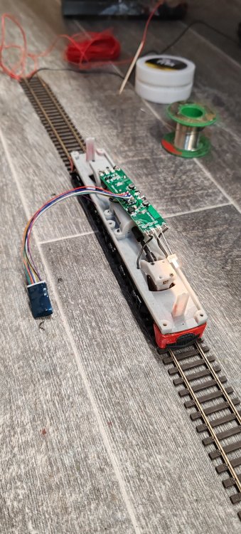

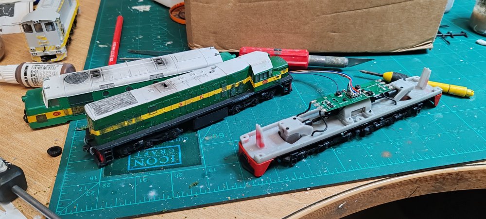

Long time in the works, Too long! MIR 071 with Proto 2000 chassis and LED headlight being test run yesterday.
It proto 2000 chassis had a circuit boat throwing out 2V to the head lights which was too low to run anything so cut the yellow and white on the decoder and hard wire the other wires to the pick ups and used 12V LEDs with resistors in them.
Horns to go on next , wipers and then some weathering
