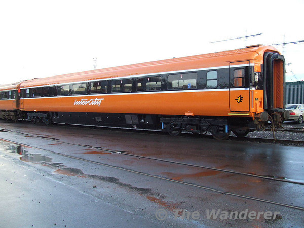

IE Mark 3's had silver window frames....however there is always an exception! Three coaches were badly graffitied at Waterford during the Christmas Shutdown of 2006 which resulted in them being repainted on one side, with black window frames. See Waterford Graffiti victim 7151 stands in  Guinness Sidings Heuston. Note the black window surrounds. The vehicle has only been repainted on one side. Sat 20.01.07 as an example.

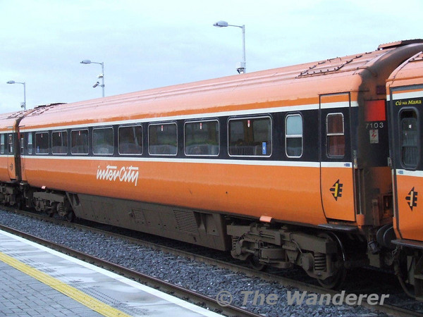

Mk3 Standard 7103. Tues 01.01.08 - Standard Livery on a MKIII.
