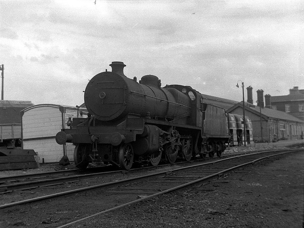

BosKonay Posted January 23, 2016 Posted January 23, 2016 (edited) photo of 371 377 382 Edited January 23, 2016 by BosKonay
GSR 800 Posted January 23, 2016 Posted January 23, 2016 That's a great pic Bosko. Looks like she is paired with a tender from one of her green sisters
BosKonay Posted January 23, 2016 Posted January 23, 2016 That's a great pic Bosko. Looks like she is paired with a tender from one of her green sisters One of my favourites - shows there is a prototype for everything

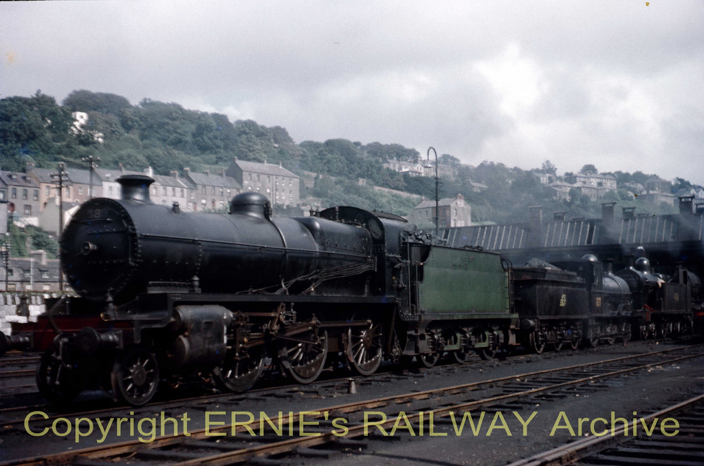

jhb171achill Posted January 23, 2016 Posted January 23, 2016 If you want something a bit different model the loco in mid 1930s virtually same as the English locos apart from the grey livery, name plates no smoke deflectors . No need to change the smoke box door or other CIE modifications. Bachmann or Dapol LMS corridor coaches would almost pass for a GSR mainline set in the new Maroon livery GSR used a shade of maroon and lining style after 1933, with the introduction of the first batch of "Bredin" coaches, which was indistinguishable from the LMS (and by extension, the NCC!). So, removal of LMS style lettering and crest, and replacement with GSR, is all that's needed. That's a great pic Bosko. Looks like she is paired with a tender from one of her green sisters I've seen that before - but there's another interesting point. Grey tenders sometime had light green snails, sometimes unmarked. But green ones always had snails and lining - except this one! It's just plain green, one of those occasional livery "aberrations"! I've seen a picture of a 400 somewhere in green, and no lining is visible, though it's quite probably there but can't be seen because the engine is absolutely filthy, and it's a poor photograph. I'll see if I can find it.
GSR 800 Posted January 23, 2016 Posted January 23, 2016 John, when Meadbh was repainted on inchicore in the early 60s, she was not given a snail, I wonder why. Also, on some of the other green locos, the snails seem to have disappeared, probably under a layer of filth!
jhb171achill Posted January 23, 2016 Posted January 23, 2016 She was repainted the standard way (and is thus the "go-to" reference for proper CIE green) but the snails omitted as (a) it was the currently-used logo, and (b) it was leaving CIE ownership. It remained like that in Witham Street, and is snail-less when moved in 1993 or thereabouts to Cultra. The UFTM added the G S lettering and crest when it arrived there, which (like virtually everything else they painted) is incorrect. In that green, with that lining, it should have a snail. If they wanted GSR style, a lighter green with the lining in black and yellow, not black and white, is what's required.
