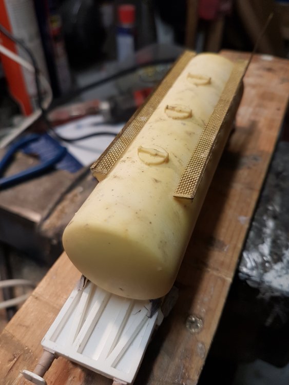

The ends were made by casting some machinable wax into a mould and machining them to size on a small lathe .
I am working from the drawing on the forum and the photos on the net. These are very good but not great for the smaller detail such as the hatch lids , so if anyone can offer more detailed pics I would be very grateful .

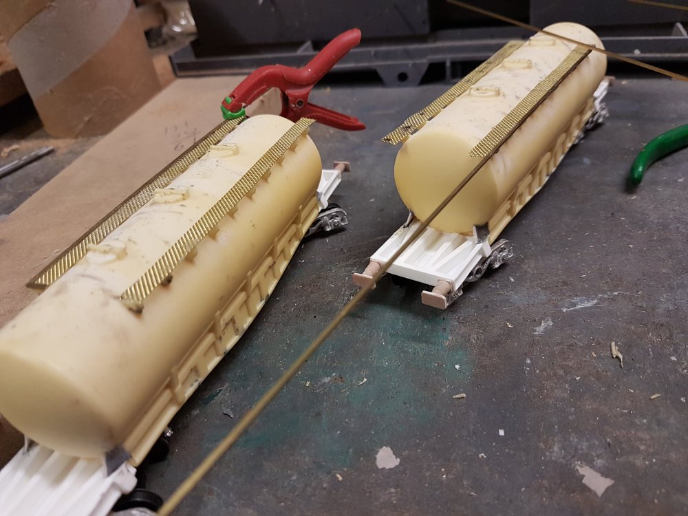

the day job has slowed progress on this , but I got the mould made .
This is the first "pull" from it .
It is in a polyurethane resin .
The white one is the master .
I need to work on eliminating the air bubbles in the resin .
thanks guys ,
the mould has one part in silicone rubber and a core made in acetal both of which are inside an acetal box or " shell" .
not sure if that makes it a 2 or 3 part mould?

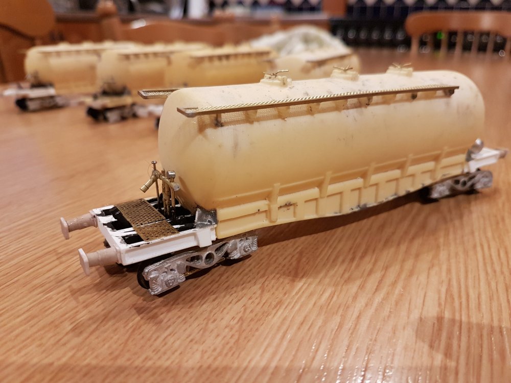

Now that I am starting work on the chassis does anyone have any advice re which bogies to use ?
Hi brianmcs
The mould looks cool, though it looks like you had an air problem also! the silicone looks like it needs to be evacuated when mixed and before pouring to make the mould- this may help in casting bubble free casts. Also you could try a mould spray loubricator it may stop the plastic cast forming bubbles at the bubbles in the mould! if that makes sence?
SSM do the bogies sides your looking for or you could the Y25 bogies from Bachmann which are a bit smaller then Irish ones

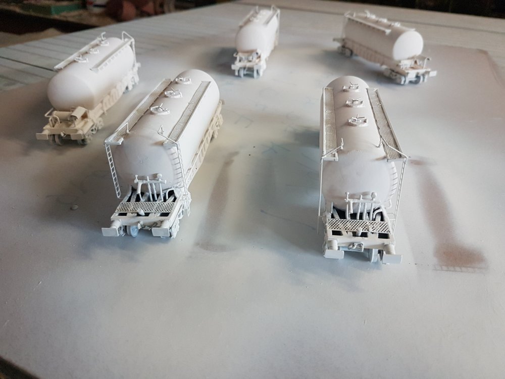

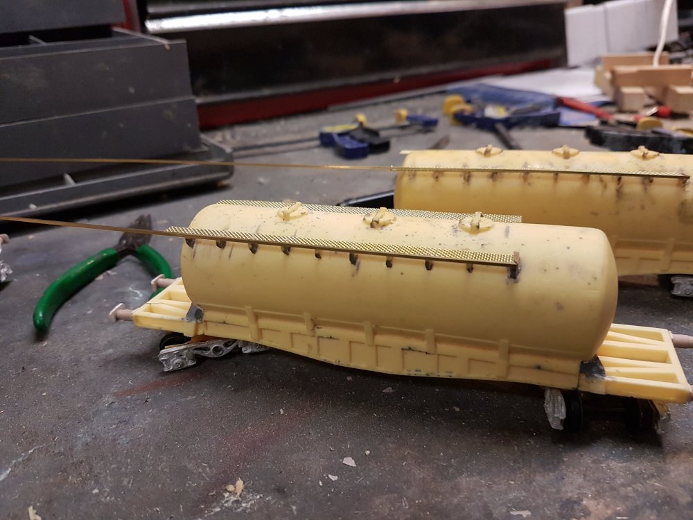

12 minutes ago, jhb171achill said:
Looking amazing, Brian! That lot will look amazing behind an "A"......
The bogie Bulks were never hauled by the A class as they were air braked wagons the A class were never equipped for air braked trains (029 was as a trial ).
Nice job on the wagons
Edited by flange lubricator
Indeed; I stand humbly corrected!!
