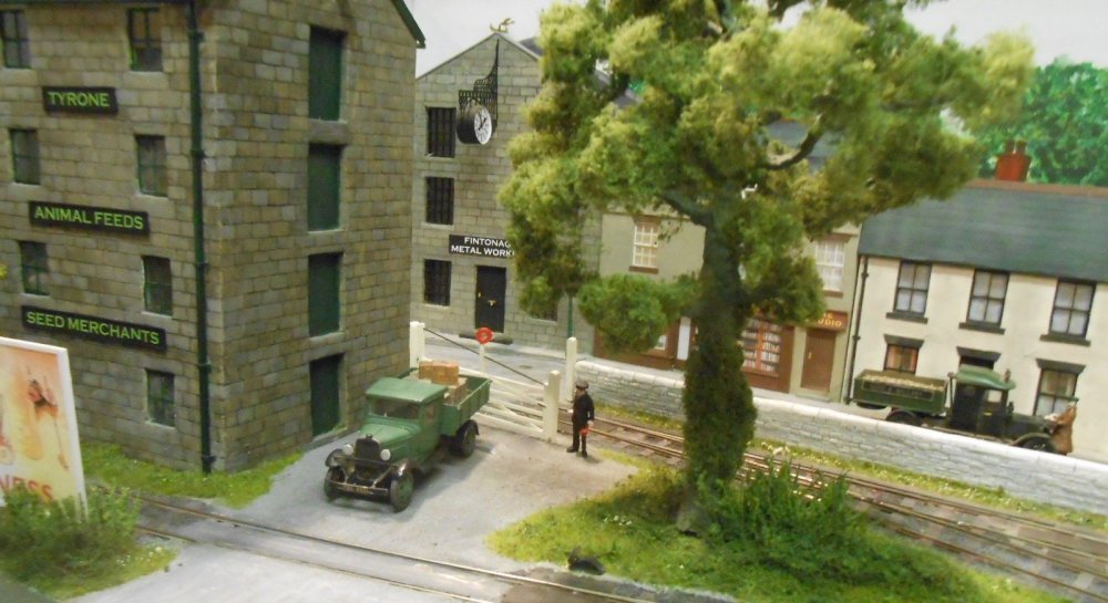

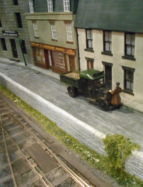

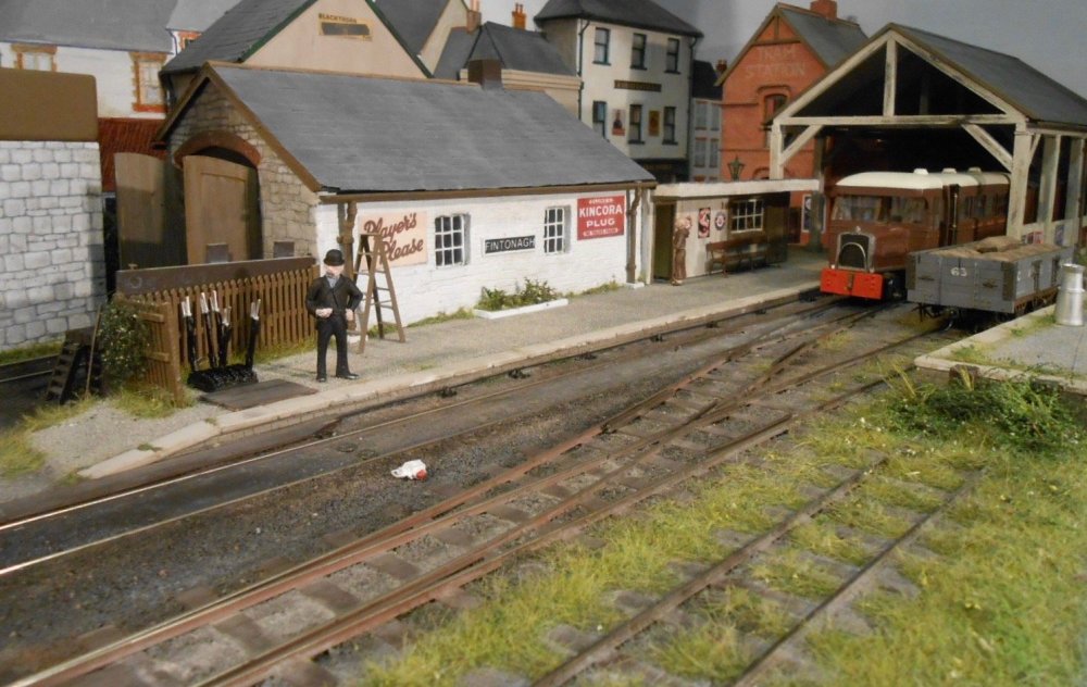

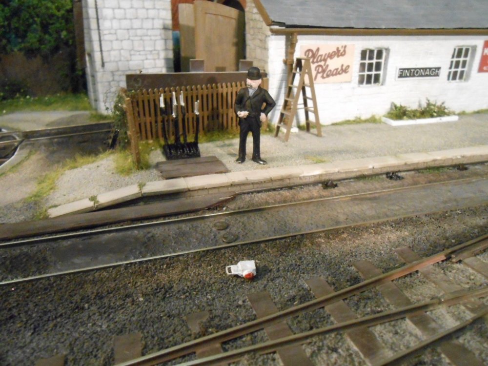

David Holman Posted October 15, 2018 Author Posted October 15, 2018 Fettling and finishing touches It is now less than a week to Fintonagh's exhibition debut at Uckfield next weekend. Not the largest show in the country, but definitely one of the finest in terms of layout quality. Manager Adrian Colenutt has become a past-master at fitting a lot in the space available, while the hospitality is very good too. However, this means the layout has to not just look right, but it must run well too, hence the last few weeks being spent in trying to iron out all the faults! I've written elsewhere that this is very much a problem with hand built stuff - or at least it is for me, for I am no expert, but I do work at things in the hope of getting them right, while experience helps too and I have approaching 100 shows under my belt now. Fettling essentially involves running the operating sequence over and over again, making notes of where things go wrong, then investigating the cause in the hope of putting things right. Faults manifest themselves in various ways: Derailments - mostly these are down to back to backs on the wheels. I use 4mm fine scale standards, which means 19.3mm b2b and not much leeway either. Less than 0.5mm out and wagons in particular derail on either the point blades or the crossing vee. Easily solved with a vernier gauge, thankfully Hesitant running - mostly cured by compensated/rocking axles on locos, plus pick ups on all wheels. Couplings - I'm using Kadee No 5s and though they are fairly reliable, they do need careful setting up, especially as I'm also using small 'rare earth' magnets for uncoupling. Practice also important too, stopping trains within a 5mm space requires a degree of concentration. On top of the above, one also has to create a sequence that works simply and effectively, for as well as running the layout, it is always enjoyable talking to visitors and they have paid to come in, so you owe it to them to put on a decent show. In addition to the above, there is of course Sod's Law, which can strike at any time - usually when there is a video camera operating! When [not if, note], this happens, then you just have to grin and bear it, though it is just as well visitors can't hear what I'm thinking! At them moment, the layout is running at about 95% efficiency. Derailments are now only operator error and the locos [as long as track and wheels are clean] are running nicely - even Blackwater, which has had large amounts of lead added to enable it to pull a short coach and two wagons [!]. The problem is it has 30:1 gears as opposed to the 40:1 in sister Erne and it makes quite a difference. Blackwater has caused further headaches, by repeatedly suffering from a loose wheel nut [hopefully now cured with some gloss varnish in the threads] and a broken lead on the motor. The first class bogie coach has caused much head scratching and many rude words, because in one direction, it was derailing on the point entering the station. No amount of wheel checks could sort it, but eventually cured it, by reversing the bogie, so the troublesome wheels were in the inside, not the outside. Fingers crossed now ok. The photos show some of the small details that I've been adding: A small [dummy] ground frame on the platform to operate the points A small section of point rodding [along the platform] and boarding elsewhere to cover the rest, which I really don't want to do! Figures, including a rakish fellow outside Forbes Bar, a flagman guarding the exit from the station and a lady promoting the Temperance Movement outside the tea rooms. Road vehicles are mainly from Arigna, including donkey cart, small lorry and Austin 7 saloon, plus the Model T Ford truck seen earlier. In addition, there has been organising packing and transport, with new stock boxes and trial fitting in the car. Talking to Christopher Payne [also at Uckfield with Pyn Valley Railway [in latest RM], he opined that a layout probably shouldn't be exhibited until it has done at least three shows, to iron out the faults that only ever occur away from home. Difficult, but I know what he means! Wish me luck, or better still, come along and say hello. Uckfield really is a great show. 8 1

banntry Posted October 20, 2018 Posted October 20, 2018 Excellent detailing David-Its these smaller items that really bring a layout together.

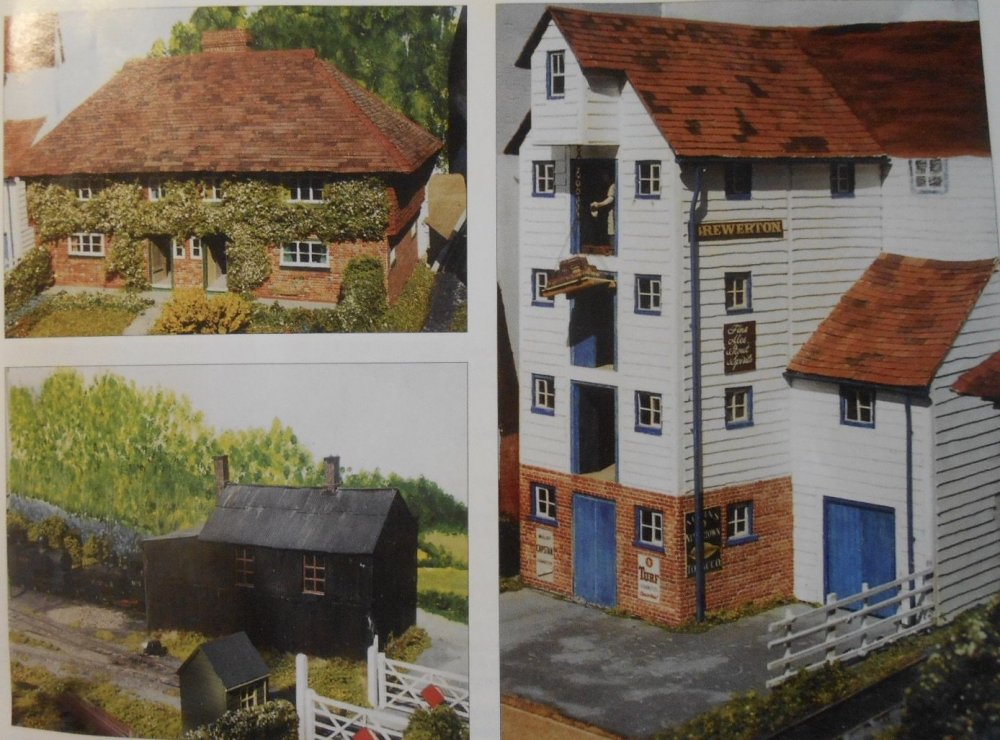

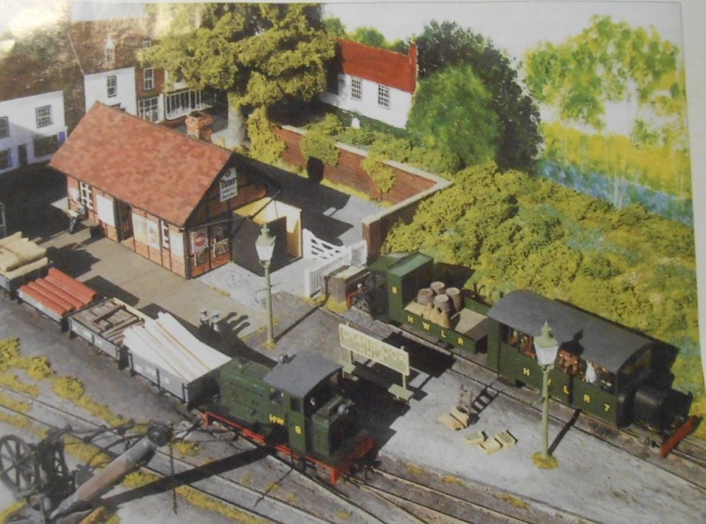

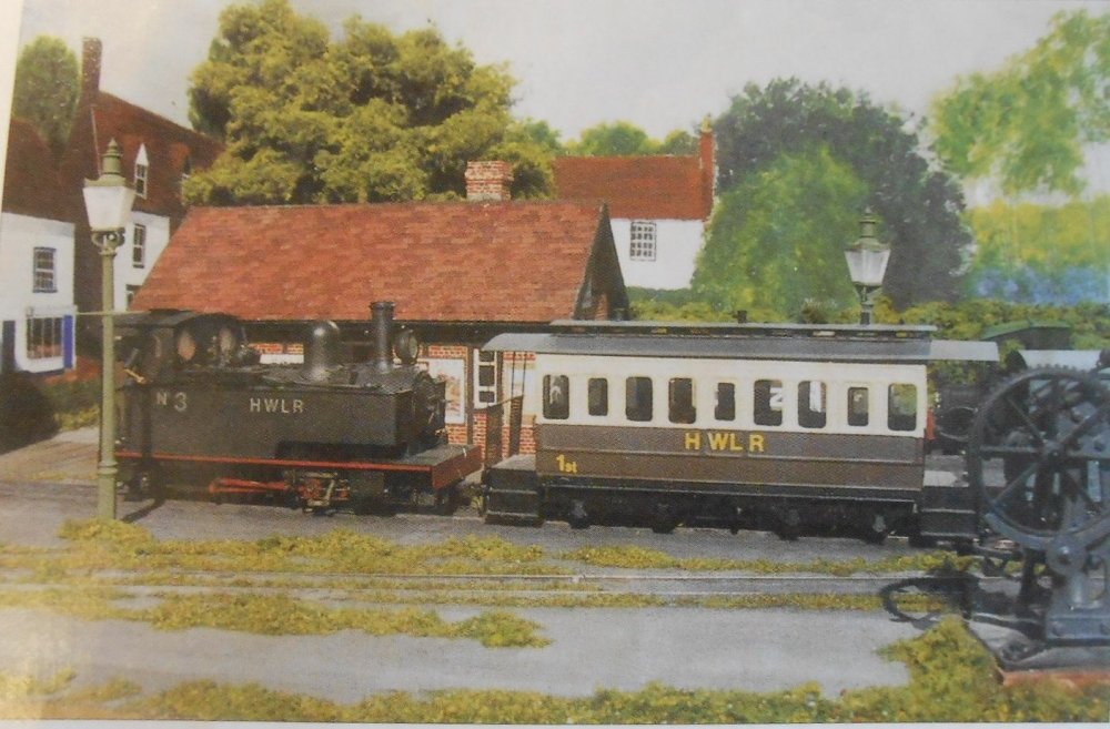

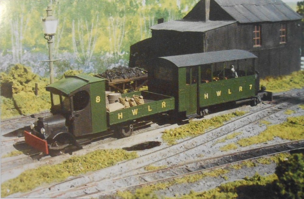

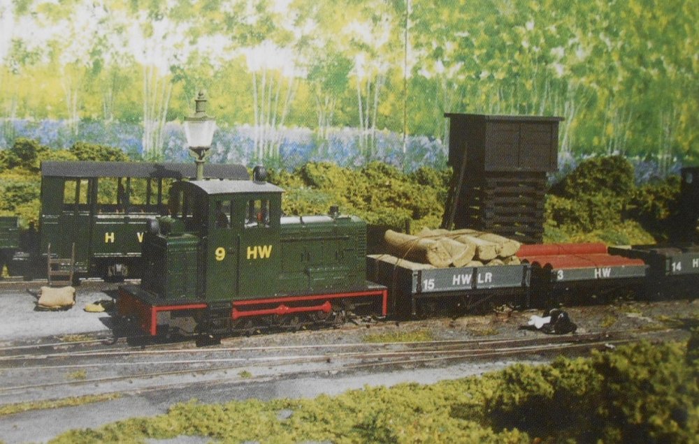

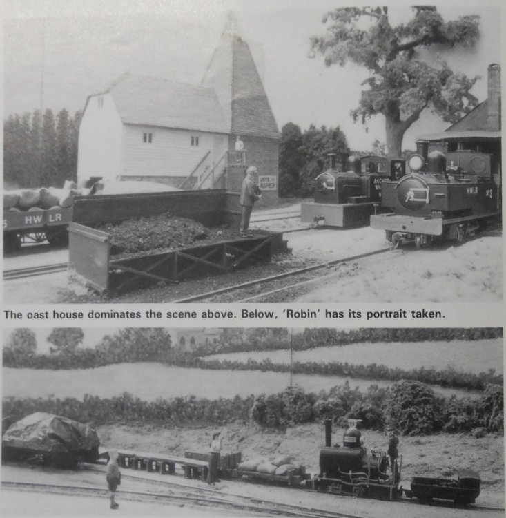

David Holman Posted April 24, 2020 Author Posted April 24, 2020 Fintonagh's predecessors Midlandman was asking about these, so I dug out my old RM's to include a few pictures from the articles I had published. Hawkhurst High Weald, was my first ever magazine article & while I've been lucky to have quite a few since, there is still a real thrill to see your work in print - plus you get paid as well! The layout was 0n16.5 using hand made track, but with a short length of 0n9, using N gauge track as a feeder 'twig' to the branch. The High Weald Light Railway was very much a Colonel Stephens inspired system [the surname has much to do with it], replacing the Kent & East Sussex with narrow gauge. It did about a dozen shows in the early 90s, but to be honest, it never ran as well as I would have liked. The baseboards developed a sag and my point building could have been better.. However, I'd become reasonably ok with making buildings and had a lot of fun with the station [based on Hemyock] and, especially, the oast house. The latter is a real Kentish signature building & I went to town on making it as accurate as possible, right down to the thousand odd individual peg tiles on the roof, while the bricks were all painted individually too. Stock was an eclectic mix, to say the least. I made extensive use of 00 chassis, so an outside framed 2-6-0T [freelance] had a plasticard body on a Lima 08 diesel shunter chassis, while the same methods resulted in an 0-6-0T with tramway skirts and an 0-6-2T came from a Lima 2-6-2T chassis. There was 'proper' stuff too - the Vulcan kit of a Sierra Leone 2-6-2T that gave me my first go at outside valve gear and a Wrightlines Baldwin 4-6-0T. Wagons and coaches were all scratch built in plastic on Ratio wagon chassis. Their bogie brick wagon yielded a couple of open wagons, plus a coach chassis, for very little outlay, which is one of the joys of freelancing in 7mmNG. I kept all the buildings, but Hawkhurst went to the recycling centre; the oast was reused on Loose End. However, as I still had all the narrow gauge stock, I decided to build another, small layout, called Cranbrook Town, initially to exhibit, but also with the intention of selling it all on. Cranbrook was a quick build, because I used Peco track. Indeed, see to remember I made the baseboard, laid the track and wired it all up inside a week. Scenics took a lot longer, as I experimented with a detailed back scene, portraying a bluebell wood. Made up of three 3x2 boards, with integral legs, the layout was easy to set up and even quicker to knockdown. The record for being back in the car after a show was 12 minutes! Some new stock was added including the Branchines Clogher Valley bogies coaches. I butchered one of the then brand new Hornby/Dapol 08 shunters into a narrow gauge diesel [which ran beautifully], while one of the MTK El Crappo [yes, really] railcar kits was paired with a lorry trailer made from the Corgi Liptons tea van [as per the real thing on the Selsey Tramway] to make a neat mixed train. Both layouts taught me a lot. I cut my teeth on scratch building both locos and coaches. Being freelance meant there was no need to absolute accuracy, but even then, inspiration came from Irish as well as English prototypes. 7mm NG is certainly a great was of getting into making your own stuff, not least because there are plenty of cheap, second hand chassis out there as starting points. I also explored various elements of layout design, used cassettes in the fiddle yards, Tortoise point motors and even made some track. Any elements which have since appeared in my Irish models are by no means coincidental. The first three pictures are Hawkhurst [RM was still not all colour then], the rest are Cranbrook. What happened to it after I sold it on, I've no idea, but do know that one of my CVR coaches ended up on David Taylor's Bridport, after being rebuilt into a parcels van. 8 1
Garfield Posted April 24, 2020 Posted April 24, 2020 Thanks for sharing those images, @David Holman; I remember seeing that RM article about the High Weald Light Railway back in the '90s. Superb modelling! 1
