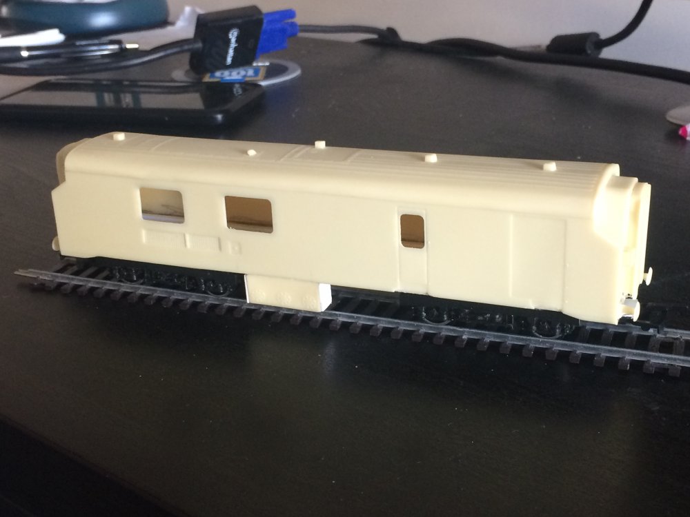

0 DJ Dangerous Posted November 25, 2020 Posted November 25, 2020 The Dutch Van kits sold by DC Kits, are they Silver Fox kits or IFM kits or whose kits are they? What is required to complete them? Are they body and chassis only, no bogies or details like buffers etc? Quote
0 flange lubricator Posted November 25, 2020 Posted November 25, 2020 (edited) 38 minutes ago, DJ Dangerous said: The Dutch Van kits sold by DC Kits, are they Silver Fox kits or IFM kits or whose kits are they? What is required to complete them? Are they body and chassis only, no bogies or details like buffers etc? I got one recently from DC kits but it was just the body I think that’s all he had left , I got the bogies from silverfox and made the chassis myself. Edited November 25, 2020 by flange lubricator 1 Quote
0 Noel Posted November 25, 2020 Posted November 25, 2020 (edited) 1 hour ago, DJ Dangerous said: The Dutch Van kits sold by DC Kits, are they Silver Fox kits or IFM kits or whose kits are they? What is required to complete them? Are they body and chassis only, no bogies or details like buffers etc? I don't know where DC source them from. Silverfox didn't release a rebuilt version. I got basic kit from IFM last year but where Tom got it from I know not. Since had to make some chassis box gubbins for under the chassis. I only bought the kit to have something to run with my Bachmann mk2a intercity coaches. I put sprung buffers on mine and boiler tanks inside. Edited November 25, 2020 by Noel typo lexdysia and predictive text 2 Quote
0 flange lubricator Posted November 25, 2020 Posted November 25, 2020 17 minutes ago, Noel said: I don't know where DC source them from. Silverfox didn't release a rebuilt version. I got basic kit from IFM last year but where Tom got it from I know not. Since had to make some chassis box gubbins for under the chassis. I only bought the kit to have something to run with my Bachmann mk2a intercity coaches. I put sprung buffers on mine and boiler tanks inside. Great job Noel , you don’t need boilers on these as they were removed during the conversion to EGV . 1 Quote
0 Noel Posted November 25, 2020 Posted November 25, 2020 (edited) 2 hours ago, flange lubricator said: Great job Noel , you don’t need boilers on these as they were removed during the conversion to EGV . Oh great I'll rip them out Cheers (in jest) But I'll keep them in the RPSI original dutch GSV Edited November 25, 2020 by Noel 2 Quote
0 flange lubricator Posted November 25, 2020 Posted November 25, 2020 1 minute ago, Noel said: Oh great I'll rip them out Cheers Sorry about that Quote
0 Noel Posted November 25, 2020 Posted November 25, 2020 Just now, flange lubricator said: Sorry about that No Problem. I just realised I may have put kerosine into B135 instead of diesel Hopefully the dutch will keep RPSI customers warm and happy 2 Quote
0 flange lubricator Posted November 25, 2020 Posted November 25, 2020 1 minute ago, Noel said: No Problem. I just realised I may have put kerosine into B135 instead of diesel B135 is an EMD 2 stoke diesel it will burn it anyway 1 Quote
0 murphaph Posted November 25, 2020 Posted November 25, 2020 4 hours ago, flange lubricator said: I got one recently from DC kits but it was just the body I think that’s all he had left , I got the bogies from silverfox and made the chassis myself. How much did you pay for the body only if you don't mind me asking? Quote
0 flange lubricator Posted November 25, 2020 Posted November 25, 2020 5 minutes ago, murphaph said: How much did you pay for the body only if you don't mind me asking? As far as i remember about £30 I ordered and paid for the complete kit and they contacted me too say they had no more bogies so I asked them to supply the body only which they did and organised a refund for the difference , I looked at the IFM one but thought the buffers were too high so I got the DC kits one instead . 1 Quote
0 NIR Posted November 25, 2020 Posted November 25, 2020 (edited) DC Kits are not into stocking bits and pieces these days, more along the lines of if it's gone it's gone. Edited November 25, 2020 by NIR 1 Quote
0 Noel Posted November 25, 2020 Posted November 25, 2020 53 minutes ago, flange lubricator said: . . . I looked at the IFM one but thought the buffers were too high so I got the DC kits one instead . Agree . . . and they were too big, tonka tank big. I substituted the 3D buffers with sprung metal buffers from Peter's spares. 1 Quote
