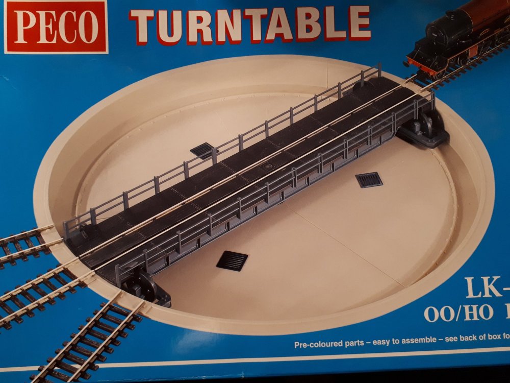

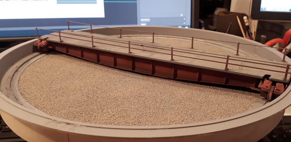

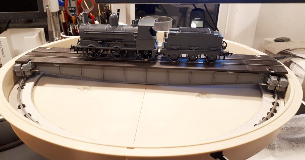

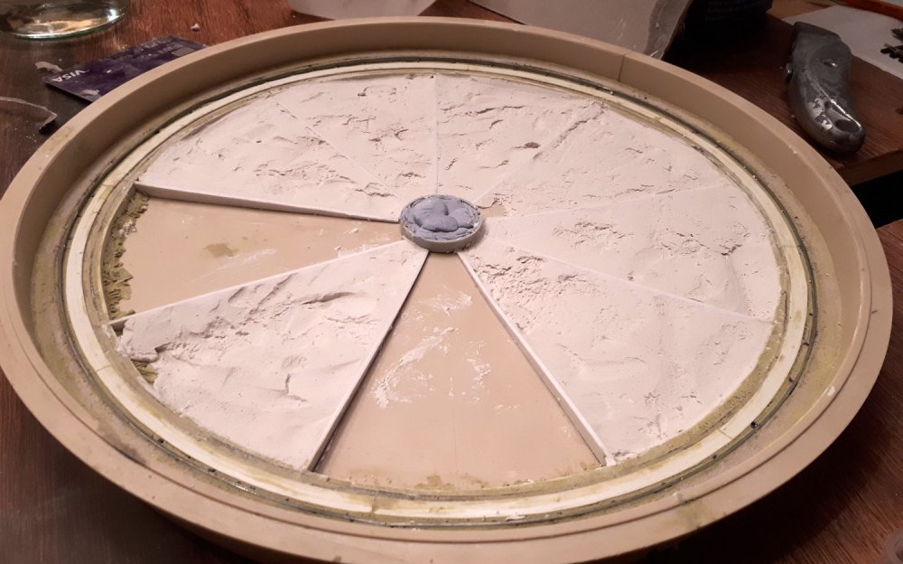

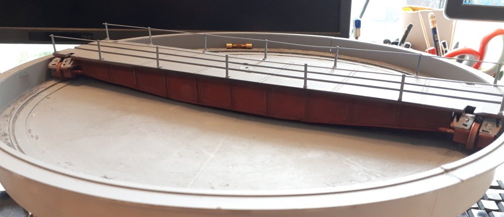

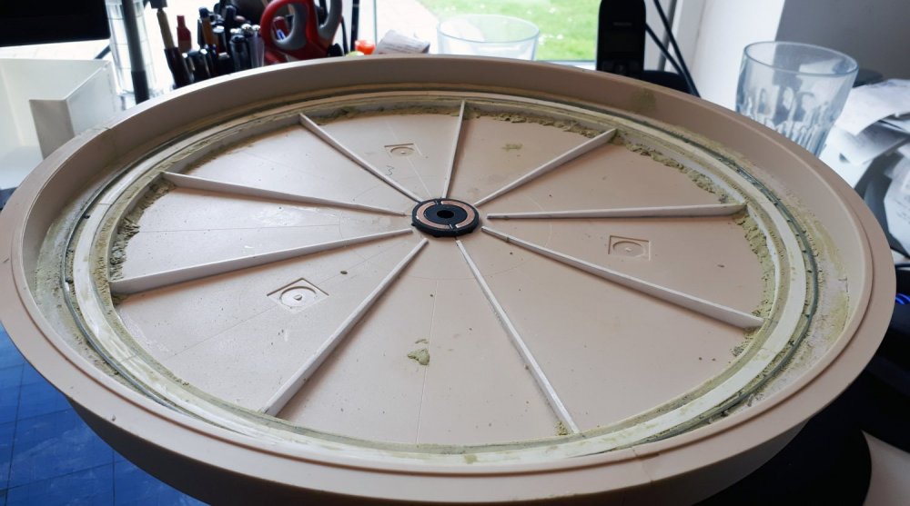

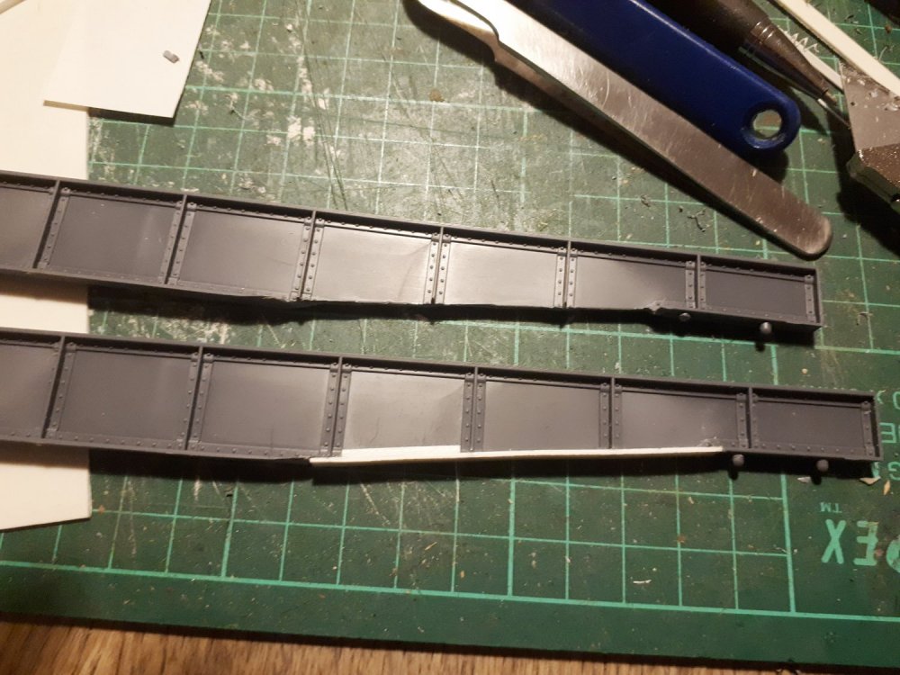

scahalane Posted May 4, 2020 Author Posted May 4, 2020 I bought a Peco turntable kit a couple of years ago with the hope of converting it to look somewhere in the ballpark of the turntable that was at Kent station Cork. Its very over scaled and a bit toy like but a good starting base for a bit of kit bashing. The Kit! The support girders are the wrong shape so required a bit of chop and paiste. The turnatable well is far too deep so required building up the base. I also had to swop the over size wheels for something closer to the correct scale. I used card to build up the levels, and some old hornby set tract for the runner rails. v Plastic card was used to create a sharper edge and pilliput to fill the gaps Fine modelling plaster was used to build up the levels and create a solid base. Evergreen angle and tube were used to create the hand rails. Fine ballast added. In situe in the next stage of my layout. A bit of weathering. 12

jhb171achill Posted May 5, 2020 Posted May 5, 2020 18 hours ago, scahalane said: I bought a Peco turntable kit a couple of years ago with the hope of converting it to look somewhere in the ballpark of the turntable that was at Kent station Cork. Its very over scaled and a bit toy like but a good starting base for a bit of kit bashing. The Kit! The support girders are the wrong shape so required a bit of chop and paiste. The turnatable well is far too deep so required building up the base. I also had to swop the over size wheels for something closer to the correct scale. I used card to build up the levels, and some old hornby set tract for the runner rails. v Plastic card was used to create a sharper edge and pilliput to fill the gaps Fine modelling plaster was used to build up the levels and create a solid base. Evergreen angle and tube were used to create the hand rails. Fine ballast added. In situe in the next stage of my layout. A bit of weathering. Looks great. What did you do to put the inevitable gunk and gravel in the pit? Looks very much the part, and prompts me to think of posting a pic of a pristine grey loco tomorrow, just out of the paint shop at Inchicore.......must have a look! 1
