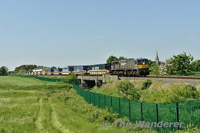

The penultimate train from Ballina, the 1105 Ballina - Waterford is pictured crossing the Commons Bridge at Portarlington with 081 in charge of a fully loaded train.
Click the image bellow to see the full sized image.

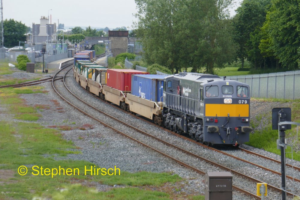

The final Ballina-Waterford DFDS liner operated on Tuesday 5 June. The train was composed of 12 fully laden CPWs, hauled by 079. The photos below show it at Hybla bridge (OBC 96) between Monasterevan and Cherryville Junction and at Athy, where it was to cross the 14:50 Waterford-Heuston passenger.

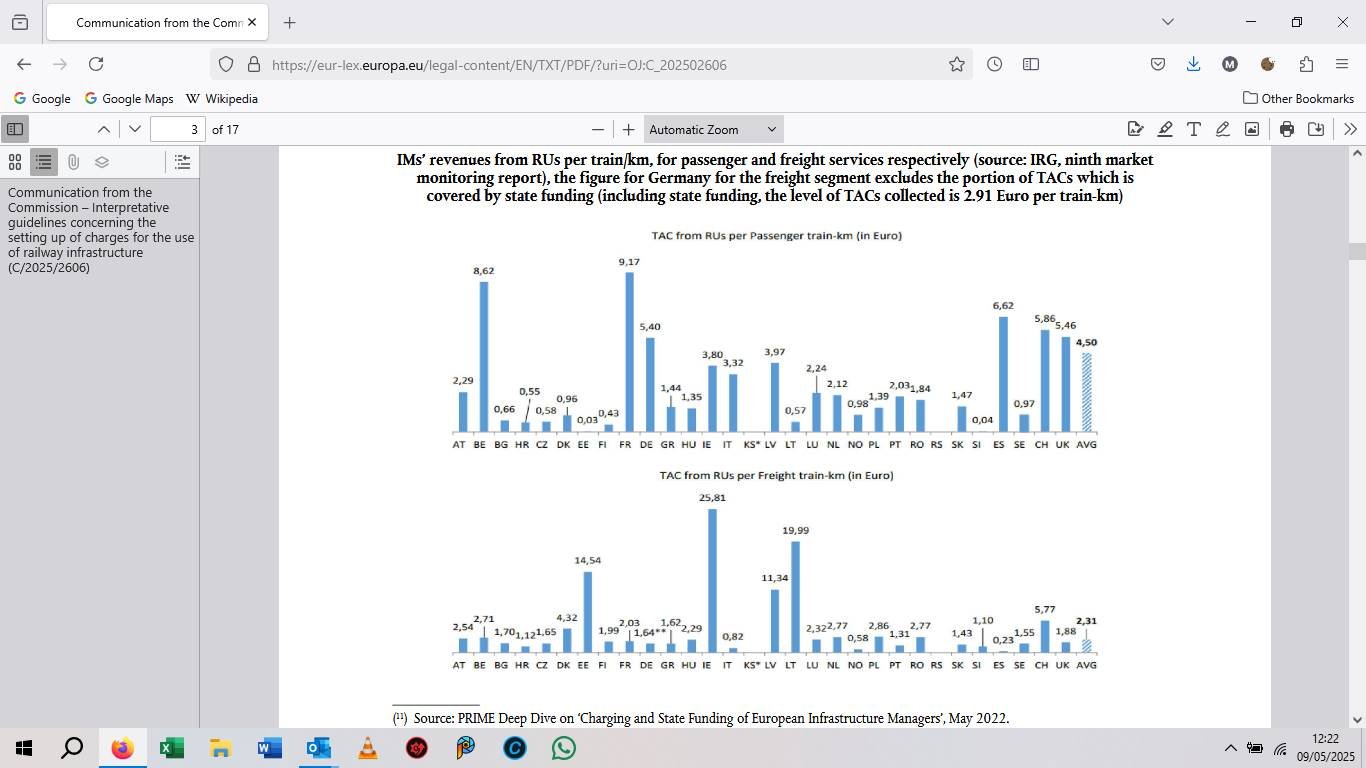

Track access charges for freight are in the lower graph. It looks like Ireland has the highest in Europe so is it any wonder that rail freight has declined.
Interesting - thanks. Over ten times the average!
It's especially bad since these figures are per train-km, and Ireland's freight trains are much shorter than most in Europe. If it was done by wagon-km (which better represents the earning potential) then I would expect an even bigger differential.
I wonder what proportion of the total train operating costs the TACs are? To run a freight over a 200km route the IE TACs will be about EUR 5000. The loco's probably going to burn 200 gallons* of diesel at maybe EUR 4 per gallon so around EUR 800. The driver might earn a few hundred more for the trip. Harder to quantify are the maintenance and terminal costs, overheads etc. But it looks like the TAC might be the dominant factor at IE rates, whereas it would be a smaller percentage in other countries.
