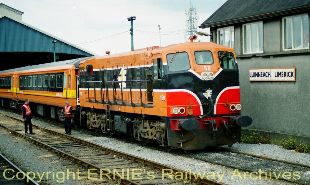

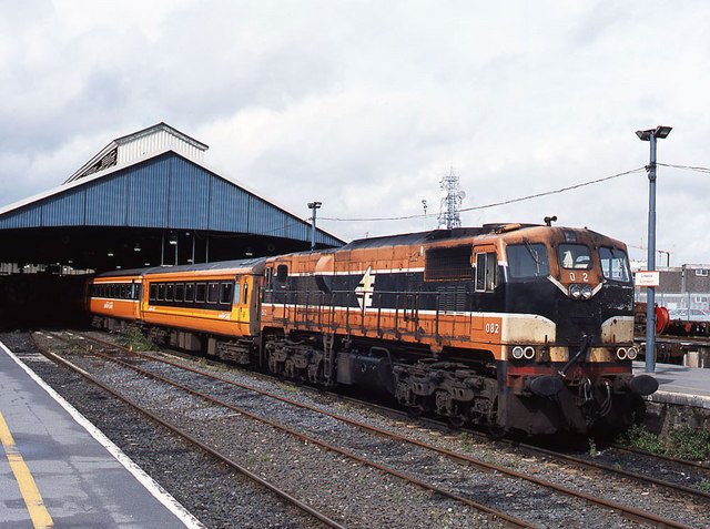

They definitely made it to Limerick City so would have passed round the 'new' curve at the Junction but I havn't found any images of  any actually passing through or calling at the station yet.
This one Limerick City June 2001
b Limerick 150 sta pilot June 2001 a940

IMHO the Galway livery was a short lived abomination that was designed to brand match the newly delivered orange 201s. Instead the 201 locos ran with tippex Mk2 and Mk3 coaches and looked quite incompatible due livery mismatch.
  • 0
This was something different and adds interest, Variety is the spice of life.
  • 0
15 hours ago, Rob said:
You going to model something based around Limerick?   Lots of questions about Limerick 🤣🤣🤣
Yeah I believe I will when I have moved on from rolling stock collection mode. Some very interesting possibilities in a Limerick junction/Limerick/Foynes/Nenagh layout.
  • 0
34 minutes ago, murphaph said:
Ooh that's nice. I'm not a huge fan of the livery but the odd one mixed in like that is a nice option to have.
I saw an odd one a few times through Ballybrophy, but I have no presentable evidence of any of the events..
