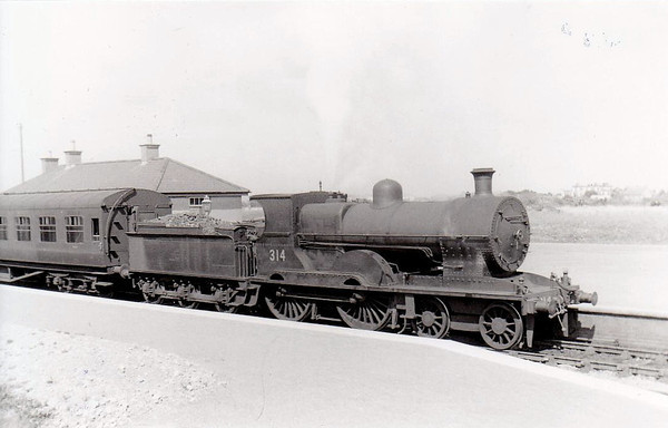

Magpie1951 Posted December 6, 2014 Posted December 6, 2014 Thanks for all the suggestions, so pre 1955 the dark green similar to the Bachmann CIE coaches and post 1955 a lighter green? Yeah pretty much got it one there Kirley although if you thinking of the dark pre 1955 green (which would look great with your Bachmann coaches) a lot the CIE Bredin Mk2's didn't seem to get the eau de nil lines above and below the windows like the Bachmann coaches (and the GSR Bredins). Most seem to either have a thin line along the waist like the park royals I posted earlier and a good few didn't even get an eau de nil waistband at all. They were just all over plain dark green. The BSGV in Downpatrick is painted in this earlier pre 1955 livery shown below , https://www.flickr.com/photos/conorsteamtrains/15735317358/in/pool-transport-in-ireland The coach behind the Steam Loco is in the pre 1955 dark green livery without any eau de nil lining in the link below I think the buffet cars were built in 1956 so they would be in the post 1955 Emerald green livery with the eau de nil waistband like the park royal in my earlier post. It would make a great train if you had one coach dark green livery with waistband , one in just dark green with no waistband , the buffet in the post 1955 light green and waist band along with the bachmann coaches! One other point I should have mentioned is although the park royals I built had no flying snails along there sides, any pictures I have seen of the CIE Mk2 Bredin 3rd corridor and composites coaches had flying snails on the sides (passenger class identifying numbers on the door too) in eau de nil (Westy has done these transfer for me before) in the pre 1955 livery with the waistband and post 1955 Emerald green livery but not the pre 1955 plain dark green livery!!I don't think the buffet had flying snails on the sides though!

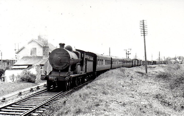

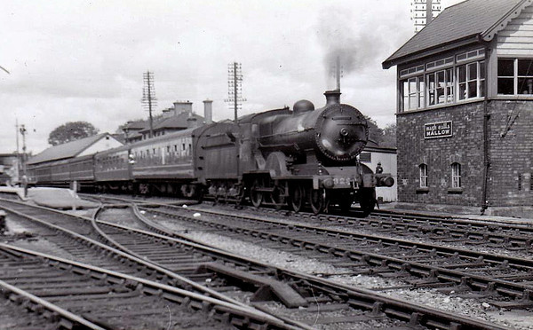

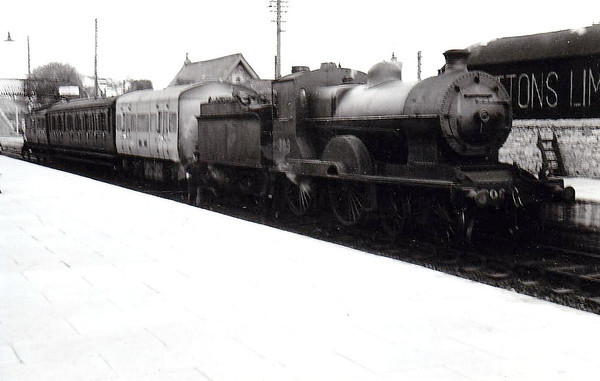

Mayner Posted December 7, 2014 Posted December 7, 2014 Great to see the amount of carriagebuilding this thread is bringing out of the woodwork. Probably going a bit off topic its important to remember that in the 50 & 60s uniform rakes of coaches were rare, particularly with loco hauled trains CIE regularly ran mixed modern and older coaches in the one train. Pre & post amalgamation coaching stock built in the 1920s relatively modern but dated in appearance was still in top-link service in the 1950s The green Models/Bachmann coaches would make a reasonable rake of these vehicles. The new coaches probably displaced some of the older bogie coaches from main line service, in turn to replace (but not completely) 6 wheelers on branch and suburban duties. Some of the classics include a new Composite and a GSWR 6w 3rd brake at Loughrea and a steam hauled Thurles-Clonmel train with an ancient looking bogie coach sandwitched between a MGWR 6 w caboose Brake 3rd and a silver heating van. Possiby a Waterford-Limerick train with two of the newer coaches, a GSWR coach and a string of vans. What looks line a Kingsbridge-Tralee express leaving Mallow, modern CIE coach possibly composite or 1st, Pullman Dining car and a rake of early GSR/late GSWR corridor coaches. I could not resist this one powerful Coey 4-4-0 with a tin van, GSWR bogie coach and MGWR brake van probably Thurles-Clonmel branch train. Some of the Clonmel trains connected with Dublin-Limerick (via Nenagh) trains at Ballybrophy with a featherweight load and a high speed run down the main line to Thurles.
