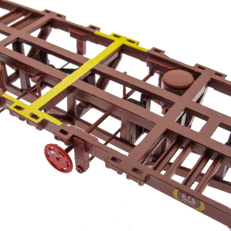

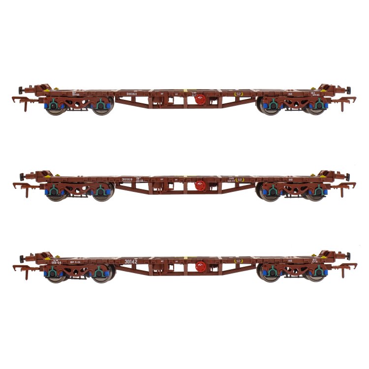

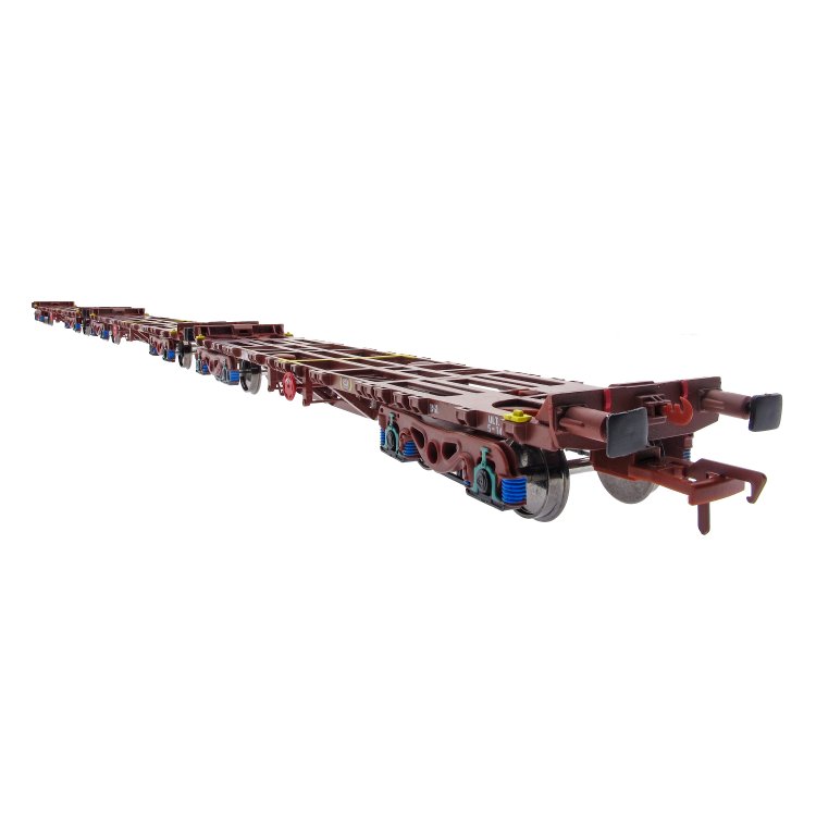

The huge advantage with the IRM type flat wagons of course is that they are not plastic at all but die-cast metal, so they are the correct weight even unladen. Hiding a weight inside a plastic skeletal wagon, regardless of manufacturing method, is nigh on impossible so you end up needing to place a load on them, missing out on all that detail visible through the chassis from above.
  • 0

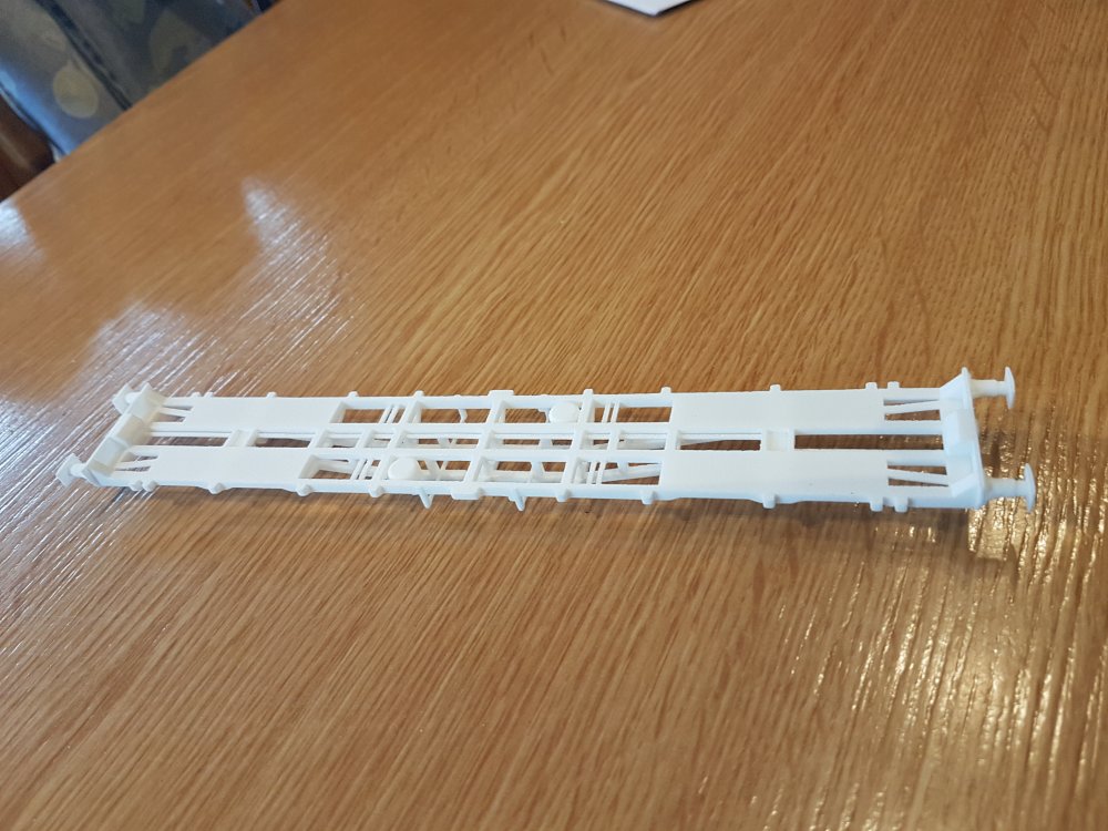

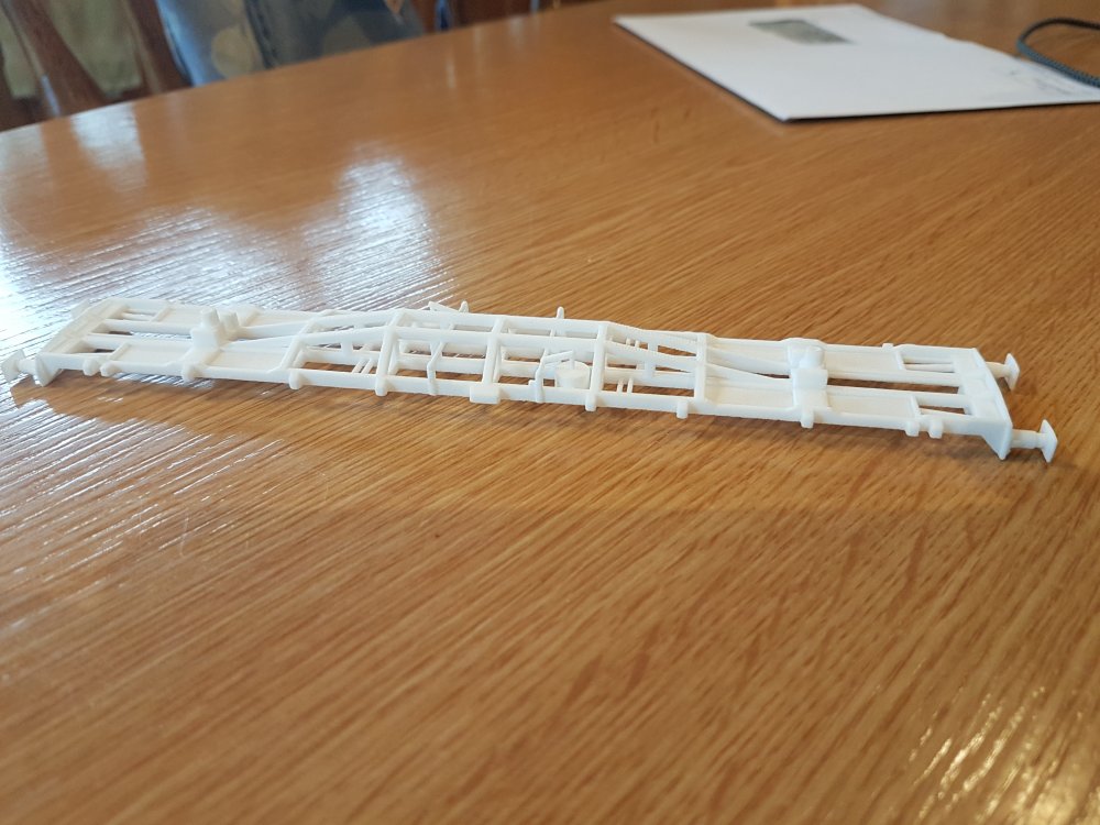

The main draw back with Shapeways seems to be that models like the MGWR 6 wheel coaches only appear to be available in White Natural Versatile Plastic which has a surface texture like rough cast plaster  https://www.shapeways.com/product/QYWUZUKGH/0-76-mgwr-6w-brake-3rd-coach?optionId=96599245&li=marketplace
Some models like the 47'6" flats are available in Frosted Ultra Detail (FUD) but the material is more expensive, has a layered effect and quite brittle, I managed to shatter some FUD parts.
A superior surface finish without a layered effect should be achievable with Shapeways SLA materials, but a lot depends on the skill and experience of technician who sets up the CAD file on the printer and how the print house ensures that the model is not damaged during the clean up process and removal of the temporary support structure. https://www.shapeways.com/materials/sla-accura-xtreme/.
The goods brake is a good example of the standard of surface finish and and level of detail that can be achieved by SLA printing, the wavy roof and coupler sag has been resolved in the final design.

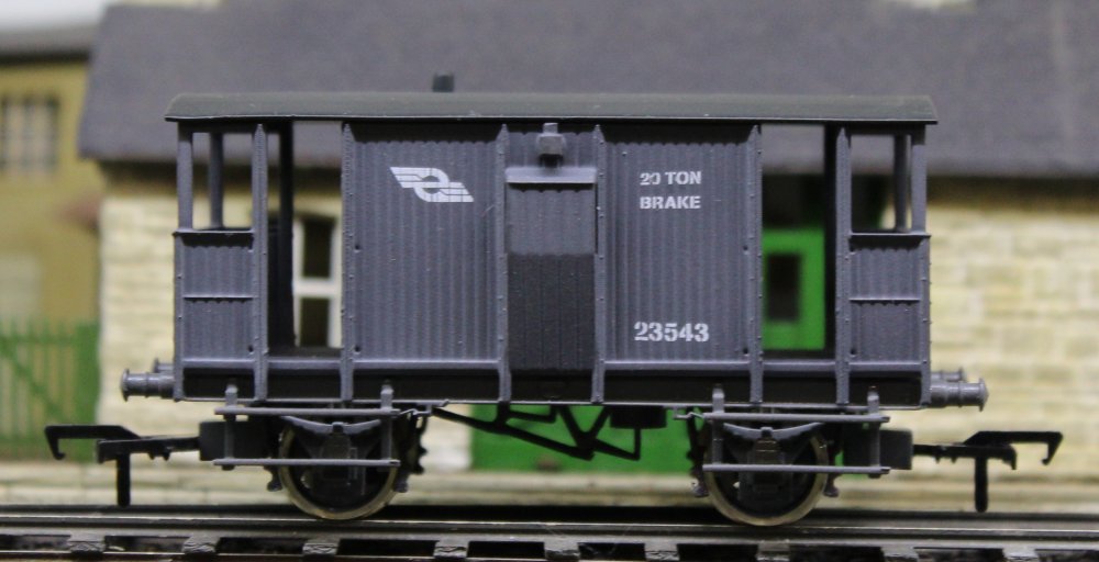

A direct comparison of a SLA print and a plastic injection molded model a test print of a GSR grain wagon and a Ratio LNWR coal wagon.
We went a bit heavy with the rivet detail on this wagon, but otherwise I am quite happy with the model and CAD work.
The blemish on the side of the grain wagon is I tried to apply dry print lettering that is past its sale by date, we tried to push the boundaries on detailing with this model but ran into problems printing the hopper release gear which will have to be beefed up. The challenge at the production stage will be to avoid removing detail such as brake levers and linkages while removing the support structure at the factory.
Although SLA printing appears to be a viable option for the small scale manufacture it remains to be seen whether its a viable option for the manufacture and assembly of rtr models.
The next two months shall certainly test the concept for production of the brake van!
The Chinese OEM factories that produce small production runs of <10,000 unit orders are only viable because they have the capability to take on and process orders from a number of clients simultaneously, a number of the companies that specialise in smaller production runs were set up by former employees when Kader decided to shut down a lot of its OEM manufacture to concentrate on its own in house brands about 10 years ago.  This left Hornby and other competitors stranded until the present generation of Chinese OEM model railway manufacturers entered the market.
I doubt that similar model railway manufacturing capability or experience exists in the West today
